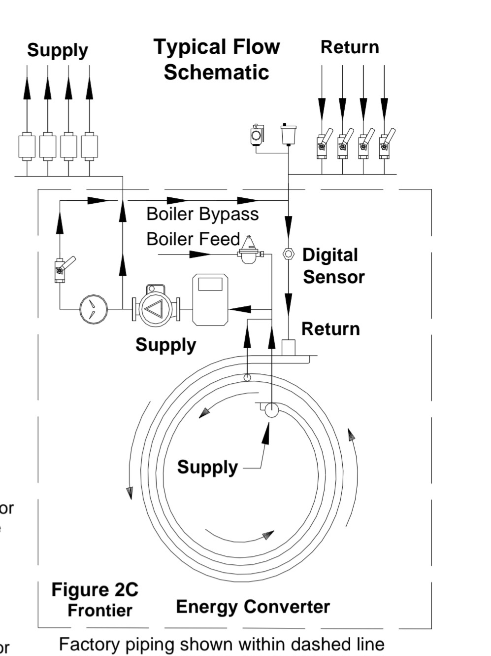

    HVACNUT Posts: 7,784
    What condition is the air eliminator in? What position is the bypass valve in? It should be about half way as shown in the schematic. Never closed. Is there a plate heat exchanger for a water heater, or is it just a bypass?
    Its odd there's reoccurring circulator issues.
    @Resipsa88 , you mentioned ratiator. What type? Is it a monoflo system? How many zones?
