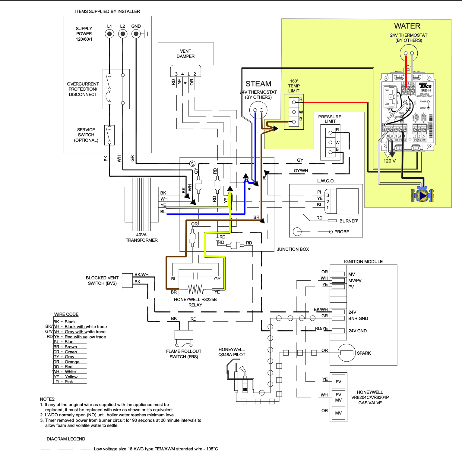

Need some help i have a hot water basement zone off steam boiler for some reason its producing steam to the upper floor when its calling for heat I have a aquastat installed set at 180 but that does not help
    Wiring problem or problem with aquastat. Can you diagram the wiring for us? What connects to what?

    On a call for heat from the water baseboard zone there should be a control that stops the burner when the water temperature reaches 160° or 180°. That way the burner can not operate at a high enough temperature to make steam.
    A detailed wiring diagram can be provided for this logic once I know what boiler and burner system you have. Also what thermostat operates the baseboard water loop? Picture of the boiler from far enpugh back to see the piping and the controls from 2 or 3 different angles will help

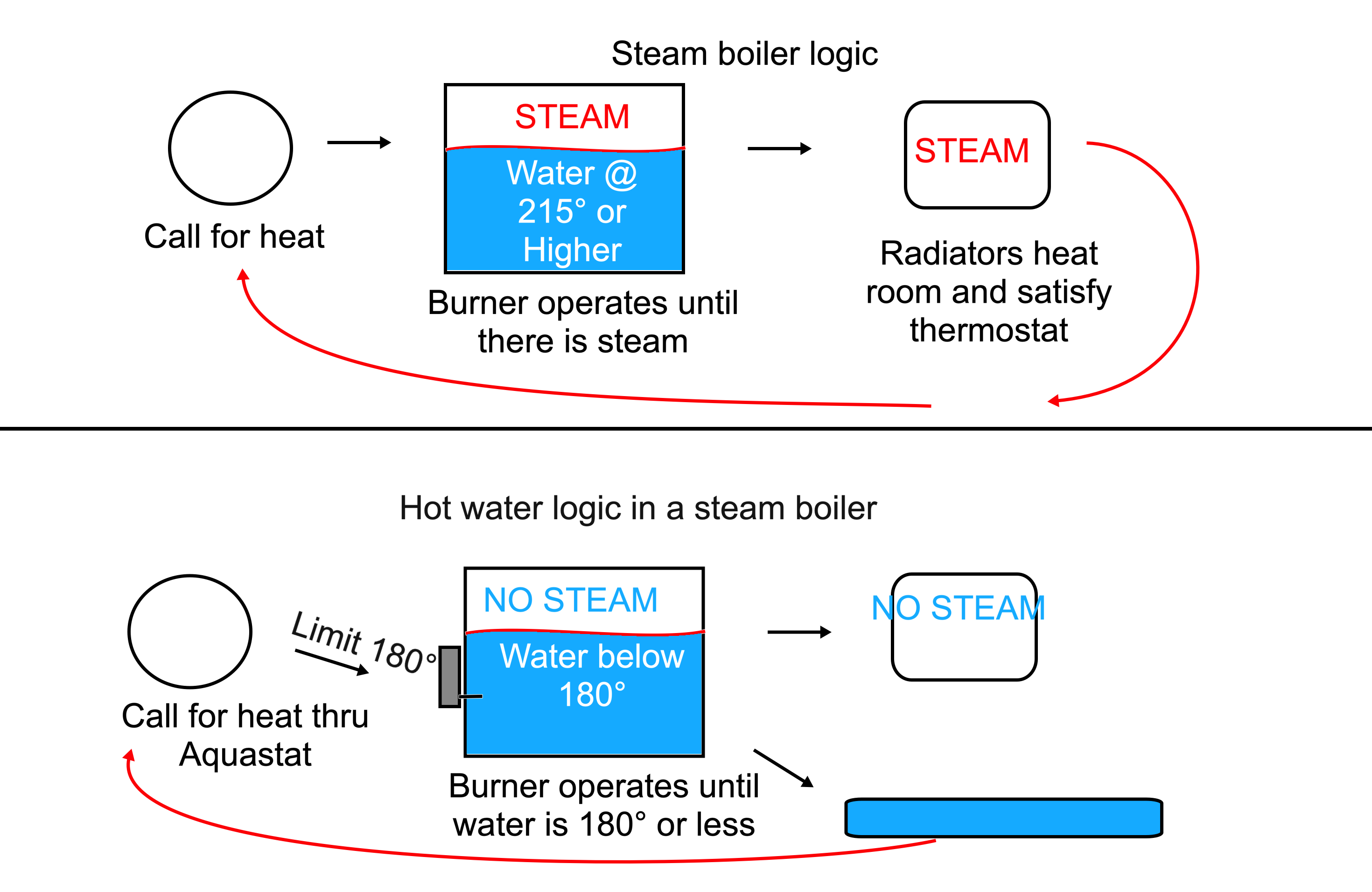

    I'm not sure if this is your exact wiring diagram from Crown Boiler by Velocity Boiler Works, but if it is, I have added the controls needed to operate the circulator pump and the burner so your thermostat from the water zone will not make steam.
    The yellow highlight is not part of the factory diagram. It has the three controls needed to operate the circulator pump. A thermostat for the water zone. a circulator relay and a Aquastat like the L6006C to stop the burner before it gets hot enough to make steam.
    You will also want to read up on how to do this because the circulator location as close to the floor as possible is important so there is less chance of cavitation when the steam thermostat makes the water heat to 215°F and the water zone is operating at the same time.

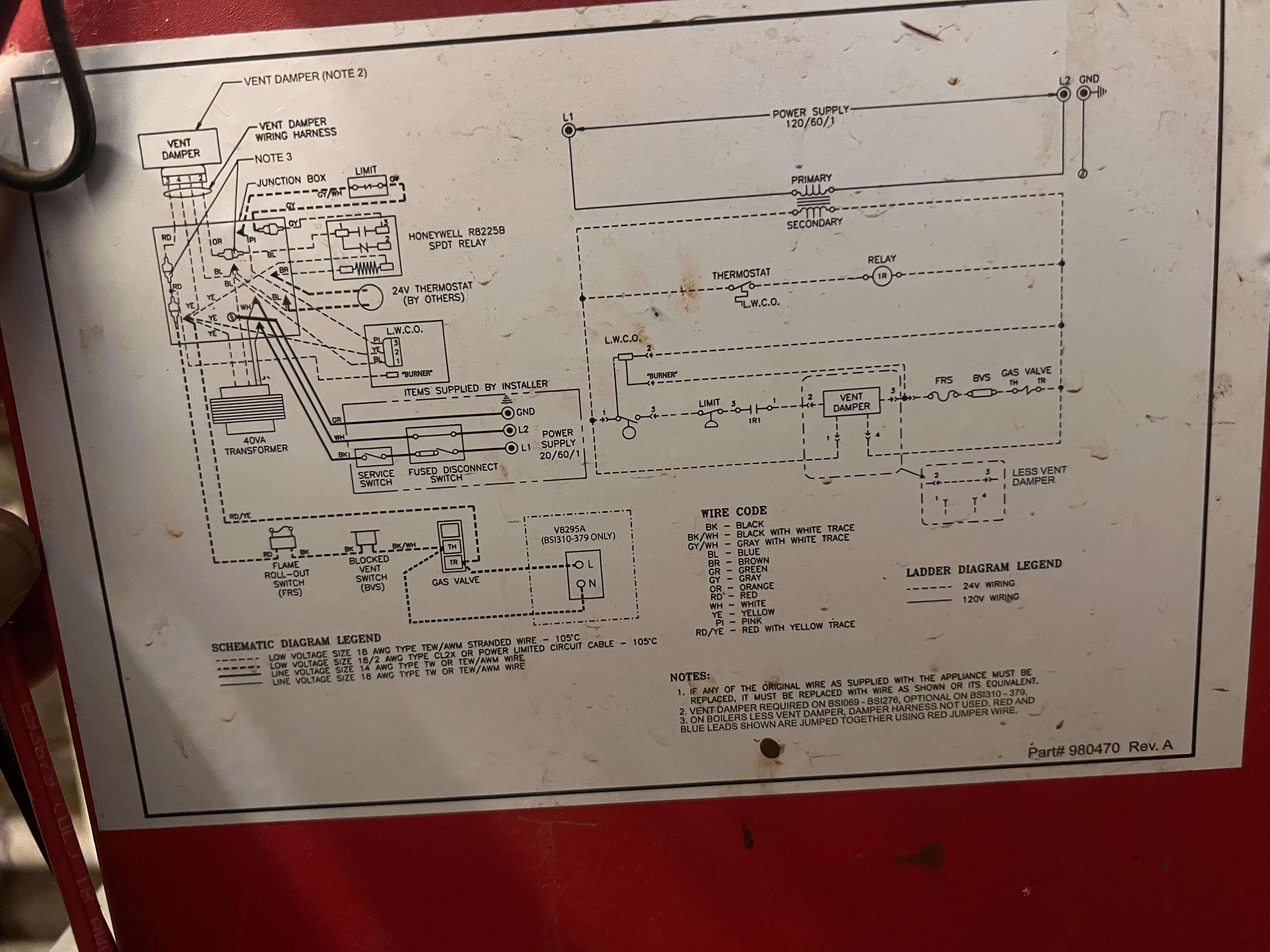

    Hi, I will update today with pictures and wiring diagram exactly the way it is thanks all for helping

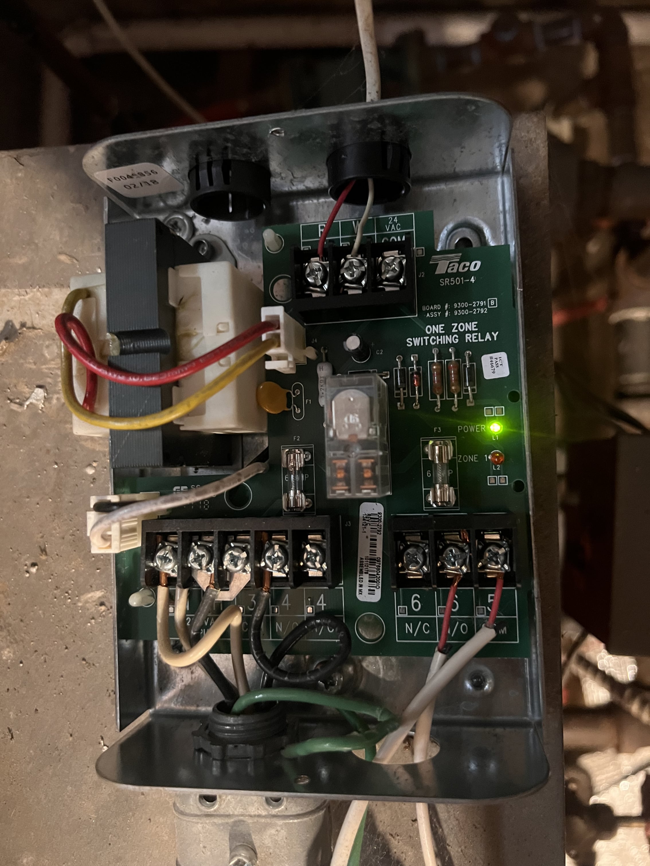

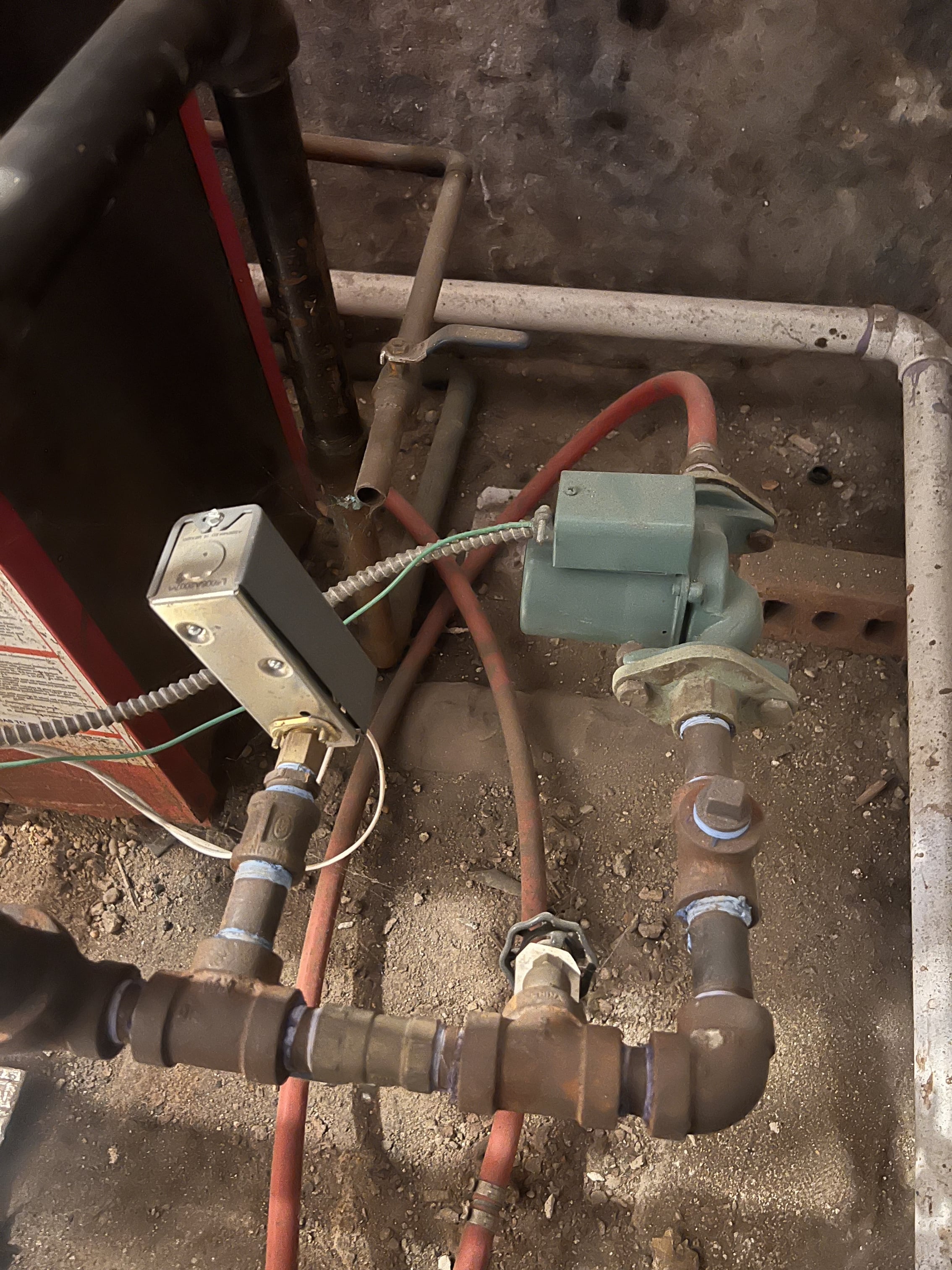

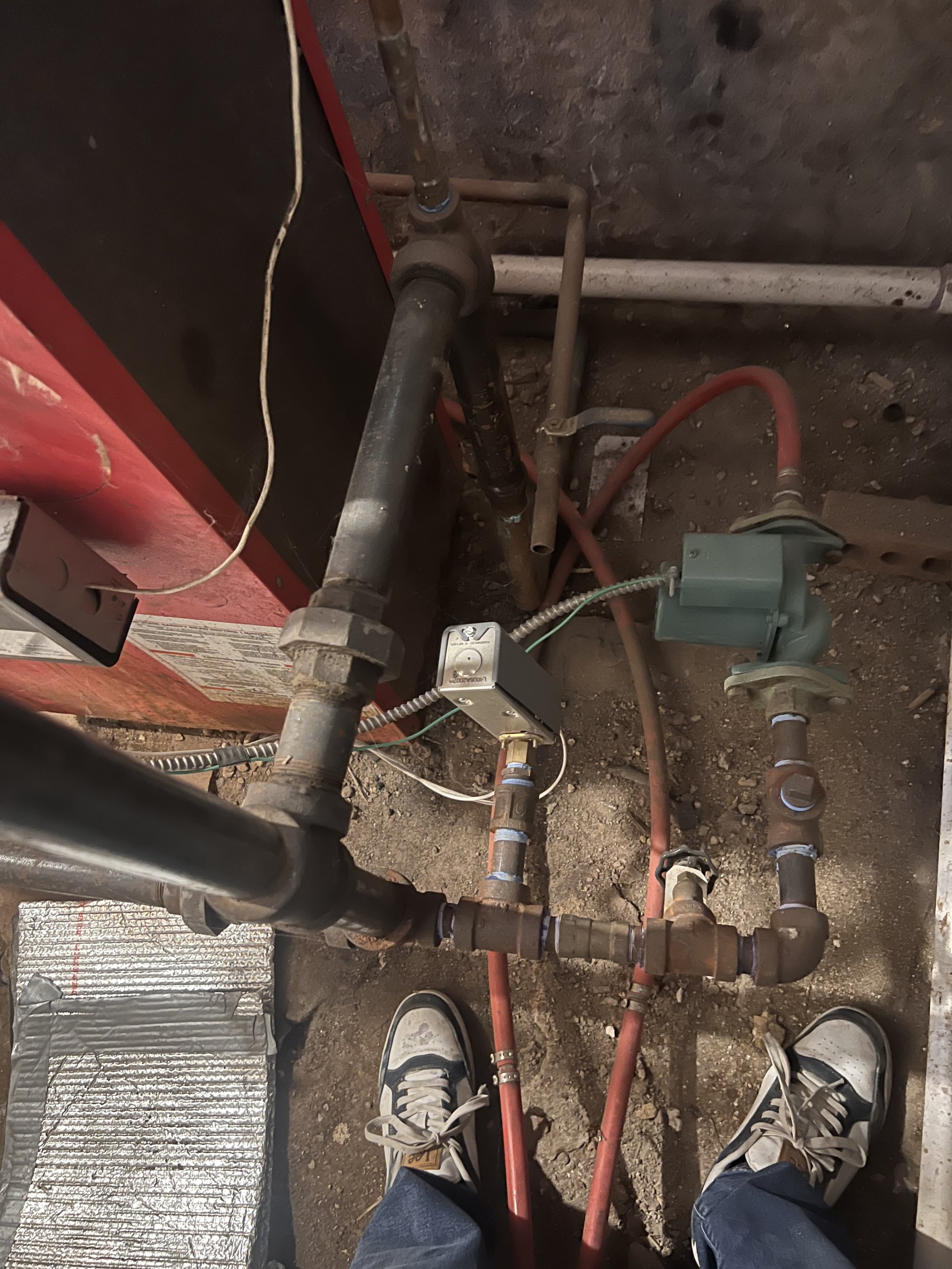

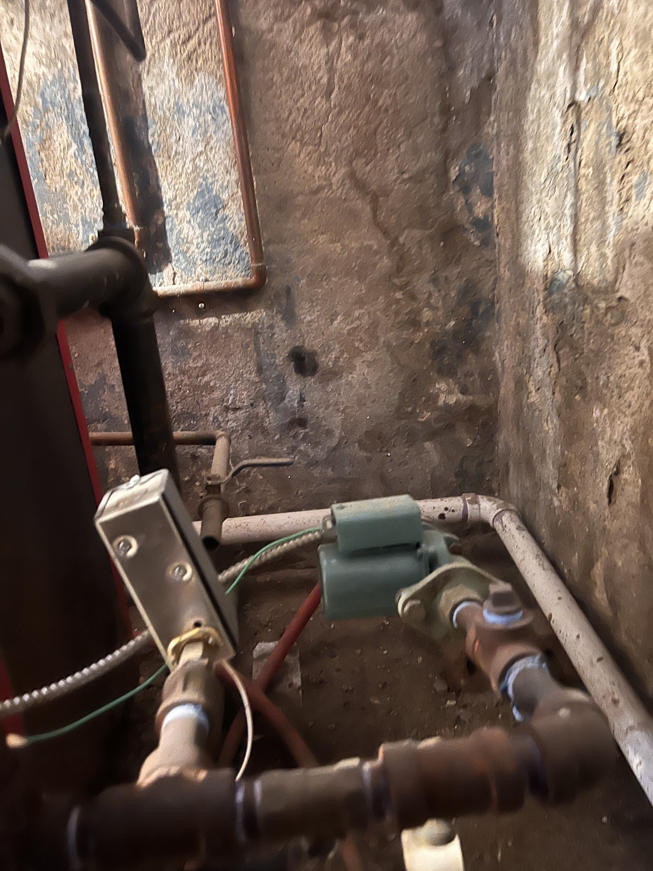

    Hi, all I am attaching pictures thanks

    I installed the system about two years ago honestly and it was not cutting off at 180 degrees so I did replace the Aquastat about a year ago thought that was the prob but it’s not and yes I turn down upstairs thermostat to test

    I'm not sure that the aquastat location is the best choice. the boiler temperature and the temperature where the temperature is being sensed can be over 30° different which will make steam and the aquastat is still allowing the burner to operate. That will depend on the distance from the boiler and if the pump is operating and how fast the heat will transfer up the Tee fitting until it reaches the actual temperature probe.
    Please take a close look at the position of the temperature probe that I have superimposed inside the pipe. The water temperature you are measuring is from the bottom of the boiler, flowing past the tee fitting and then to the circulator pump. You are not measuring the water temperature in the boiler near the surface of the water, where the steam is generated.
    What model number is your boiler. There is a better place to install that aquastat.

    wiring diagram update to your diagram posted:
    I believe your system wiring is correct. The problem is in the aquastat location.
    This diagram in the manual shows that the Aqustat location for a hydronic loop (the indirect in this case) is located in the boiler, not on a tee outside of the boiler.
    It is above the larger return tapping, but below the water line. Also there are specific tappings on the boiler for taking a hydronic loop off of the boiler. see Figure 3-3 tapping P is for the control. Tapping M and N are where your circulator and retur pipes should be located.
    Since you did not use the proper tappings, but the system is heating the baseboard loop, I would not stress over that piping. I would just try to remove the 3/4" plug from tapping P and install your aquastat there.
