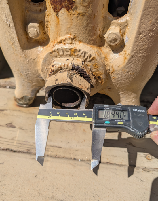

Hello,
We are going through a kitchen remodeling project and the old steam valve with handle was disposed of during the demo. The new valve will not connect to the union nut on the tailpiece in the radiator. Are these not standard, or is there something else we should be looking at? Plumber could not remove the tailpiece with a spud wrench (a piece inside broke). 1 1/4" Pipe Size. I am assuming the new valve was bought from supplyhouse.com.
Thanks
    ethicalpaul Posts: 9,035
    They are not standard. You have to install the one that came with the new valve. You can search youtube for videos, or this forum for written instructions about how to remove the spud from the radiator. You basically carefully cut it and chisel it out. It's not as bad as it sounds. Don't cut into the threads. You've been warned!

    You remove the old spud using a pipe wrench.
    You cut the nut off and then you can get a pipe wrench directly on it.
    The spud wrench is only used for installing new spuds, it'll break on old ones.
    The new valve should have come with a new matched spud. There is no standard.
    I like the digital calipers though…………. Nice choice.
    IronmanPC7060

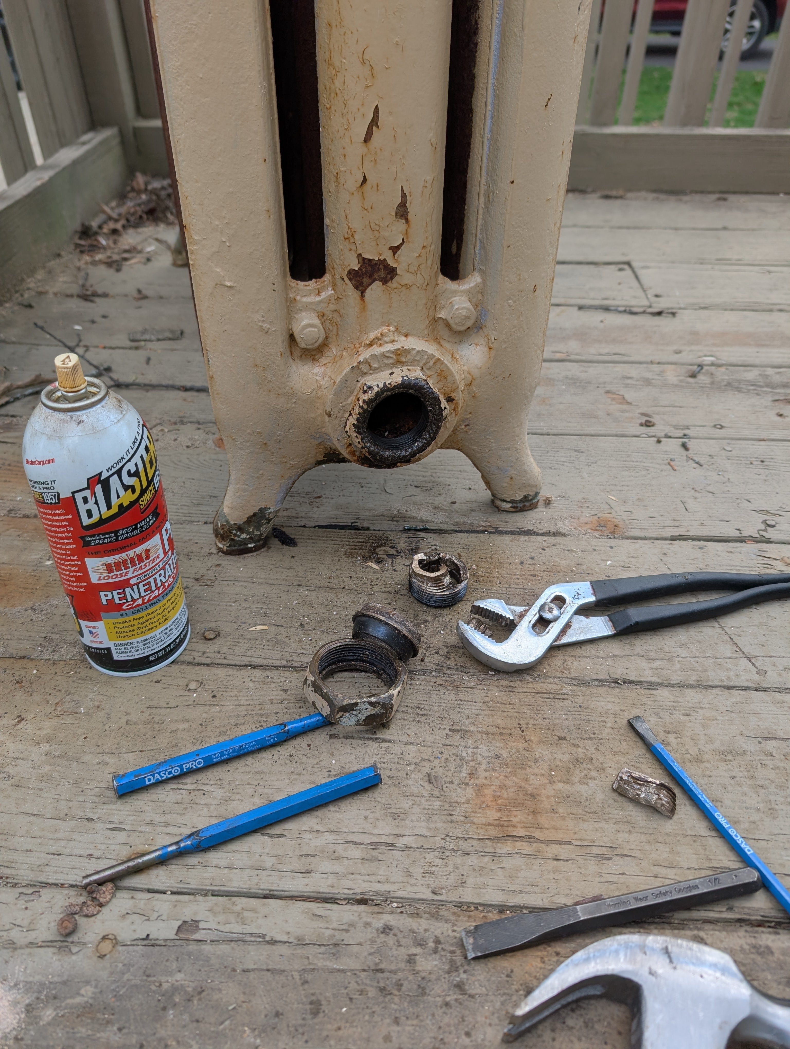

    Grallert
  • barnic
    barnic Posts: 19
    Thanks for all of the comments. I watched this video and it did not go as planned. The metal seemed to be soft and brittle, not just soft. When trying to fold the metal in, it broke off instead. Ended up using PB blaster, then using and punch and hammer to rotate it off.
    mattmia2 Posts: 18,233
    it might be worth trying a wrench again after you cut the slots, they might relieve enough stress to unscrew it. you need the chisel pretty close to the face of the bushing.
