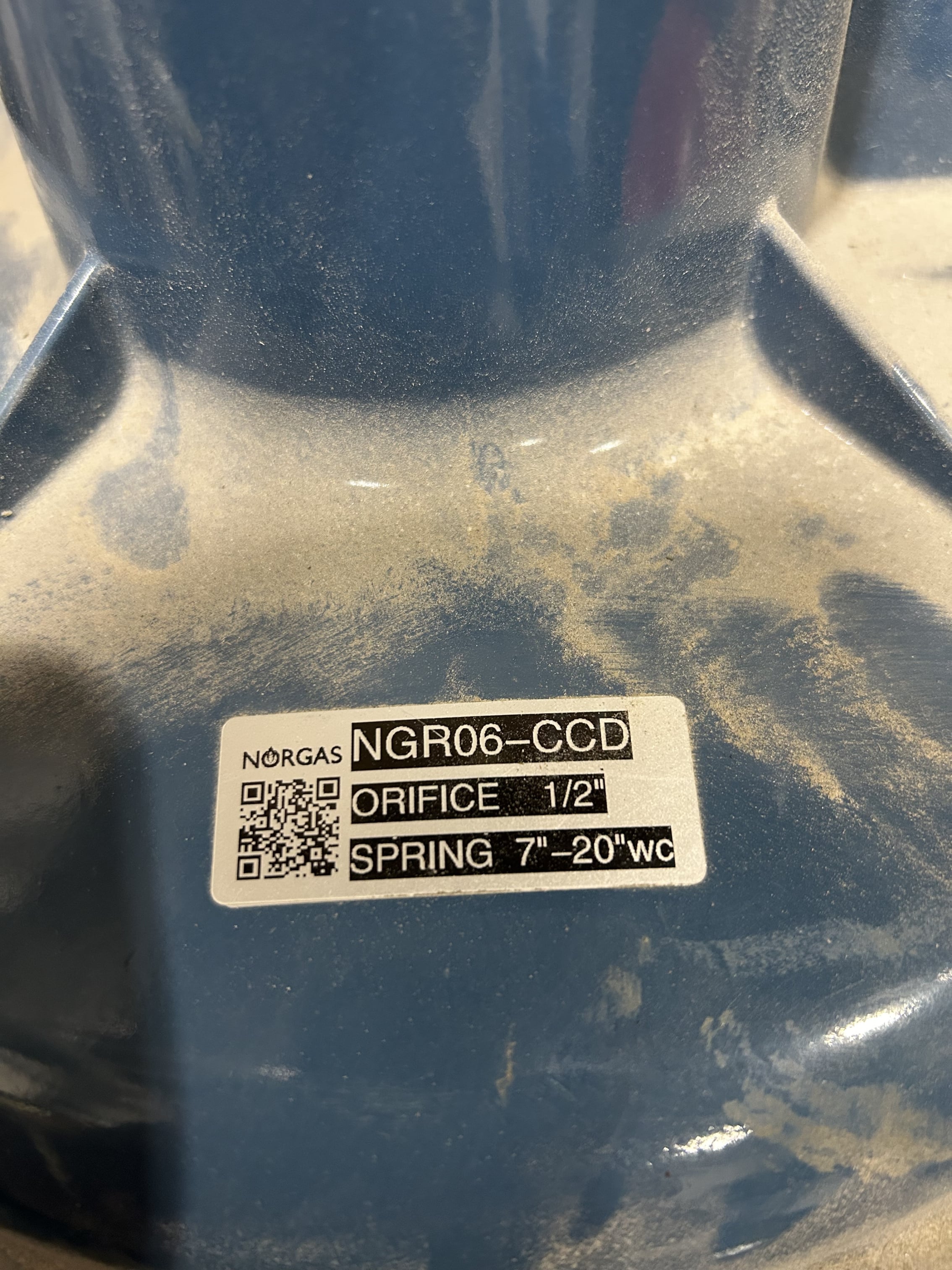

I have an odd problem. I’m working in a commercial building. 10lb gas coming in.
I have 3 sets of boilers in a boiler room and they each have their own regulator. So 3 regs in total. When one or more are firing, the regulator pulses. Almost like hunting. But what’s odd is that all three do it.
Another thing that’s happening is when I take the cap off, it really starts to pulse.
All three regs do this.
however, when I remove the union for the regulator vent, it just pulses like normal.
Regulators are 10lbs to 7-20”
anyone have any experience with a problem like this?

    Is that the correct regulator?

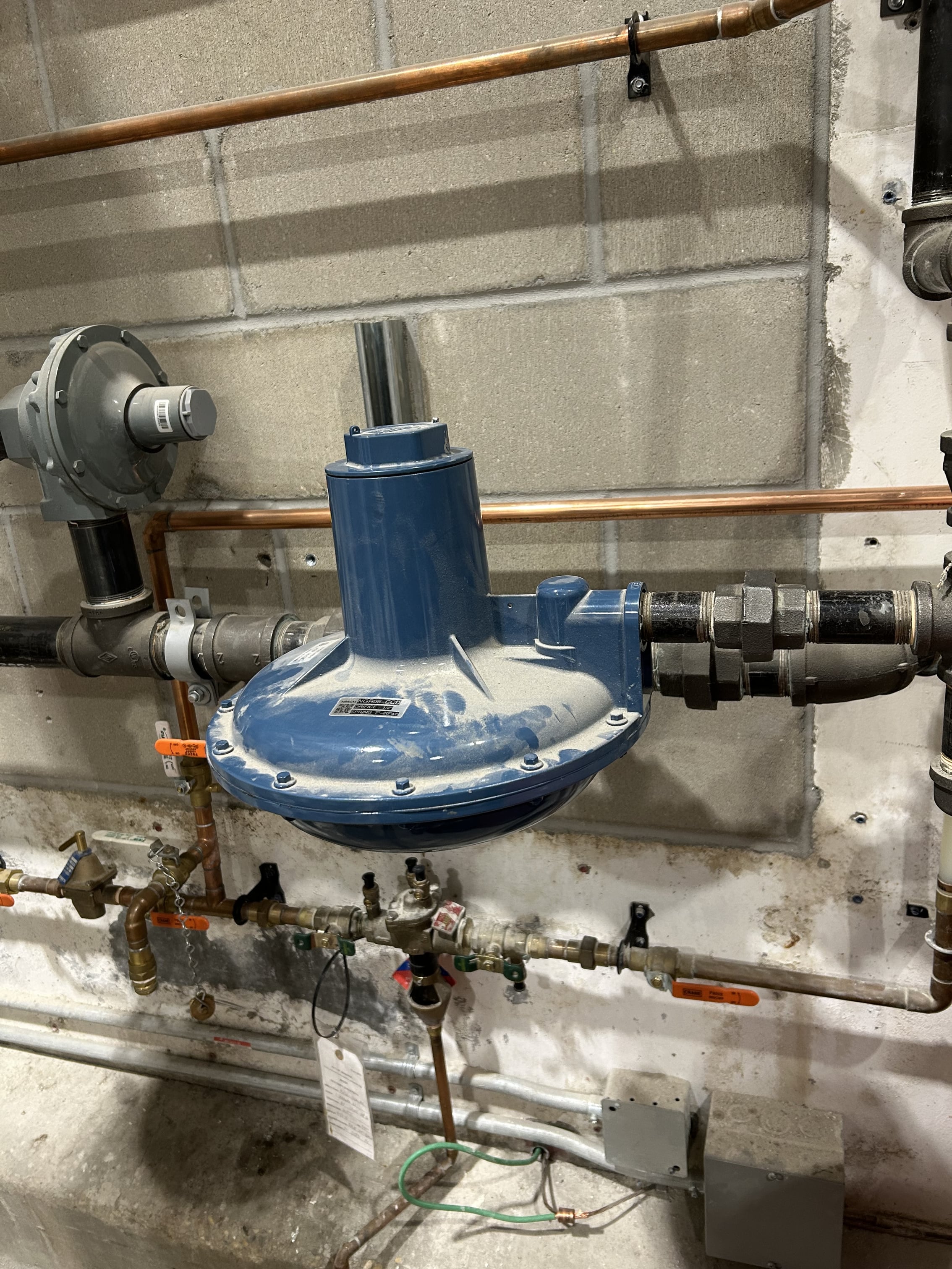

    The more I look at that 1st picture, the more confused I get. A dirt leg with a ball valve on the inlet to the regulator? A dirt leg (with no ball valve this time) on the vent line??

    I dunno if you were replying to me, but I was questioning the ball valve on the dirt leg, not the dirt leg itself. It begs the question: is there a cap on it? It's horrifying to think there might not be. And, how often does the dirt leg need emptied that there's a ball valve on it??

    That is not a dirt leg. It’s a testing port.
    each reg has a shut off up stream to service reg. For some reason it’s further upstream than what you see in picture.
    each vent is individually vented and OPD’s are individually vented.

    Check the orifice size vs maximum load (everything on that regulator firing at 100%) and minimum load (just one unit, whichever has the lowest rate, operating at it's minimum). See where the two points fall in the curve. The orifice might be miss-sized.
    Check the maximum inlet pressures too, you might be able to go up. (outlet pressure may effect the orifice sizing.) I occasionally have trouble with larger MAUs (million+ Btu/H) when they try to regulate 5# down to 8", even though the unit is rated for 5# inlet.

    I see what you're talking about to the left of the big blue regulator on the horizontal run. That's a running trap and does NOT meet code. You must make a 90-degree turn from either below or up> down so any foreign matter falls into the sediment trap while the gas turns horizontal into the regulator or appliance. In this case, I don't think it's really intended so much as a trap than as a suitable means for attaching a psi gauge upstream of the reg. Yes, it certainly should have a cap.
    Some regulators do not use a gravity ball vent limit so they can be multi-poise. However, regs. such as the ubiquitous Maxitrol 325 series can be used outdoors sunnyside-up as long as you replace the vent limiter with their blue plastic umbrella shield. Still not bulletproof. You can always just extend the vent however far and use an ell with the screen facing downwards so it doesn't freeze up or catch a bunch of water.
