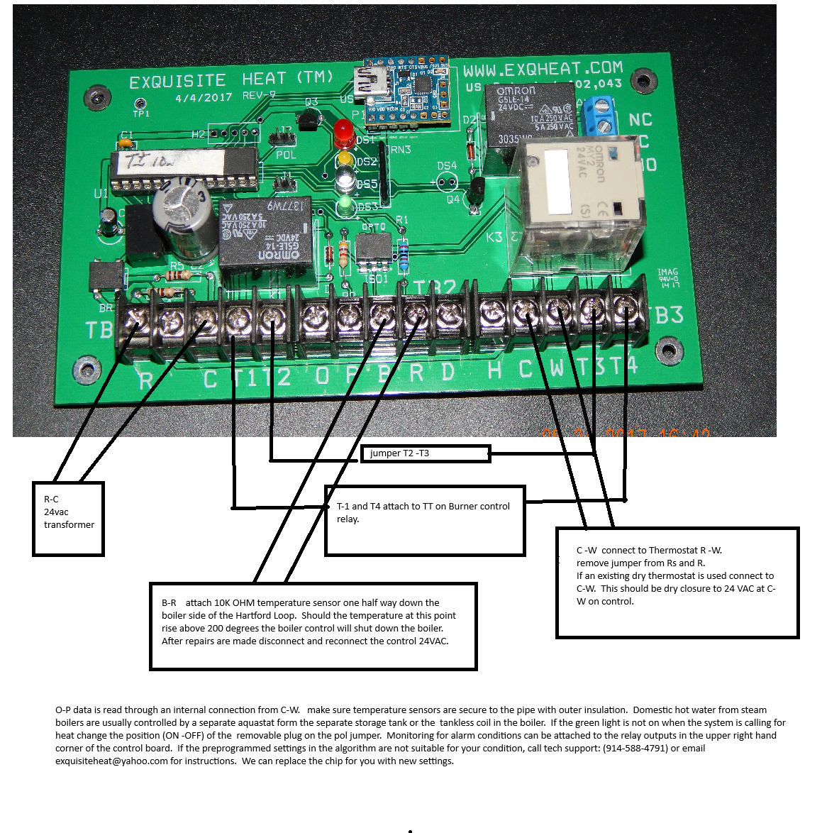

    We use a teriiary method. On steam boilers we efeel the danger can be recognized by a high temperature in the lower half of the Hartford loop piping back to the boiler. If the low water fails, the water level will go low, the return water will stop comming throuh the hartford loop, and the drip line will increase the water temperature in the hartford loop (boiler side). If this temperature goes above 180 degrees, the control cut out yeh boiler. This boiler cannot be refired with out a control reset. That is known to the installer.

    Is that an off the shelf product or a custom build ?
  • exqheat
    exqheat Posts: 229
    Off the shelf.
