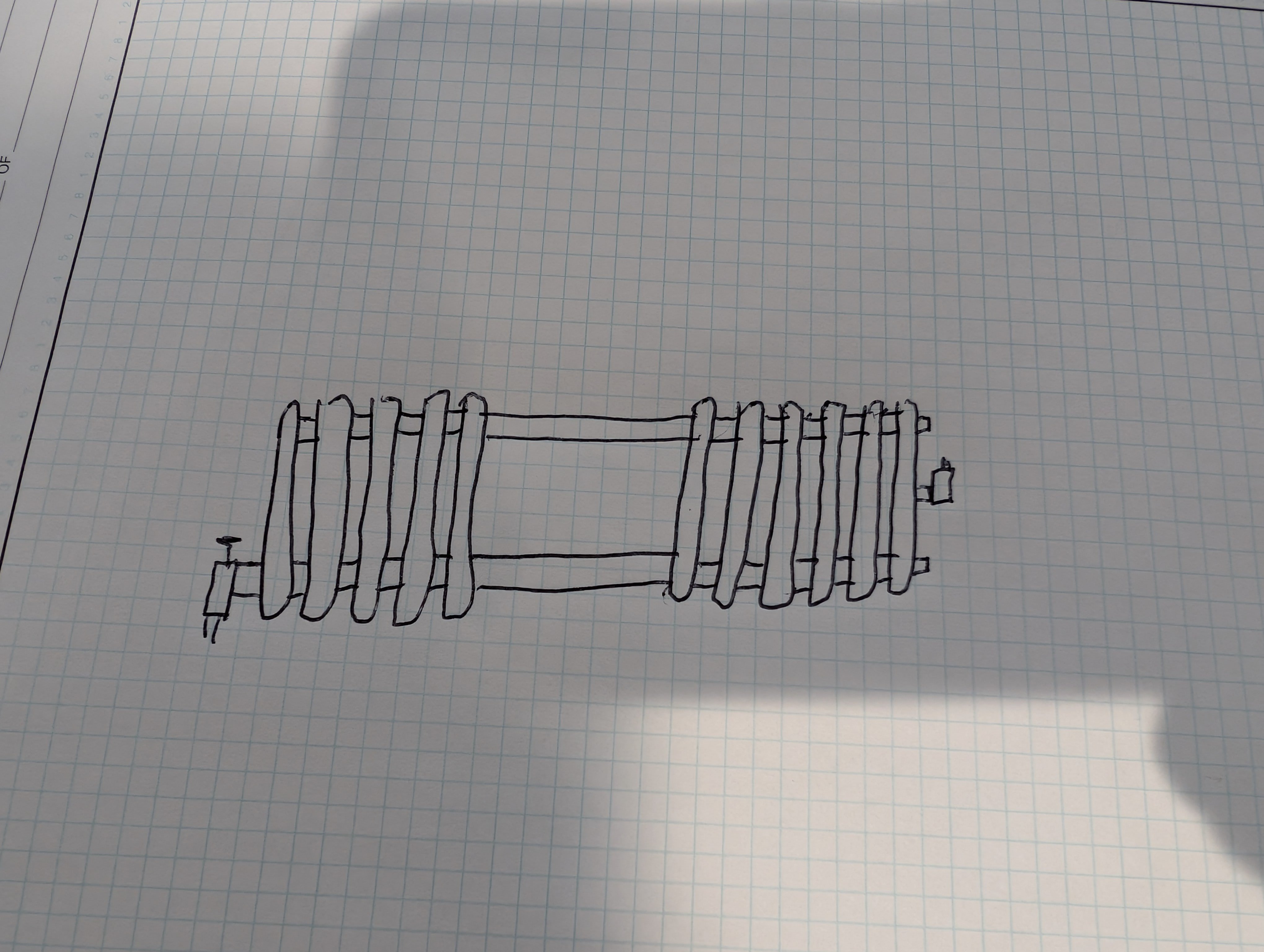

I have a client who is asking me to add a radiator within his bedroom as the current radiator which is located on an opposite wall of a very large bedroom is not adequately heating his space in the giant walk-in closet. There is a radiator already located in there I’m curious if there’s any negative implications if I were to remove the 2 inch plug at the bottom of the radiator located in the closet and extend a pipe utilizing proper pitch into the next room which would be his bedroom and add a second radiator ultimately placing these radiators piped in a series fashion is that possible

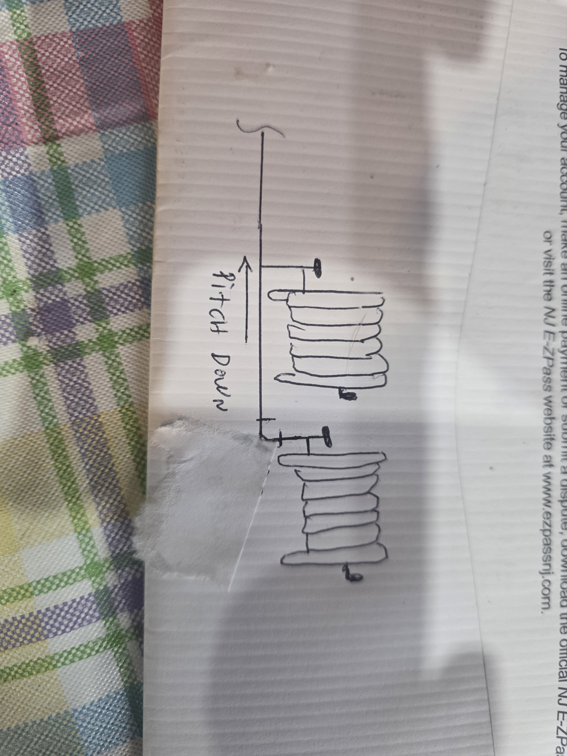

    Curious, could there be an arrangement utilizing a single supply valve where they could be joined in parallel so to speak? Basically split at the inlet valve, piped around behind the first radiator with slope to the second radiator which would have to be set on some amount of blocks to maintain pitch on the supply pipe. I have never seen it but if the current supply pipe size is large enough to support the two radiators could it work?
    Yes that could be made to work, @dabrakeman . The trick — I'm assuming single pipe here — would be to get the balance right, and might take some fiddling with the vents. The other thing to watch out for would be not exceeding the EDR capacity of the riser and any runouts

    I would think it would work unless it is too long to pitch correctly
    I don't see why it wouldn't work — if pitched as @EBEBRATT-Ed said and the riser and runous were big enough. But… it would like a little odd.

    @DanHolohan didn't elaborate because presumable he wanted tlaosh to not be a 10 volume set, he simply says that the condensate in the first radiator keeps the steam from getting in to the second radiator.
    I think what is happening if i try to think like steam is when the steam fills the first radiator down to the far outlet where the second radiator is connected, it encounters the condensate in the bottom of the radiator and that for the most part stops the steam there, it doesn't follow the pipe across.
    I think that @ChrisJ 's connecting to and bottom would work. the textbook way is to run a lateral that tees up to both radiator between the legs of or behind both radiators with pitch back to the riser.

    Think about it....most residental supply piping is max 1 1/2" for a large radiator which is sized for it., more often its 1" or 1 1/4" Now you want to add another radiator off that same supply....its overloaded. That being said, if the supply is large enough AND you have plenty of plenty, Chris J's depiction will work fine. Mad Dog

    the sketch in tlaosh shows them connected end to end at the bottom which I think won't work for the reasons I stated above.

    We have done it several times. Not good practice, and there are a number of issues that negatively affect this, but it has worked where we've done it.
    As some above have said, you need the proper sizing and pitch of the supply pipe. You also must understand that the standing condensate in the first radiator will dramatically condense the steam passing over it into the second. And the condensate will cool both radiators. That can cause hammering, a cold radiator, wet steam or spitting vents.
    Like most things steam: You can try it and maybe it will work. Maybe it will work in mild weather only; maybe it will work in cold weather only. Maybe or maybe not it will be balanced. Sometimes. Maybe it won't work at all.
    Proper practice assures a consistent, well operating system. Anything less than that invites problems.

    EdTheHeaterMan Posts: 12,948
    And we are still asking if it will work anyway. I have this better idea where we don't use pipes to connect the radiators. We just imaging that the steam will get to the next radiator. What if I draw you a diagram of how it might work. That will make it happen. Right?
    Try it and tell me how it works out for you. I would like to know
