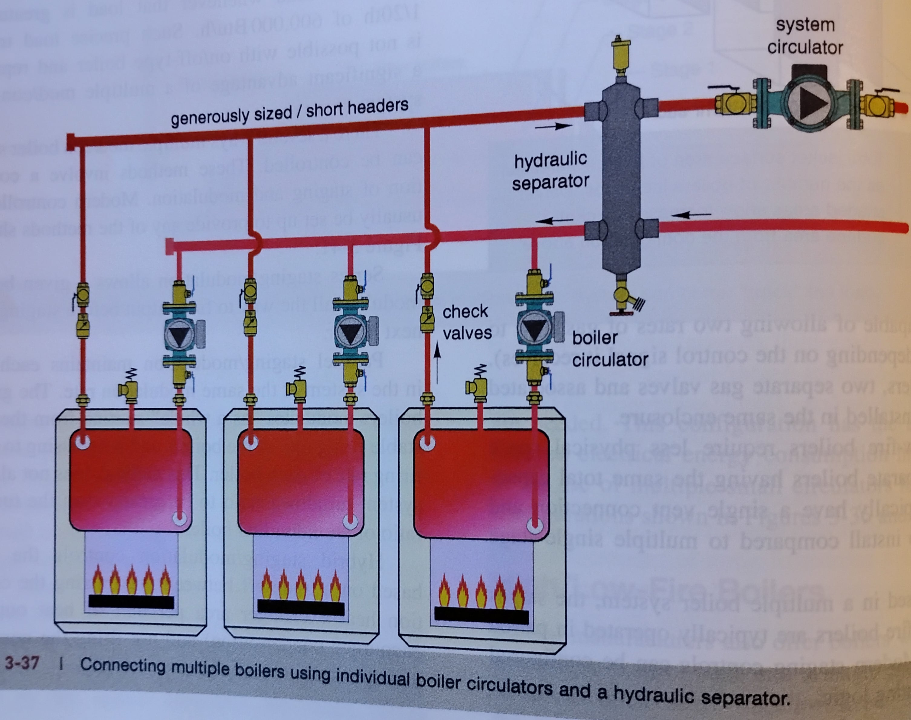

    Not a heating pro, just a homeowner/mechanical engineer. But we have a somewhat similar situation in a 4-unit condo building with two boilers that we would like to eventually tie together in a primary/secondary arrangement to heat the entire building (vs current split where one boiler heats one half of the building).
    You don't say how far north you are or how old the building is, but here in the Boston area, a typical 100-year-old multi-family would need maybe 20 BTU/hr/sq ft. Let's add some hallway space to your habitable square footage and say 7000 sq ft total. 7000 x 20 BTU/sq ft = 140,000 BTU/hr. Or worst case with leaky windows, 30 BTU/hr/sq ft = 210,000 BTU/hr.
    So (depending on your exact heat loss) you could maybe do 2 x 100MBH boilers piped primary/secondary with staging control. Most of the time you'll probably be running only one boiler.
    Here's one way to pipe it, from John Siegenthaler's Modern Hydronics, using a hydraulic separator. This shows 3 boilers, but as others have said, you probably only need two. This is how I'm hoping to re-pipe our two WGO-5 boilers.

    And if I were to do multiple boilers, I would also agree to pipe them primary / secondary and stage them in some way to operate only as needed.

    OK, so an older apartment building in Pittsburgh area, maybe 14,000 sq ft with hallways/lobbies added in? Could be under 20 BTU/hr/sq ft if not terribly leaky. So 280MBH total?
    Still doable with 2 x 150MBH output boilers, or 3 x 100MBH output. You will get somewhat better overall efficiency with 3 smaller boilers vs 2 larger. If the owner is willing to pay for 3 smaller, that may be the way to go.
    If you go with a cast iron boiler you'll also need return water temp protection/bypass with that high water volume system to prevent flue gas condensation. The single zone for a large building means you will be flooding a relatively small boiler with a massive volume of cold water on cold starts.

  • gpjazz
    gpjazz Posts: 106
    Thanks for the replies so far.
    To confirm, this is not steam. It is a single zone hot water system in an apartment building.
    And the plan is to remove the old large boiler and install 3 Weil McLain 133,000 btu boilers instead. Obviously these will all be located in the same "boiler room".
    But do all the same rules apply since they are smaller btu capacity ?
