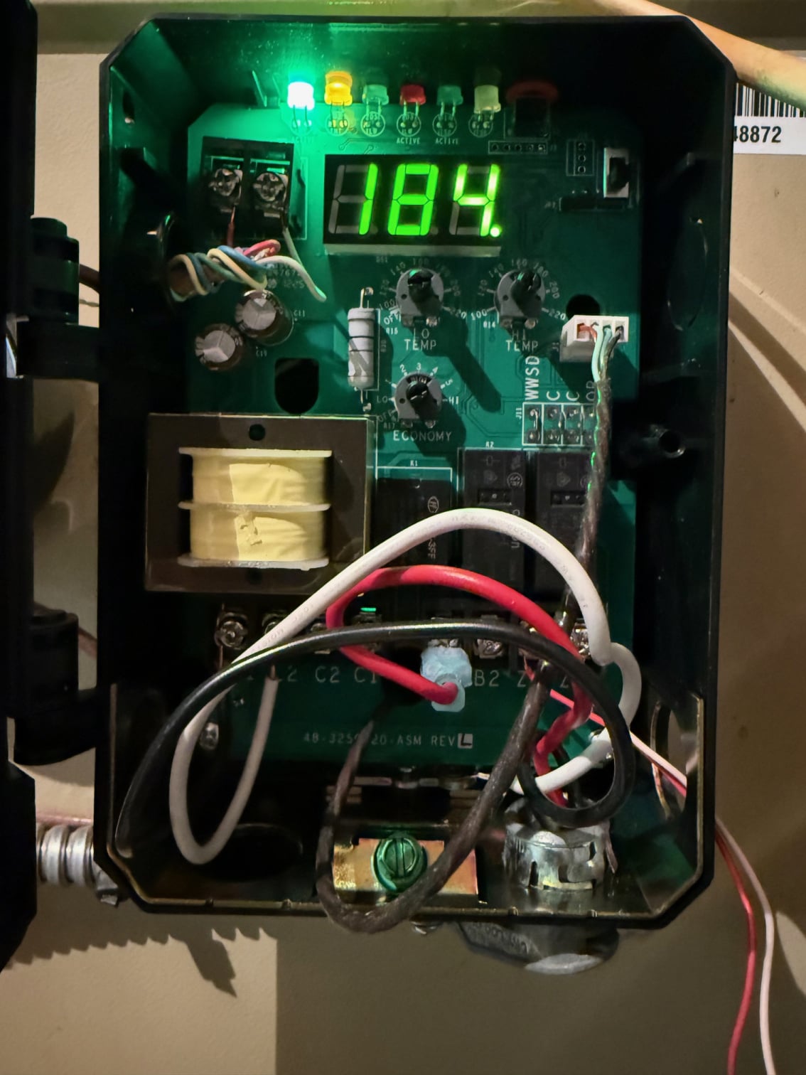

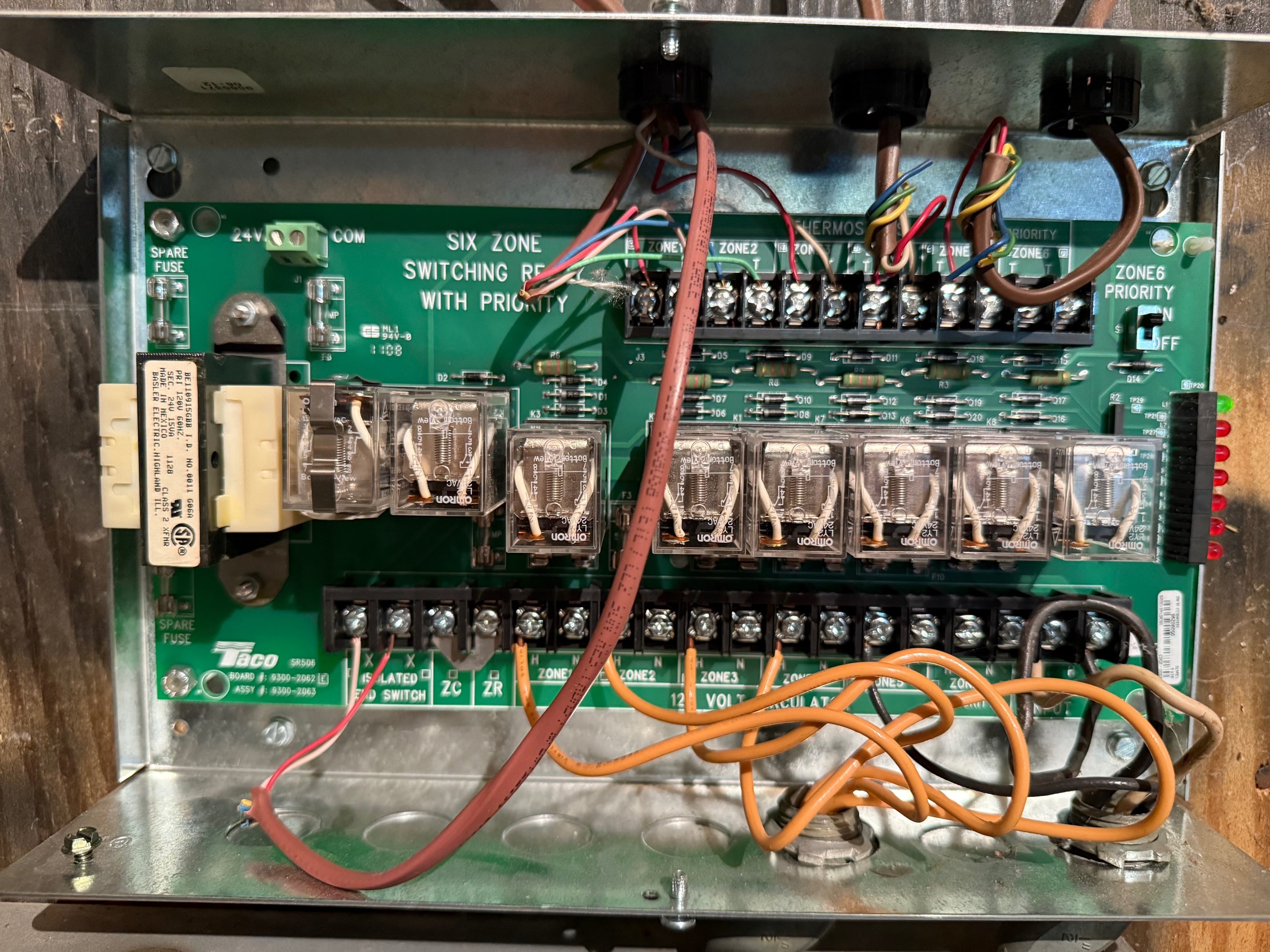

    Thanks for the reply. I was very careful to replace each wire exactly as on the original Hydrostat. Pic of both the Hydrostat and Taco….

    I'll try your recommendation though I was VERY careful with the replacement making sure each is correct and tight as was. I disconnected the ZC/ZR wires and this did turn off the call for heat dot on the Hydrostat. That wire goes to the Taco DR501 switching relay (indirect hot water) a separate unit from the Taco SR506 zone pane. On the SR506, zone 6 thermostat terminals are not connected to anything which I believe is that panel's indirect water thermostat.

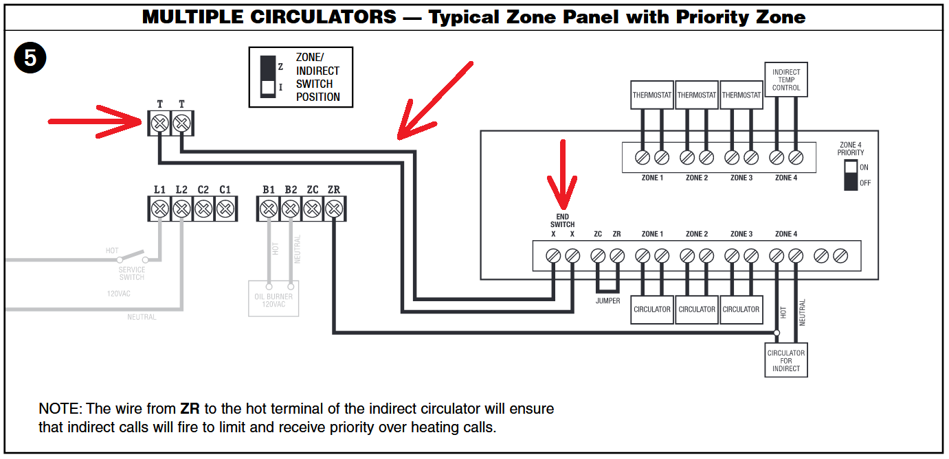

    In your picture ZC/ZR has no wires, just a jumper. The Taco SR506 X - X (Isolated End Switch) are the wires that go to the Hydstrostat 3250.
    Remove one or both of these wires, See if the call for heat goes a way.

    Bit confused with this " System is indirect water heat, 5 zone hydronic w/Taco circs. " so you have 5 indirect DHW (Domestic Hot Water) tanks ?
    Or 1 indirect DHW tank and 4 space heating zones.
    109A_5 Posts: 4,790

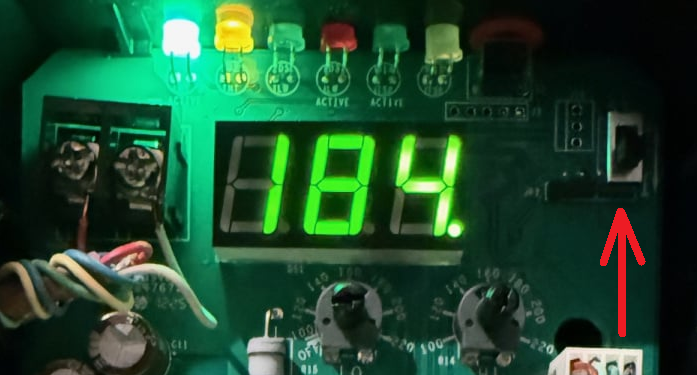

    Is this switch in the same position as the old unit ?
    109A_5 Posts: 4,790
    No unintentional connection between these smaller Red and White (ZC/ZR) wires ?

    First, there are wires going to ZC/ZR but that's not what's circled in your picture. You circled TT terminals which I agree comes from the Taco SR506 terminals X/X. I disconnected 1 of the terminals (low voltage) live and it did not eliminate the call for heat dot on the Hydrostat. However, when I disconnected the 2 wires going to ZC/ZR on the Hydrostat, that did eliminate the dot. I believe those 2 wires control the indirect hot water Taco SR501 single zone control.
    In the Taco SR506 6 zone controller, there are no wires to the Zone 6 thermostat which is the priority thermostat used for indirect water. There's no wire from the lower section zone 6 for the circ pump either. There is a jumper between ZR/ZC.
    Near the indirect water storage tank is a Taco SR501. I'm wondering if the SR506 ZC/ZR is going only to the SR501, never touches the SR506 and the issue keeping the dot on is coming from the single zone SR501. ??

    Good question, the answer is no because for some reason, it was set for zone and not indirect though the house has indirect water heating. Should I switch it back to zone?

    Turns out the SR501 single zone hot water has it's own power switch. When I turn that off, the Hydrostat dot turns off leading me toward the indirect hot water SR501 or hot water storage tank thermostat. On the SR501, I removed the R and W wires. Reading online that if the red line turns off after removing those wires, it's likely the thermostat which is a Residio L 4080 B 1352 that continuously is calling for hot water. Any ideas how to troubleshoot the thermostat?

    is the I / Z switch now in the same position as the old unit ?

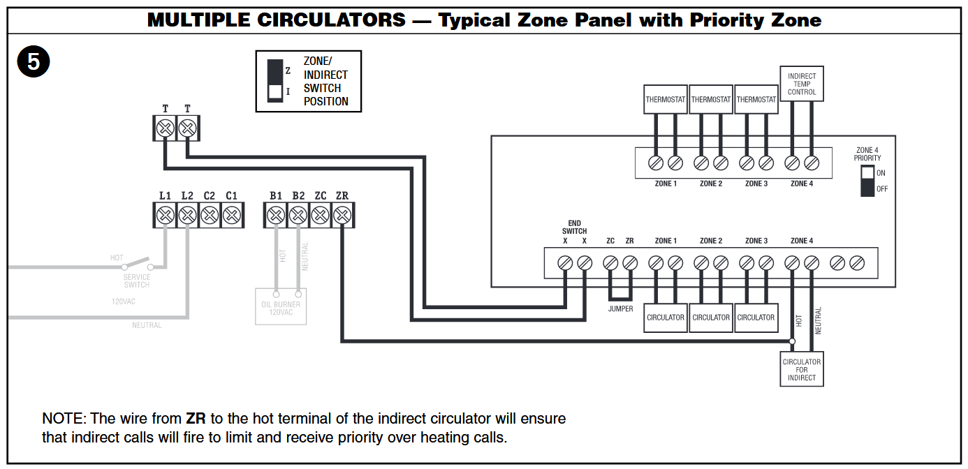

    HVACNUT Posts: 7,815
    This is the wiring that should be used. XX in the SR506 to TT on the Hydrostat. ZR/ZC on the Hydrostat to 5/6NO on the SR501 for the water heater.
    The wires on the aquastat for the water heater should go to TT on the SR501.

    It’s wired exactly as you mentioned which leads me back to the aquastat thermostat on the IHW holding tank. When those wires are disconnected from the SR501, call for heat dot turns off on the Hydrostat temp control.

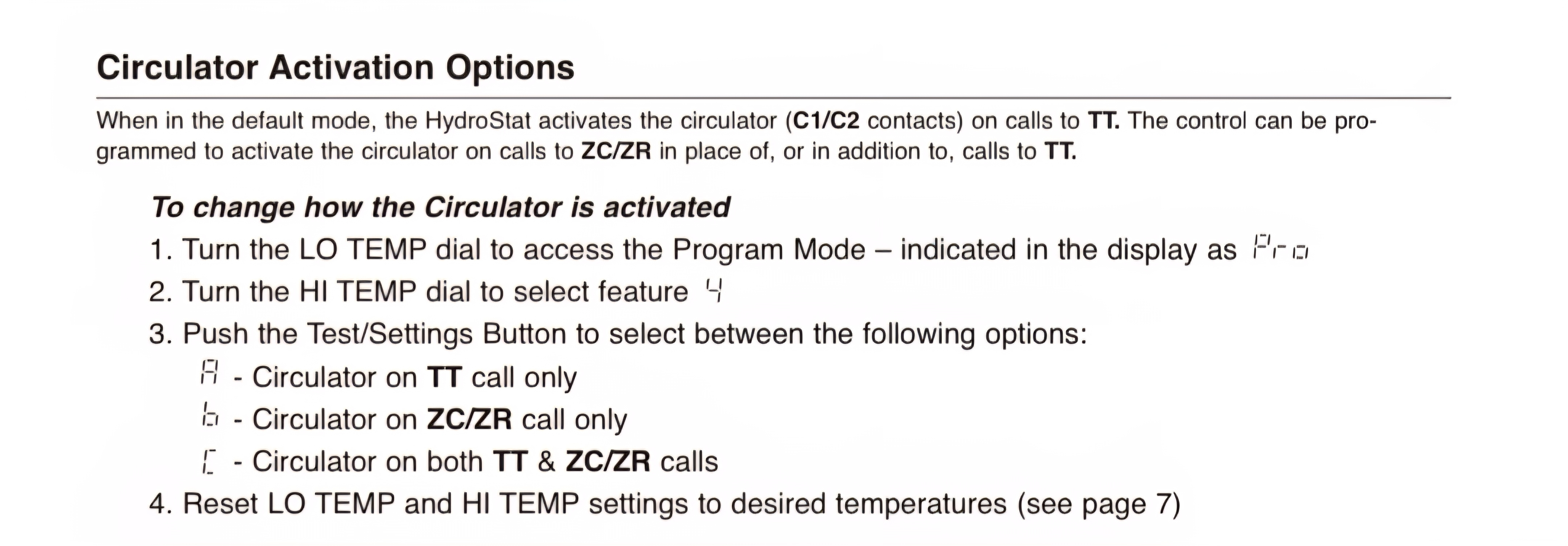

    Got it, my confusion is that the Hydrostat can shut off the heat circ pumps but it only adjusts the high temp based on demand, correct? So in warmer months, it would set the high temp lower and opposite in colder months. Only the zone control can turn off the heat circ pumps and funnel only to the HWP based on demand. And since my system is using a single zone control (SR501-4), there is no priority possible in the current setup. Do I have that right?
