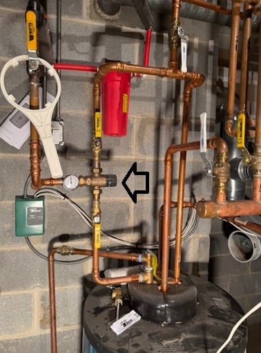

  • BG9696
    BG9696 Member Posts: 14
    Yes there appears to be a mixing valve though I can't see a cold water line going to or through it. Here's a pic. The high temp setting on the tank thermostat has been set to 140 which seems fairly standard. The high temp setting on the boiler Hydrostat is 180, also standard for the house heating.
  • GGross
    GGross Member Posts: 1,889
    the pipe connected at the top of the valve as we view the picture is the cold line, the line coming out the side as we view it, with the gauge is the mix out. looks pretty normal overall at a glance, I would be investigating the aquastat
