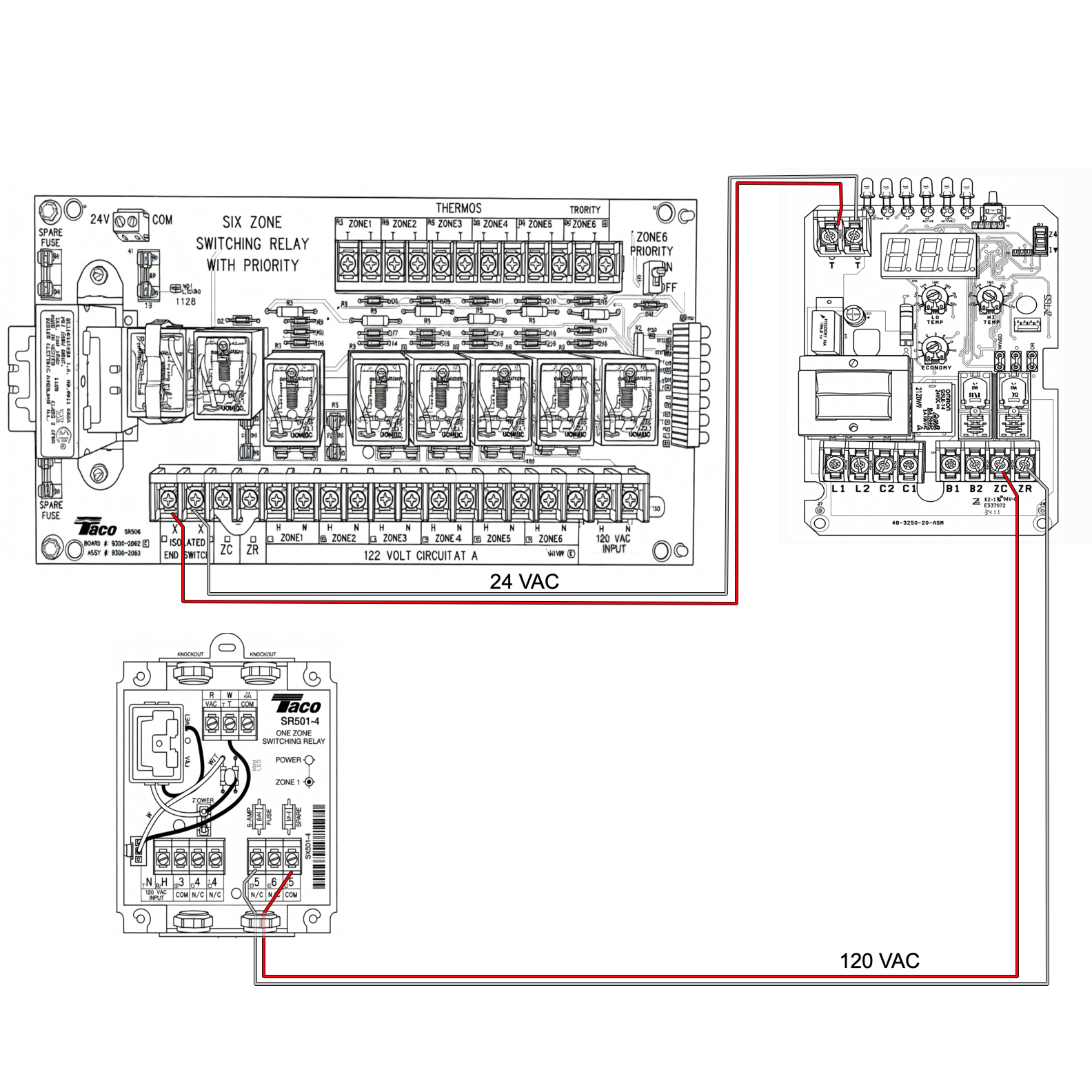

System is indirect water heat, 5 zone hydronic w/Taco circs. I recently had a leaking valve replaced in my boiler system. After, the burner was failing to trigger. The HVAC guy mentioned he noticed the Hydstrostat 3250 temp control showed fluctuations in the temp and suggested replacing it which I did. This should be an on-demand system letting the boiler stay off until there's a call for either heat or hot water but now it's running the boiler at the set 180 deg high and trigger back on at approx 30 deg lower (155-160) bringing it back to 180, wasting oil which at the moment for obvious reasons, don't want to do. The Hydrostat continuously shows a dot bottom right of the current temp indicating a constant call for heat or hot water. I check/tightened all connections on the Taco SR506, turned off power and checked the removable relay "ice cubes" (all except the 120V one) and still shows call for heat. Turned off and physically removed all the basic Honeywell thermostats, still shows call for heat. After replacing the temp control unit for $230, I don't want to replace the Taco SR506 unless I'm sure this will cure the problem. Any & all suggestions would be greatly appreciated!

    a pic of how you have the taco wired, and the hydrostat wired, might help. sounds like you have something wired wrong at the new hydrostat
    109A_5 Member Posts: 3,993
    Sounds like this is a new behavior since the Hydstrostat 3250 was changed.
    If all the heat demands are through the Taco SR506 and when the Taco SR506 has no active demand for heat yet the Hydstrostat 3250 acts like there is a demand for heat, I would suspect the wiring from the Taco SR506 to the Hydstrostat 3250 was inadvertently changed (or corrupted) causing the " indicating a constant call for heat or hot water ".
    I would completely inspect the wiring path between the Taco SR506 X - X terminals and the Hydstrostat 3250 T - T terminals. With the replacement work done maybe the two wires were crushed together somewhere.
    Also a test of the Hydstrostat 3250, with the power off, disconnect one of the Hydstrostat 3250 T - T wires then restore the power see it the call for heat has ceased.

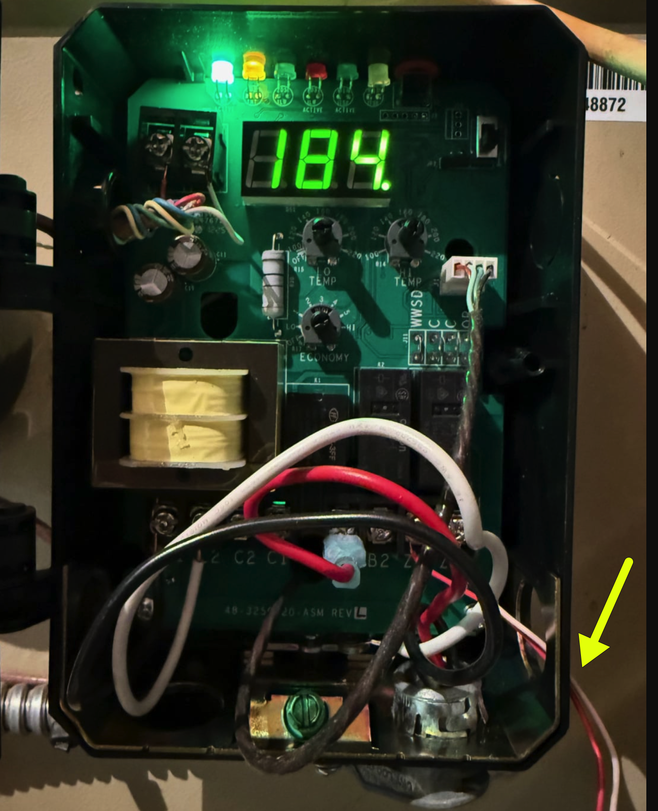

    Thanks for the reply. I was very careful to replace each wire exactly as on the original Hydrostat. Pic of both the Hydrostat and Taco….

    I'll try your recommendation though I was VERY careful with the replacement making sure each is correct and tight as was. I disconnected the ZC/ZR wires and this did turn off the call for heat dot on the Hydrostat. That wire goes to the Taco DR501 switching relay (indirect hot water) a separate unit from the Taco SR506 zone pane. On the SR506, zone 6 thermostat terminals are not connected to anything which I believe is that panel's indirect water thermostat.
    In your picture ZC/ZR has no wires, just a jumper. The Taco SR506 X - X (Isolated End Switch) are the wires that go to the Hydstrostat 3250.
    Remove one or both of these wires, See if the call for heat goes a way.

    Is this switch in the same position as the old unit ?
    No unintentional connection between these smaller Red and White (ZC/ZR) wires ?

    First, there are wires going to ZC/ZR but that's not what's circled in your picture. You circled TT terminals which I agree comes from the Taco SR506 terminals X/X. I disconnected 1 of the terminals (low voltage) live and it did not eliminate the call for heat dot on the Hydrostat. However, when I disconnected the 2 wires going to ZC/ZR on the Hydrostat, that did eliminate the dot. I believe those 2 wires control the indirect hot water Taco SR501 single zone control.
    In the Taco SR506 6 zone controller, there are no wires to the Zone 6 thermostat which is the priority thermostat used for indirect water. There's no wire from the lower section zone 6 for the circ pump either. There is a jumper between ZR/ZC.
    Near the indirect water storage tank is a Taco SR501. I'm wondering if the SR506 ZC/ZR is going only to the SR501, never touches the SR506 and the issue keeping the dot on is coming from the single zone SR501. ??

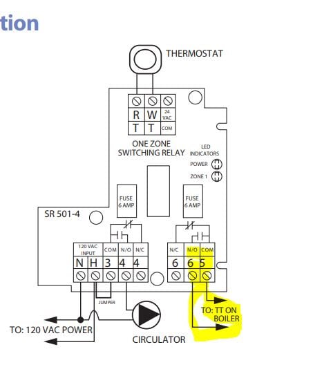

    This is the wiring that should be used. XX in the SR506 to TT on the Hydrostat. ZR/ZC on the Hydrostat to 5/6NO on the SR501 for the water heater.
    The wires on the aquastat for the water heater should go to TT on the SR501.

    The ZC/ZR wires on the Hydrostat 3250-Plus go to the N/O 6 and Com 5 terminals in the single zone DHW Taco SR501. The R & W wires in the SR501 go to the tank thermostat. When disconnected from the SR501, the call for heat at the Hydrostat turns off. This is why I suspect the thermostat attached to the Burnham Alliance SL35 HW holding tank.

    depending on which exact sr501 you have its not wired correctly to the boiler, RW are for your thermostat to wire into
  • BG9696
    BG9696 Member Posts: 20
    My apologies and of course you are 100% right. I corrected my text that you replied to. The ZC/ZR are connected to the 6 and 5 terminals bottom right on the SR501 and the R/W are connected to the thermostat which when disconnected, turns off the call for heat on the Hydrostat temp control at the boiler.

    I could not help but notice that you have a 120 VAC circuit wired with 18-2 thermostat wire
    The wires from your SR501 number 5 and 6 terminals are connected to ZC and ZR on the Hydrostat. I believe those Hydrostat terminals are 120 VAC. Check with a meter and replace with the proper wire if needed.

    The SR501 does not have any control on what toy connect to the relay contacts. The 5 and 6 can be used to connect to the T T on the Hydrostat and that would be a 24 VAC circuit. Where i see the problem is that the 5 and 6 on the Taco SR501 is connected to ZC and ZR on the Hydrostat. I am sure that ZC and ZR are 120 V to operate the burner circuit on an oil fired boiler. I'm talking about the wires that are connected to ZC and ZR in this photo where I have the yellow arrow
    The T T terminals from the Hydrostat are connected to X X on the SR601. Even if I am guessing incorrectly, regardless the wires on ZC and ZR should not be 18 Gauge thermostat conductors.
