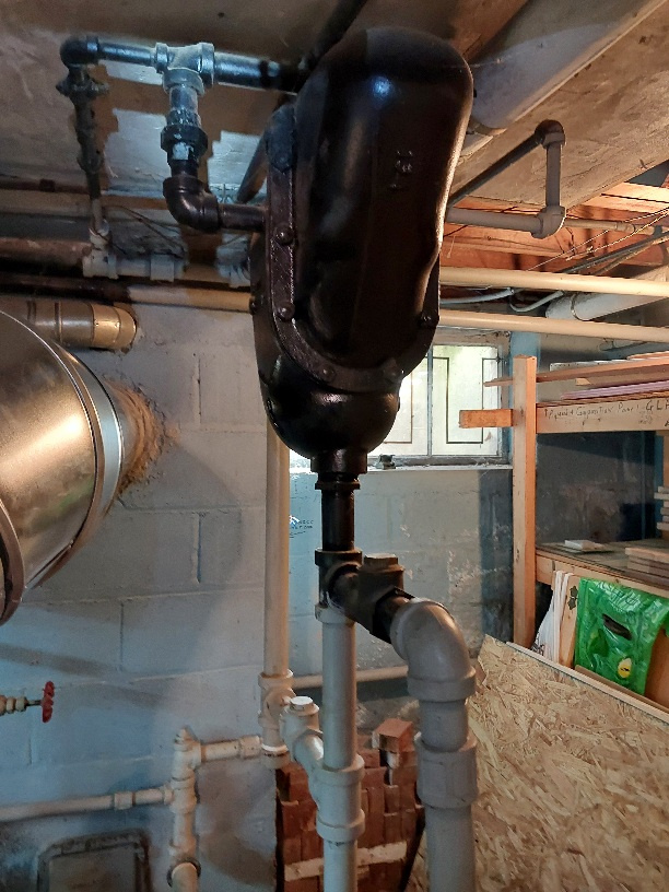

What is this?
Doing a steam boiler install and my co worker asked what this is. I said "no idea lol". Its a two pipe system and this is at the end of the re
turns.

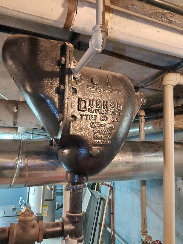

    Dunham Return Trap for Dunham vapour steam system. It's in The Lost Art — look it up.
    That system should be controlled with a vapourstat running at a cutout of 8 OUNCES per square inch or less.

    If you sized the boiler correctly it shouldn't get to 1.5 psi, so it shouldn't matter. The vaporstat or pressuretrol are pressure safeties. On 2 pipe the sizing is extremely critical, I feel it's critical for all systems, but the 2 pipe are typically more sensitive to pressure, which is a function of boiler sizing. How did you size the boiler?
    I agree with Jamie though, it should have a vaporstat to ensure it doesn't have a chance of getting out of hand.
    2014 Weil Mclain EG-40
  • So yeah I would LOVE to install a vaporstat, but the salesman won't want me to get a $500-600 part for this. Also the salesman sized this boiler- you guys are gonna love this- "the old one was this size so I got the same size boiler for this zone". Theres a lot of things I can see wrong with this install, but unfortunately I was told to just "slap in it exactly how the old was was". Im beginning to realize that the company i work for is the "knuckleheads" the Dan Holohan warns homeowners about lol.
    You ask the consequence of running the boiler up to 3 times the desired pressure.
    It won't heat as evenly (and indeed may be difficult or impossible to get anywhere near balanced). It may use more water than it should. Components such as radiator traps and the main vents will fail much sooner. It will use more fuel than it should.

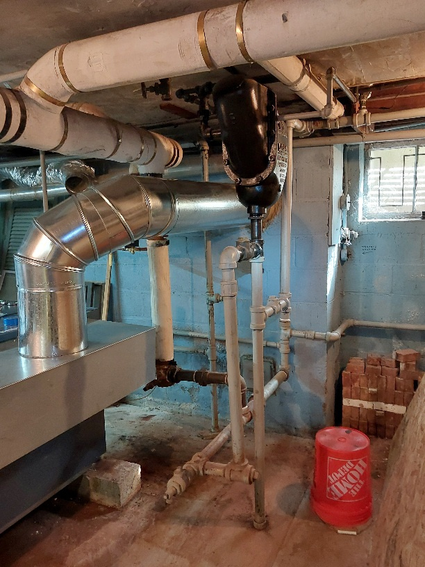

    sort of. 2 pipe in some ways is more forgiving in sizing. you can undersize the boiler somewhat compared to the connected edr and have it still heat the whole system, in fact everything will be much happier with a slightly undersized boiler because it will never build appreciable pressure.
    as for the op, you're going to have a rough time until you at least put the correct controls on the boiler and ideally use the right size boiler.
    it isn't like the return trap and vapor valves on the radiators weren't there when the salesperson looked at it.
    tylerjgardner
    edited March 26
    what boiler was there before? you need to make sure things that need to be below the water line are still below the water line with the new boiler.

  • Thanks for the information guys. Im currently in Syracuse NY (this job is in Auburn NY). We get steam jobs maybe once or twice per heating season. No one knows anything about them in the company I work for, so its kinda up to me to do things correctly. Worst part is, I'm a service tech, but happen to be installing this system. So if things go wrong or dont heat, I'LL be the one that gets called out. The new boiler is the same foot print as the old one, the only difference is its like 10k btus bigger than the old system. So its one section wider. Its a Weil-McLain EGH-95
  • dabrakeman
    dabrakeman Posts: 1,038
    Obviously nobody totaled the connected EDR. Could you do that so we know if or more likely how much it is oversized?
