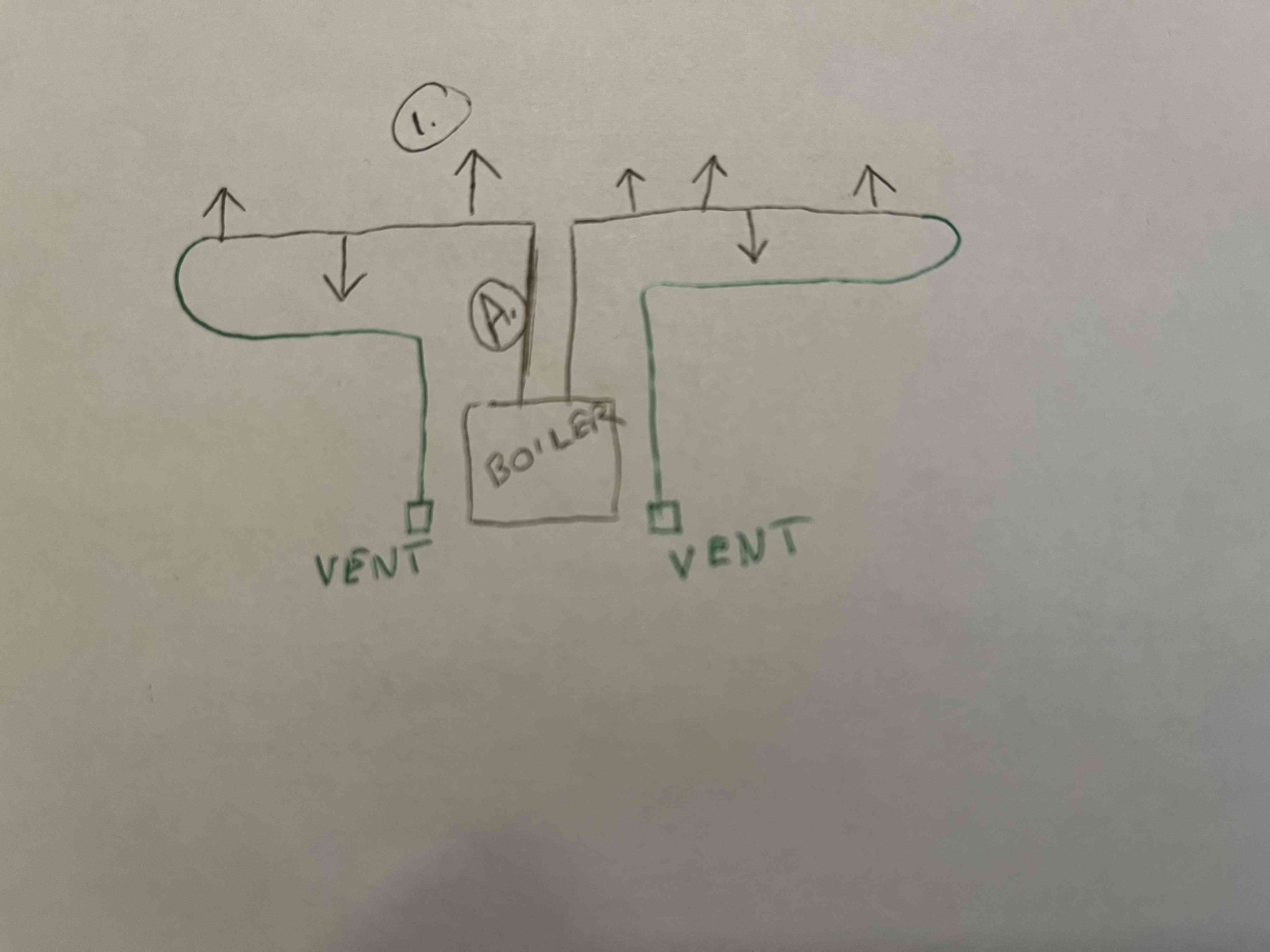

    Finally had a chance to watch things when the heat kicked on with the system completely cold. The bathroom radiator did NOT do the extra rushing air thing, but here is what I observed. Refer to diagram below, black lines are outgoing pipes (about 2.5 inch diameter) and the arrows are pipes going up into the house. The green lines are vertically lower than the black line pipes, and about 1 inch diameter, and wrap back to vents (Vent-Rite 35). The first pipe to get warm was A. After a bit, 1. started to get warm. Eventually, the rest of the pipes got warm, with the returns to the vents taking the longest.
    I could not feel air coming out the vents, but they did get hot. No stethoscope yet to listen.
    I don't know the exact paths of steam pipes up to the radiators. Pipe marked 1. could go to the second floor bathroom where the air rushes out, not sure.
    The problem radiator has a Vent-Rite 11. All the rest have Vent-Rite 1, which is adjustable. They are set to various levels, where i have tried to balance the heat flow as felt .

    How long are those mains shown by the black lines?

    Your Ventrite 11 should have about the same venting rate as the 1's when they are set around 6 or 7. The Ventrite 35's are pretty slow vents for main vents but then again all your radiator vents are fairly slow which may make the 35's sufficient. However, if in your observation steam is not reaching the main vents until after you are already getting air rush noise and heating from that bathroom radiator I would definitely increase the main vent sizes. What is the total length and pipe sizes (note whether you are talking actual OD or nominal pipe size) of your mains and returns from boiler to main vents?
  • klmcc1894
    klmcc1894 Posts: 10
    The left side is about 9 feet, the right about 7.5. The run from the boiler is about 6 feet.

    I'd upgrade your Vent-Rite 35s to Gorton #1 vents. This will vent the mains faster and help to balance the system.
