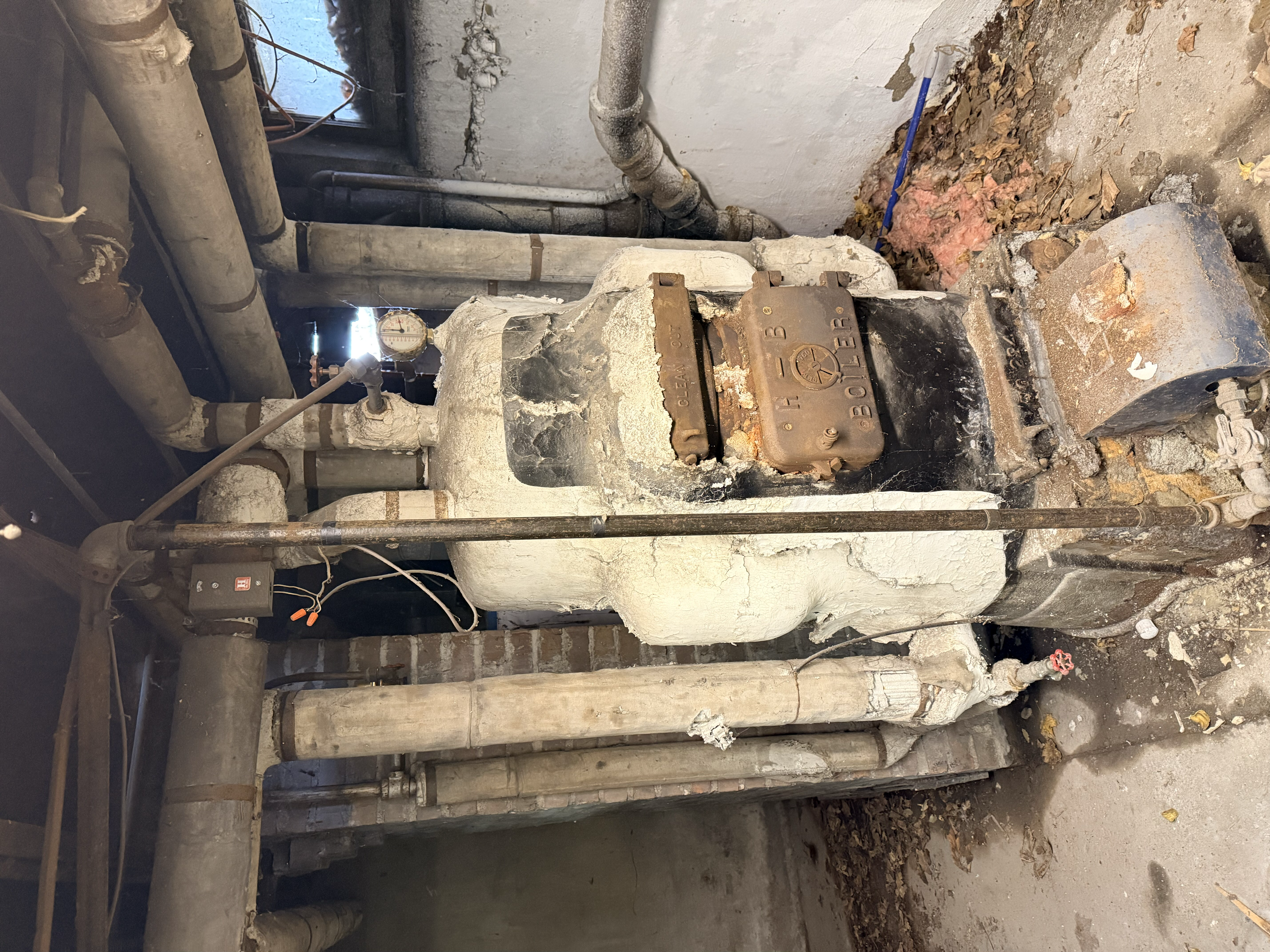

Just leaving this here
New York state
    Some things are just better left alone…

    Still in service?
    Steamhead Posts: 19,007
    That was made by the H.B. Smith Co, back before it was mismanaged out of existence.

    Unless someone is paying the full boat 🚢 for a serious abatement.....leave it be....Mad Dog
    HVACNUT Posts: 7,784
    Its definitely all or none.

    unknown, house was vacant for 10 years until my god son bought it.

    Looks like gravity hot water.
    I would love to see some of the radiators that are there.
    Looks like a gas system. Would be a great fit for a Mod Con gas boiler.
    it might work if you can encapsulate enough asbestos to fill it and clean up and light the conversion burner. i guess that is kind of a big cost to find out if the boiler is leaking or not. then you need to inspect especially the chimney to see if it is safe.
    It is gravity HW. Strap on aquastat, Altitude/pressure gauge

    I've done similar replacements, twinned 2 navien fire tube boilers in my house. two pumps with check valves so I could zone it north, south.

    "It might work if you can encapsulate enough asbestos to fill it and clean up and light the conversion burner. i guess that is kind of a big cost to find out if the boiler is leaking or not. then you need to inspect especially the chimney to see if it is safe."
    twenty years ago I would of thought about adding modcon boilers and keeping old boiler and building fire box and converting to wood fired.
    More worried about radiators.
    the system itself should be fine unless it froze
