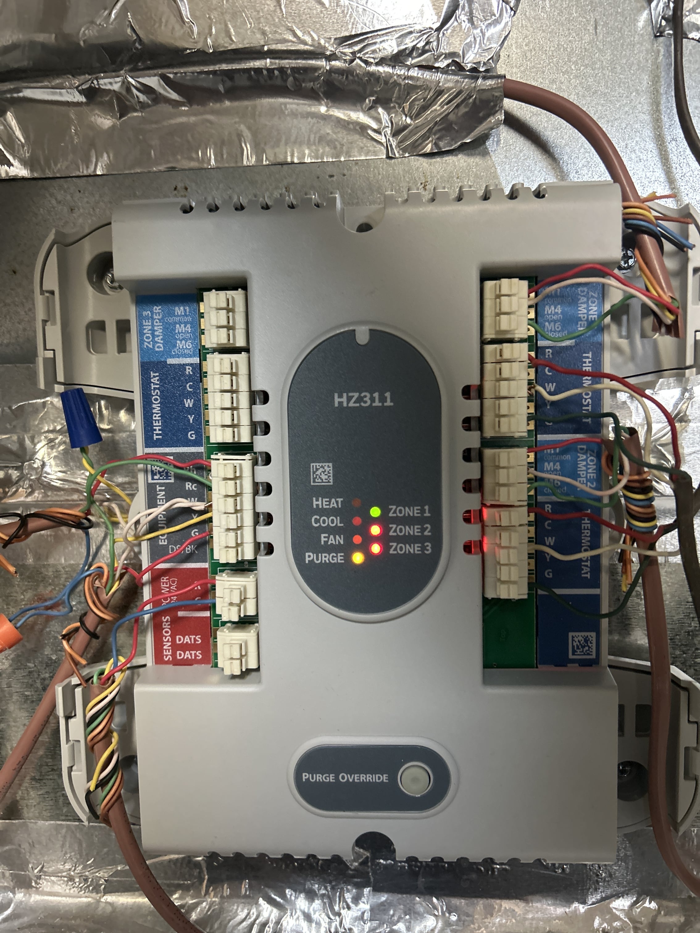

    Can you post pictures of thermostat wiring and zone board?

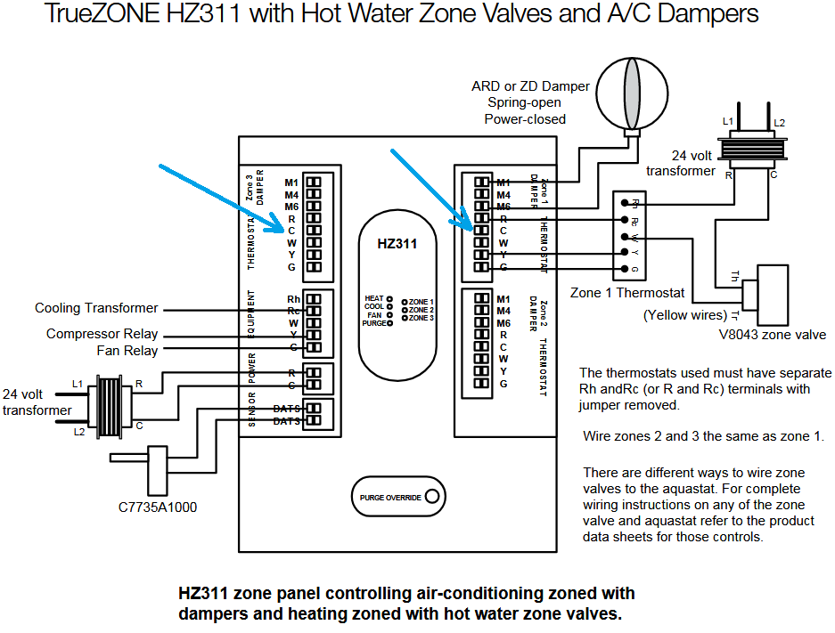

    109A_5 Posts: 4,759
    If you have full control (On - Off) of the heat at the thermostat's location by touching the wires R & W wires, I would definitely use (connect) the C wire on the thermostat and the HZ311. You may not need the G connections unless you want (need) fan control. Depending on the thermostat the Rh and Rc may need a jumper.
    The C wire provides constant 24 VAC power to the NEST.

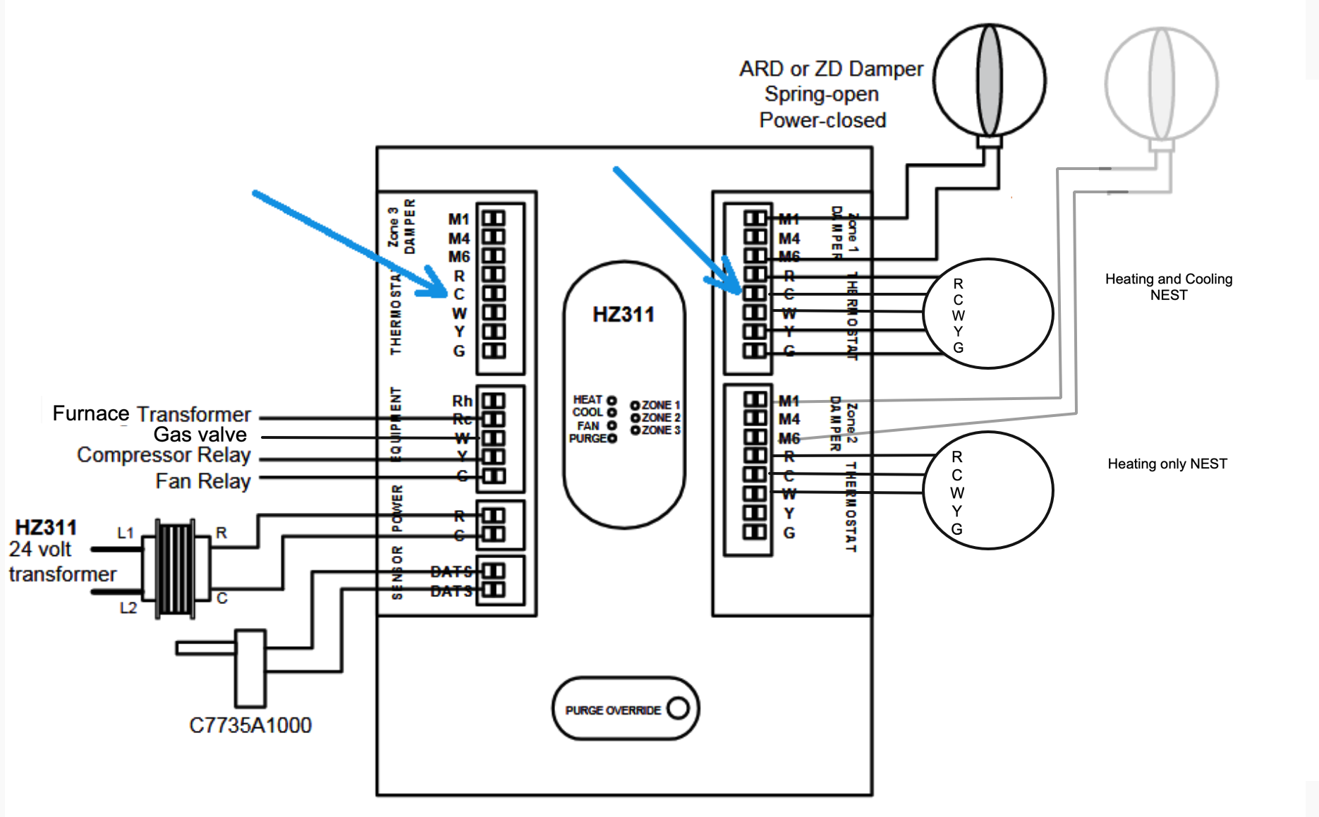

    EdTheHeaterMan Posts: 12,948
    first thing @briandonahue1800 says: "I have a gas fired furnace system in a customers house"
    And I do not see any mention of a boiler or a zone valve. so Where did that come from @Jamie Hall and @109A_5 ?
    Ok from what I am reading here Brian, has a customer where you have R W and G connected to the old thermostat. The G wire us used to operate a fan on switch or a fan when the heating or cooling circuit is controlled by the thermostat. (on a gas furnace the furnace operates the ductwork blower fan and the G wire is not needed.) When you decided to use a smart thermostat you need to free up a wire in order to use it as a C or common wire.
    The Nest thermostat should be wired R from HZ311 Zone thermostat to the R on the NEST. The W from HZ311 Zone thermostat to the W on the NEST. Finally the C on the HZ311 Zone thermostat to the C on the NEST. This will leave you without a G to operate the fan independently as the old Honeywell used to.
    Are you following me so far?
    This would be the logical rewire for the NEST thermostat to the heat only zone: See zone 2 below.
    This presents a problem if Zone 2 is also to be cooled using the Zone 1 heating and cooling thermostat. I don’t know how that would have worked in the summer with only three wires on the Zone 2 damper, since there is no way to open the Zone 2 damper when Zone 1 is calling for cooling, and there are no cooling wires to the Zone 2 thermostat.
    However, I am not sure how the system operated for cooling prior to the Nest thermostat(s) installation. Perhaps that is the way it was designed on purpose.

    No assumption of a boiler here, just the closest, simplest diagram in the HZ311 manual to show where the C wire connection is.
    I clearly stated " You may not need the G connections unless you want (need) fan control. "

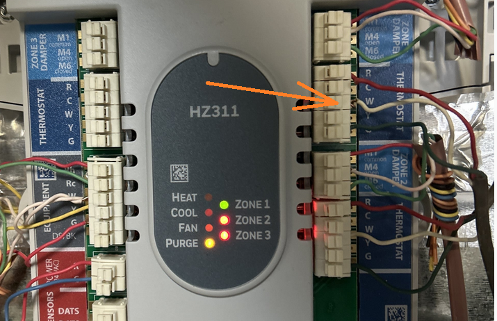

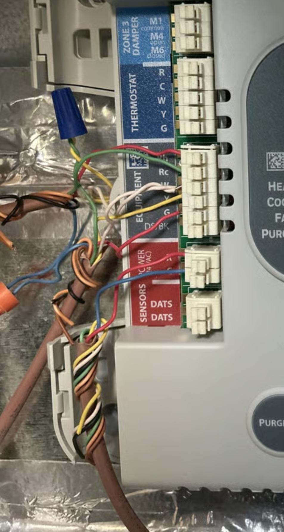

    So neither thermostat has the capability to operate air conditioning, yet the Equipment side is clearly using the Y terminal.
    Does this furnace have a dehumidifier ducted to it? There's 2 white wires that land on W on the Equipment side. One white wire should go to W on the furnace control board. Where does the other white wire go?
    In the pic you posted, Zone 1 is calling for heat. Is that the problem zone? If so, it's the wiring to the thermostat, or the zone panel itself if the thermostat is turned down.
    The "Power" terminals on the zone panel are fed by a separate thermostat wire. That means the zone panel SHOULD be powered by a dedicated 40 va transformer thats probably mounted in the blower compartment. That transformer powers the zone panel, the thermostats (if 24 volt powered), and thermostat switching in the panel. The Equipment side is powered by the furnace OEM transformer. Never the two shall meet. That's why the Common (Blue wires) from the furnace board is spliced through without landing on the zone panel.
    I believe your problem is on the Equipment side of the zone panel. Where are the other wires going?

    Remove (disconnect) this white wire, what happens ???
  • yeah zone 1 is problem zone. No dehumidifier ducted to it. Theres one on the other furnace in the mechanical room. I will double check where white equipment wiring is running when i go back. Thank you

    why are there 2 W wires on the equipment station?
    And a red wire on G?
  • all signs point to thermostat being the issue but its not. And its not a short in the wire. I also was confused about 2 white wires being at equipment W
