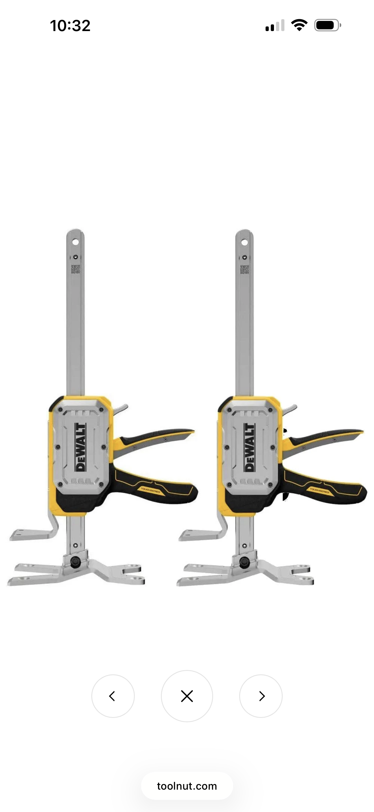

    As others said I used to use blocks of wood and fulcrum. That is until I got these Dewalt lifting jacks. On a small radiator that just needs a little shim I can get away with only 1. Otherwise I use a small section of unistrut at an angle under tye radiator and a jack on each end. Quick and easy to lift and shim. I also used them on furnaces, baseboard and water heaters to level equipment.

    Those Dewalts can handle the weight? Im shocked and impressed, also buying a set immediately.
    is that a rebranded irwin since if i'm not mistaken stanley owns irwin
  • offdutytech
    offdutytech Posts: 260
    @4GenPlumber the ones I have are rated for 350 lbs each. Usually using 2 plus a section of strut works better. Just angle it between the rad feet and go slow. Makes it quick and much easier on the back.

    So the strut goes diagonally and you have a lifter from the front on the valve end and the other lifter is slipped in from the end between the feet rather than the front? Will the lifter fit between the feet?
  • offdutytech
    The end opposite of the valve at an angle between the feet. This gives you a better base so they don't kick out on you when you lift. You can lift it to shim it up to regain pitch.
