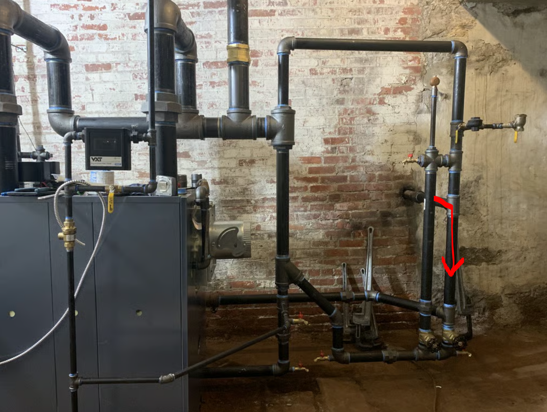

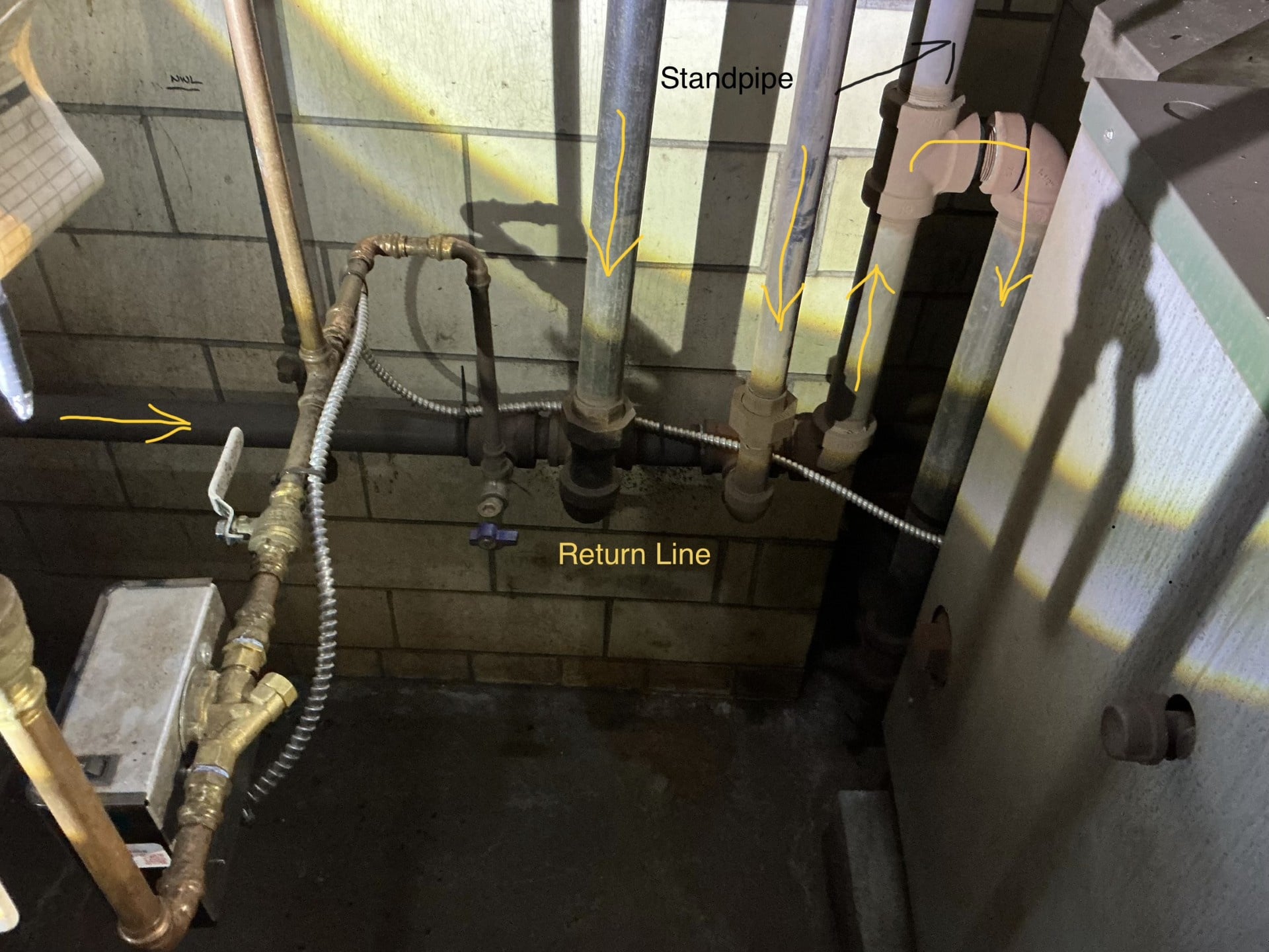

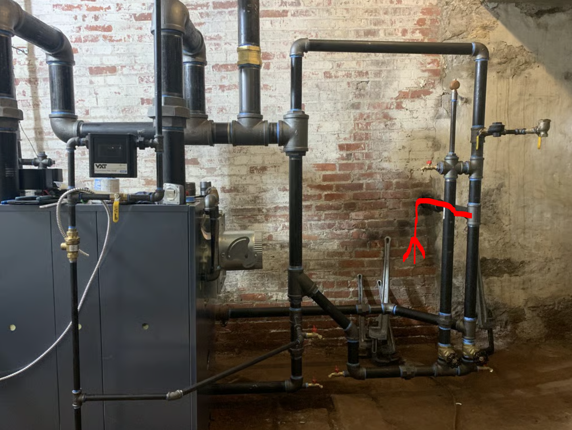

I can't say I've seen in this in the past, and I certainly can't explain it, but recently I went to a call where the complaint was water "erupting" out of a 1.5" pipe near the boiler. When I arrived, the boiler was already cold and turned off from the day before. The standpipe is installed on the wet return line near the boiler, and is piped up about 5-6' above the return line. Next to this pipe is a pipe that is tapped off the steam header, and directly piped into the return as well (no trap, valve, vent etc. in this line) The return line is then piped behind the boiler, and tees in at the Hartford Loop/equalizer. I feel like the piping is correct as far as dimensions/instructions go.
We started the system, and all was good until the steam header started getting hot. Then you could hear gurgling and some slight banging until that pipe started erupting. It took 10-15 minutes? At this same time, the water line was noted to be lower than normal, but still in the glass. (the operating water level is found to be lower than the tag for "normal" water level as well) and of course the boiler shuts off to take on more water.
Anyway, we did some routine things as it was our first time there. Cleaned the pig tails for both controls, flushed out the bottom of the boiler, and cleaned the LWCO/feeder probe. We let the boiler run, and it never erupted again once hot. The numerous air vents were all working. The water level was also found to be staying a little higher now once warmed up, but still below the normal line. I think this is because the Hartford Loop is piped in a little lower than recommended?
I realize this got long winded now- what is the reason for this standpipe, and what is the reason for the steam line piped down into the return line from the steam header? Also, if the Hartford Loop is piped a little short, can the steam equalizer allow steam down into the return, and up the standpipe?

There is a pipe on the wet return 6' up open ?

Unlikely. I'd also love to see pictures of this pipe

Big Ed, I have no idea. Our first time there. I am trying to make arrangements to get back there and take some pictures. Is capping this off a good idea? Or adding a vacuum breaker there?
Very odd. How high is the top of that geyser above the water line? And what pressure is the boiler showing when it erupts? The line from the header down to the return is at least sort of normal…

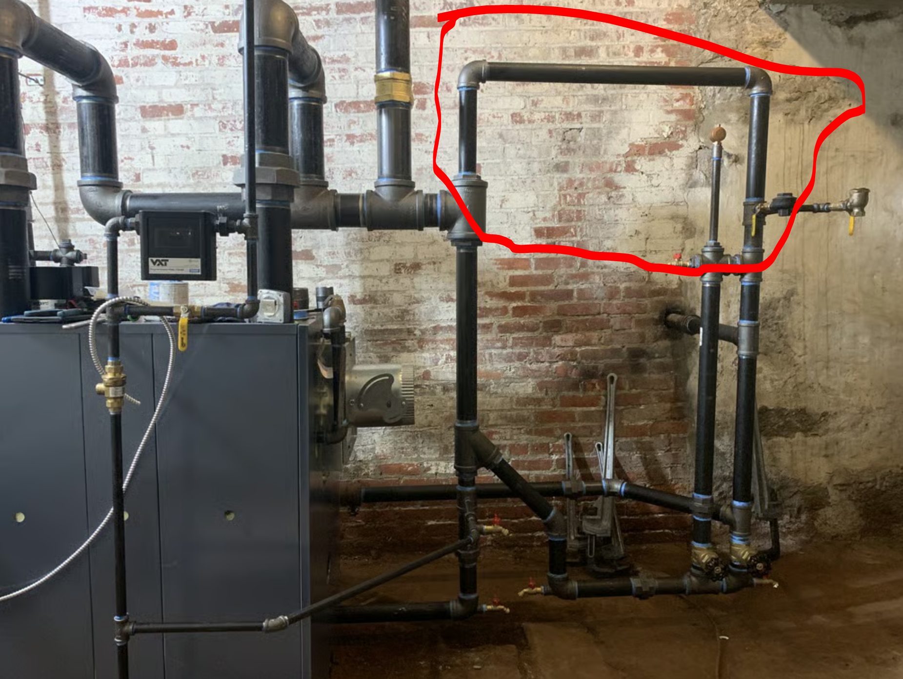

I agree someone's version of a false waterline

I went back to the job today just to take pictures. (I hope I posted them correctly)

shows a picture of similar open pipe vent. I can't remember which book it was in
It seems like a main was taken out of service or something. I would cap it.

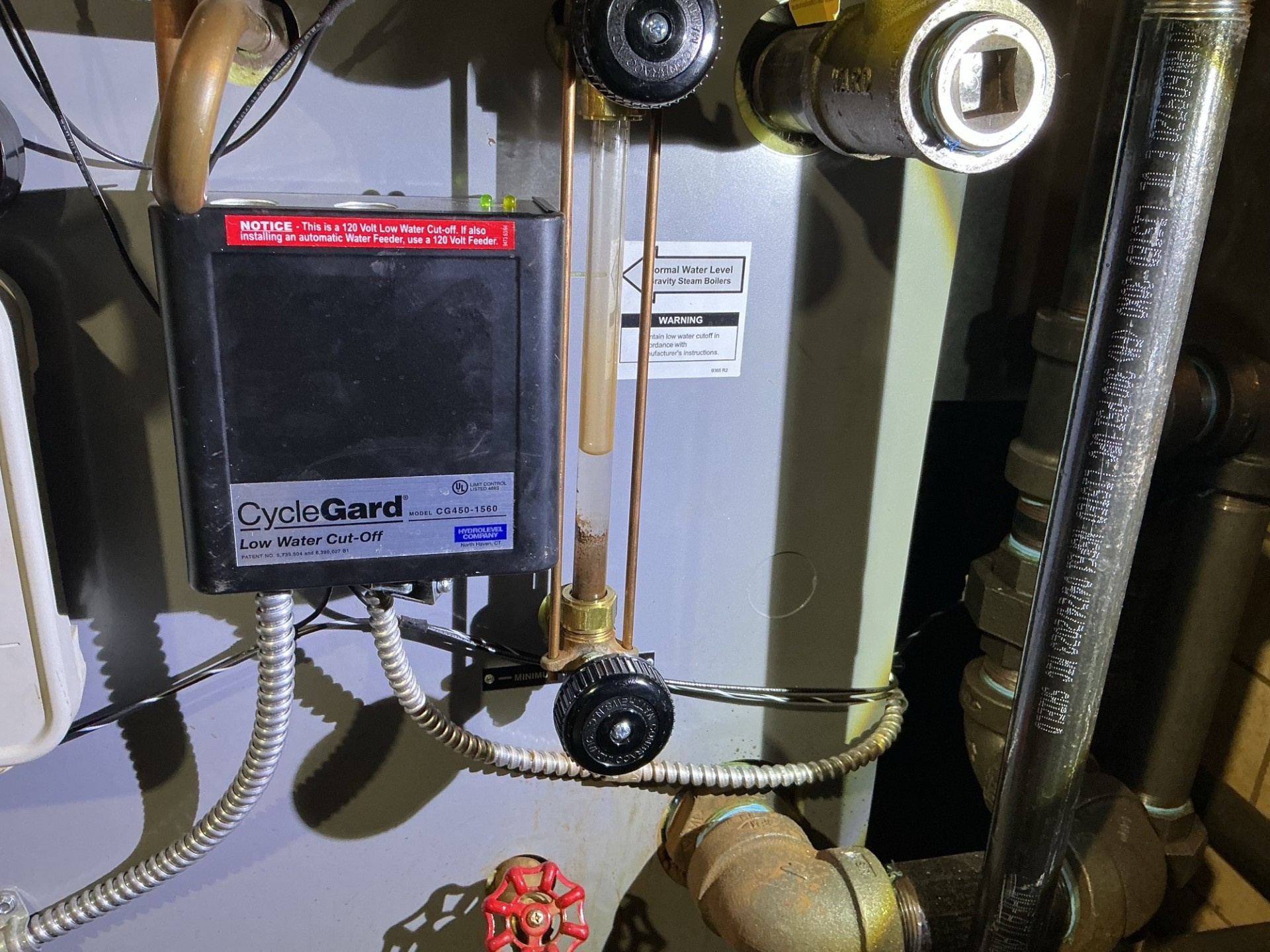

Your water looks oily, has the boiler been skimmed?
i would put a vacuum breaker on it
looks like a false water line but instead of connecting it to the equalizer they left it open
how old is that system, like 50's? that glazed natco tile looks post wwii to early 60's
it drops to the water line, I think it won’t have much vacuum to break

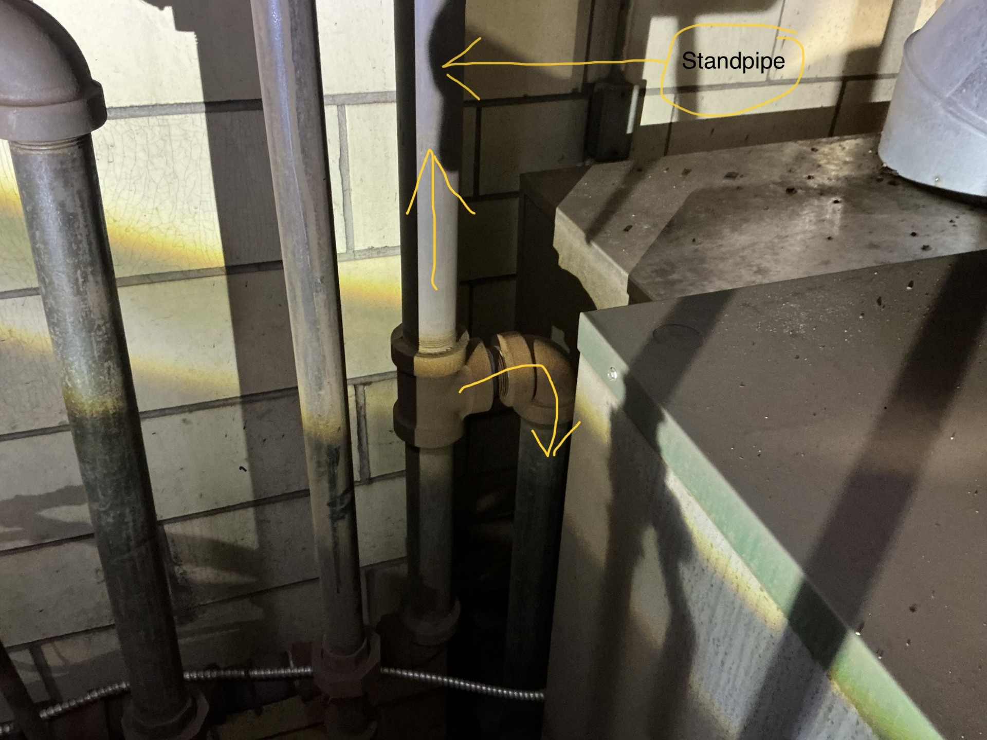

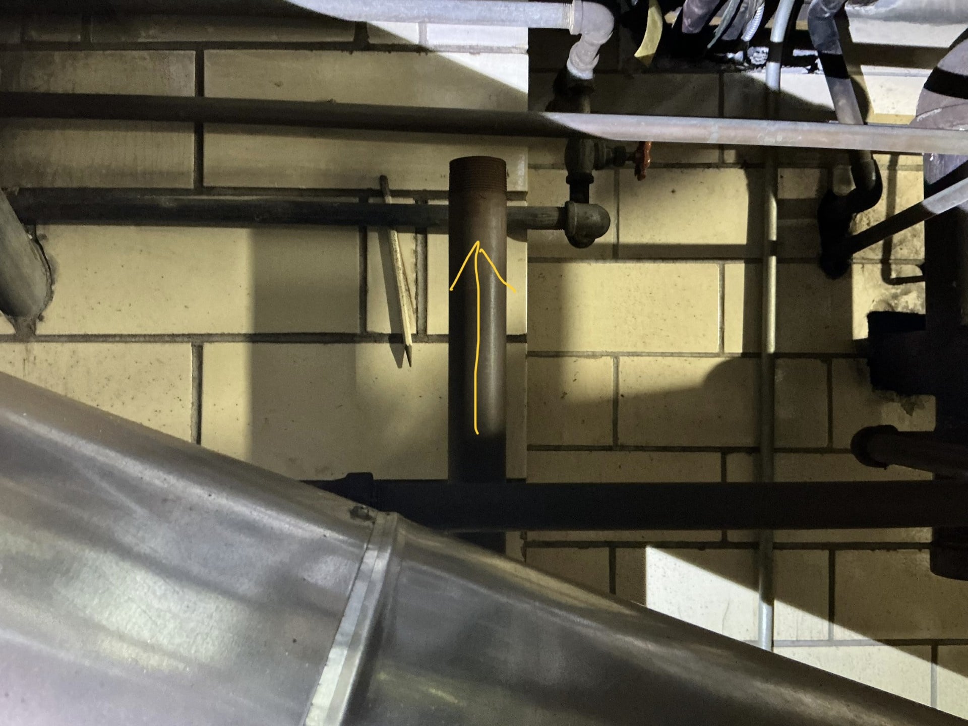

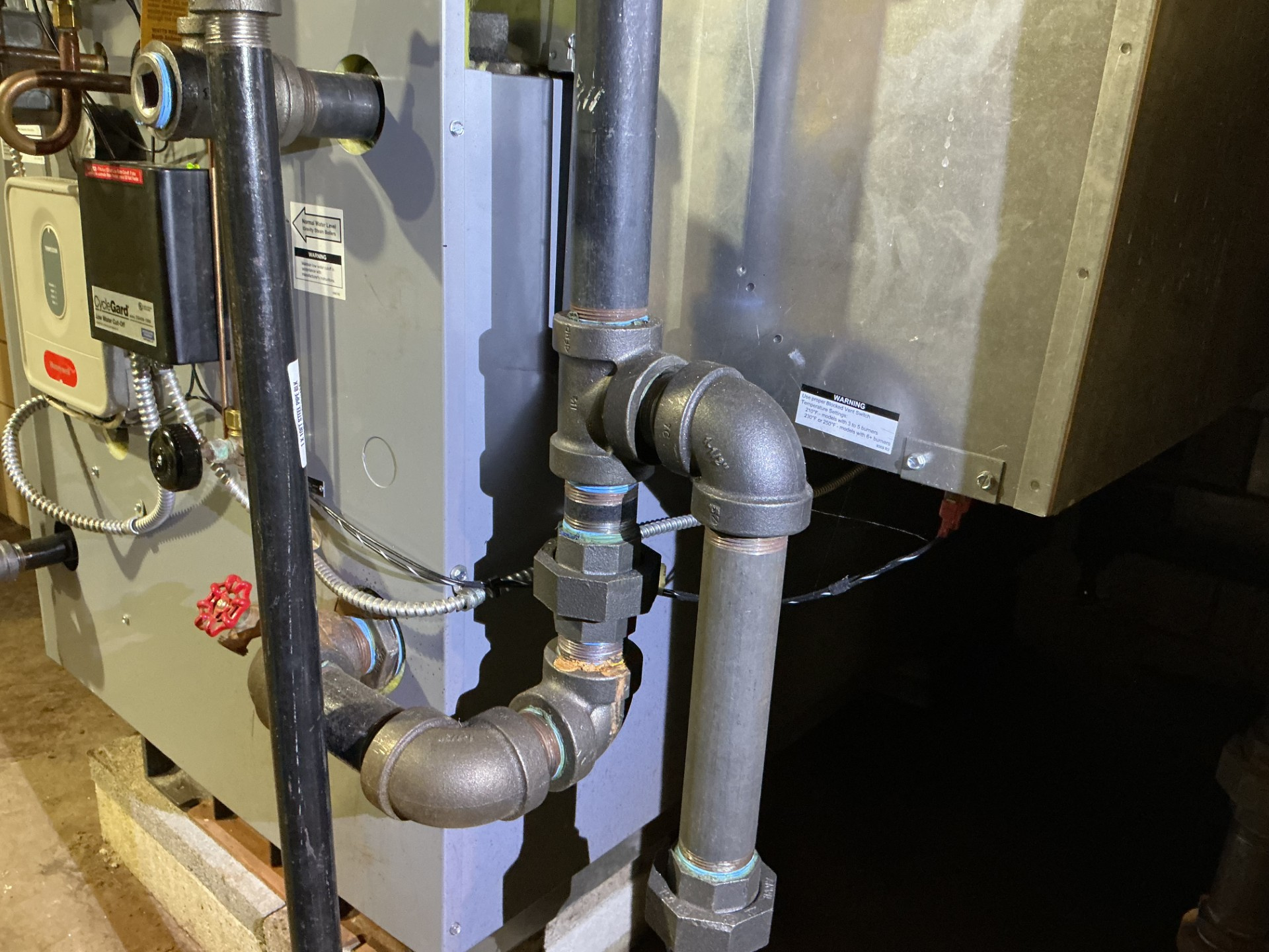

the open pipe is there to keep the water from syphoning down to the water line. if you cap it it can syphon the system water line down to the boiler's water line.
I just realized this by looking at my own pictures. The standpipe is the top of a return line "trap." The trap would've needed a vent for water to carry over, no? Now I'm curious why the trap is piped in at all? Couldn't the return line just be piped down with an elbow to join the return line where it connects to the boiler? Why the trap?
To answer some of the questions- Boiler is 3 years old, it is the 2nd boiler in the building since it was built, and I don't know how old the building is. It looks piped properly to me, and equalizer is intact. (If you mean the top pipe to the hartford tee) To the skimming question- the logs show someone was caring for the flushing, blow downs, etc until the last year when they got a new "staff." I agree the gage glass needs cleaned. But water level is steady while running.
