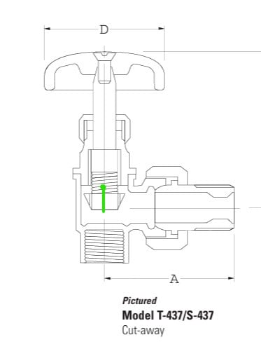

    A litttle follow up. Prior to replacing the valve, I took it apart and did some research. It looks to be a Legend T-437 or S-437 (just by shape and design). It does have a hole in the stem that makes it 'leak' a small amount when closed. I really don't think I need this on a functioning 2-pipe vapor system. The radiator is in a warm room with no risk of freezing. The steam trap on the radiator is in good shape.
    I put a drop of solder into the stem and all my noise problems are gone.
    I can't see how this is going to 'blow up' or cause problems. Any thoughts? Thanks.

    A lot of things would have to go very very wrong for anything to blowup. Good idea with the drop of solder.

    This valve is the input valve (control valve) located high on one side of a single radiator in 2 pipe steam system for a large house (6 bedrooms, over 20 radiators total). The fix works (just trying to prevent all flow to this single radiator because of expansion noises caused by inaccesable supply piping to this single radiator.) Not trying to do anything fancy. I guess I was surprised that they used such a valve design in this 2 pipe system. I guess it was to prevent waterlogging and possible freezing damage? I'll open the valve fully a few times per season, but keep in closed at night when I'm trying to sleep! Thanks all!
