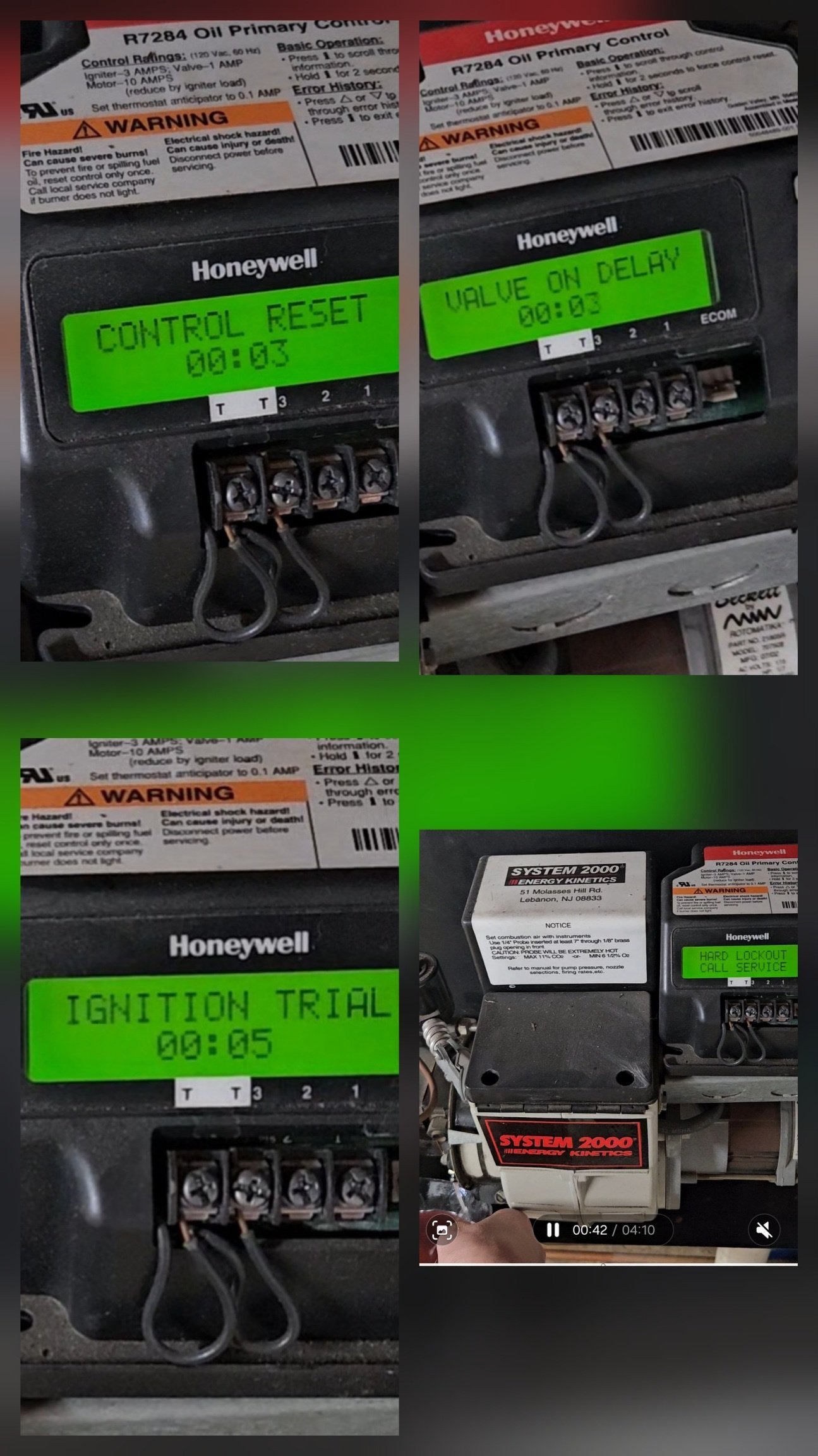

EK System 2000 - usually when we run out I grab 5 gallons of diesel, dump it, bleed it and it's good to go. I've done 10 gallons of diesel and bled it at least 10x still goes off as soon as it gets to ignition eact time. Do I just keep trying?

    Either you're not doing it correctly, you clogged up your oil line/filter/strainer/nozzle, or you did bleed it correctly and it's not lighting.
    Time to get someone in there who knows what they are doing.

  • Thanks @HydronicMike I realized I was leaving the bleeder open too long, closed it timely and it started up the first time. Not running out of fuel would be a great plan, I just always forget to check it. #goals
