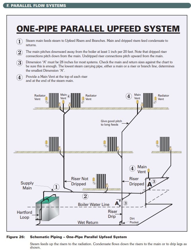

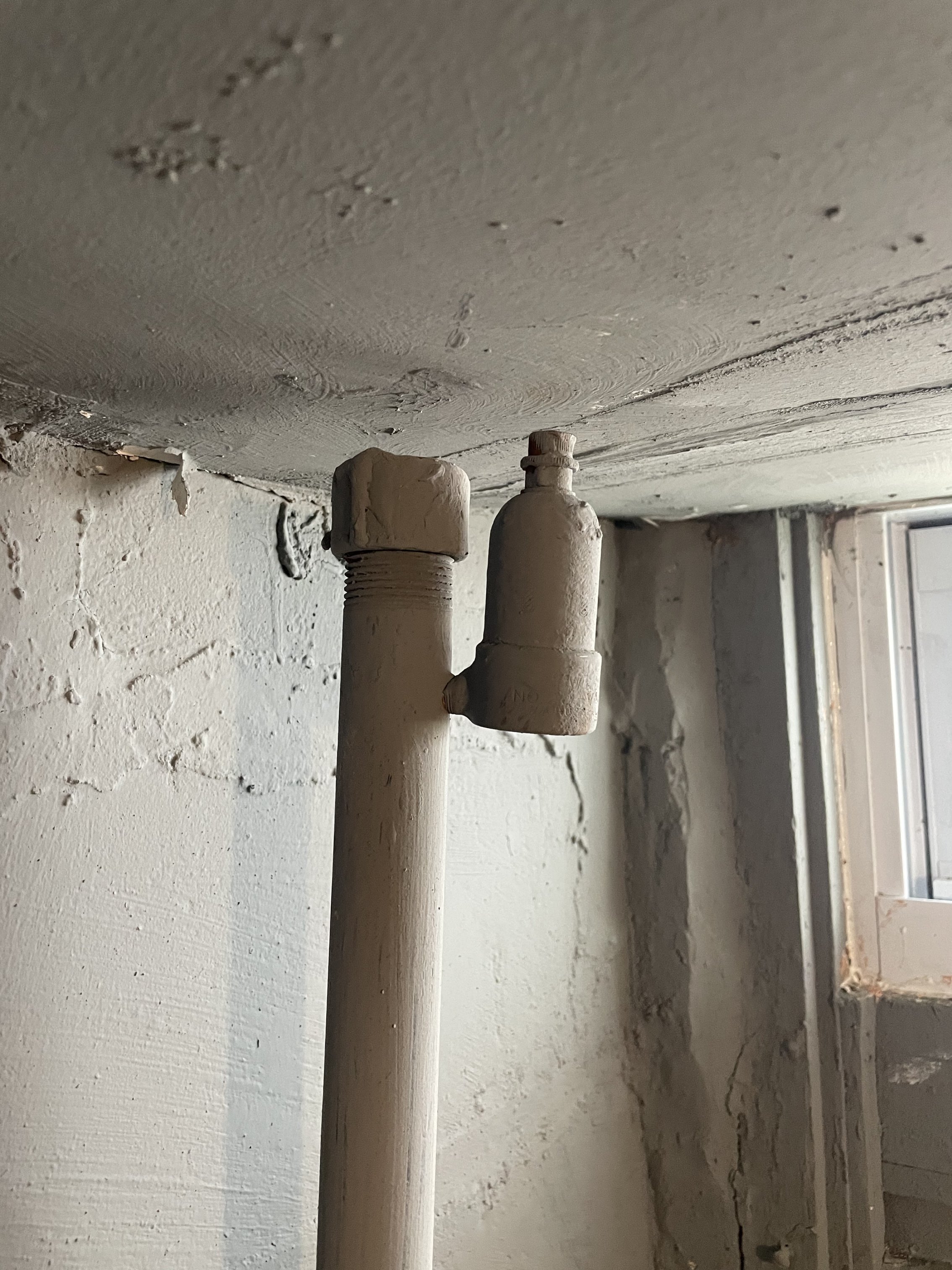

Hello all, I want to replace my air valve on my steam man line in my residential home? This is what is currently there from the previous owner. Plumbers have told me that this is a riser pipe on the return main pipe. What is a good replacement? And how do I replace this? I believe it reads No. 20 on it and it looks like a 1/8 inch thread size. I have been reading that gorton #2 is a good air valve to place here? Or is a Gorton #2 too big for my residential home, and maybe I should go with a gorton #1?
if I were to replace this with a gorton #2 which is a 1/2" thread, what additional piping will I need? since there is 1/8 thread hole currently there, do i need to drill a 1/2 inch hole on the existing 1/8 inch hole then use a 45 degree or 90 degree elbow → 1/2" diameter Nipple → 1/2 bushing, then Gorton #2? Image #3 is an image I found online that resembles this configuration.
Or is there another configuration that stops the air valve from hitting the ceiling?
Thank you.
Image 1 and 2: My current set up
Image 3: Something I found online that could be applied to my system.
    Argh. Well, it was a vent once uon a time. Not with all that paint on it, though.
    And yes, replacing it with a Gorton #2 ight be just the thing — but there's some terminology here to figure out. What does that stub pipe really connect to at the bottom end? Is it a steam main? Is it an extension of a steam main back to the boiler? Is it a true dry return? Makes a difference.
    In any event that cute bit of modern art probably is on a 1/8 in NPT tapping, and you have to drill out the hole and tap for the correct thread for the new vent. Easy — if you have the tools.

    I think we have a problem with terminology here. What floor is it on? Can you tell us which vent on this diagram it would correspond to? I'm thinking it is at the top of one of the vertical risers, with drip or without drip.

    That first photo looks like the riser pipe is intended to function as a small radiator in the corner of the room, which would mean the vent at the top is an ordinary radiator vent. This is how New York City apartment bathrooms were traditionally heated; the riser ran up through the stacked bathrooms in the building, and on the top floor there was a radiator vent at the top of the capped pipe. Cheaper than radiators and just as effective.

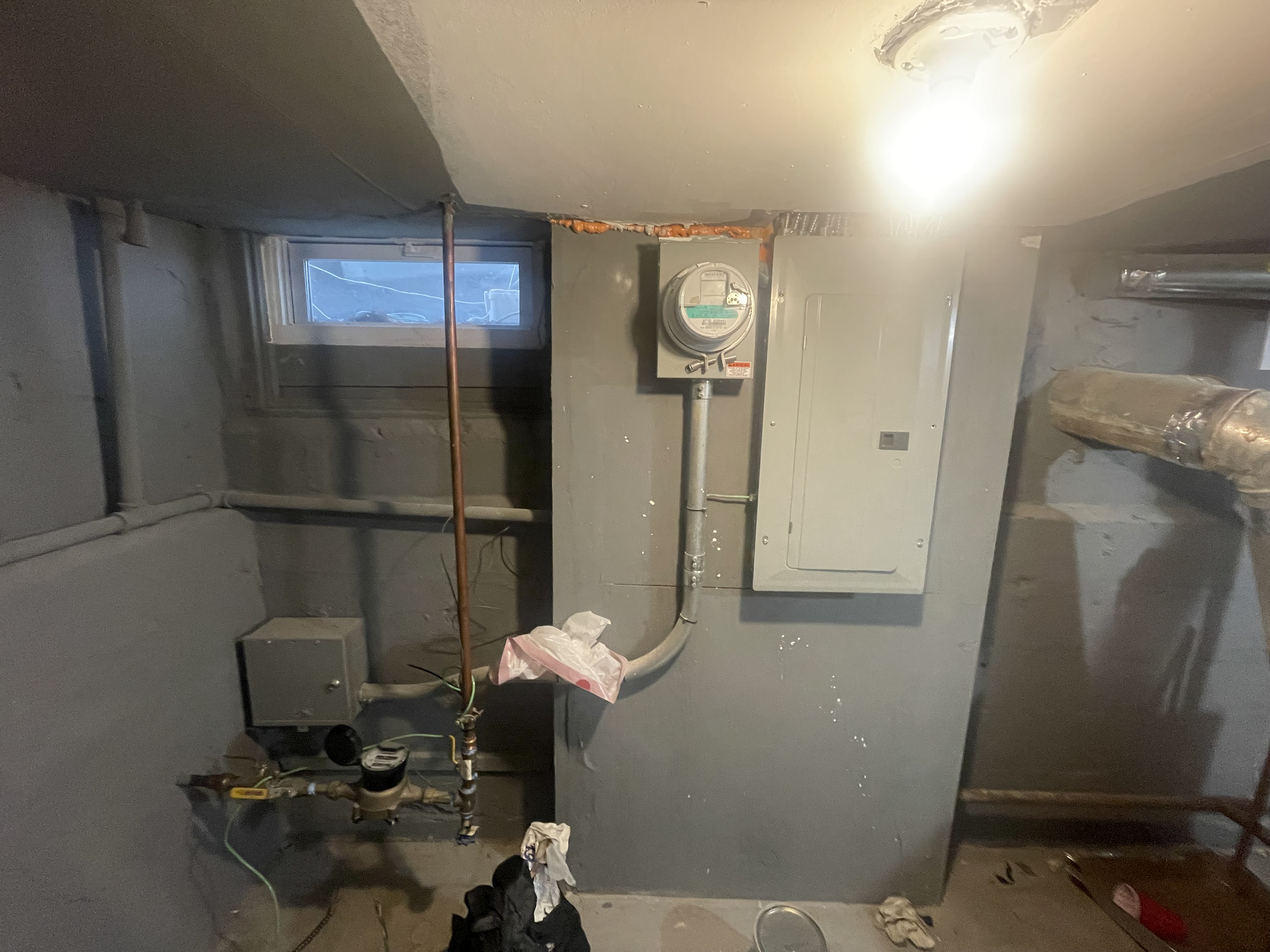

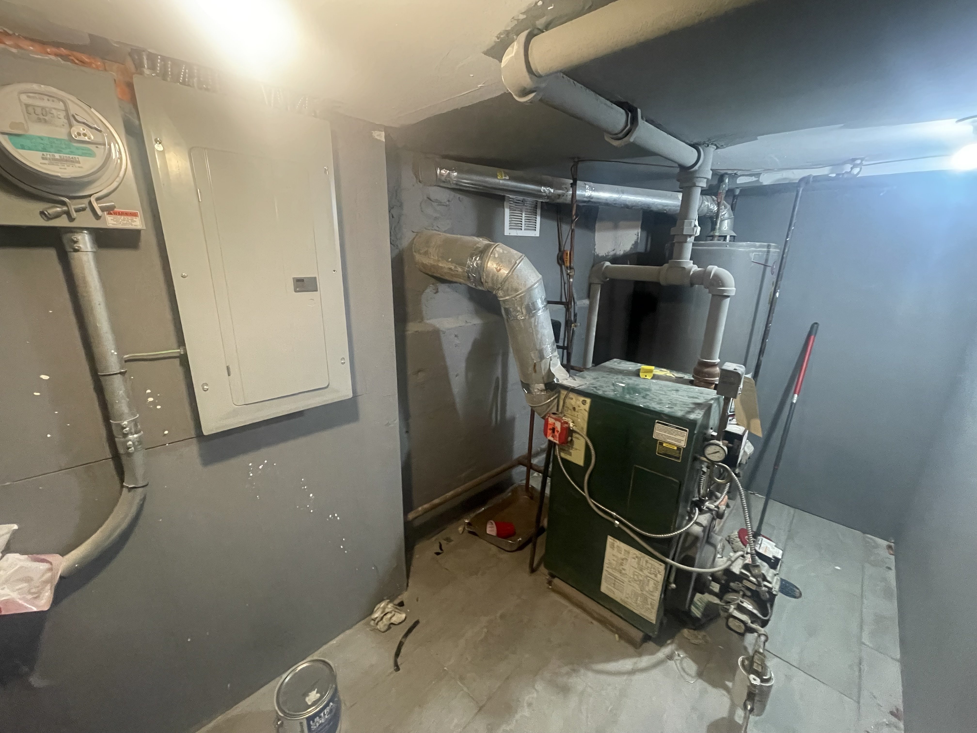

    I think we need that — but I think we also need pictures of how that pipe ties into the main lines running around the basement and how they tie into the boiler.
  • here you go all.
    ok. Do these pictures help?

    So that riser stub does not look like it's meant to be a radiator. It's a very strange place for a main vent though, and that is a strange height for a gravity return.

    The one on the riser is a radiator vent that is venting the riser. Without being able to see what else is going on, I would honestly just replace it with a normal, "angle radiator vent". I would throw a Maid O Mist #D (or really any Maid O Mist with the orifice removed from the top) which will be equivalent in size to a Gorton #1 main vent.
    It won't require any tapping or additional fittings and it costs like $14 from Supplyhouse.com

    There is nothing connected to that riser. Buy your new straight vent. Figure out the height you want the vent at. Go to a plumbing supply or big box and have them cut you a new pipe. Take the old pipe out of the tee and put the new pipe and vent on with a reducer from the pipe to the vent.
    If you don't want to have a new pipe cut you can buy nipples and couplings to make up what you need. Looks to be about 2' long.
    You need a working vent there because that pipe drops down making it a wet return behind the electrical panel.

    And what about the third photo in the original post? Where in the system is that?

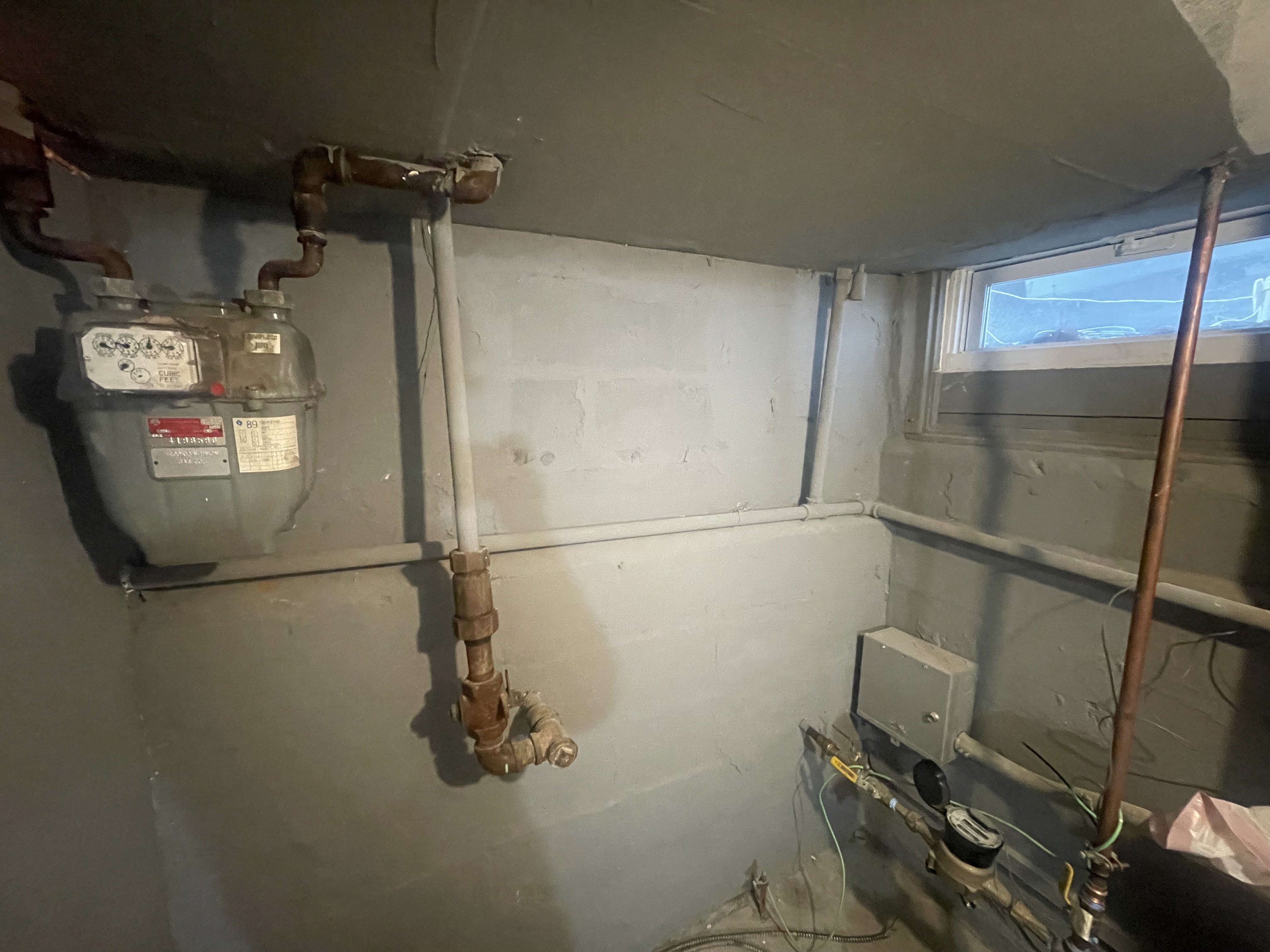

  • I think there is confusion with the third photo that shows a gorton #2 valve. That third photo is NOT in my boiler room or home. It’s a photo that I found online to use as a reference IF I were to replace this air valve with a gorton #2.
    So again I don’t have a gorton #2 anywhere in my mains. I can’t see my mains since they are between the basement ceiling and first floor.

    Steamhead Posts: 19,007
    Try a Gorton D first since that's a one-for-one swap with no modifications.
