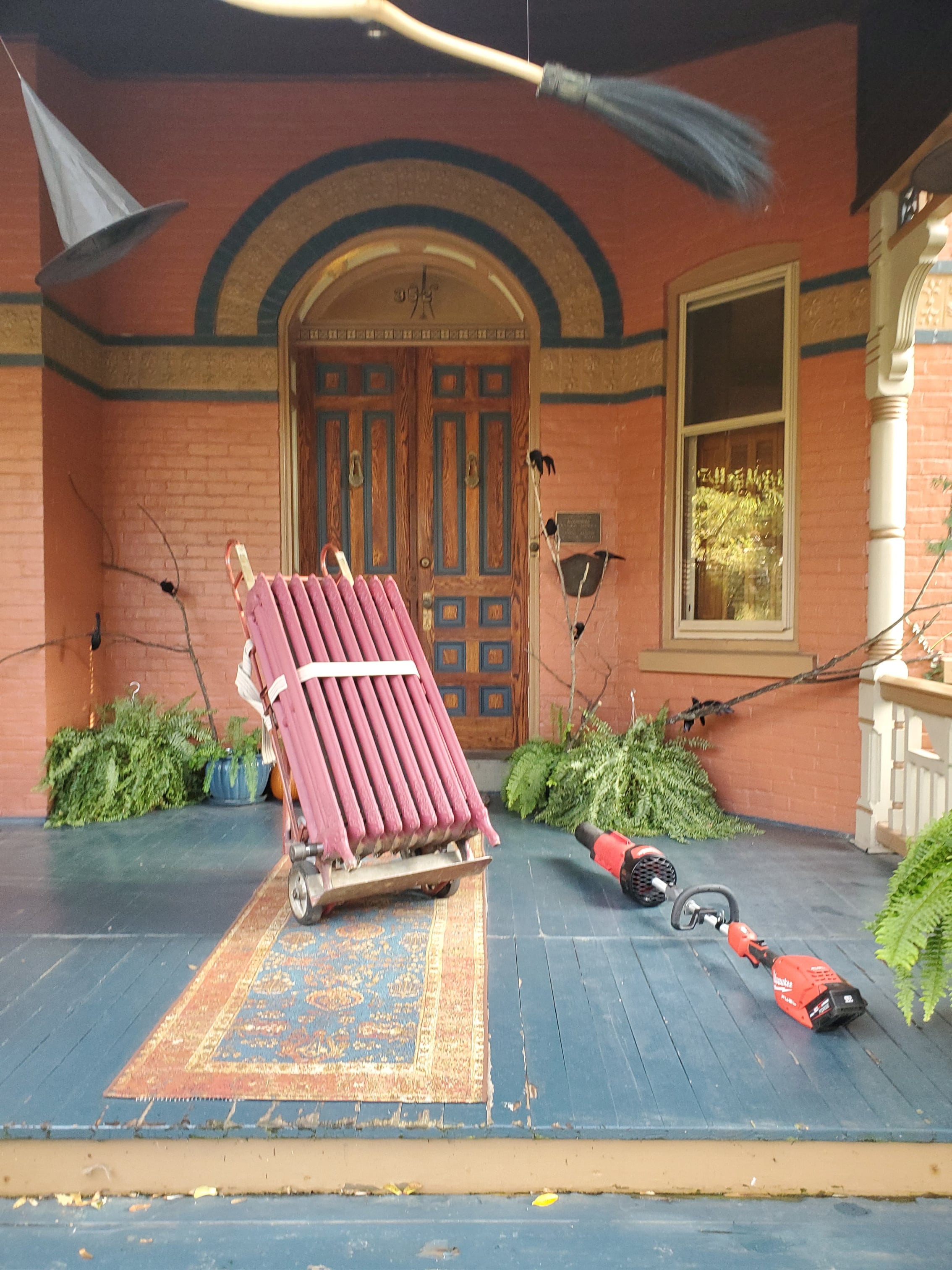

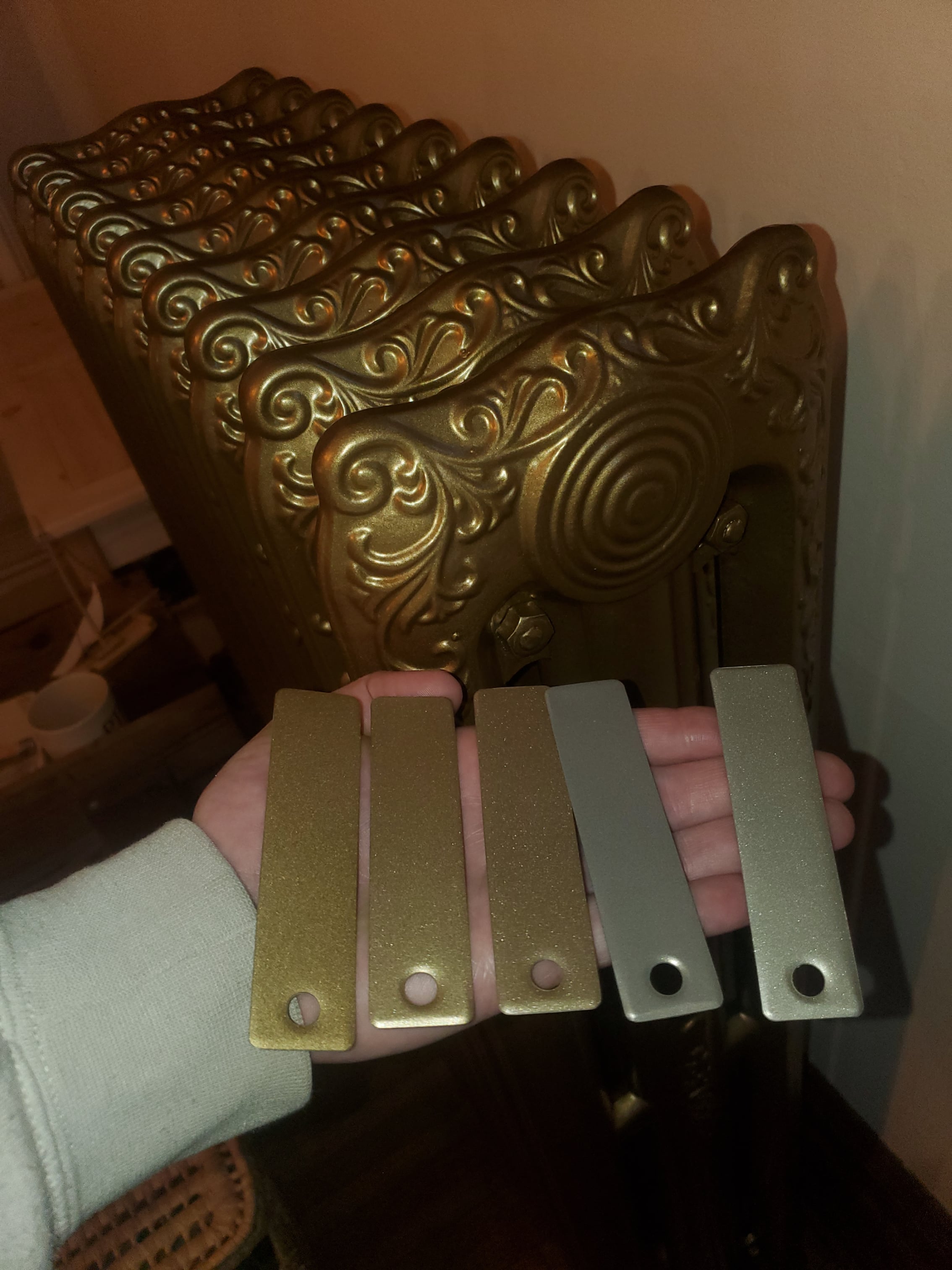

    My wife and I recently had a very tall(45 inch) Rococo radiator sandblasted and powder coated and we are very happy with the results. As stated above they are extremely heavy, so I would have 3 or 4 guys to help. This was a first floor radiator and only required going up/down 4 or 5 stairs.

    Other minor things:
    I used a short nipple with a cap for the steam inlet side and an 1/8 inch plug for the air vent side, to prevent any damage to threads.
    A heavy duty appliance cart is very useful.
    I rented a very small trailer from Home Depot so we did not have to lift into my truck bed.
    Start looking at finishes well before you remove the radiator, there are thousands of options and it is very difficult to decide. Prismatic Powders will send you 5 samples, you just have to pay for shipping.

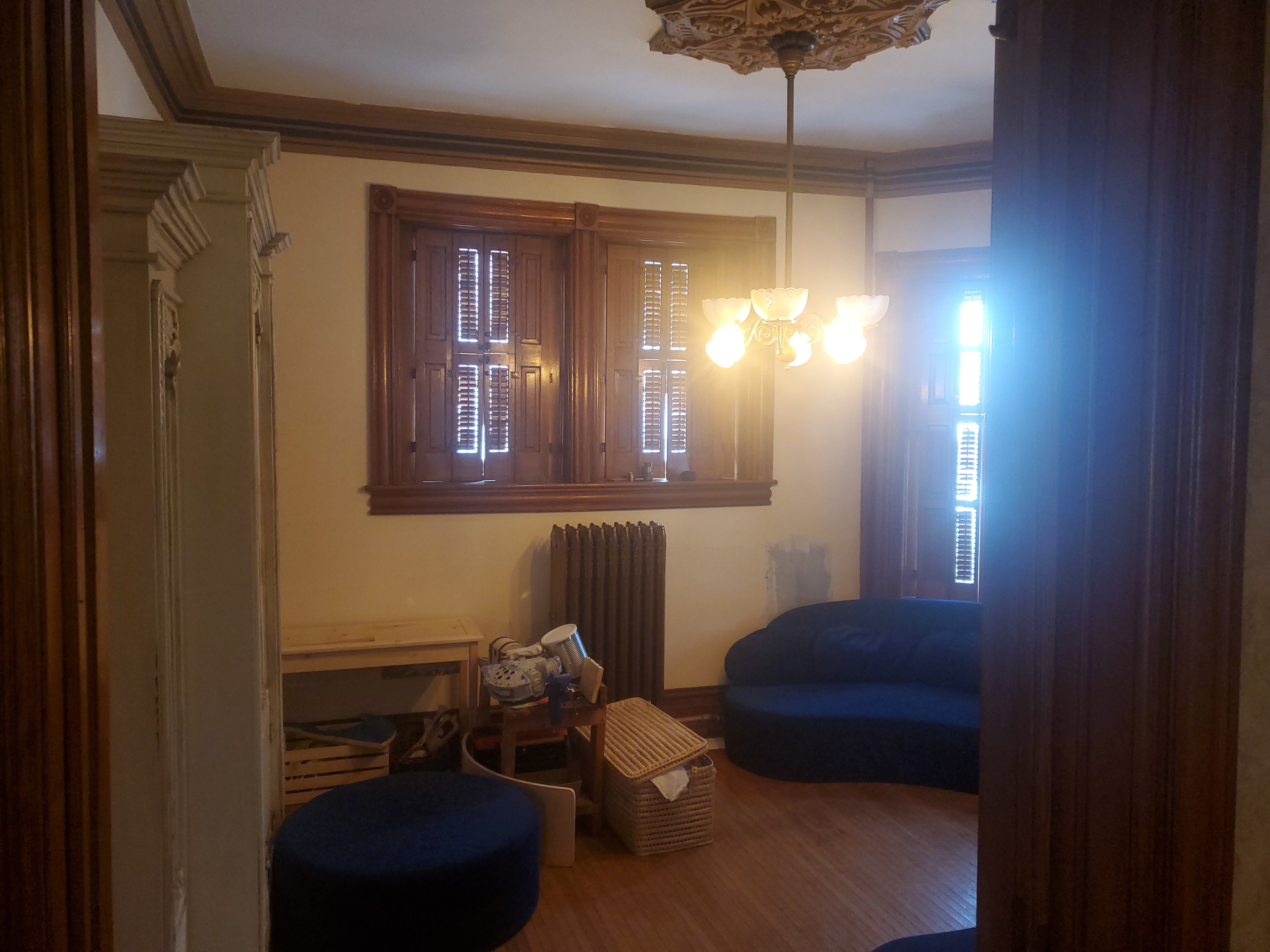

    This is our Tv room/library/ playroom for our son. My wife wanted a curved couch in this room, at least until our son grows up, so we rotated the radiator to accommodate. You can see the plaster and painting that will need to be done.
    Adding a 10 inch nipple got the radiator further from the couch and centered it on the windows. Pitch was still ok, so we figured we would give it a try. I replaced the black iron nipple and elbows with brass once we finally found someone to sandblast and powder coat. In hindsight I would have just had the 10 inch black nipple and elbow fittings powder coated to match.

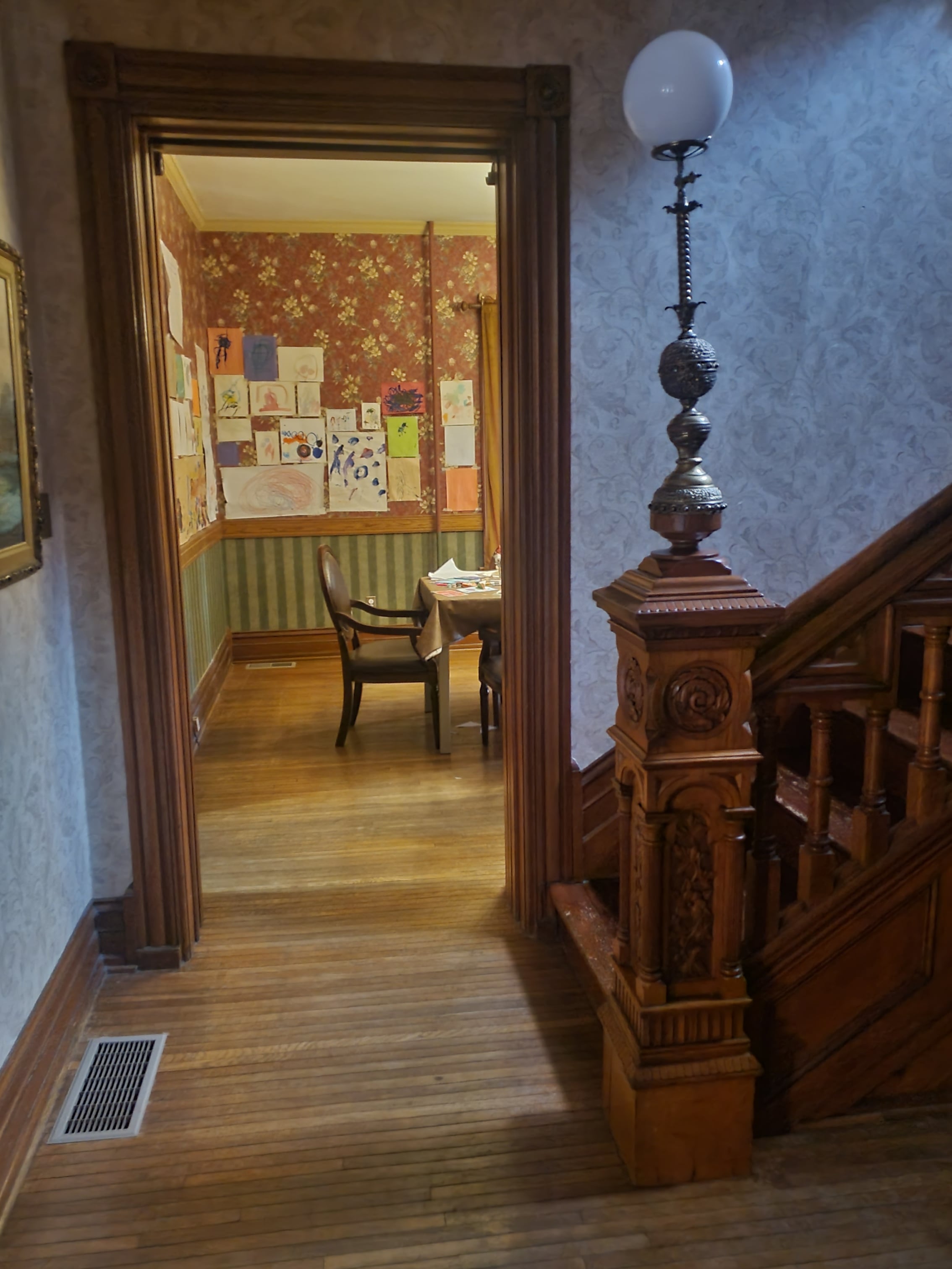

  • pjyorks
    pjyorks Posts: 8
    I believe a converted gas chandelier to electric . The gas is not connected. Same thing with our newel post. I am not sure if they are the original or not.
