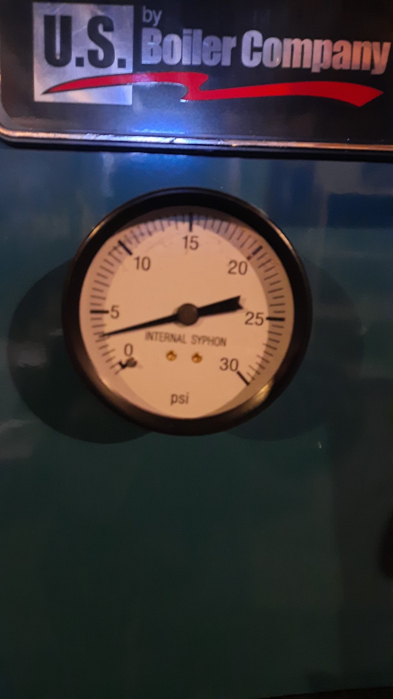

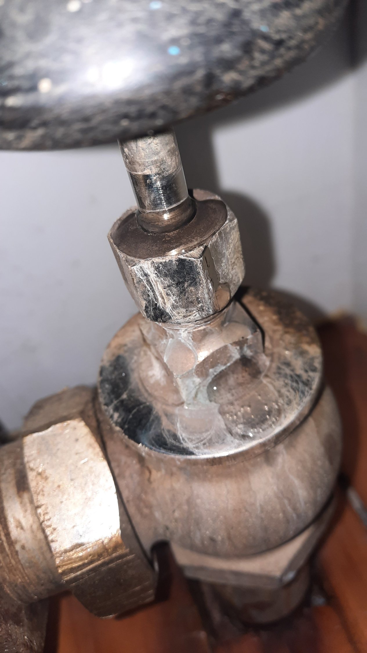

Short-ish version: started having issues a few weeks ago (upstairs radiators venting louder than norm, stem valves starting to spurt water) and found we had a loose nut on one radiator connecting it to the pipe (tightened, resolved) and then also found we had a radiator that had a hole/crack (replaced, resolved).
Continued to have the initial problems mentioned here, but getting worse (air vents on our steam baseboards rattling louder, one leaking water now, almost all stem valves now leaking or spurting/gurgling water, particularly two of our upstairs ones which are the loudest). We have two Gorton No. 2s as mains in our basement, bought/installed them late April '25. Everything was working like a dream until a few weeks ago. Bought a new Gorton No. 2 thinking the mains had failed, tried replacing each of the others with the new one, no improvement, so put the "originals" back in place (this was Saturday, two days ago). Woke up Sunday morning very cold upstairs (but still getting a small amount of heat to some radiators and lots of the gurgling valves on two of them still), so I figured either a) the heat failed (hopefully not, the boiler was replaced in March '24) or b) there was too much pressure and it wasn't making it upstairs. Checked the boiler and pressure, pressure indeed was rising too high (we've never run into this before) and the pressuretrol would cut the system out.
Called our heat company, they didn't know what was causing this so they did their system maintenance/annual cleaning (cleaning out the parts, making sure nothing was clogged, etc.).
They suggested Ventrite mains instead and I was able to find some #35s at a local supplier today, but I asked about why the pressuretrol's not cutting out when it's supposed to and they didn't know, so they're going to replace it this week.
My biggest concern and aggravation right now is that I seem to be missing something/I can't figure out what's causing the overpressurization in the first place now that we've tried replacing the mains (in fairness, as of writing this I only replaced one of the Gorton's with a ventrite because I can't get the adapter on the other Gorton out so just replaced that stuck one with the new Gorton No 2 we bought a few weeks ago). One person said maybe all of the stem valves need to be replaced but they were functioning completely fine before and I can't understand why they'd all suddenly start having the same problem at the same time if that was the case.
We've put in a help request with another company that does specialize in steam but they're a few states away and only come up this way based on how many customers they have in need in the area so it could be a month or two (based on the last time I scheduled with them) before they come this way again.
I am despondent here that I am hemorrhaging money on these service calls and parts and no one who has been to the house seems to know what the actual problem is. If anyone has anything else for me to check I am all ears, I've read "We've Got Steam" a few times and have been deep diving this forum and other sites for more information but am at a loss.

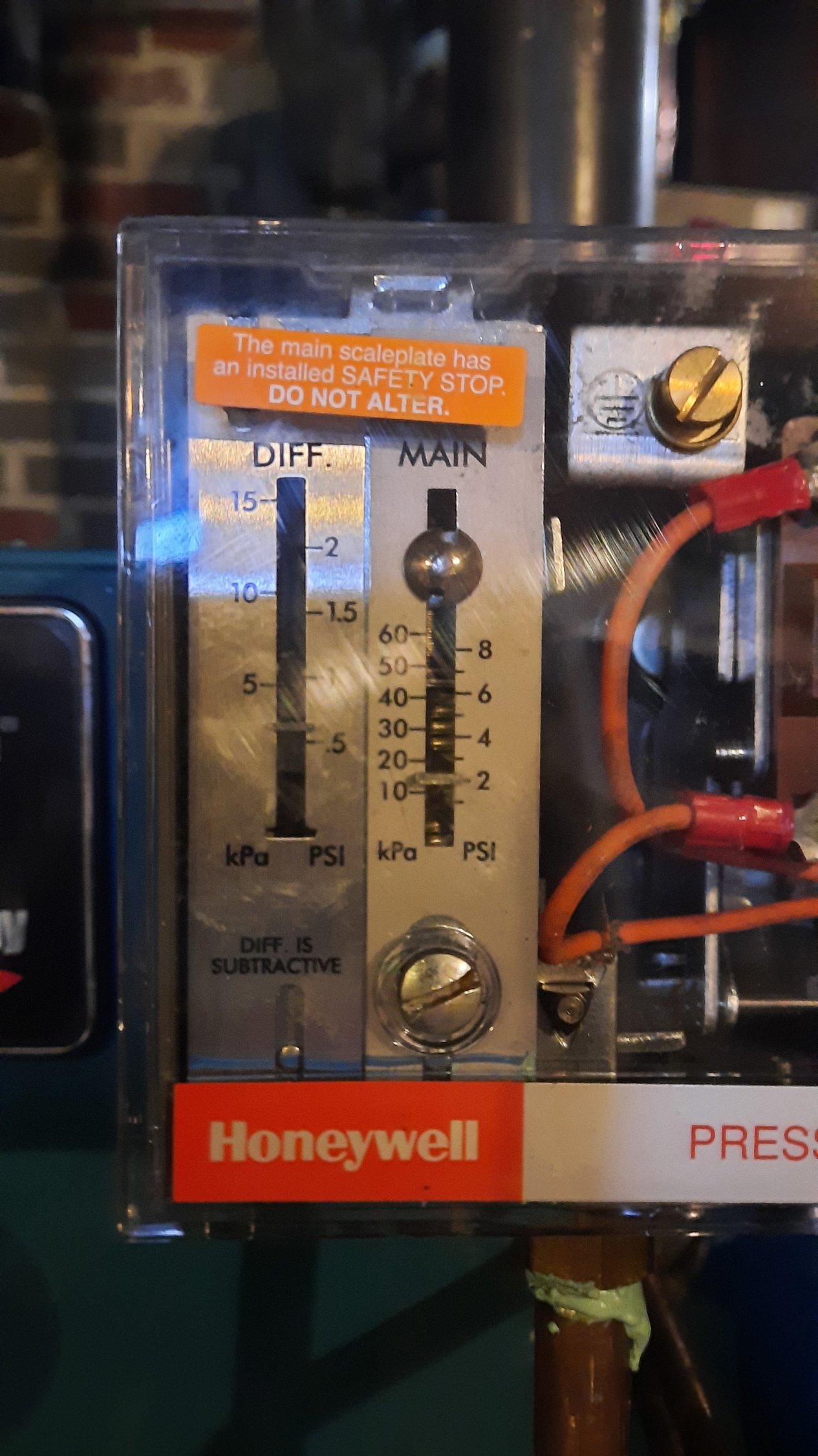

    Jamie Hall Member Posts: 27,571
    Fussing with vents won't do anything to help with excess pressure.
    What will, though, is whether the pigtail from the boiler to your pressuretrol is clear. I realise you just had some mainentance, but did they take the pressuretrol off the pigtail and ensure that the pigtail was clear into the boiler?
    That would be the first place I'd look…

    Those pressuretrols are badly calibrated often straight from the factory. This video will help you calibrated yours (don't mind sensationalizing title):
    You MUST get yourself low pressure gauge (0-5psi) to really know what is ACTUALLY going on in your system. At 3psi (assuming your 0-30psi gauge is correct) you should be hearing whistling of your radiator vents as if they were the Orient Express.

    As suggested above first make sure the pigtail is clean. Second get the low pressure gage put in so you can see actual pressure. I would go ahead after assuring the pigtail is clean setting that pressuretrol at 1.5psi with a 0.5 diff.
    Also, lots of things will happen at 2psi that just don't happen at a normal 0.25psi or less operating pressure. The extreme cold may be forcing you into higher pressures more than anything else. If it extremely cold eliminate your setbacks and depending upon what you have for a thermostat make sure you allow at least 2 cycles per hour or if swing controlled go to +/-0.5degree instead of +/-1deg.

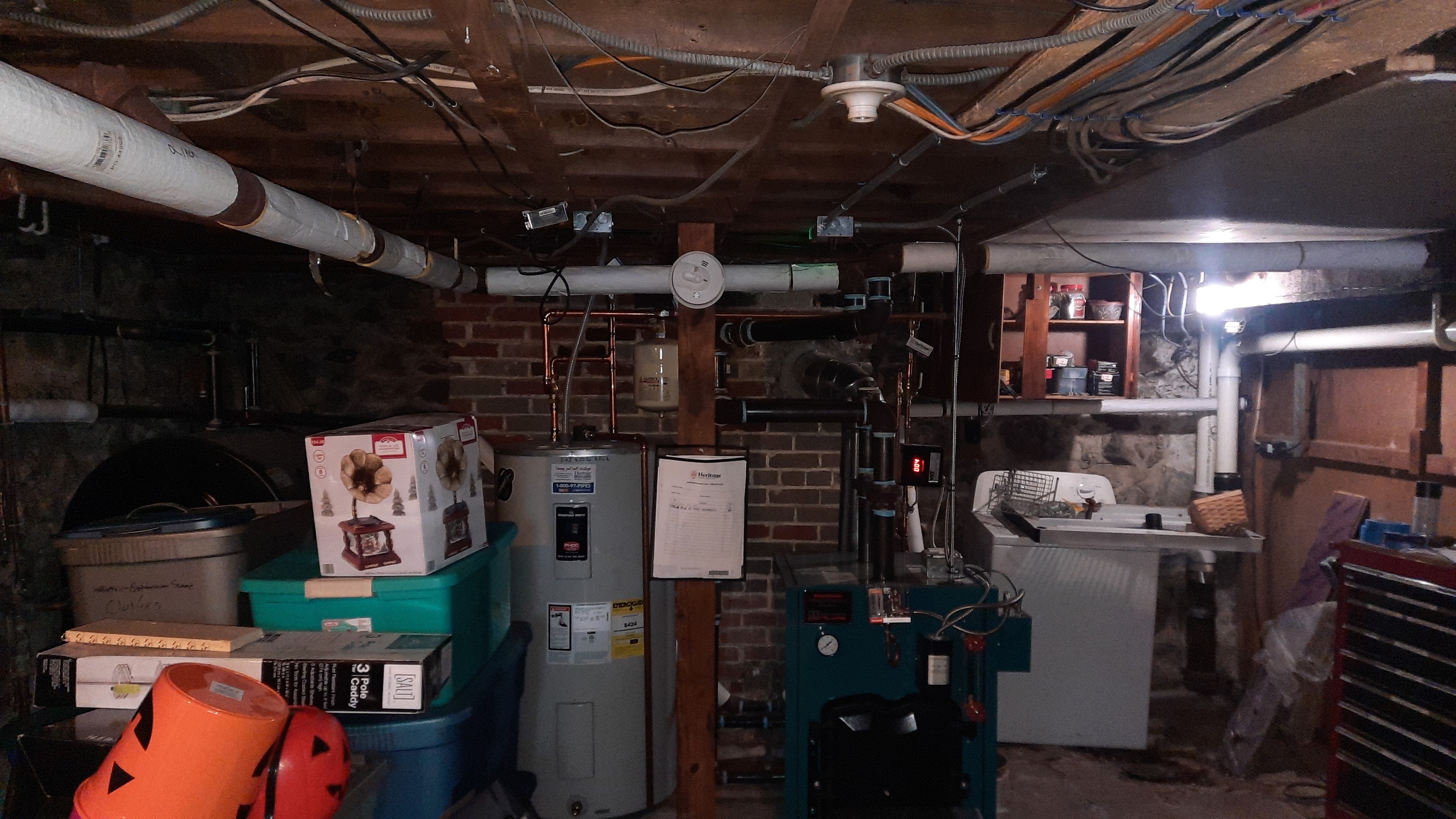

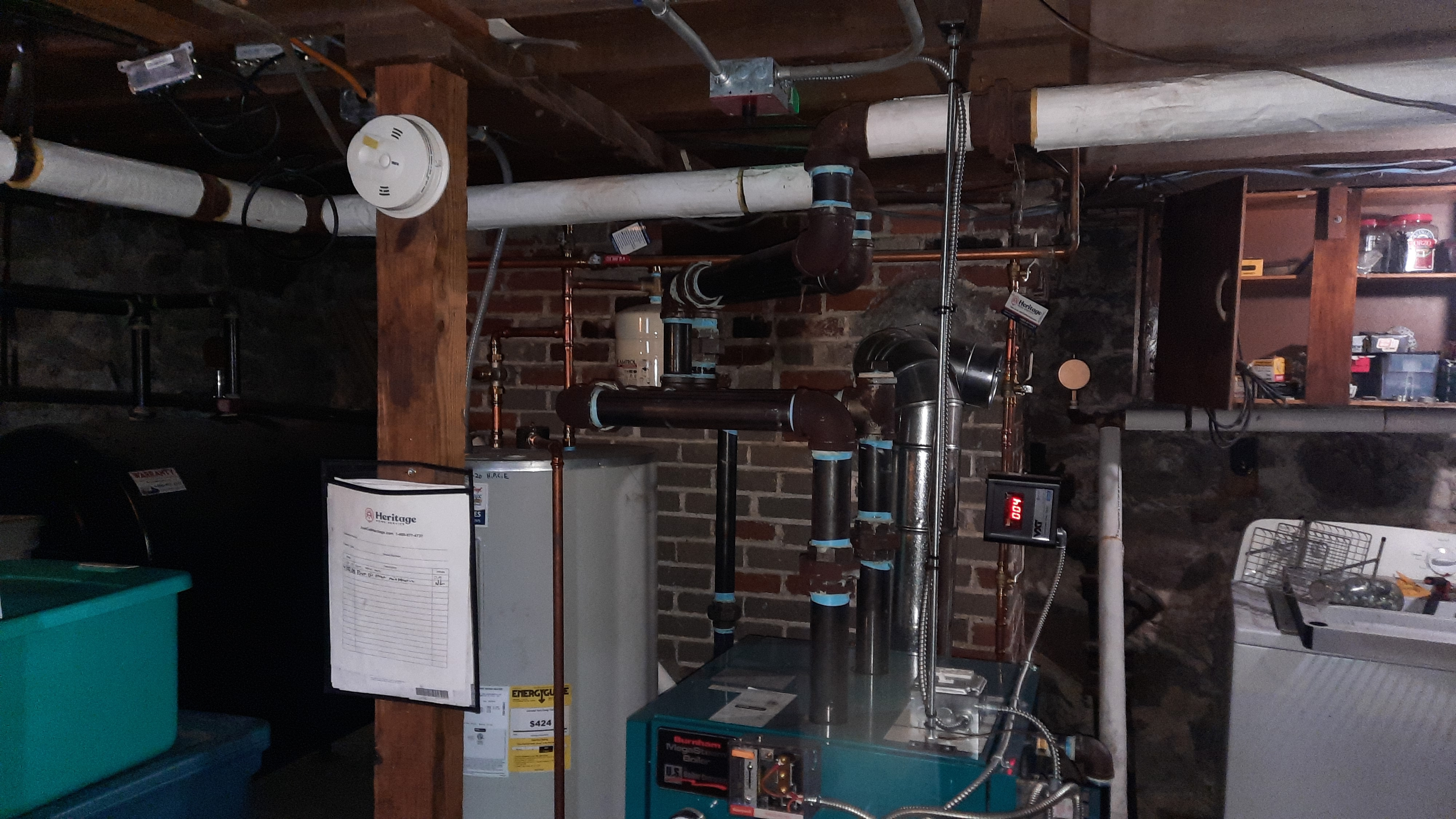

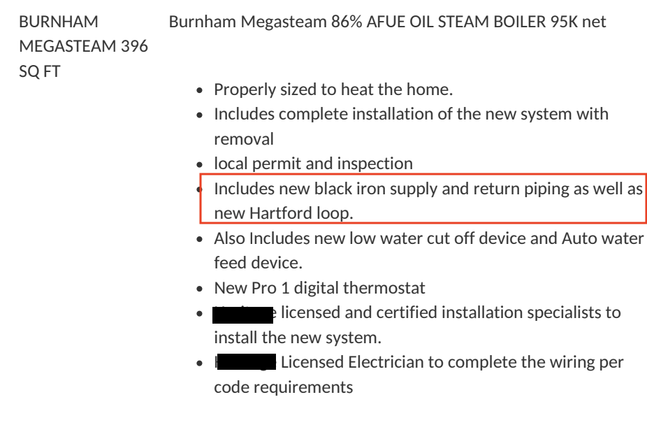

    I read your other two previous posts and IIRC you mentioned that the new boiler was installed Mar 2024, and they also replaced some pipes. That's pretty key information that needs to be given in detail regarding what they did to the pipes.
    "We do skim the boiler about once a week and we try to flush it every few weeks, we do get a lot of gunk through the system but when we got the new boiler they also replaced a lot of the basement pipes which has helped a little bit."

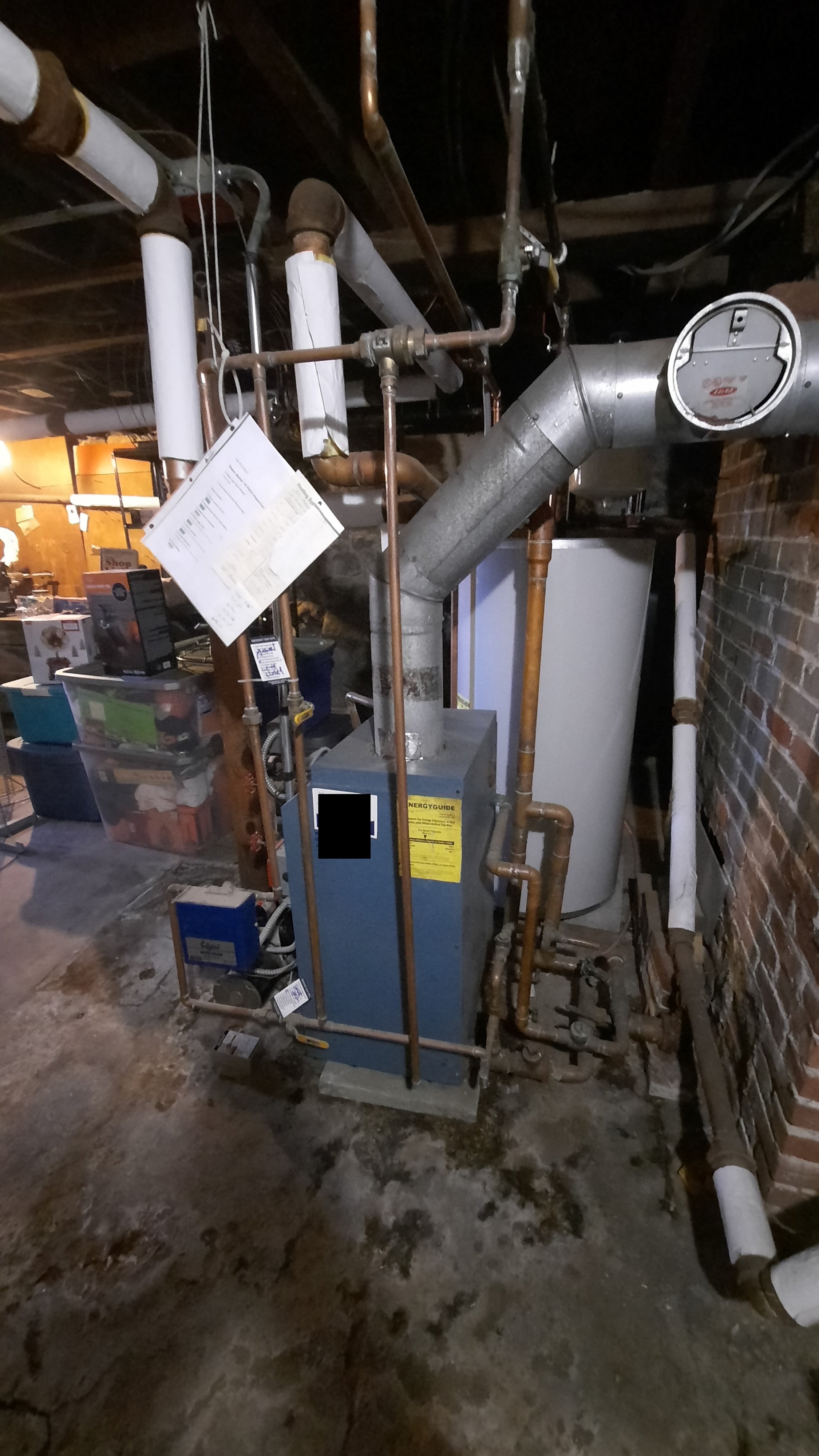

    Hi, I went back through old photos from when we did the replacement and before, as well as our inspection report from when we bought the house but can't find much in the way of old pictures unfortunately (and of course, hindsight being 20/20, had I know we'd being having issues in the future I'd have measured the pipes, taken better pictures, etc.)
    What I can say is I know they replaced some of our copper piping with black iron. The only specifics I have, though, is this screenshot:
    And these are the only "before" pictures I have:
    Vs. our "after" pictures (these are recent since they're from that other post):

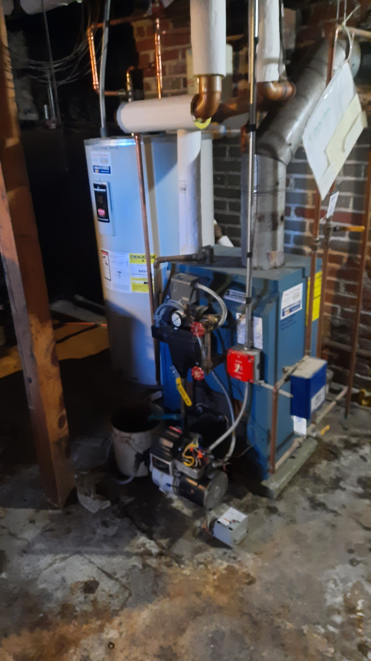

    I do see that on the new system there are two pipes coming out of/into the top of the boiler vs. the one that split off in our old boiler. We did have a steam-specializing company come out last year when we were having issues and they seemed happy with the way the piping was done, I think they mentioned the Hartfood loop was slightly lower or higher than they'd typically do but they didn't seem concerned about it.
    The last day or two I've noticed the upstairs vents have started getting louder again, and this morning one of the stem valves started gurgling/spitting again, so the vent replacement was just a temporary fix. We do have someone coming out tomorrow to replace our pressuretrol so I'm going to ask them to double check the pigtail to make sure it was, indeed, cleaned out last week when they did the "annual maintenance."

    I'm thinking that they were referring to the near boiler piping. If they had replaced your mains and returns you would've known it, especially the $$$ part.
  • Aack08
    Aack08 Member Posts: 16
    Oh Yes absolutely, I didn't see new piping for the full basement, just the near boiler as far as I can tell.

    get new gauges, one. 0 -4 lb. Your pressure is way high. Now, just lower pressure to 0.5 and see what happens, see if you heat. The pressuretrol is set to 2 but gauge shows 3. That’s way high. Gauge should be under 2, try for 1.5 , if vents blow water lower pressure more and see what happens. How do you know system is not overfilled ? Are pipes to glass cleaned ? . I did not see a photo of sight glass and controls close up . See if lowering water level as well as lower pressure help . You only need as much pressure to get heat everywhere. I would get it as low as possible with proper heat.
  • leaking
    leaking Member Posts: 153
    edited February 8
    Also my presssuretrol only goes to maybe 3 lb, yours goes to 8, you don’t have as much low control . Try it at 0.5lb and see what happens . Maybe it’s inaccurate. Was it removed and cleaned? Did you look at the gauge and see if crap is inside ??? Stop with the Vents . That pressure gauge is for Hot water heat . Get a 0 - 3 lb , then you will better control and know real pressure .

    If you've been following along, the pressuretrol is suspect and is being replaced tomorrow.
  • Aack08
    Hi all, I'm overdue for an update:
    Pressuretrol had indeed failed and was replaced, keeping in mind though that the goal was ultimately to figure out what was causing the over-pressurization in the first place.
