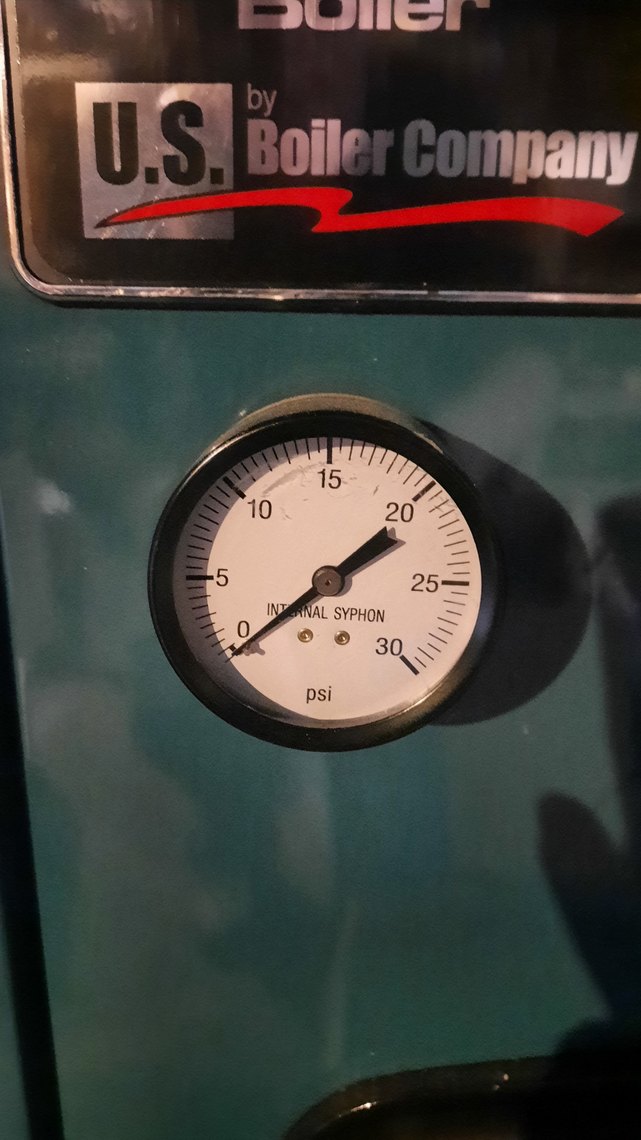

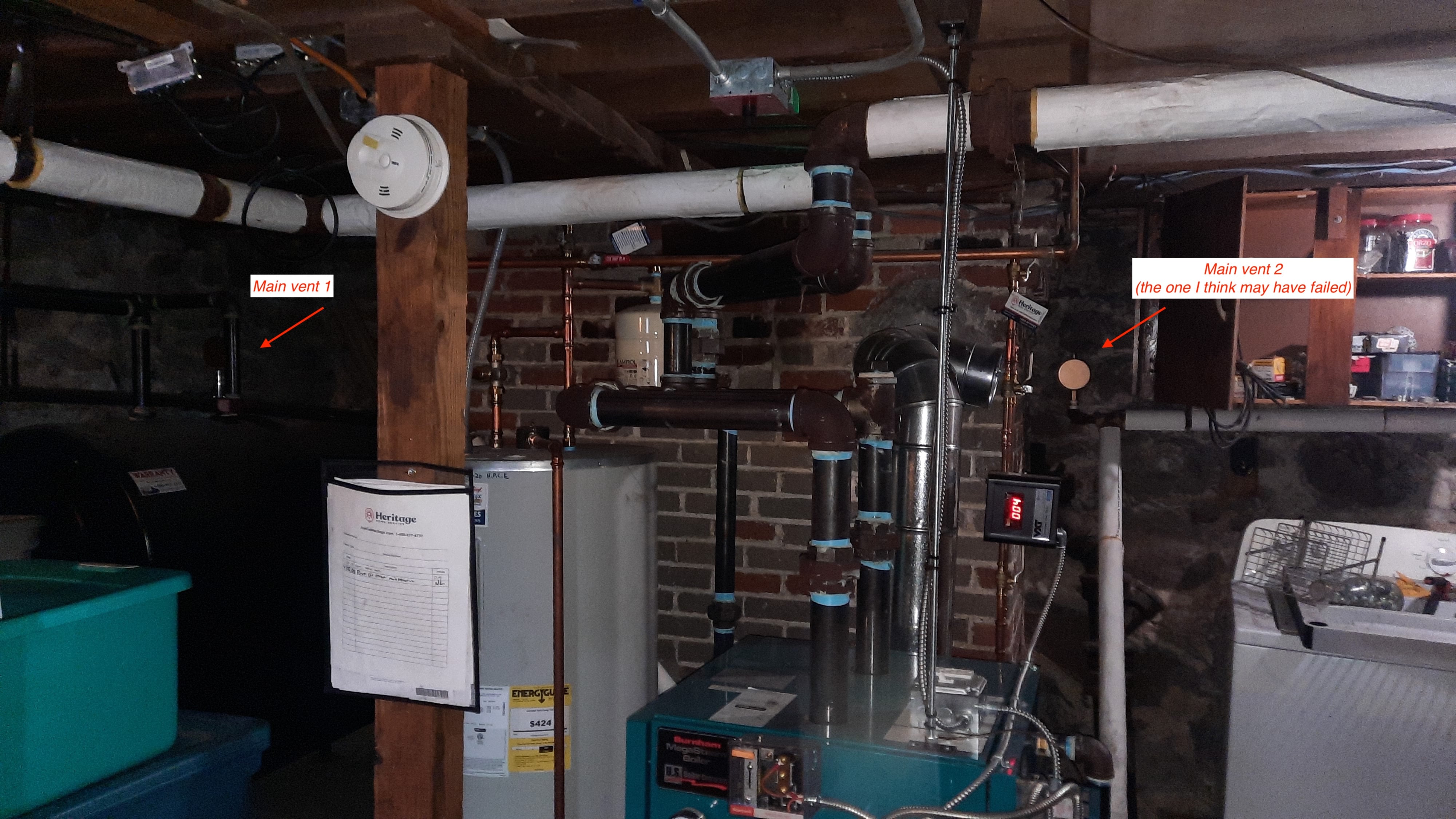

Hi everyone, we replaced our two mains last year that had failed with Gorton No. 2s and our system has been working well, mostly quiet, well balanced, etc. Within the last few days our upstairs radiators are venting a lot more loudly and are now leaking water from the stem valves. This has happened to us before and it resolved when we made a change to a downstairs vent and replaced the mains. I'm having a hard time telling if one of our mains has failed; it makes a slight gurgling sound so my guess is yes but it's less than a year old so I'm stuck between paying $___ (edited to remove specific pricing) for a new one and being wrong about it failing or paying $____ for the steam specialists nearest us to come back up and tell me the problem.
Any advice is much appreciated, thank you so much! (I tried to attach a video for reference of the sound before I realized that's not an option).
  • dabrakeman
    dabrakeman Member Posts: 1,017

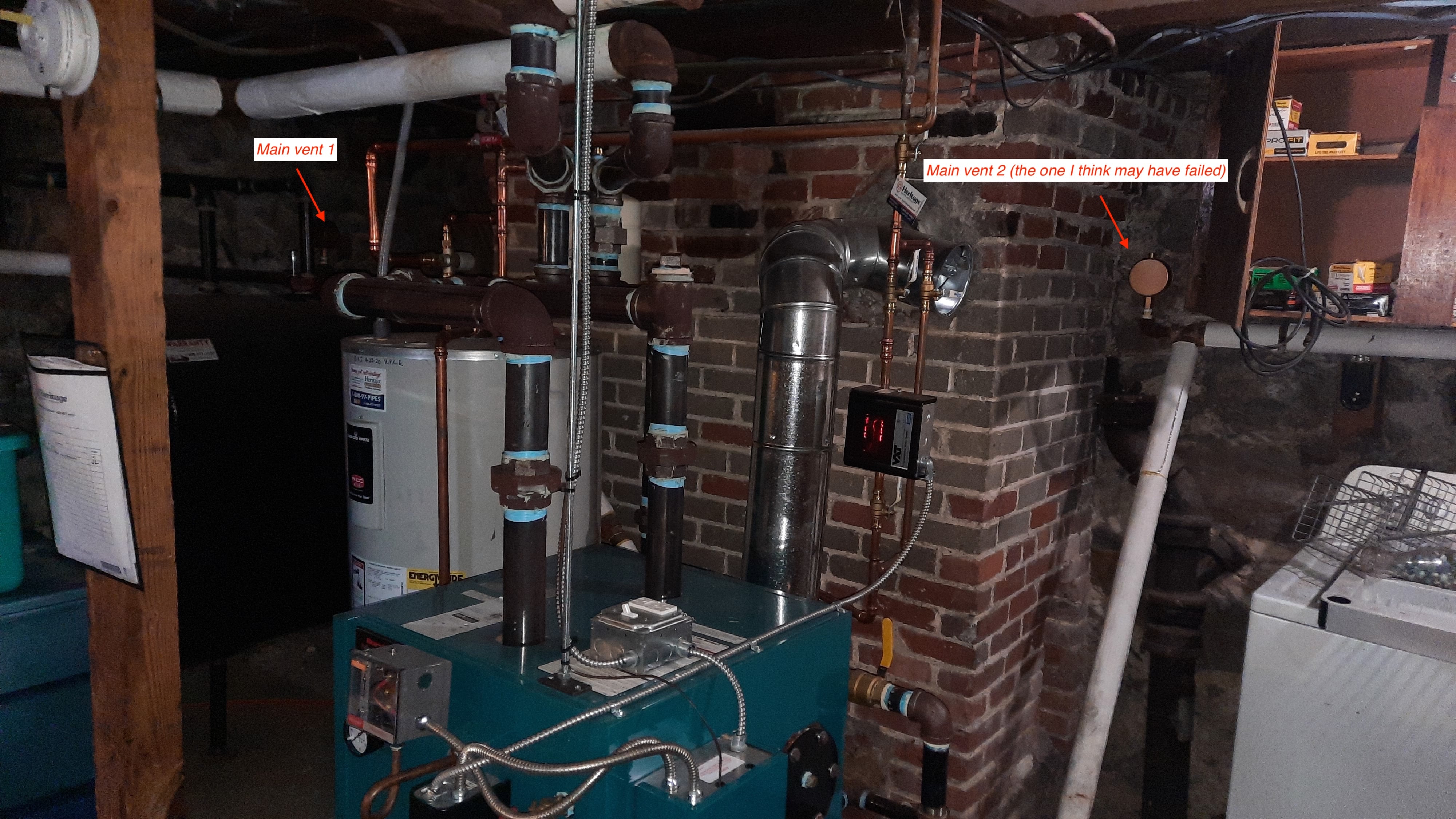

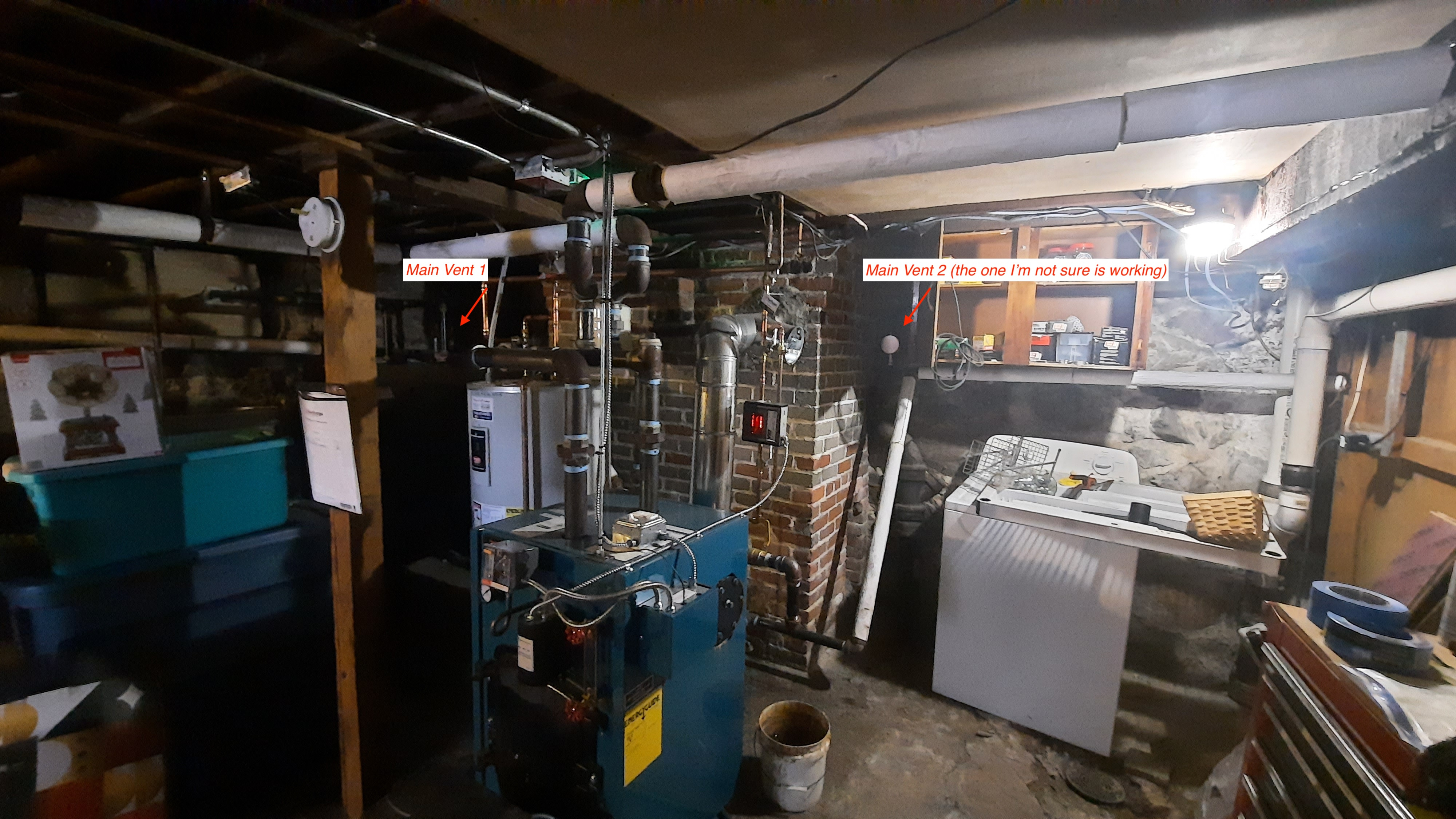

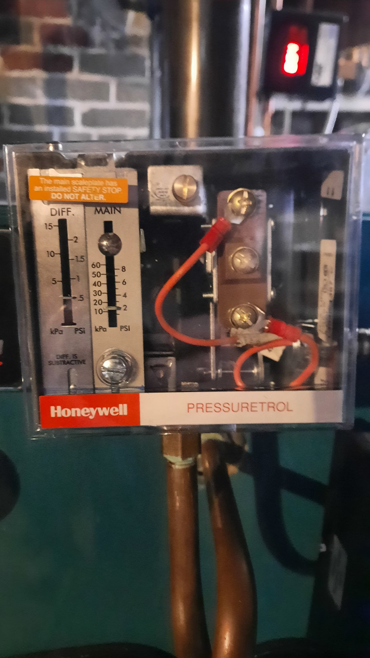

    We need to find out why you are getting water up into your main which is likely the cause of your vent failure, that or too much pressure. Start by taking some photos of your boiler from distance at multiple angles. Also include a photo of your pressuretrol and your main vent placement.

    Thank you, here are a few, if different angles will be better I will be happy to re-take these (the pressuretrol and PSI pictures were taken while the system was running).
    Also for context I forgot to mention our boiler is brand-new as of March 2024 if that helps at all.
  • dabrakeman
    Piping actually looks good.
    Do you see any surging in the site glass when the boiler is steaming, more than a half inch or so? How much skimming do you recall doing or having done when the boiler was installed?

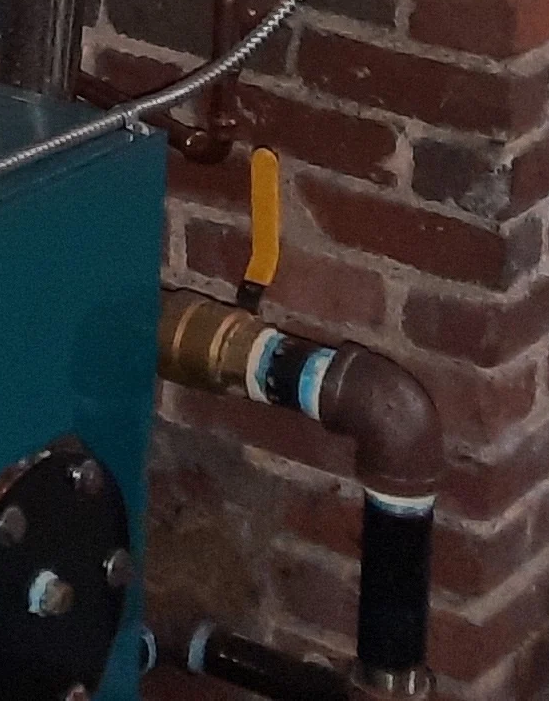

    109A_5 Member Posts: 4,067
    What is this valve for ? Is it closed ? I probably would have put the main vents up a bit vertically.
    ethicalpaul Member Posts: 8,850
    Skim tapping. Closed and capped.
    @ethicalpaul Ah yes, thanks, its an oil burner. Camera angle got me, when I first saw it I thought it was Teed into the wet return.
