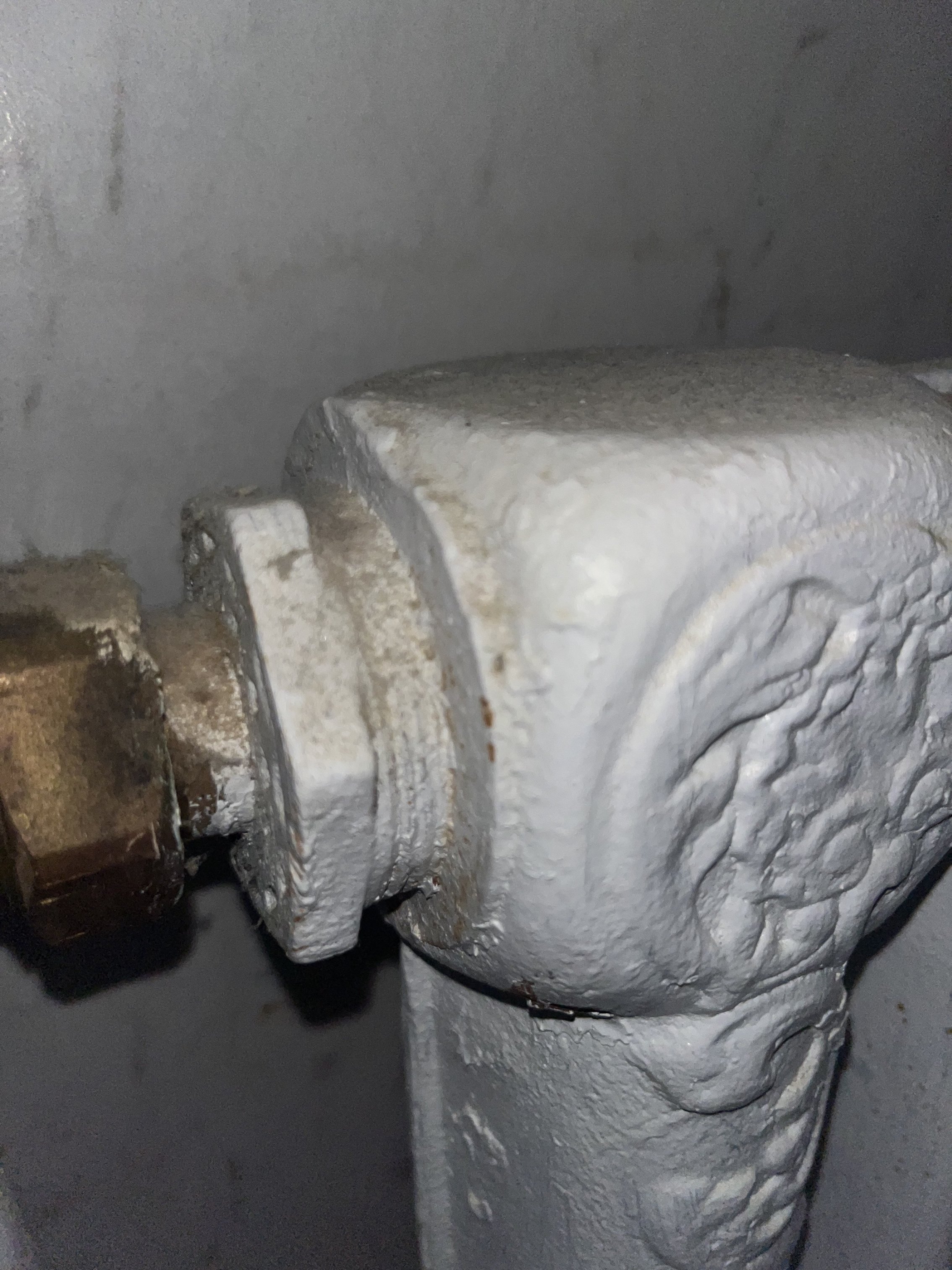

My house has been very unevenly heated in this cold winter. The third floor has been 5 degrees hotter than first floor (where the thermostat lives) on the very cold days. Some of the radiator valves feel like the mechanism is loose and others are such that closing them that little bit more will shut off the steam supply completely.
The situation made me think about replacing the valves, possibly with TRVs over the summer, Not sure what hornets nest I might be hitting with this project but I know that changing the radiator spud looks challenging.

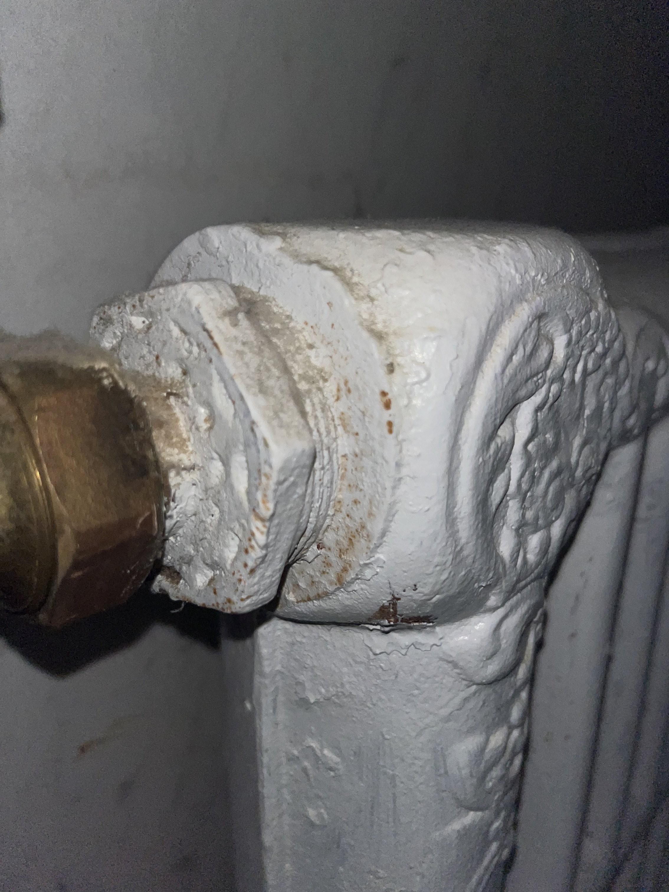

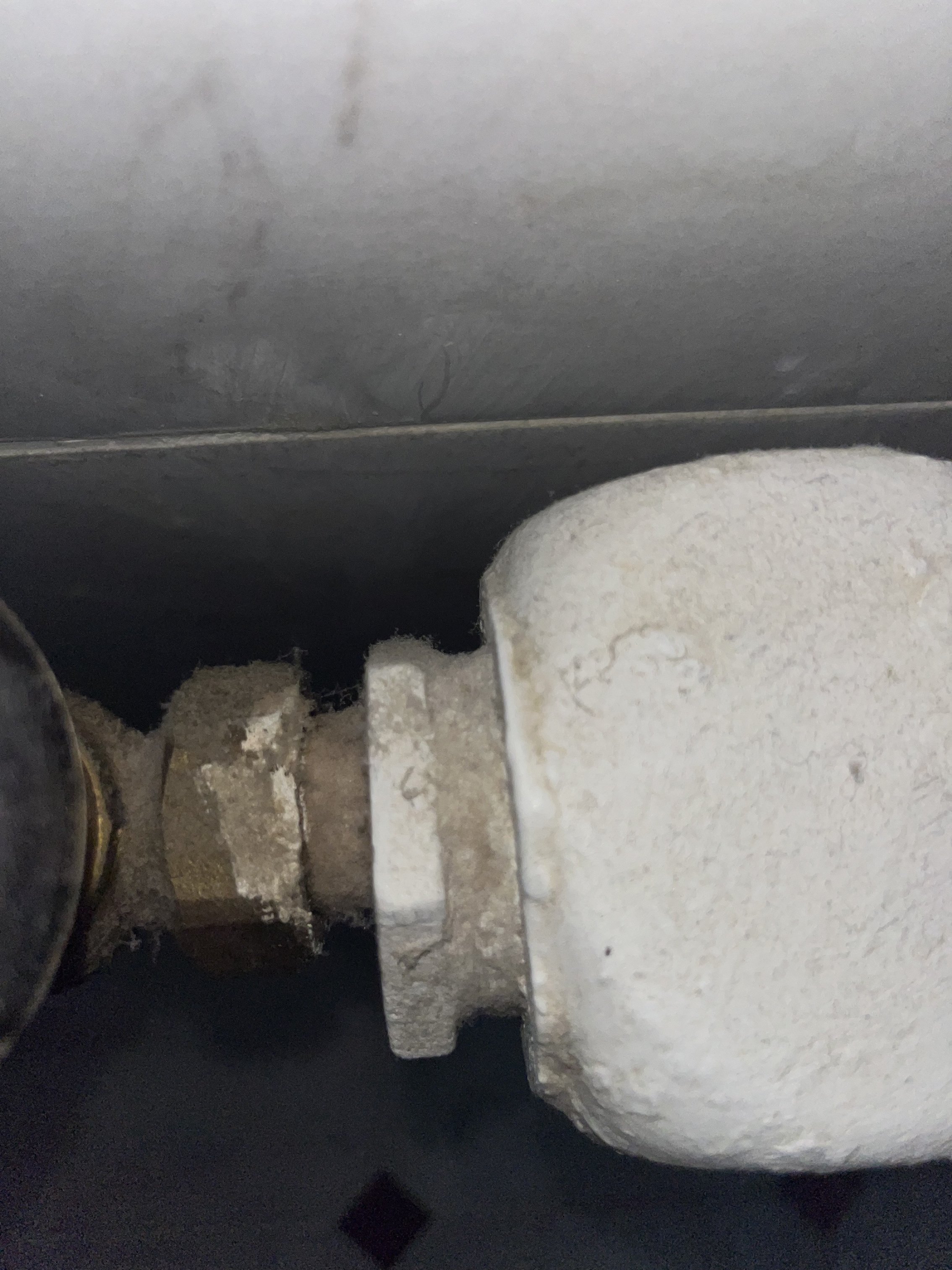

Heres a picture of one of my spuds. It looks like it is ‘cemented into’ the larger bushing which is threaded into the radiator. Notice the top view shows it is off-center so I don’t think it could be threaded in. Is this unusual?Thoughts?
Thanks.
FYI - system is low pressure two pipe (believed to be originally a Kriebel system based on my radiator elbows). Boiled is piped and sized correctly and does not build more than a few oz of pressure.

    Taking the bushing, or the painted part out could be a nightmare as you suggest. If you try to unscrew from the brass only you might be able to get them out in one piece. If not, cutting them out from the brass, is lesser of a problem and can be done with the right tools.

    what do you mean by ‘unscrew from the brass’? It looks to me like the brass part of the spud is cemented, not screwed into the large white bushing. That is really the problem I am seeing and was the meat of the question.
    My initial thought is to use TRV’s, which as far as I can tell means replacing the valve. Rebuilding the valve internals would probably be a lot easier and may help the situation but I am just assessing options right now.

    Its screwed in just years and years of paint.
    Find 2 BIG pipe wrenches. 36" or larger.
    Will probably have to carefully cut and chisel out.

    The brass spud is turned(screwed) into the bushing which is screwed into the radiator. The bushing in an eccentric bushing. The whole is off center. Normally one of those would be used at the bottom of the radiator to allow draining of condensate. In you case it isn't needed. Normally the opening would be at the 6 o'clock position yours looks like it's at 7? either case it's not important here.

    ahhhh…if its an eccentric bushing that explains it.
    so just unthread the brass spud from the eccentric bushing and hope it comes out easy.
    Ive read that spud wrenches often break. Would a 3/4 internal pipe wrench be the right tool?
    Otherwise its hacksaw and chisel, right?

    It's probably not coming out with out a fight. They rarely do. A spud wrench won't or shouldn't break but the tabs in the spud will snap off. Try it though.

    The only way to get those reducers out would be to cut them out and there is a small chance that the threads may be very damaged after they are removed. The brass spuds, however will come out if you can grab them to turn.

    "Is pulling these radiator spuds going to be a nightmare?" More like the Twilight Zone. A little bit of heat helps the medicine go down, the medicine go down. Heating the boss expands the metal and then use your wrenches. Even heat all around is best.
    Larry Weingarten
    3/4" spud is usually not a big deal. Try a spud wrench and the tabs may break off or it may work. If that fails cut the nut off so you can get a pipe wrench on the spud. Before you try find a piece of steel rod, or threaded rod or or the handle of a cold chisel anything you can put snugly into the spud so it won't collapse.
    90% of the time they come out

    Most radiators old enough for a new valve are probably going to stubborn enough to have frozen spuds. Maybe you can get lucky with a spud wrench….but you'll more than likely have to do it the hard way.
    Flip the radiator upside down so you can use a small hand saw and cut through the spud on the top-side of the radiator (now facing the floor). If this is a two-pipe radiator and this spud is on the top-side of the radiator you don't need to flip it upside down.
    Make two cuts, about 0.5-1" apart being careful not to nick the threads of the radiator. Punch the small section you just cut out. The spud should now turn easily.
    If you nick the threads it isn't the end of the world. There are a number of easy ways to fix that. Generally run an NPT tap through there to clean up the threads and remove any burrs. Use extra HD teflon tape and some pipe dope. If the nick is really bad you can use pipe-thread-wick or even some high temp RTV.
