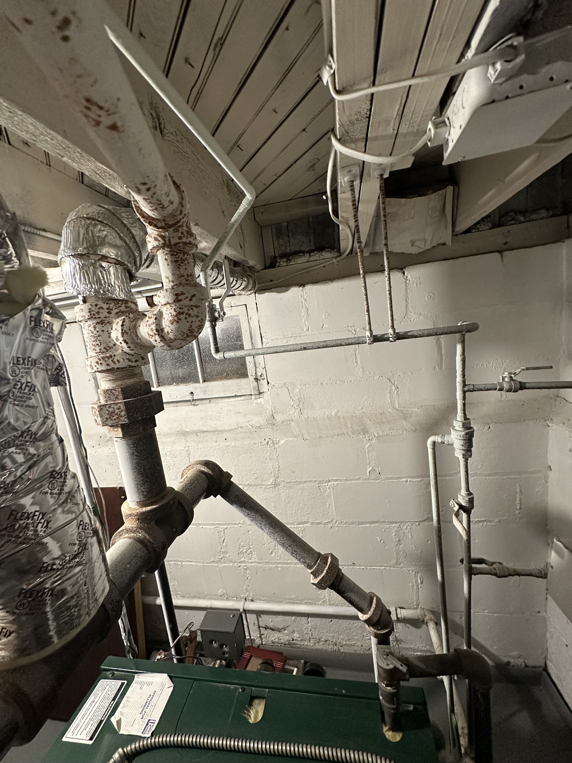

Hi there, we have a 1 pipe steam system and when it's especially cold weather e.g. -15C/5F, upstairs gets really hot. We are trying to mitigate using our central fan but it's not a good solution.
I currently have 5s on the rads downstairs and 6s upstairs although I think the overriding problem is that we don't have a vent on the main.
Hoping someone could confirm thatand let me know where the vent should go. Is it a DIY job?

    The main vents should go at or near the ends of the mains — it looks as though you have two of them.

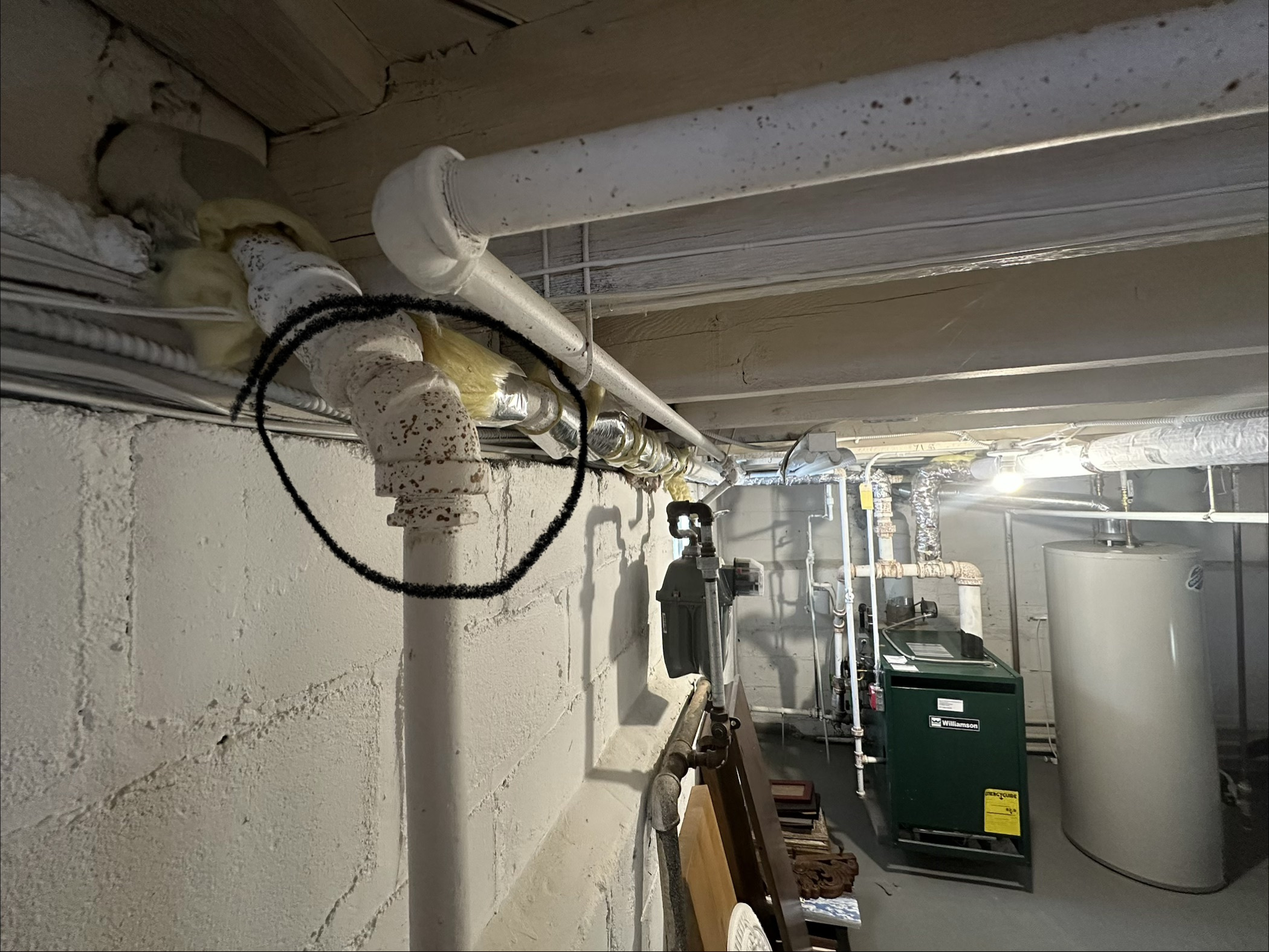

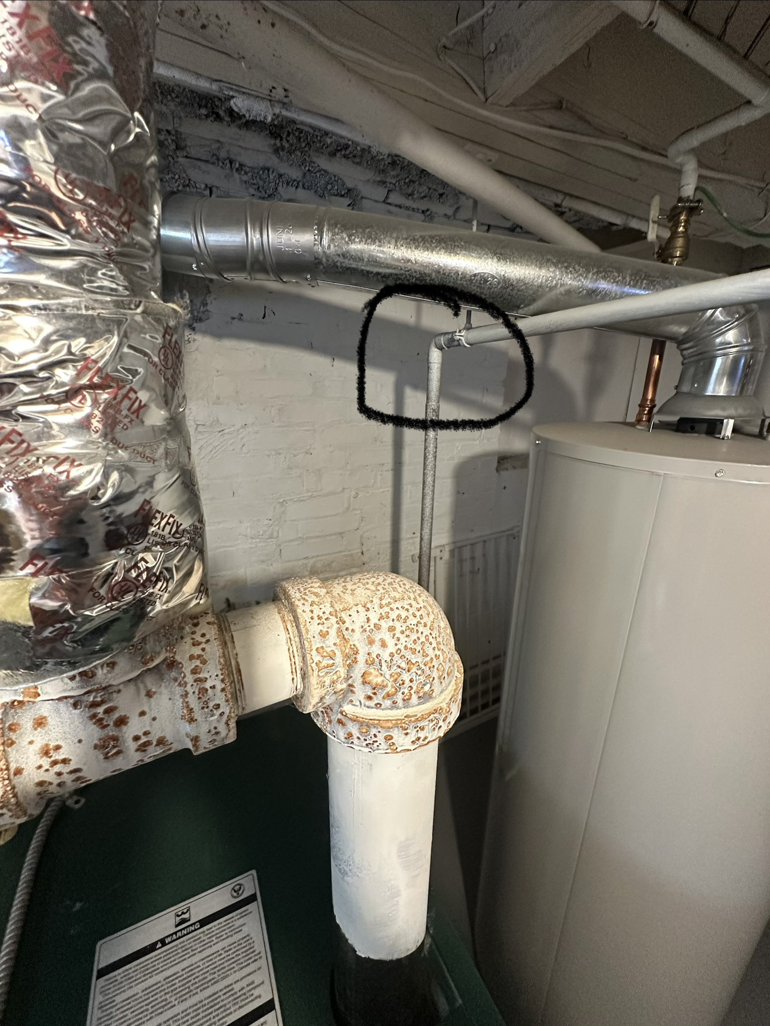

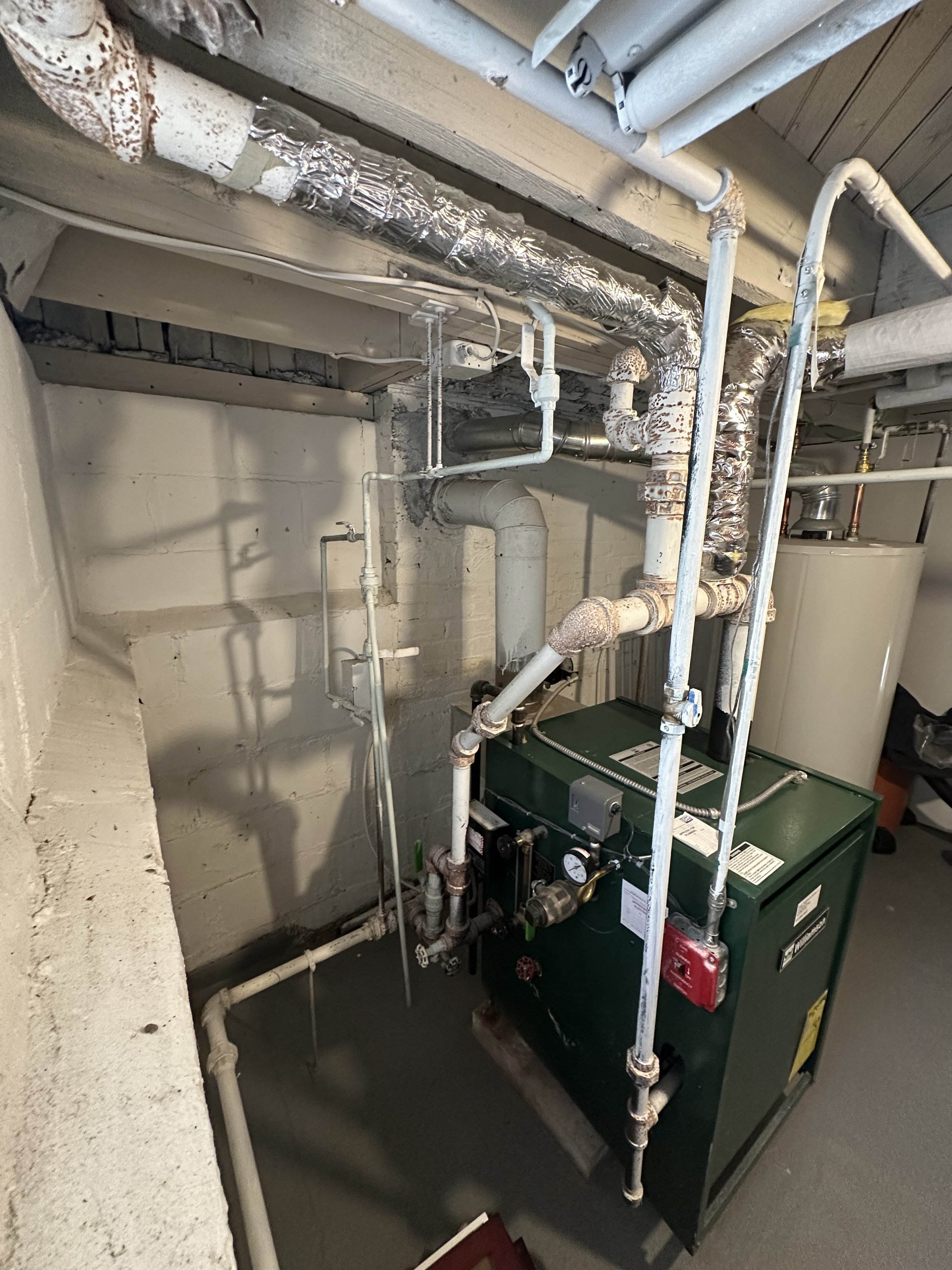

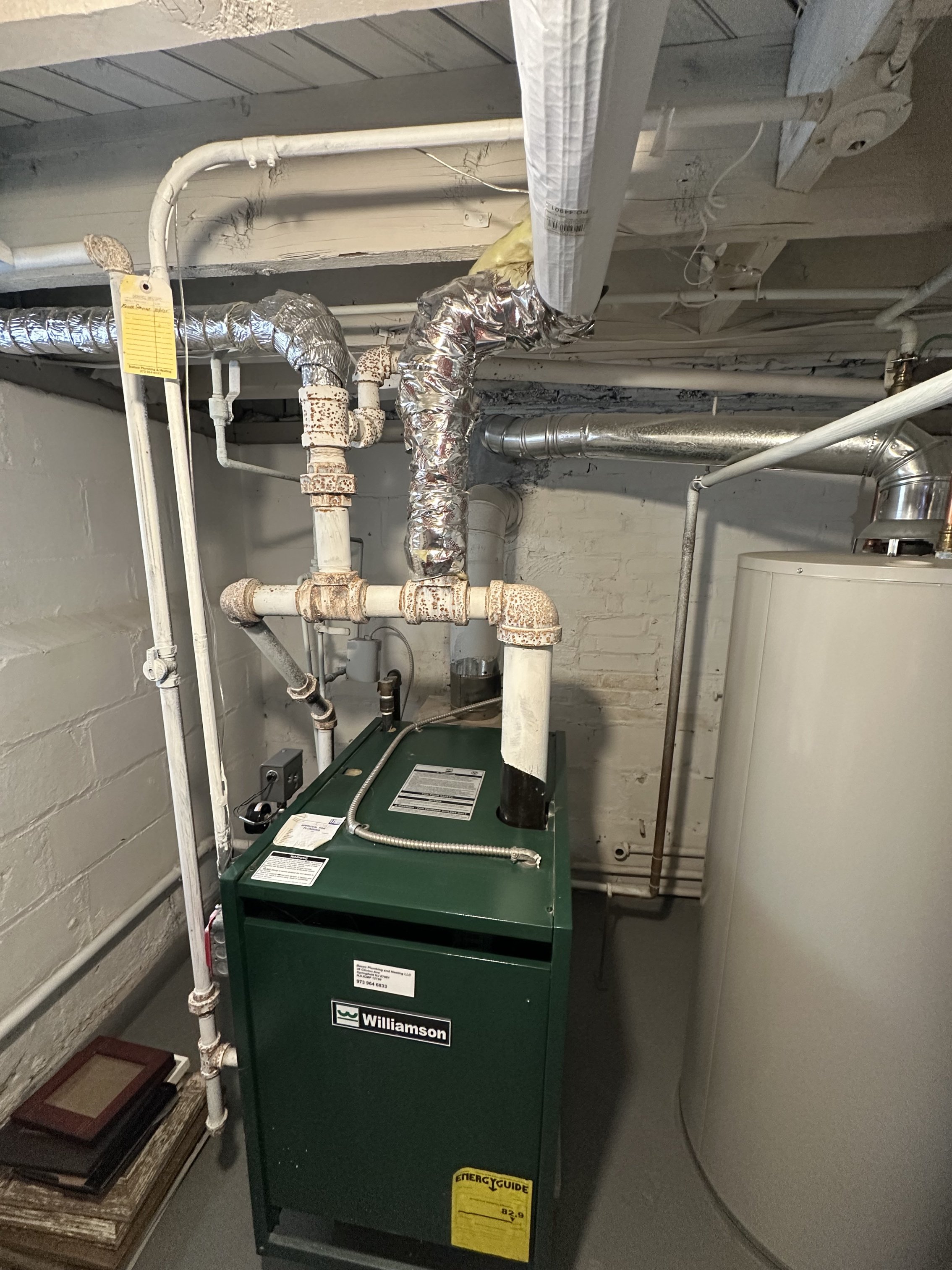

    I am still struggling to understand where the "end" of the main is and where the main vent would go. It seems we don't have one so maybe I just need to call a pro to get one installed. Should they go in the two circled locations?

    you also seem to have 3 mains at the boiler but 2 of them are teed together just above the boiler, that can cause balance issues between those 2 mains.

    Now its time for main venting. Follow the wet return. When it 90s to the ceiling, you found the end of your steam mains.
