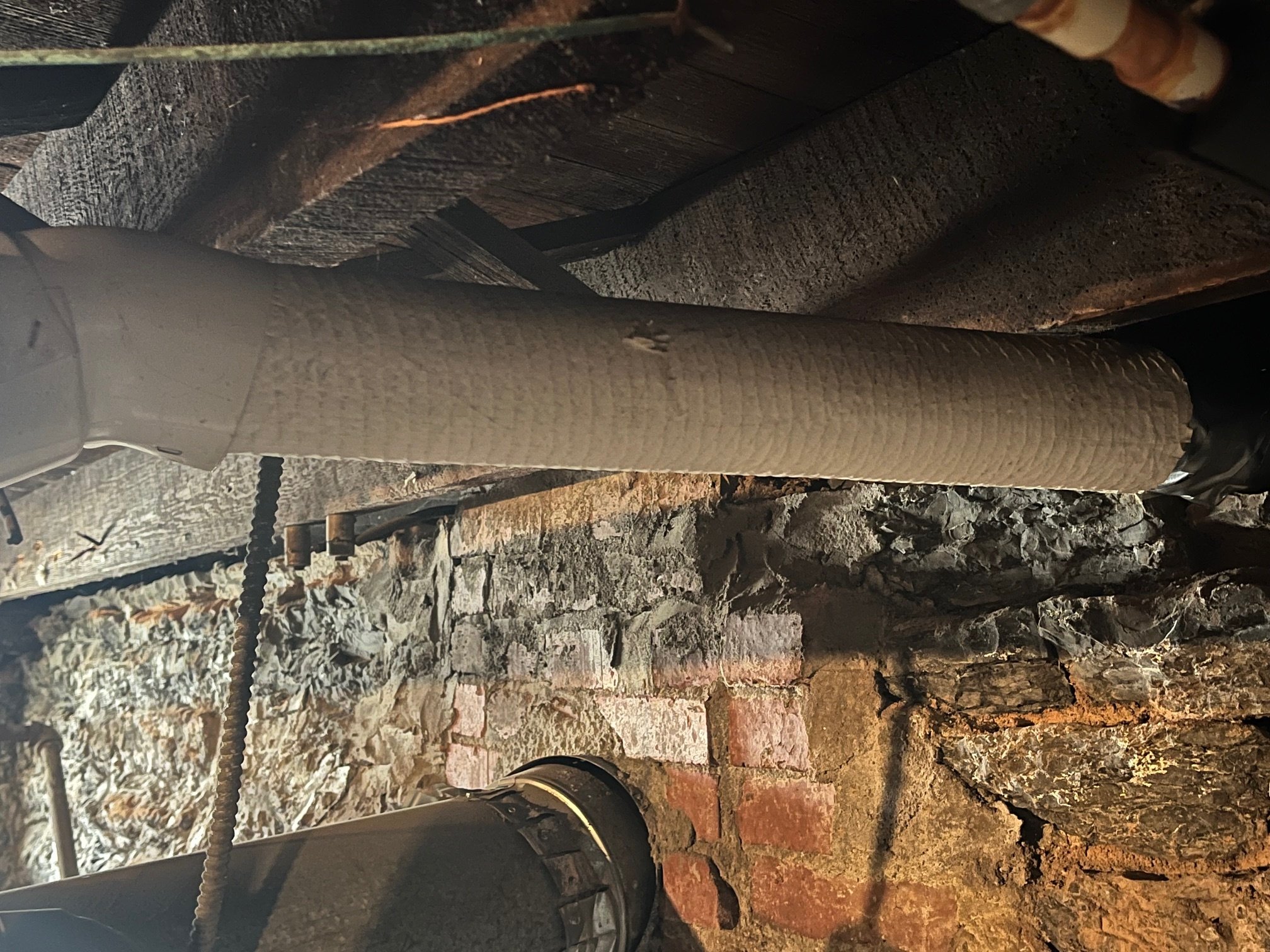

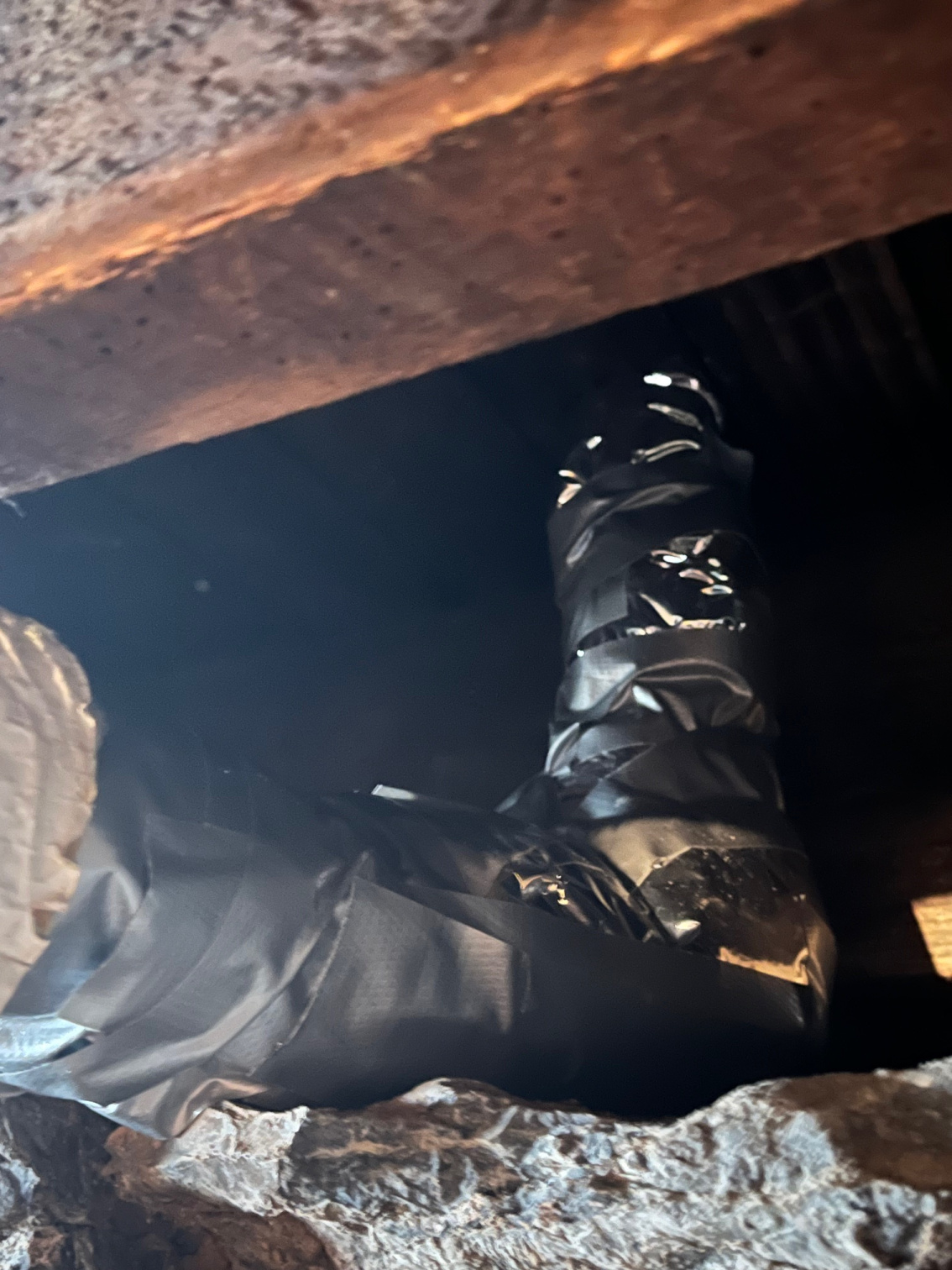

    @Grallert - as far as I can tell it is pitched down toward the main. There isn't a lot of run there so I'm seeing if I can lift the vertical supply any further and then put the radiator itself up on a wood platform.
    The elbow section didn't have any insulation, so I put 1" fiber glass (the proper heat rated version) around the whole thing, and I've ordered the regular white insulation sleeve to put there long-term.
    I think the hammer is right at the elbow. Because it is very audible on the 1st floor.
    ethicalpaul Posts: 9,076
    that’s where the water is collecting, cooling, then collapsing the steam that hits it at the next call for heat, then gets slung against the pipe.
    edited February 4
    You can try to lift the radiator a little at a time (like 1/4" to 1/2") to try to "undo" the likely settling that caused the water trap to form.
    Gently but firmly pry it higher with a 2x4 on a fulcrum then put shims under the feet. Lift it equally on both sides, the pitch of the radiator doesn't do anything. Try to lift it a little more every few days or so. You can only lift so much though before something won't let you lift more.
    I have had some success with this…it went from banging to more like gurgling (before I completely repiped it).
    I can't tell for sure from the pictures, but I'm not thinking it's the main that has to be lifted, but rather part of the "runout" (the supply pipe to the radiator that branches off of the main) that had the settled part in it
    And I can sympathize about lack of flex. We hear about "swing joints" but after a decade or ten they get rather unswingable.

    "I can't tell for sure from the pictures, but I'm not thinking it's the main that has to be lifted, but rather part of the "runout" (the supply pipe to the radiator that branches off of the main) that had the settled part in it"
    This. it's in the takeoff.
    Also I might have misunderstood your use of "main pipe". Don't disconnect the radiator, use a lever under the radiator to raise it and its supply pipe. If you disconnect the radiator, you will have nothing to hold onto.
