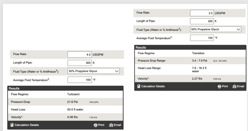

    Cold glycol is tough to pump, so as RWT goes up the glycol is thinning and getting easier to flow. So it takes time to ramp up the mass.
    A 5" slab needs @ 10 btu/hr./ sq ft to increase 1°F
    3200 sq ft @ 5" slab is about 46 yard of concrete X @ 4000lbs/ yard=184,000 lbs of concrete X .21
    If you had a measured accurate flow number
    BTU = 442 X f X ∆
    Example below of 3/4 pex at 4 fps velocity limit
    and more reasonable 2.5 gpm= 18' head

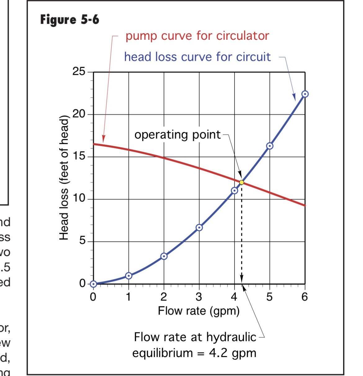

    The pump curve doesn’t tell you what flow you end up with.
    An OP operating point is developed by overlaying the system curve on the pump curve, where the lines cross is where the system actually operates
    I would swap the pump and call it a day🫢
