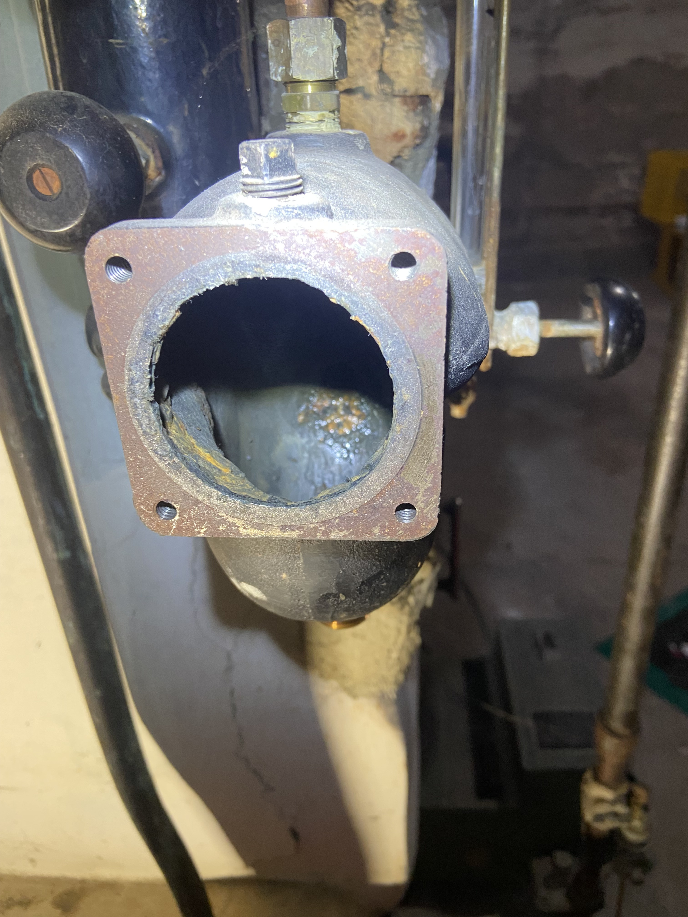

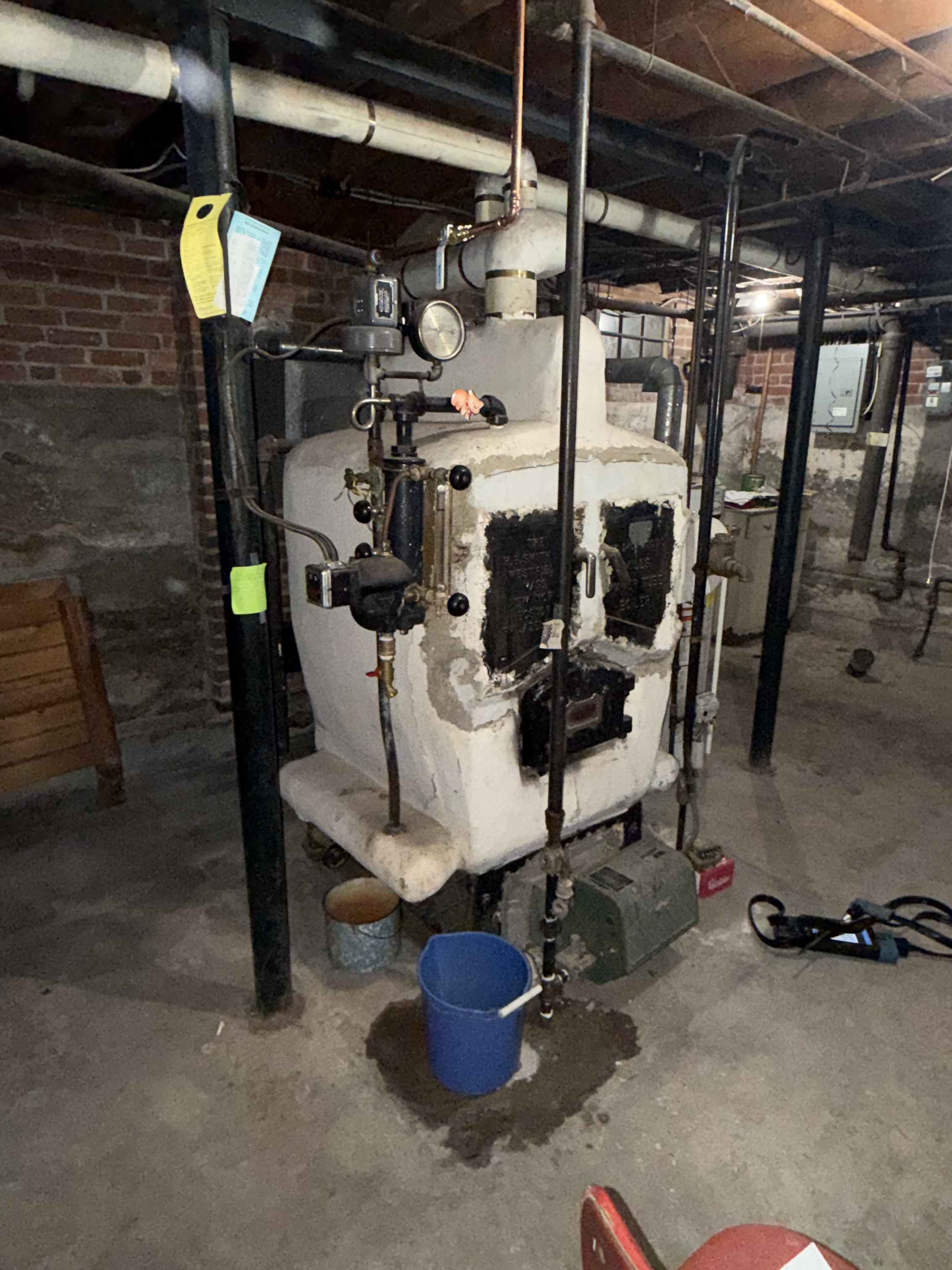

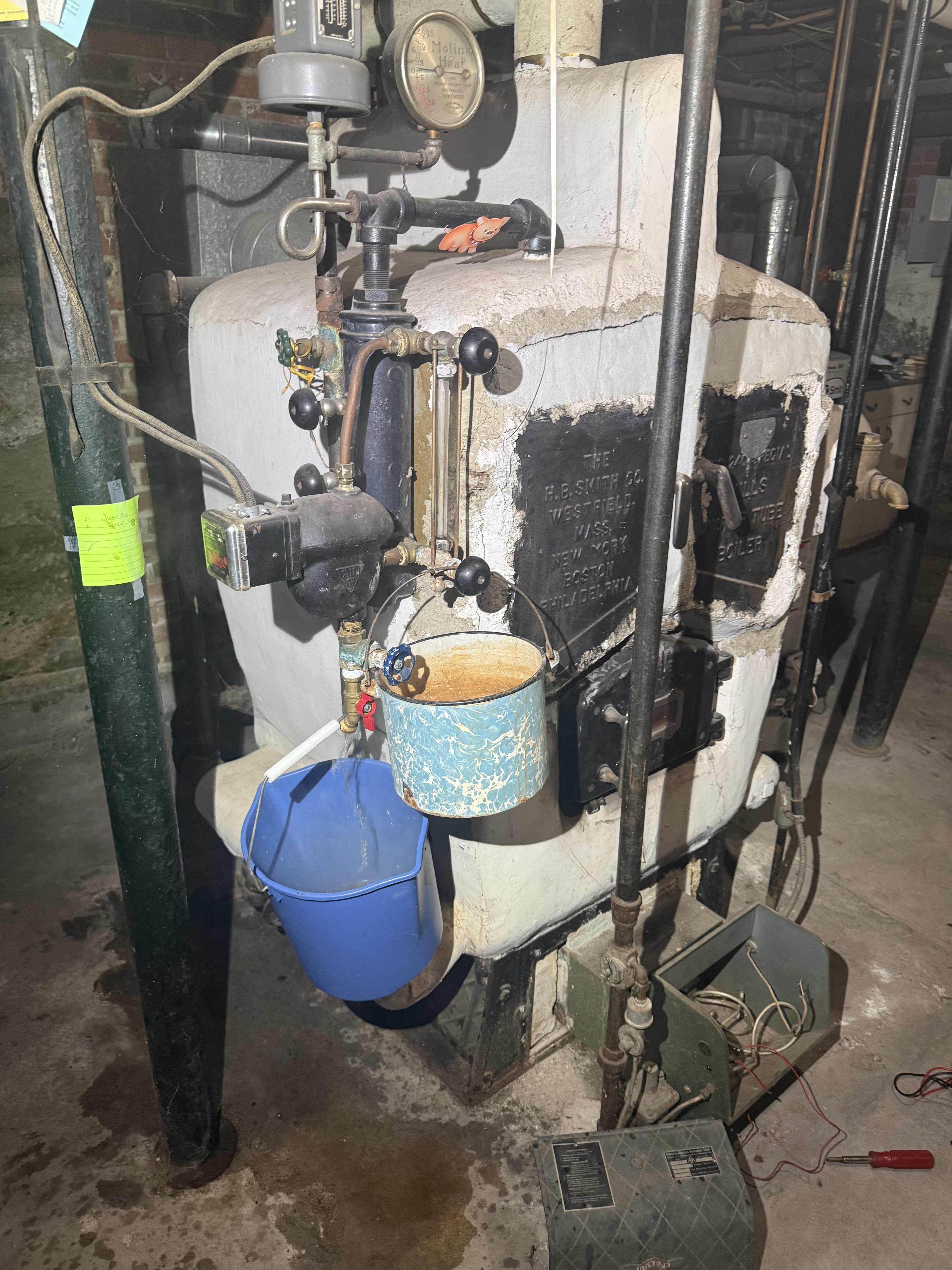

is there any likelihood I could rebuild this low water cut off?
Or, chuck it and put on a 67
it’s a millivolt so that adds to the joy
The lady somehow overfilled the boiler, I took 20 gallons out of it, brought it down to the very bottom of the boiler still wouldn’t shut off.

    it is millivolt but it is all wired in romex?
    you could probably take it apart and clean, the float is probably just hung up on muck it although replacing it with a MM would be a great idea for safety reasons.
    GW
    Steamhead Posts: 19,007
    That Watts hasn't been made in a long time. Get a 67-G, not a regular 67- the G is millivolt rated.

    Disconnect the copper tubing off of the top and use a hose from a sillcock or any source of street pressure and run water through the top. That should flush the thing clean and get it working.

    I have cleaned my M&M 67 twice in 50 years. I bet that LWCO could be cleaned, you may have to make some custom gaskets. I stopped using the paper gaskets, although they are available for the M&M 67. I made reusable gaskets out of 1/32" silicone rubber sheet material. Makes the job easier.
    edited January 27
    @GW the Watts is still listed on their web site. Don't know if parts are available. looks like a Smith model 24. They lasted forever.
    How many wires into the LWCO. That looks like K & T wiring or maybe old Romex.
    Vapor system.

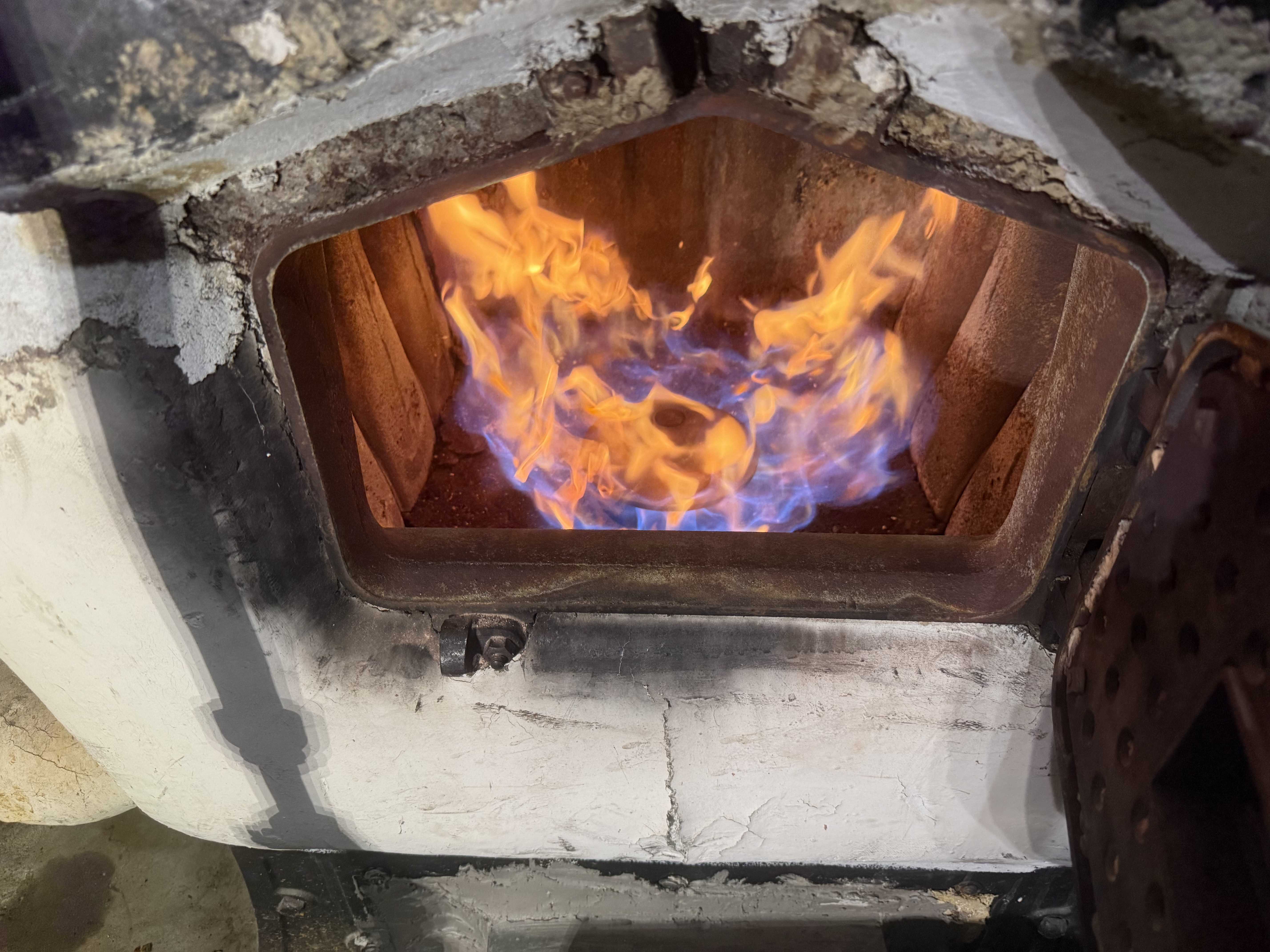

    GW Posts: 5,259
    Tim I should have taken more pics. The blast tube sends fire and hits the cast iron tripod. The power pile does not seem to get too much pilot. I’m getting like 510 mv when the powerpile is connected to the gas valve (stat and safety’s disconnected). My issue is the mv plummets after a heat cycle. So I’m reluctant to test mv droppage across the stat and safeties because the darn burner won’t come back on for a while ( could be minutes, could be hours).
    Do you have experience with converting to 24v? Any pitfalls that can bite me?

    are you getting that from a new thermopile?
    read starting around page 6 of this:

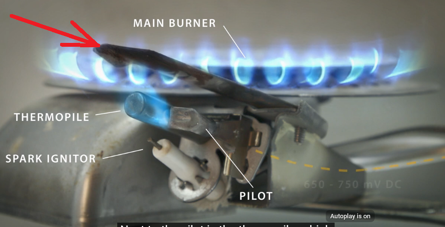

    you may need to shield the base of the thermopile from the heat of the burner because it generates voltage based on temp differential
  • GW
    GW Posts: 5,259
    yes, new. It’s a head scratcher. I think the gas valve may be getting tired.
    most concerning is the powerpile is in the heat of the “blast”, I’m unsure how the original set up was configured, how the pp didn’t get hammered with heat
    the boiler seems like it will last another 100 years, but keeping the old beast running and running safely is getting to be a challenge.
    I can throw time and parts at keeping the pp system or maybe change to 24v. But the powerpile or thermocouple will be hammered with heat regardless
    Switching burners is an option perhaps. I would have to get a metal guy to make a setup to hold the new conversion burner on the “mid section”, all semi sketchy and time consuming
    Or I tell the nice old lady “this is too much effort- if you want the question marks to vanish we need to slide a new boiler in there “. In which case I would then need to deal with the vapor system aspects.

    look at the last page of that sheet for the thermopile where it talks about building a shield to draw excess air over the base of the thermopile. the voltage is generated as a result of the temp differential between the base and tip. if the burner is heating the base the output will fall.
    109A_5 Posts: 4,759

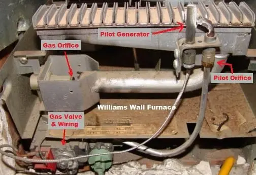

    The newer electronics version of a hot water heater tank gas valve that has the power pile has what it looks to be a heat shield, like @mattmia2 mentioned. If the heat shield is missing in this unit that may be the problem. I'll try to find a picture later today.
    there is a diagram in the honeywell tech sheet i linked to

    yes I looked at that this morning. Are you familiar with upshot burner. The power pile is completely immersed in fire. A water heater is much different than what I’m describing.

    Another example. See how only the upper half of the power pile gets heated by the flame, primarily the pilot flame. Sounds like you are fighting a situation where the power pile positioning was never set up correctly.

    yes, those illustrations , but that’s not what I’m describing at all. If you’ve ever seen this burner in real life, you would see what I’m trying to explain.
    I’m in a little bit of a corner, 1/2 of me is trying to keep this old boiler going. The other half of me is trying to keep the 8 lady from freezing.

    Guess they don't make upshot burners anymore. The only one I saw was an Adams and based on one of their oil fired furnaces I installed I would buy NOTHING from them.
    In the old days we would take the fire door off and fill the old ash pit in and fire a burner through the door. Problem with that is asbestos removing the old burner etc, Carlin EZ gas.
    GW
    it's like one of those weed burner torches pointed up at a disc of either refractory or steel/iron. they had some way of keeping the cool end of the thermopile cool, @Tim McElwain will know exactly how they did it, a few other old timers here might know too. a part might be missing or be a pile of rust in the bottom of the boiler or it might not have been reassembled in the right position 30 years ago. you could replace the valve with a modern combination standing pilot total shutoff 24v valve if you know enough to get the combustion set up right afterward. you'd have to replace the t-stat with a 24v t-stat too, not sure if the other controls are ok with 24vac on their millivolt contacts but the anticipator in the t-stat won't work righ on 24vac.

    OK I was mistaken——the Power Pile is not completely engulfed in the flame. It simple bewildered me and my memory was not accurate. I was there today with my lead guy he was there all day and I wad there 1/2 day, to change the gas valve! Yes, that's right about 11 or 12 man hours to change a valve. It was not cake.
    We put in a RobertShaw valve and we tied the PowerPile to the gas valve, not the full-time gas line off of the gas supply.

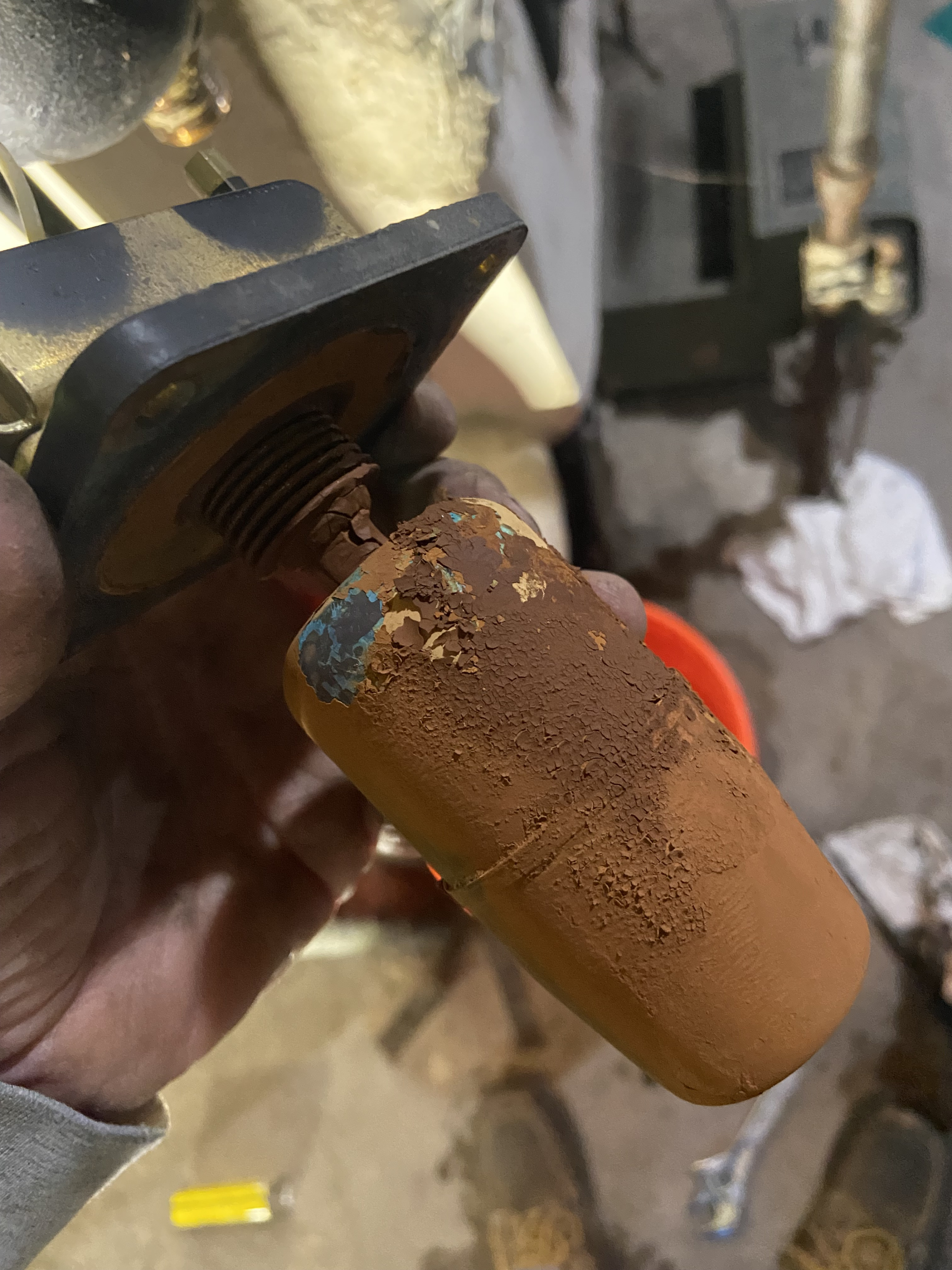

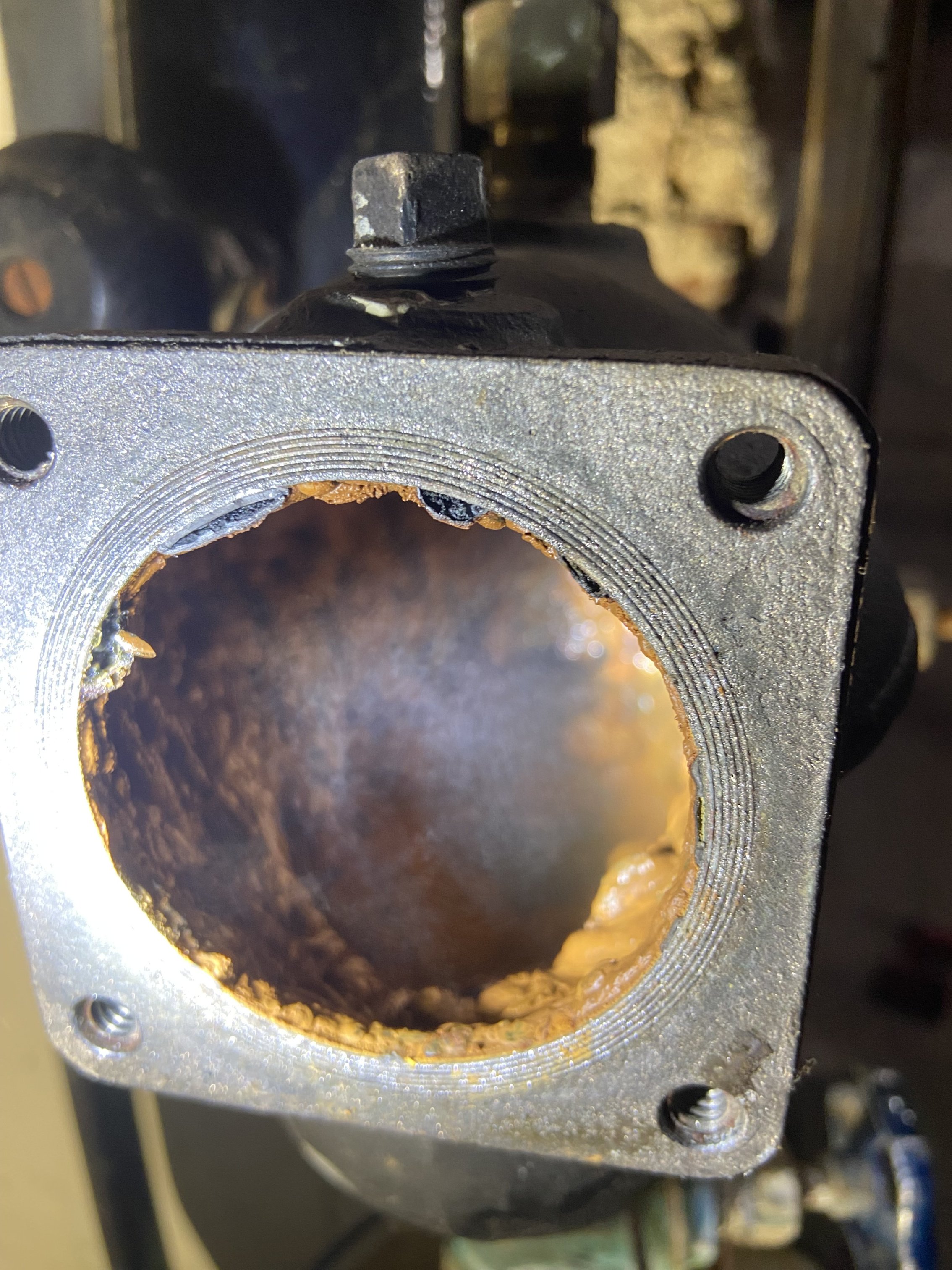

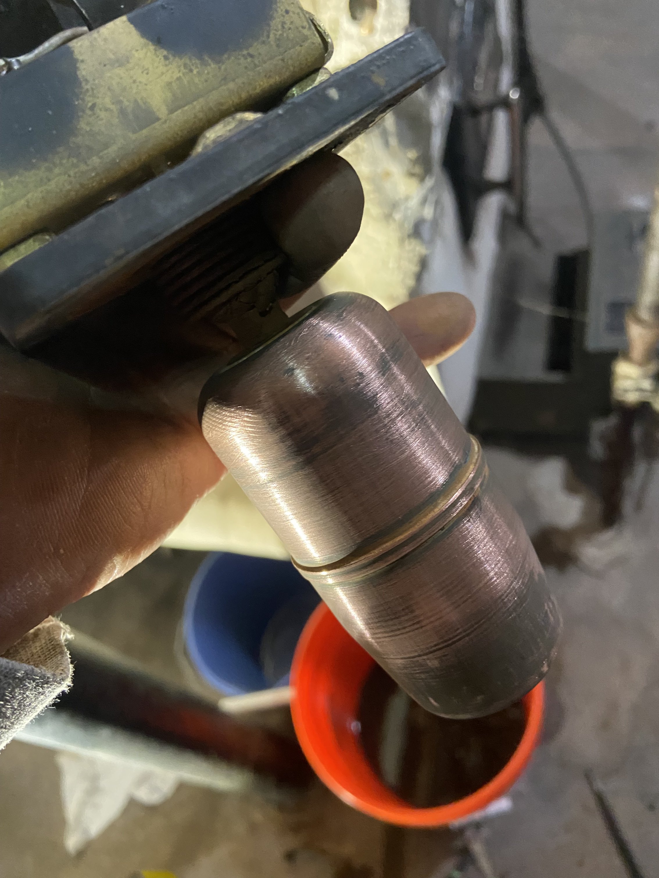

    OH- and the LWCO now works too. My other lead guy opened up that bas larry and cleaned out out, cut a new gasket, all good. It's super peculiar, the low water drops the flame before the water gets to the bottom (where the float actual resides). I can't wrap my head around it. But we dropped the flame out once and we beeped it twice, so it's good to go.
