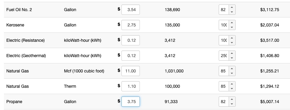

    Using last weeks energy costs for CT. Your actual prices may vary. Both operating at 82%
    EIA has fuel costs dating back as many years as you want to look.
    Oil is the clear winner. Crunch the numbers to see at what $$ LP would be the better choice
    LP in my area is currently $2.27, heating oil $3.65
    www.coalpail.com for energy calculator

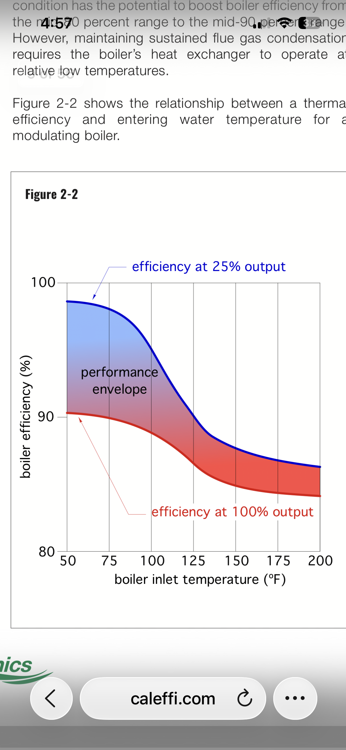

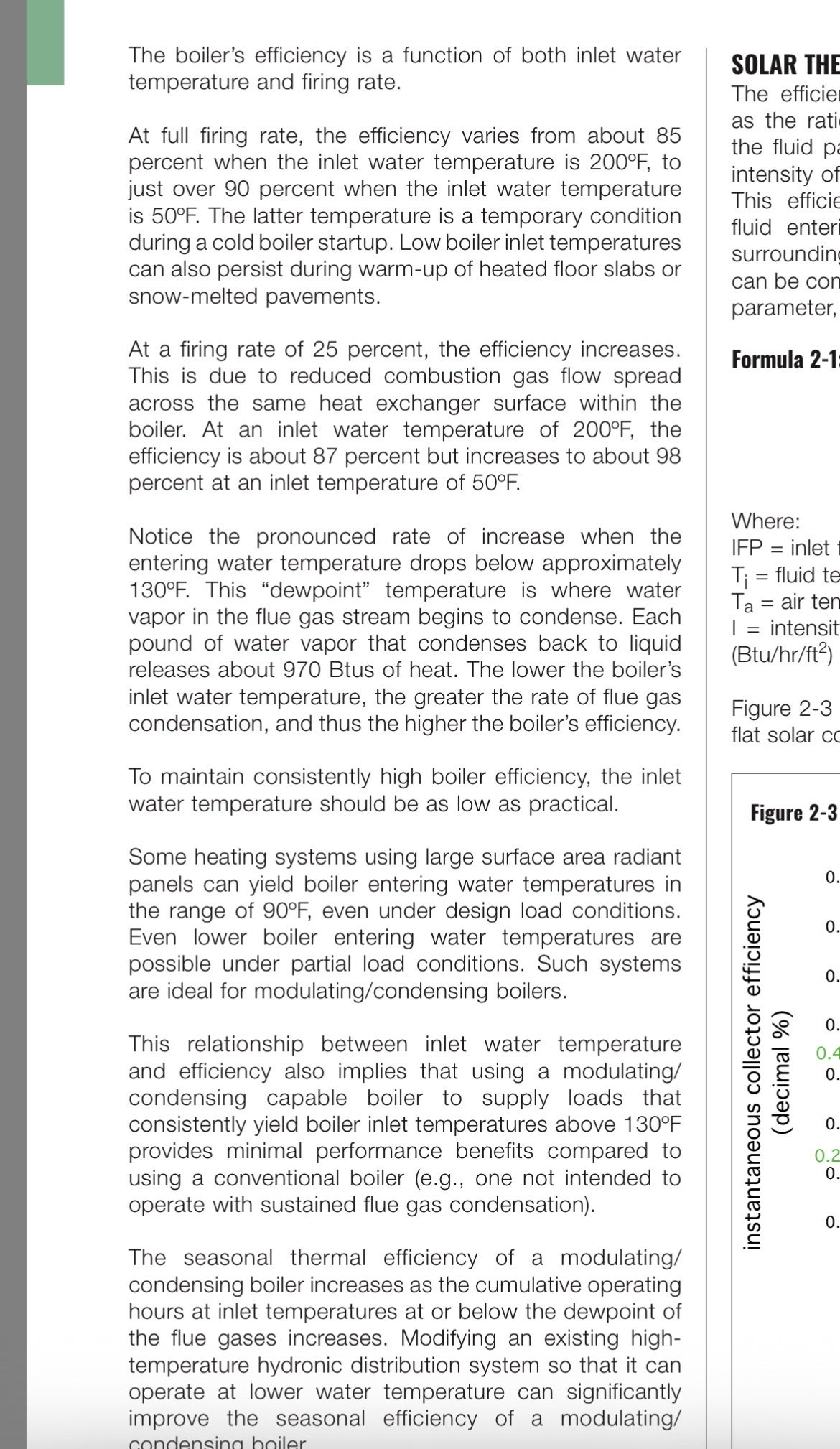

    hot_rod Posts: 28,705
    actually even at high operating temperatures the mod con efficiency can be quite impressive
    Low return and turned down burners gets you into 90%+ efficiency. 50 degree return at 25% modulation is at the top efficiency
    So the rumor about oversized mod cons doesn’t actually pencil ✏️ out
    Example from Idronics 25
    Do your sums very carefully… but I think you will find that oil is going to beat LP anywhere in Connecticut., even supposing you can get the extra say 8% condensing all the time. Which you won't.

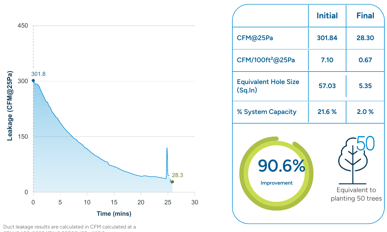

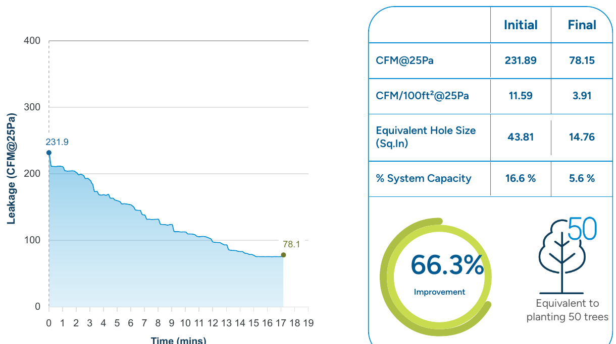

  • @MaxMercy you might want to consider aerosealing your ducts. These are screenshots of the CFM loss reduction before and after for our two air handlers. Our blown in cellulose in the attic also covers the ductwork, which should reduce unwanted heat loss/gain as well. This was essentially free for us to do in CT after energy improvement rebates.
  • MaxMercy
    MaxMercy Posts: 632
    Yeah, I've seen them, but just because they waste a ton of money doesn't make me feel better about wasting mine.
  • MaxMercy
    MaxMercy Posts: 632
    Aerosealing is part of the plan, yes. I've already sealed my basement ductwork seams with the brush-on goop in preparation for insulating them (another thing they didn't do in the 1990s in CT… )

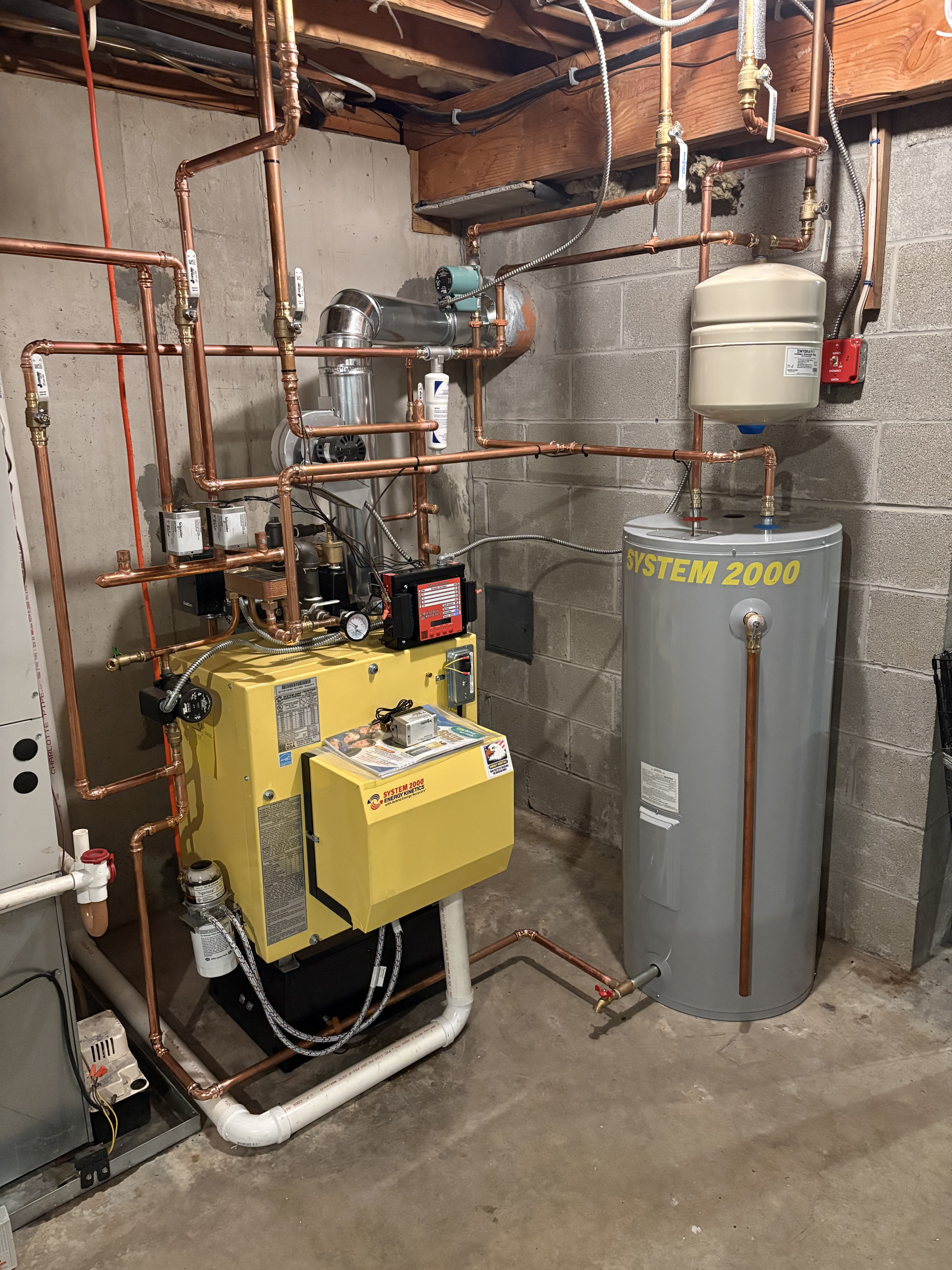

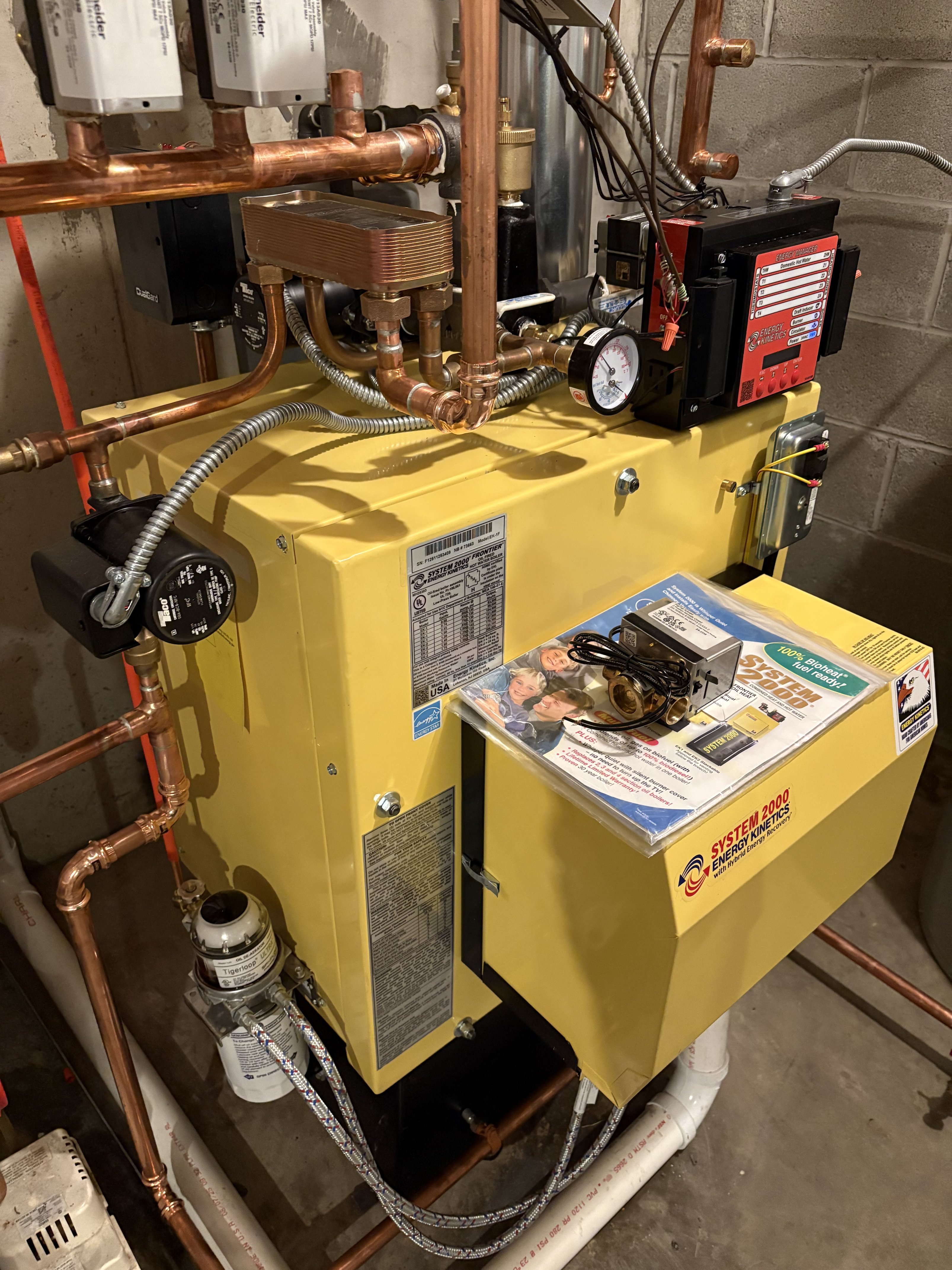

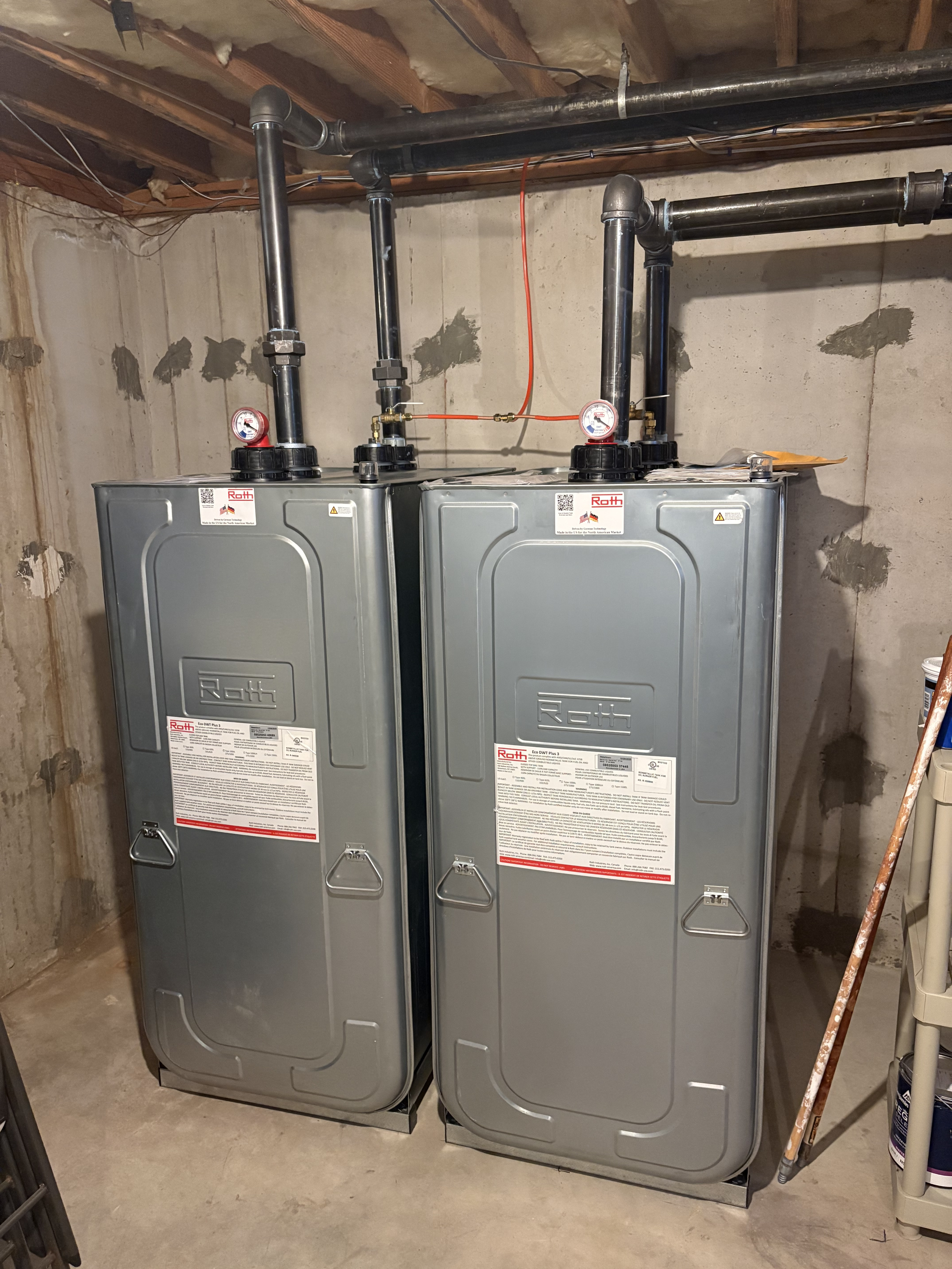

  • For anyone interested, I have attached photos of our end result on new tanks and boiler. Thanks again to @Roger and all for the help and advice.
    RobertwHarvey RamerHVACNUT
  • Nice!!
    HVACNUT Posts: 7,784
    Very nice work. It's good to see they didn't use the Roth tank twinning kit and ran separate fills and vents. Boiler piping is nice. Everything that needs support has support. There's room to get behind the boiler if needed. Very nice.
    Why the power vent? Long horizontal run?
  • @HVACNUT I am not sure about the vent. There wasn't one before - is this standard on new EK installs? I was also not expecting to see the inline filter on the domestic water inlet line coming to the circulator. Is this just to prevent sediment in the storage tank perhaps, like anything not already captured by whole house filtration?
  • Roger
    Roger Posts: 494
    Thank you for your post, @ctboiler28 . Inducers are sometimes used based upon site specific conditions. I've reached out to your territory manager to find out more.
    The "filter" is not actually a filter, but an NSF rated Scale Stopper which prevents mineral buildup on the plate heat exchanger and in other areas of the system. It works up to about 25 grains of hardness and is a great combination with our Sealix non-stick silicon dioxide coated plate heat exchangers to provide long term reliable performance in hard water conditions.
    Best,
    Roger
    President
    Energy Kinetics, Inc.

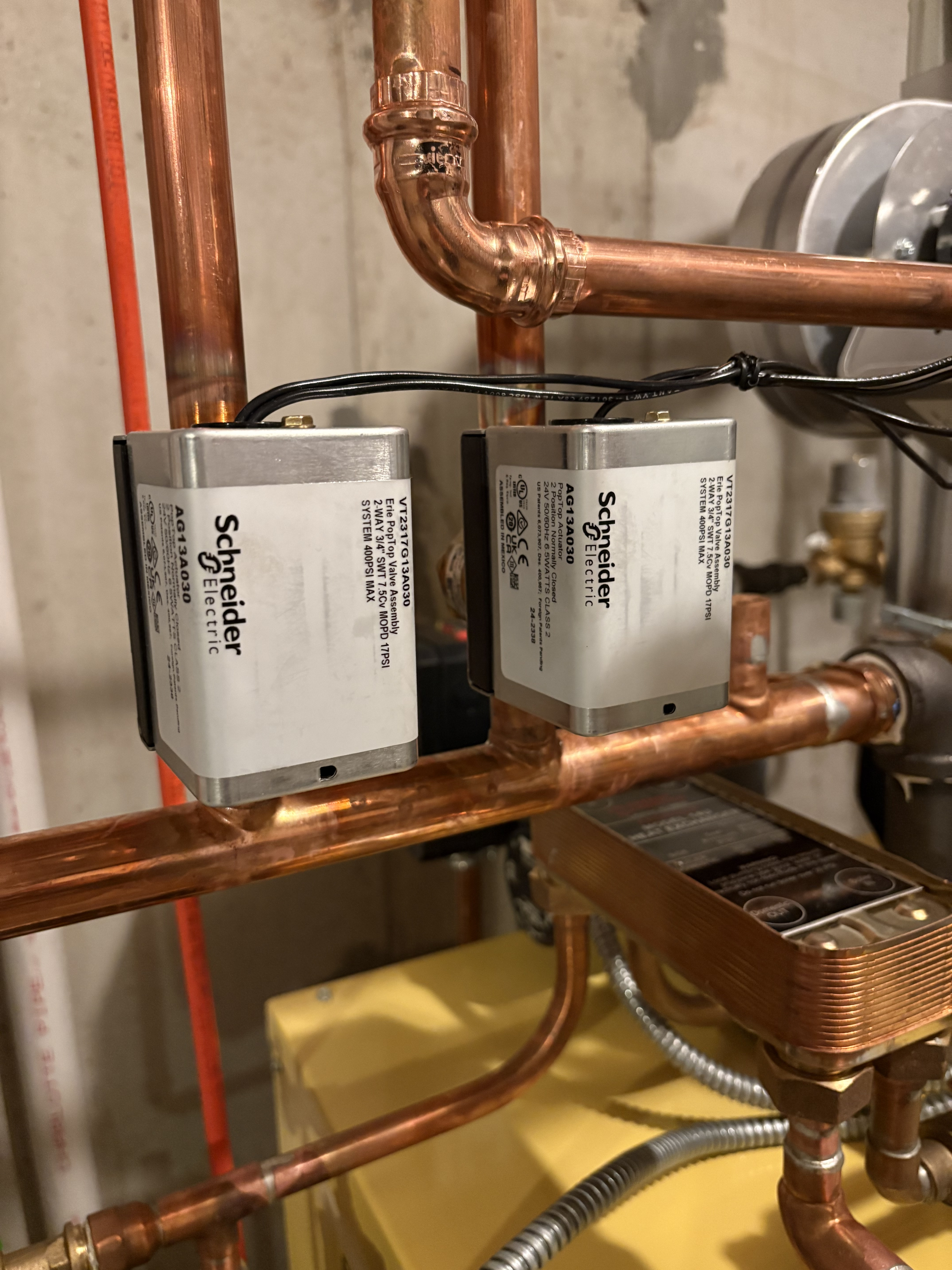

  • Update on a minor issue with our install. I know from @Roger 's previous comment here and from reading other similar forum posts that EK recommends wiring the air handler fan to the end switch on the zone valve for hydro air (essentially a NO contact that closes when the valve is energized). I didn't check this closely enough on day of install and didn't notice until I was watching the operation of the unit more closely yesterday that the air handler is shutting down right after the signal from the thermostat goes away (e.g. T2 on energy manager) even though the valve (e.g. Z2 on energy manager) is staying on for a further 5-10+ minutes. The result is that the blower cycle pushing air into our heated space is rather short compared to the boiler cycle and the thermostat calls pretty frequently. Meanwhile the zone valve never shut while I was watching it, because the thermostat initiates a new call for heat before the zone is done purging.
    Below is a picture of the zone valve wiring. I assume there should just be an additional 2 conductors coming out of each valve (wired to end switch contacts) that wire to the appropriate points on the fan coil.
    The air handlers are First Co. 36VHBXB-HW. We need the thermostat to still signal the air handler because it also controls the fan for cooling in summer. With this air handler model, can the installer just wire the zone valves to the fan in parallel with the thermostat's connections, so that a signal energizing from either the thermostat or the zone valve(s) keeps the fan on?
    So the thermostat's initial call for heat energizes the fan (may be some cold air blown while the boiler preheats depending on its state at that moment), but then the zone valve keeps the fan energized after the thermostat is satisfied, until the zone valve turns off at end of thermal purge?
    When I spoke to the installer this morning, they were not sure how to handle this offhand but are coming back tomorrow to look at it.
    Those look like two wire zone valves? If so there is no NO end switch available.
  • Taking a quick look at the valve catalog, it looks like the part numbers that have an end switch end in a "A", which this one does not. I can open one later and check to confirm. I am surprised it does not have the end switch included if that is the recommended way to wire these for hydro air. Could they instead double tap the right side outputs of the energy manager to energize both the zone valve and the fan directly?
  • Roger
    Roger Posts: 494
    Thank you for the information, @ctboiler28 . Our territory manager, Mark Santangelo, is working with your contractor to facilitate this correction. I trust all will be as it should be soon. If you'd like to reach out to him directly to find out more, he can be reached at msantangelo@energykinetics.com , or reach out to us at (908) 735-2066.
    Best,
    Roger
    President

    Thank you, @RascalOrnery . The higher efficiency is delivered through thermal purge, which only integrates well with a low mass boiler. The control to make it work is built into our Energy Manager, and the tank is specifically designed to integrate with the boiler, control, and plate heat exchanger. Energy Kinetics makes all of these work together. We do offer our Hot Water System "A" Tankless Coil upgrade system; this works with tankless coil boilers, and will only thermally purge once the boiler is also upgraded to a System 2000/Frontier or any of our other boilers with an Energy Manager.
    The reason why thermal purge works with a stratified tank is because the boiler can thermally purge down toward the make up water temperature (maybe 60°F) instead of the temperature that the coil in the tank is exposed to (maybe 140°F). This means the boiler finishes cold (heat energy is recovered after the burner shuts off) and the tank finishes hot. I went into detail on this in another HeatingHelp post here.
    Best,
    Roger
    President
