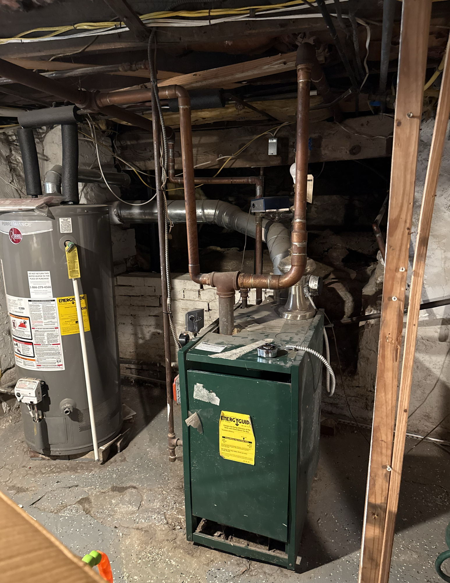

Landlord states the building heats very well

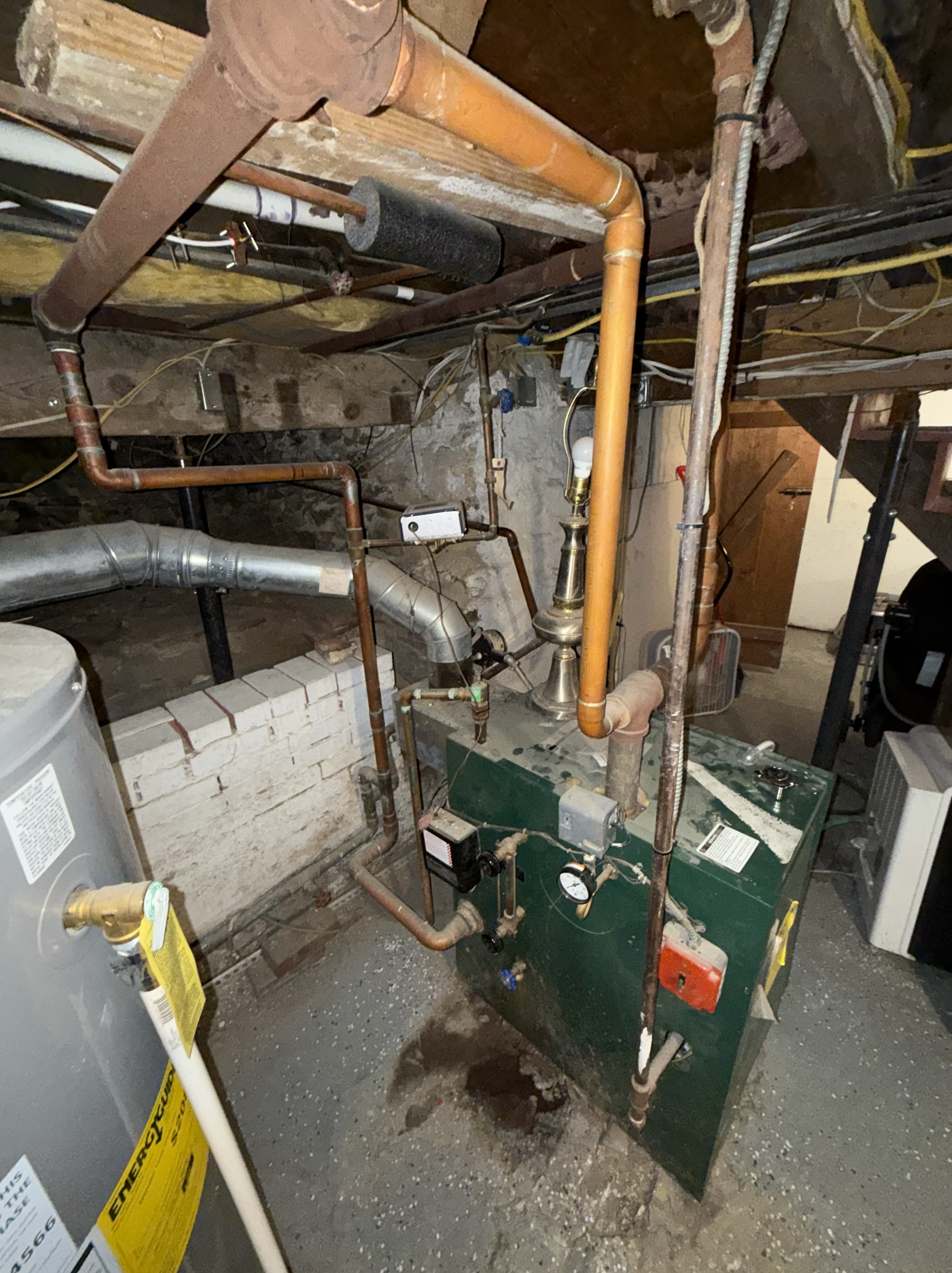

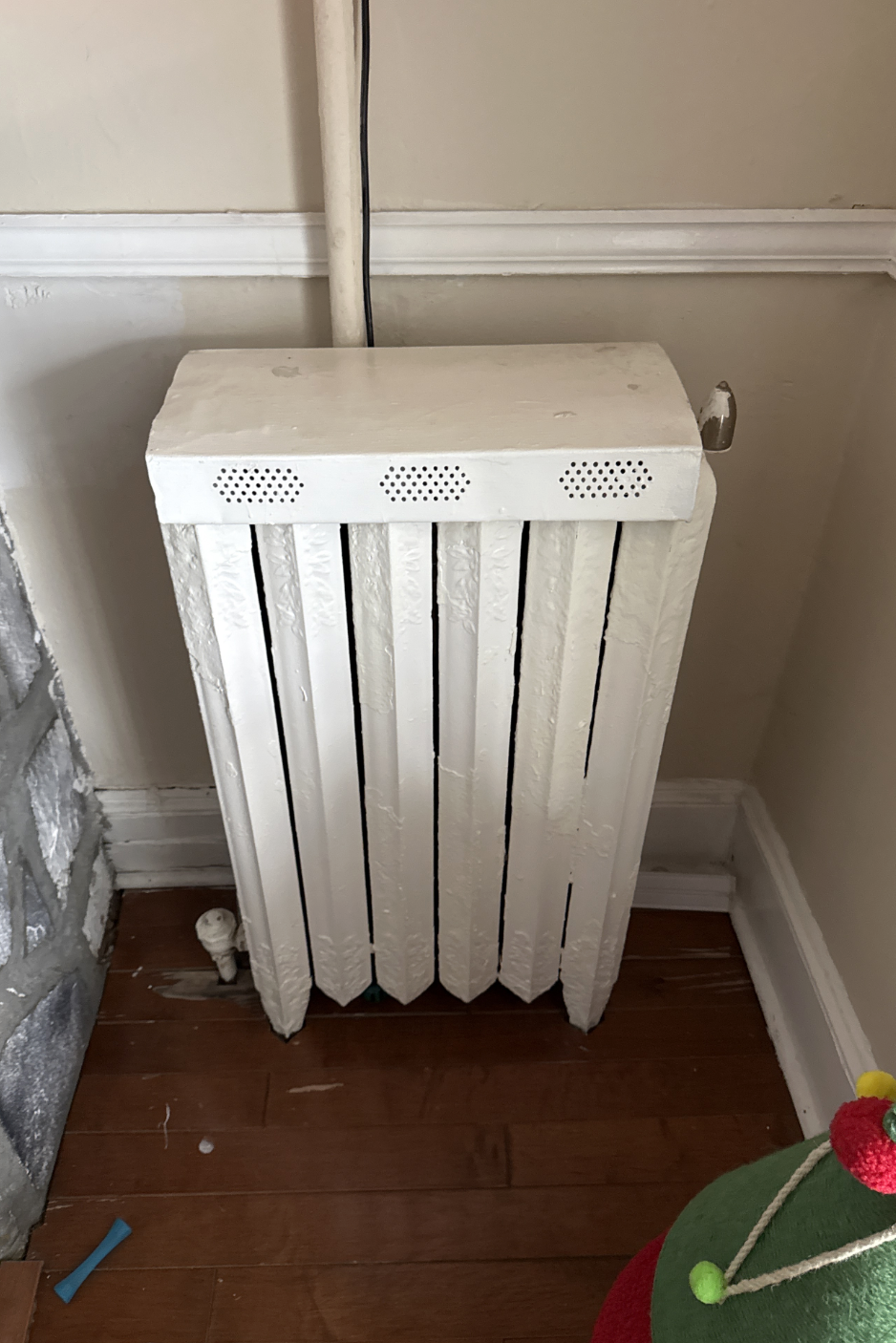

The landlord states that he has owned this unit for 5 years and has never had any issues with heating. One pipe steam system - air vents on each radiator. Each radiator has a thermostatic trap on the supply line - the bellows are all still in place in all of the traps. No steam vent at the end of the main. No signs that this was ever a 2-pipe system. Unless all of the traps are failed in the open position, how would the steam ever enter the radiators? By the looks of it, the piping has been this way for a very long time. How has it worked like this for so long?
Near boiler piping is also incredibly incorrect but thats another story.
FYI - boiler is being replaced this week, removing all thermostatic traps and replacing with rad valves, replacing all rad steam vents, and adding steam vent towards end of steam main.
Located in the suburbs of Philadelphia.

    Philadelphia has more than its share of steam boilers piped by "good hot water men", which is NOT a compliment; but I have never seen anything like that. I don't see how it worked at all.

    I hope they don't have the same installer LMAO. As soon as you find out what make and model and size they are installing I'd download the installation manual and ride them like a hawk. Print out the near boiler piping and gas valve instructions and hang it in the basement lol.

    Haha, I am the new installer. Existing boiler is 275 sqft steam, oversized - current EDR is 105 sqft between all of the rads (small twin home - only 5 radiators). When my service tech was on site, I had him facetime me to confirm what he was telling me was accurate. I immediately called the landlord to ask if he has had any issues with the heating system to which he replied, "none".

    Me either. There has to be a second connection to the rad for it to work. That Trane B1 trap is way too small to do the job. Are all the rads like this?

    Now I don't know how much pressure a steam radiator trap can hold back in that configuration, they aren't normally used that way. I suspect the boiler's pressure pushed the steam by the trap.

    maybe if you crank the pressure up enough it forces the steam trap open. the riser is too small even if it weren't choked down by the seat in the steam trap and plugged by the element closing on the steam. the radiators must be filling up with condensate until the cycle ends too

    The issue is that thermostatic traps allow air and condensate pass through, but not steam. When the steam hits the bellows, the alcohol content will expand and close the passageway. In this case, not allowing any steam to enter the radiator. So theoretically, none of the radiators should be heating (assuming that the traps are functional).
    On a 2-pipe system, the trap is typically located on the outlet of the radiator. On start up, the air will vent through the radiator and expel out of the main vent which should be located on the end of the return main. When the steam enters the radiator and hits the thermostatic trap, the trap will close and lock the steam in the radiator until it gives off enough heat to condense back to a liquid. The condensed liquid will cool the trap off enough to open it and allow the condensate to return to the boiler.

    Maybe the thermostatic elements in the traps have been removed.
    But even then, the orifices the elements open and close are so small, I can't see how this arrangement would work on a one pipe system.
    Maybe the orifices were drilled out to full pipe size?? Might be interesting to open some up and see what's, or what's not, inside.
