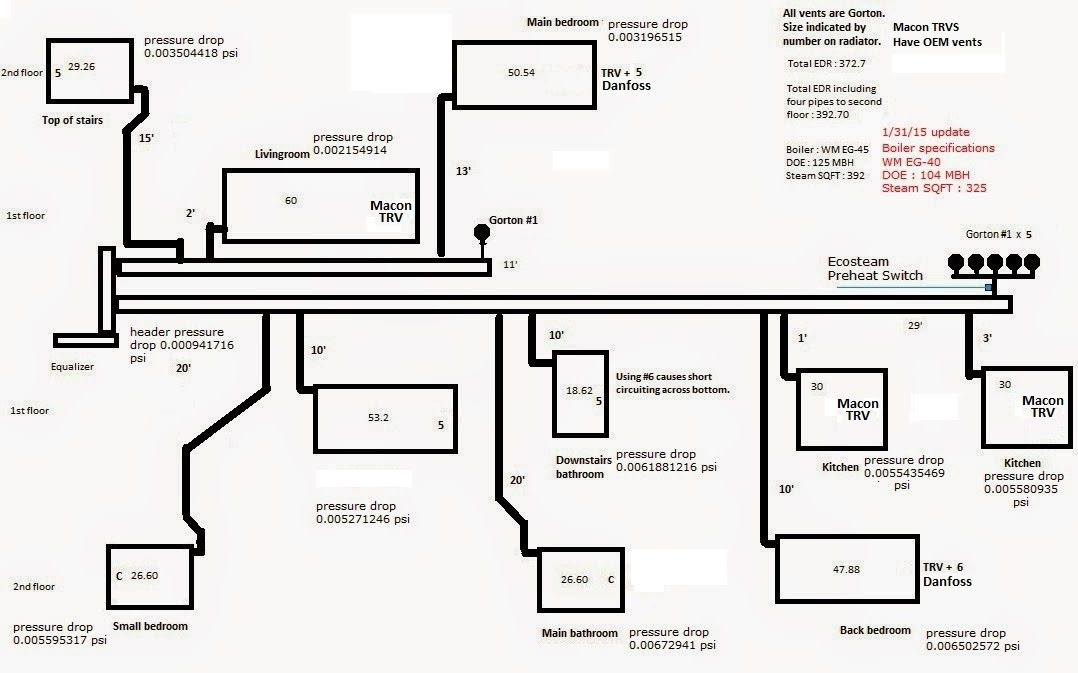

I've ordered the L408J1009 Honeywell vaporstat to swap in with my two pipe steam boiler to run the system at lower pressure. I am also wondering how to add a timer to the vaporstat so that when the cut in is reached and the vaporstat closes the circuit, if the timer has not finished, the boiler remains off until the timer completes.
I appreciate any insight and the very helpful advice I've received here. I've taken my steam system from partially heated radiators and water hammer to radiators fully heating and a just a little hammer remaining due to improper return piping at the boiler which I'm working to correct.
My next task will be to calculate the EDR for all my radiators and length of mains to get a sense of my boiler sizing. Thanks again!

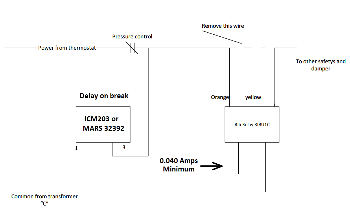

    Your boiler make and model would help to find the wiring diagram. Anyway here is a few example diagrams you can chew on. Seems it is best practice to use a relay so the load signature of the damper (if you have one) does not mess with the timer. The relay coil provides a constant predictable load for the timer unit. The relay's contacts is what actually interrupts the boiler's control circuit.
    ethicalpaul Posts: 9,076
    what I did was to interrupt my thermostat circuit with the timer relay

    I'm liking the idea of an interrupt on the thermostat circuit. Any insight on that? Parts used?

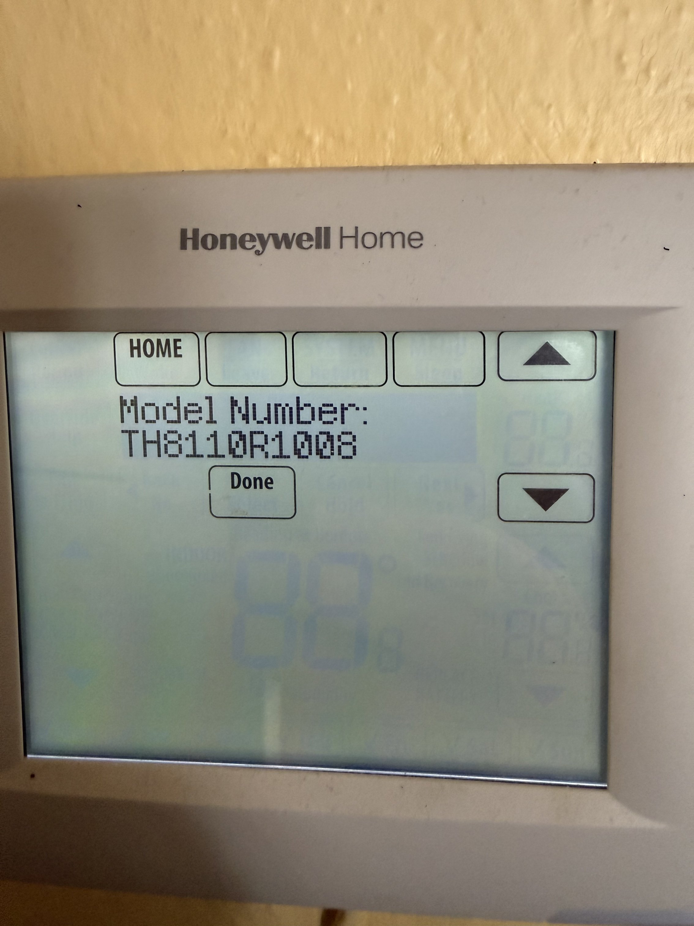

    markmarlatt - what thermostat do you use?
    Consider an Ecobee. It is pretty good at learning when the boiler cuts out, even when it is still calling for heat. It is much better than a dumb thermostat in managing shortcycle issues.

    Running this thermostat:
    My primary goal is to maximize efficiency. The current pressuretrol is is set to cut in at .5 and cut out at 1.5 psi. My 0-5 gauge is never showing over 1.0 psi, I have a 0-3 gauge ordered to verify.

    @ethicalpaul's method is similar and accomplishes the same basic thing. The examples I posted above use the existing pressure sensing equipment on the boiler (Vaporstat or pressuretrol). AFAIK @ethicalpaul's method uses an independent pressure switch to trigger the timer. You could use a relay after the boiler's pressure sensing equipment to trigger the timer that @ethicalpaul used. There are many ways to accomplish this task.

    @EBEBRATT-Ed Yes you are the author of the original drawing with just the timer and the relay, it is from another post and if you remember I edited it to add information and re-posted it in that other thread.

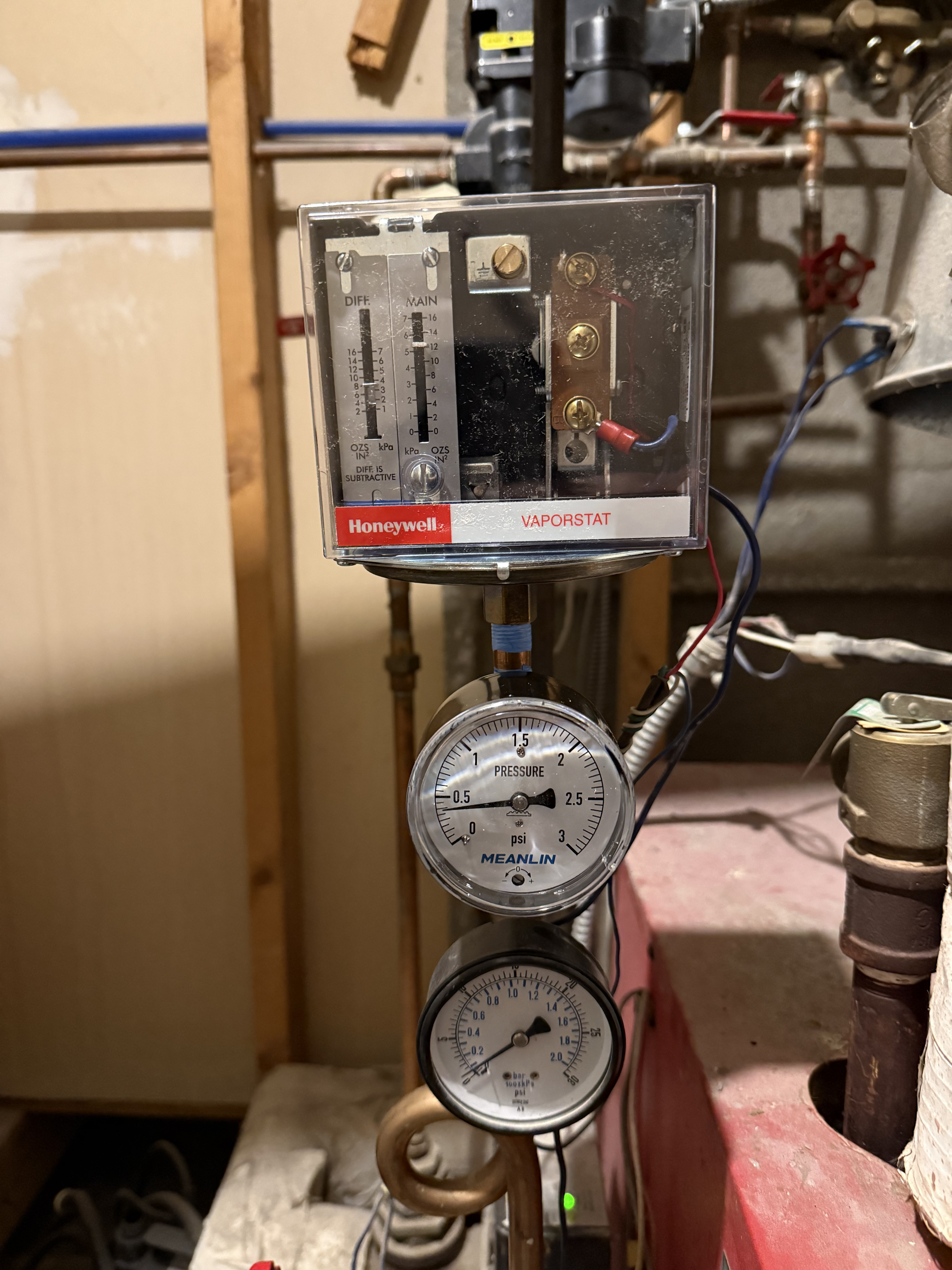

    I’ve ordered a 0-3 gauge to see if the 0-5 gauge is faulty. Will have that Monday and report back. I do know the boiler is never shutting off from Pressuretrol, only tstat or lower water cutoff after observing for three hours sitting in front of the boiler.

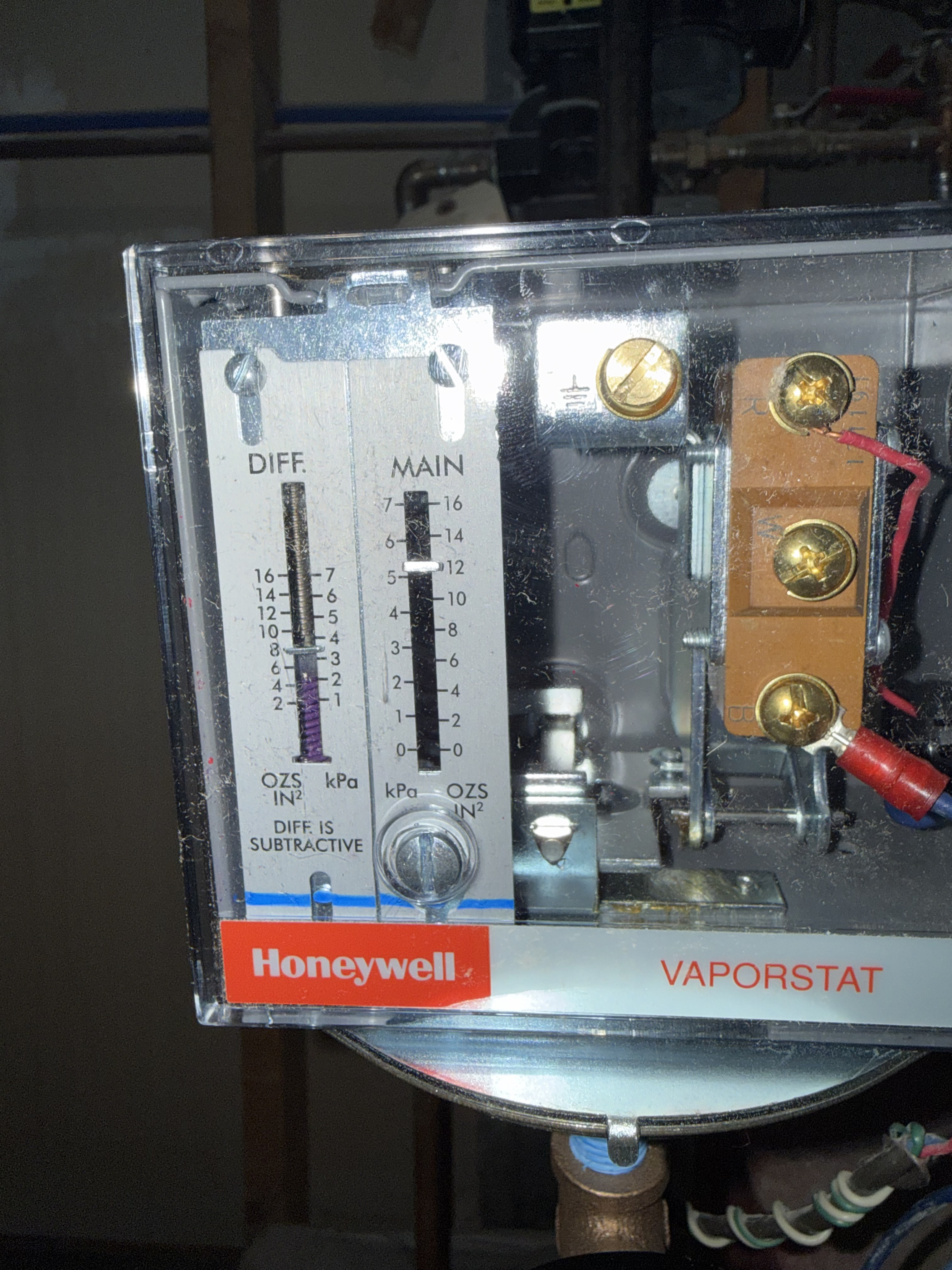

    Tonight I lowered the water level in the boiler to just below the top mark on the boiler and ran it. The system pressurized must quicker and probably like it should. I’m having to keep the water level higher to prevent water hammer from steam getting into the return. This is due to wrong return piping at the boiler that I’m in process of getting fixed.
    I did find that my pressuretrol allowed the system to get to 2.5 lbs before tripping which is way too high for me. Going to swap in the vaporstat when it arrives to see if I can keep the system between 12-14oz cutout with a 6 oz cut in. The new pressuretrol is set to .5 cut in with 1.0 differential and should trip at 1.5 but it’s not so I’d wager I got a faulty unit. I’m going to see about building a tester like I’ve seen on YouTube to correct the pressuretrol.
    During this cold snap I’m keep the system working while I get things sorted.
    Thanks again for all the help, I’m not ready to give up on steam yet!

    A pressuretrol can be recalibrated, you should be able to find the procedure on this site by searching.
