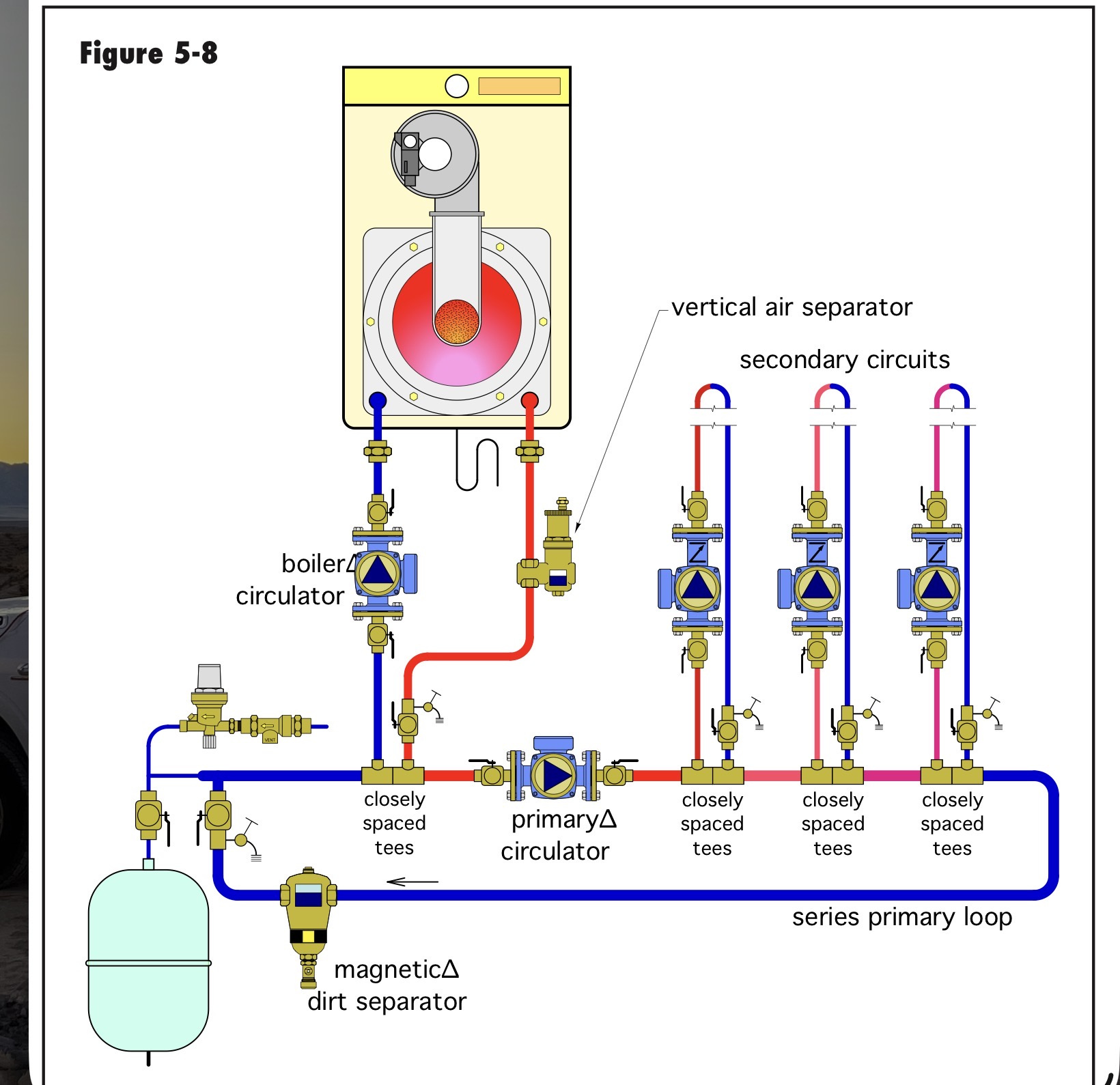

    here is an example where 3 or more circs are required.
    This is a dedicated series primary loop system. It is series because the zone pumps are in series to one another
    Boiler loop, primary loop and zone pumps
    If the expansion tank was connected at the boilers pump, then the boiler loop is the primary loop.
    Mail4tommo
  • thank you for the example.
    So if the "primary circ was removed" and the expansion tank was piped before the boiler loop circ, would this still work? (Im going with no) I'm assuming not because of hydraulic separation.

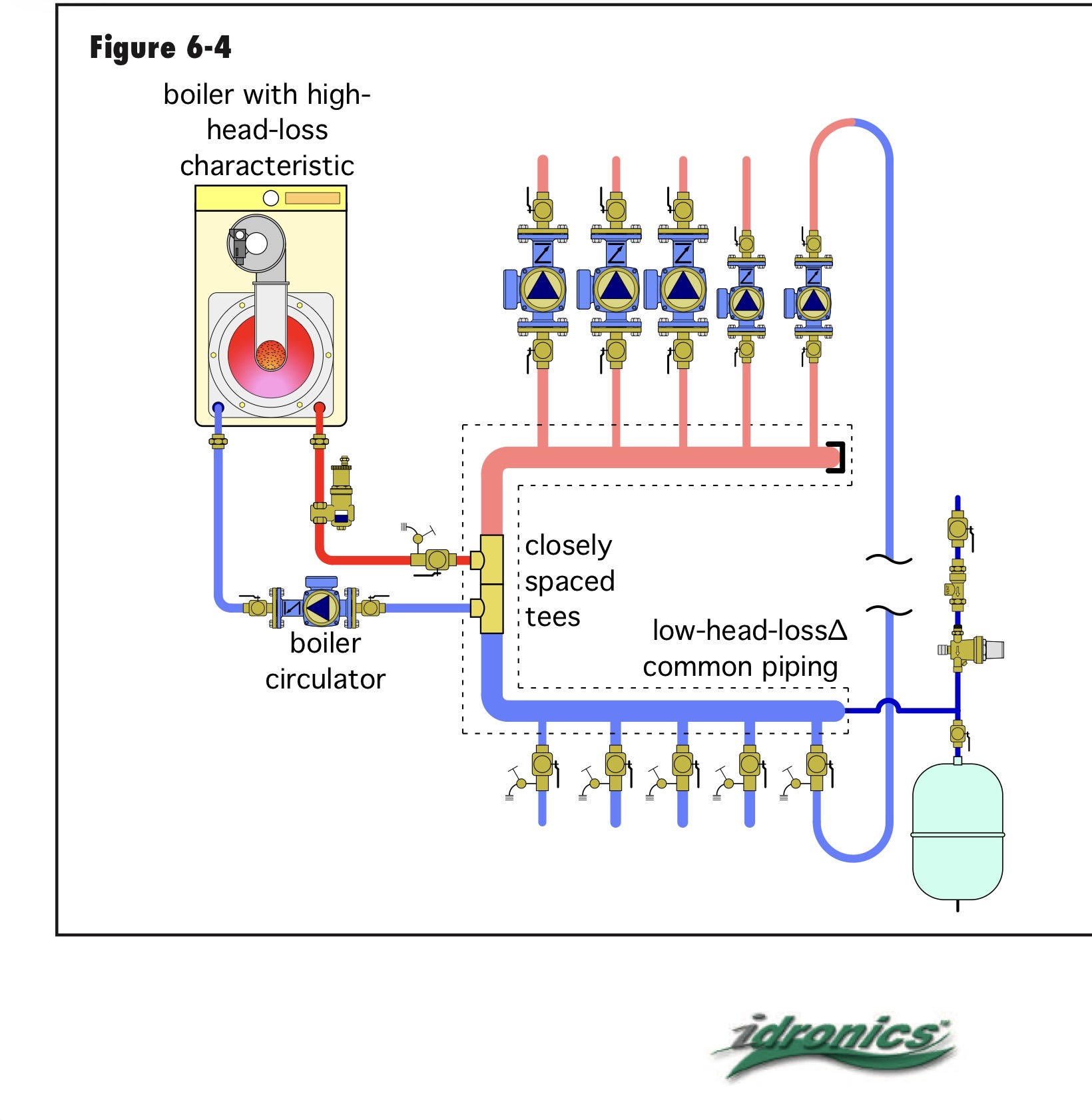

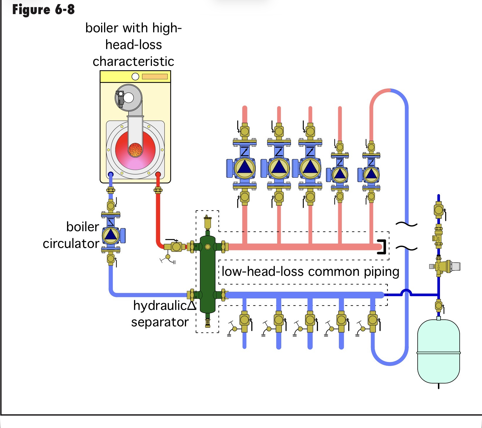

    here are some options where only two circs are required. These show multiple zone pumps, but the concept is still two separate piping circuits with either closely spaced tees, or a separator acting as the tees.
    The series P/S two posts up would not work with the primary loop removed.

    Question for hot_rod: do these last two schematics still qualify as "pumping away"?
    I"m sure @hot_rod will answer on the "pumping away" — but in my mind they both would. It's as much a matter of figuring out where the lowest pressure in the system is likely to be, and placing your expansion tank (and automatic feed, if used) at that location. And both of those arrangements do that

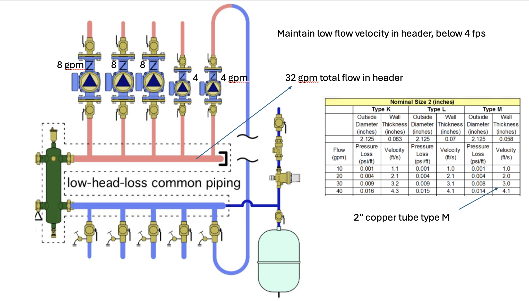

    The key point on any piping with multiple pumps or zones is the header pipe needs to be LARGE. Sized to handle the flow of all the pumps combined, ideally at a low velocity around 2-4 fps.
    The large (low head loss) header pipes become the "extension" of the PONPC
    In this example lets say the 3 large circs are 8 gpm each, 4 gpm on the smaller, so 32 gpm total through the header.

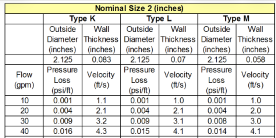

    So 2" type M copper would be the choice, just over 3 fps velocity.
