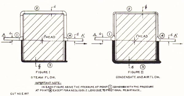

Is it necessary to go over the top of the door for a door loop on a 1 pipe steam system that's only returning condensate to the boiler?
    Jamie Hall Member Posts: 27,599
    Maybe. The first question to ask is whether this is a steam main extension or not, and if it is, where the main vent for that main is located. The consideration is that that loop under the door is a water seal, and neither air nor steam can pass though (unless the pressure is excessive, but that's another question).
    The second question is what the piping is downstream of the door loop. You may get some interesting and unexpected pressure variations without the loop over the top, since that loop acts as an equalizer.
    So… sort of depends on the situation, but in the absence of a pretty thorough knowledge and understanding of how steam, air, and condensate are going to flow, and what the pressure relationships are, that equalizing loop is a pretty harmless addition…

    You need the upper loop to carry the air. Lower loop caries water…….If this is a return. The tee for the outlet side of the loop is supposed to be 1" minimum below the entering tee. The 1" of water collum is to overcome the fitting pressure drop.

    Door loops
    It it is a steam main the steam goes through the top and condensate on the bottom so the upper pipe is larger.
    If its a return larger on bottom carries condensate and upper is air smaller pipe. If with a return you will have a water trap on the bottom and without the upper pipe air can't get out. Need air vents on either side of loop
