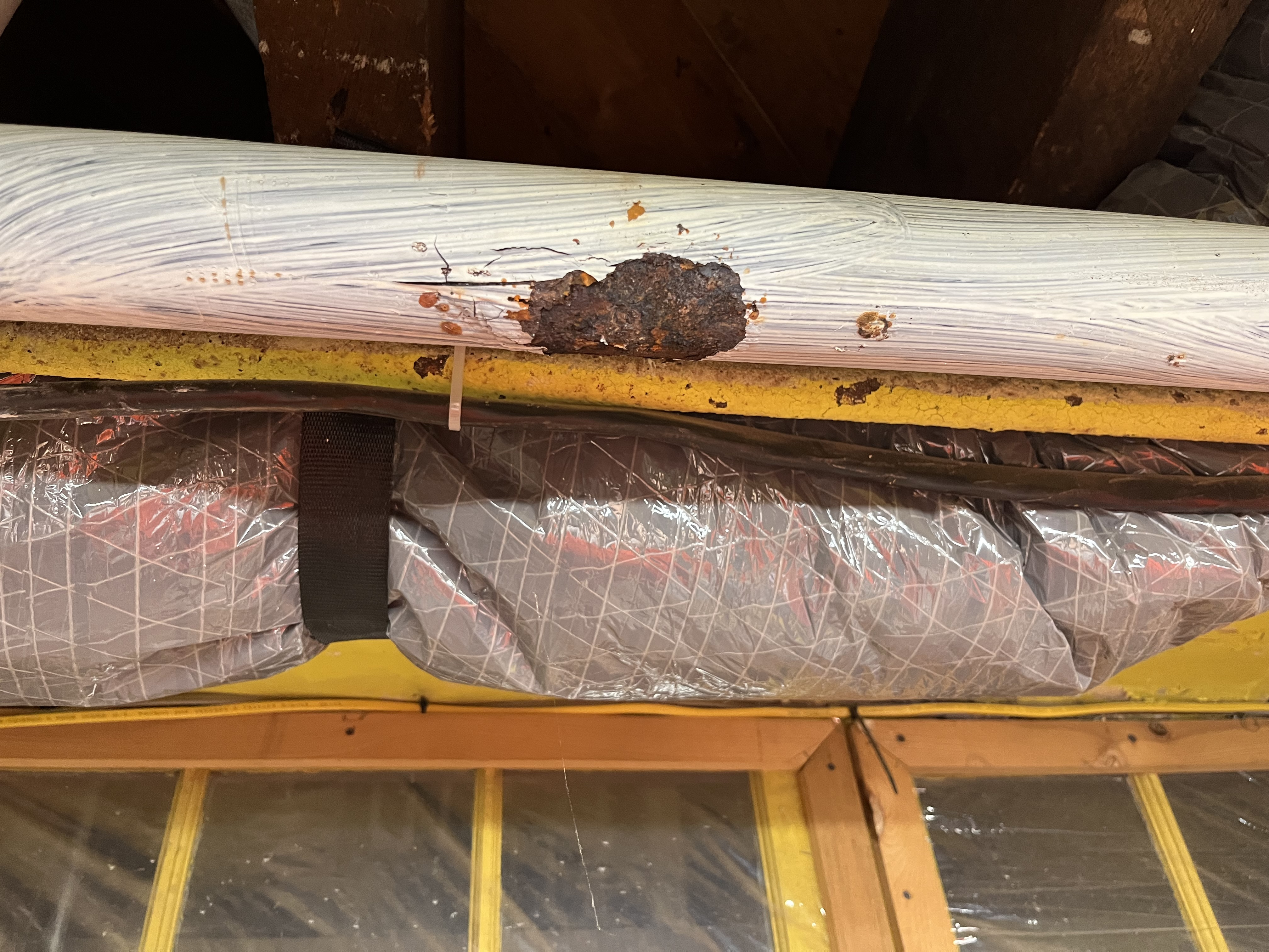

whats the best epoxy to fix a leak in the steam main to get me through the winter? I would much rather deal with repairs in the summertime when heats not needed.
idk what it looks like yet other than the insulation (fiberglass) is pretty wet.
You have access to Mega Press?
nope. I’m a homeowner - not a pro
Try one of these gizmos….
330-089 - Matco-Norca 330-089 - 2" x 9" Stainless Steel IPS Pipe Repair Patch Clamp
I used this to seal a leak in a 4" steam main, lasted for over a year before I got around to making the repair: . The Lowe's around here carries a package of 12" strips, which wouldn't help me but if you're working with ½ or ¾ it should be fine.
I've also had some luck forcing a piece of plumbing epoxy into a hole in an abandoned section of main that blew out a small hunk due to water hammer. Dunno how long it's going to last, but the real fix will be to remove the section & relocate the flange. I sure wish it wasn't 8" threaded pipe.
I have seen rubber Fernco fittings on steam mains. Some of them had been in place for years. Would obviously not suggest such a thing.

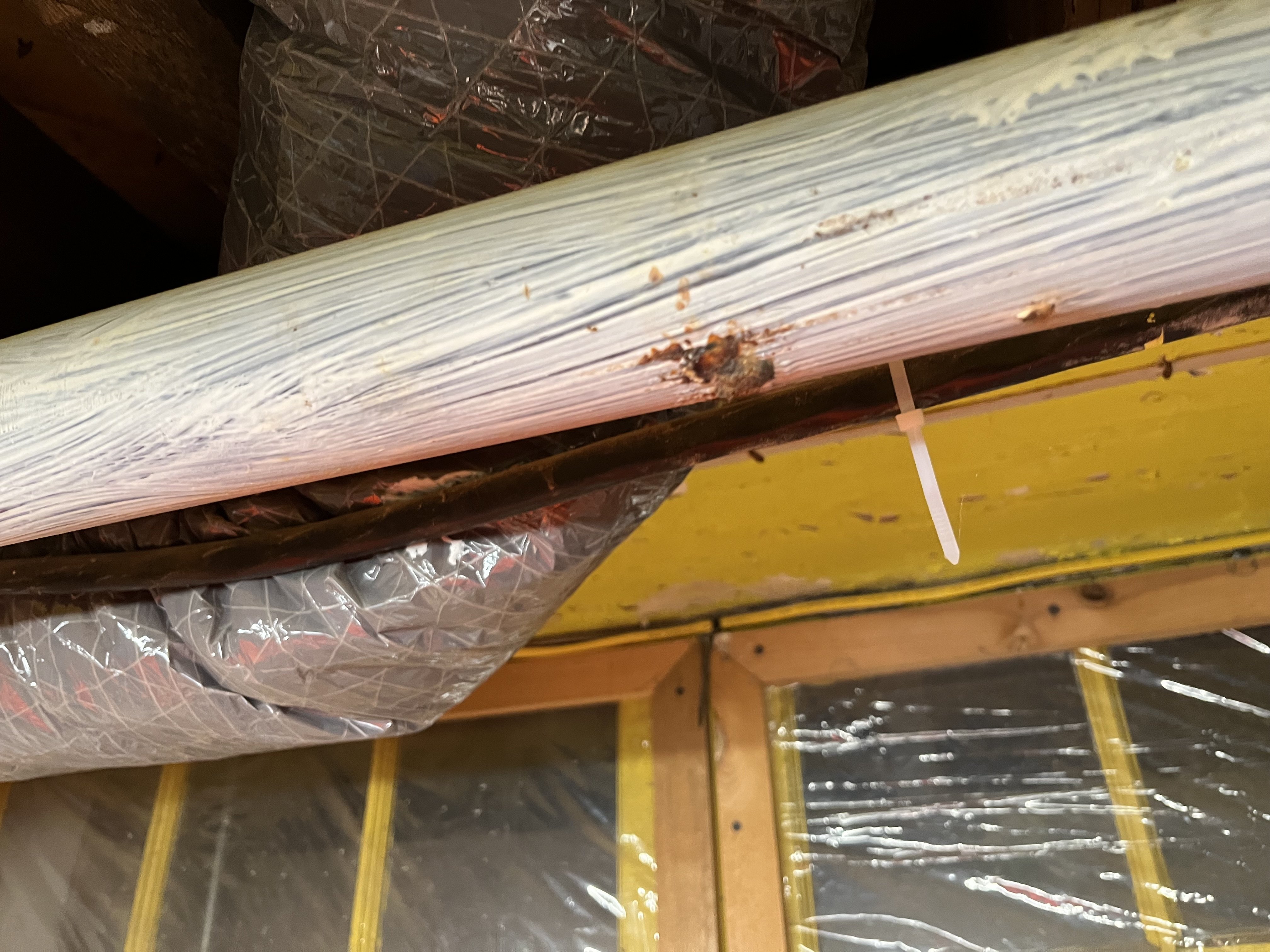

well…maybe not as bad as I thought. Definitely want to replace the pipe in the summer, but nothing is visibly leaking with the insulation off and boiler running.. i think the fiberglass was acting as a wick drawing the water through the weak spots
Maybe some JB Weld first, than any one of the above mentioned clamps.
