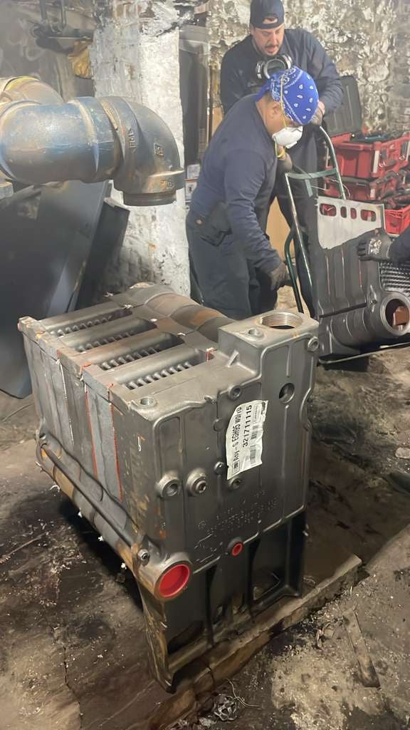

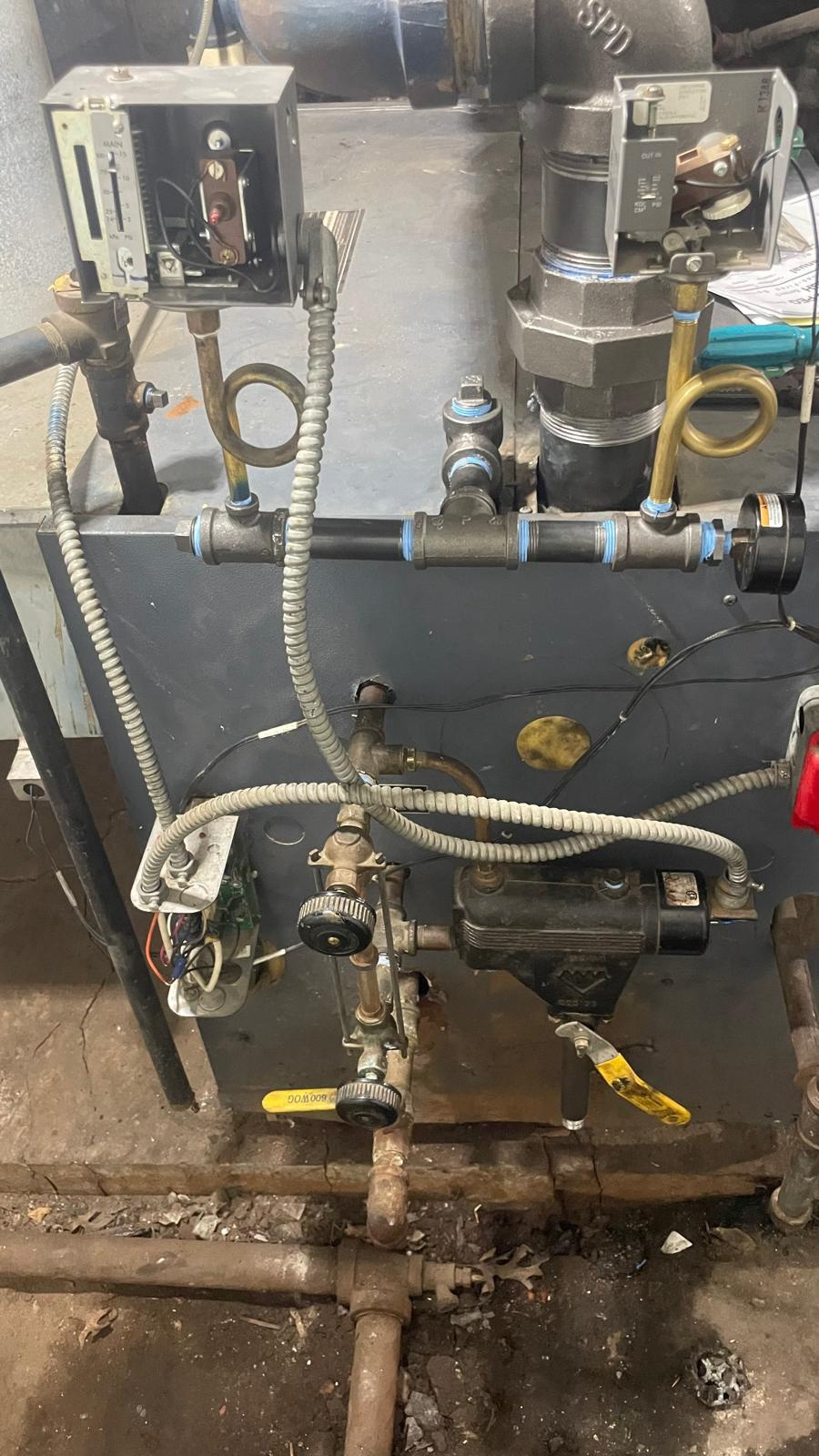

Today I found that out the my EG-95 (400kbtu) gas boiler (small apt building) stopped working because it has a couple of leaking sections and something happened last night where the flame spilled out and burned some wires.
The boiler service company recommends replaceing all the sections, which means tearing it all apart (including the header), and the burner base.

    @Big _Ed_4: I've had a long standing relationship with the current boiler company, and I have a service contract (which effectively means they will service my boilers at full price vs. without the service contract where they will not service my boilers). This goes directly to your understanding that I am lucky to find someone.
    @EBEBRATT -Ed: Service guys say it is full of crud and no way they can get it working. It's not old -- less than 10 years. They said they recommend just swapping the sections.
    @mattmia2 : Service guys say no. I specifically asked about getting through this season.
    @Mad Dog _2: EG-95, 400K, I don't know how many sections.
    My problem is I have tenants who are rightfully pissed off because they are cold, so no time for due diligence (which I would certainly prefer to do).
    I have the water level on this boiler (and all my boilers) checked and skimmed at least weekly. What I don't have is a full service done annually -- I need to get that in place!

    All sections scheduled to be replaced today.

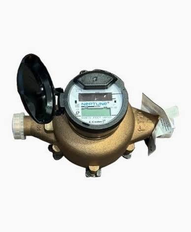

    I think monitoring water usage is a great idea. I think the water feeder copper line is 1/2". What would be a light weight, simple water meter to install?
    Intplm. Posts: 3,162
    Interesting. @josephny How did you come to the conclusion to replace all of the sections and not replace the boiler?
    Here is one type of water meter to consider. This is a Neptune T-10. Some have a remote reader that can be used without having to enter the building.

    Your boiler uses O-rings construction , if you have the mussel it is not a bad job …

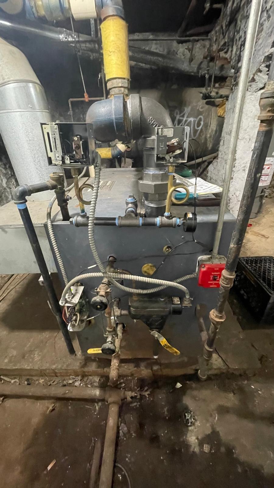

    How are you going to skim that new boiler? They didn't install a way to skim it that I can see?
    Big Ed_4

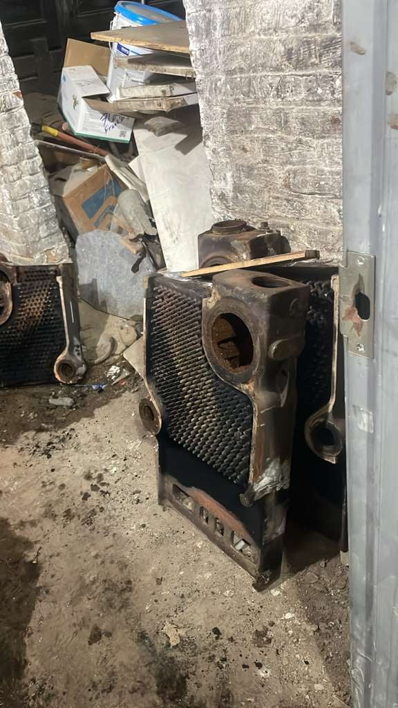

    why is the old one sooted?

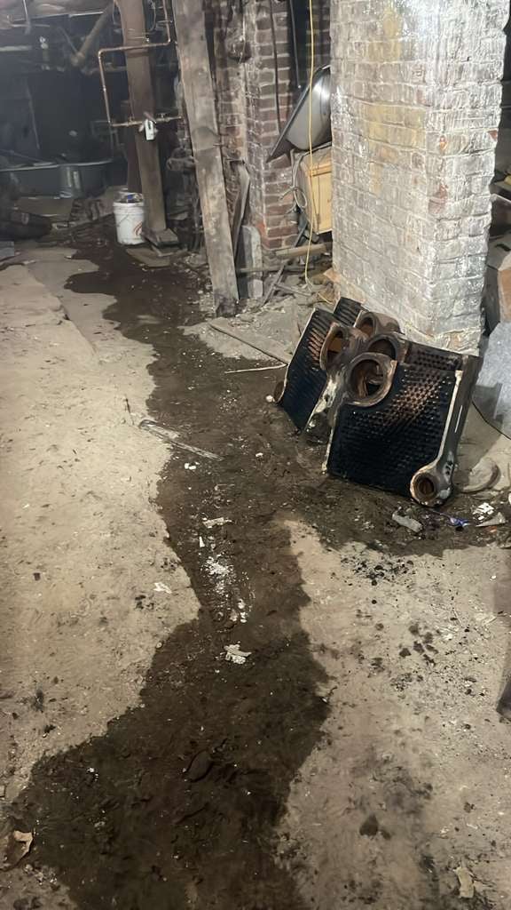

    There was some incident (I don't know exactly what happened, but I assume a big splash of water from a leak occurred) that triggered this whole situation. That's when the soot appeared, burned the wires, and brought down the boiler a couple days ago.
    I'm going to install a water meter on the MU water feed on this boiler (and other boilers I have) because it sure sounds like (from the experts here) that excessive MU water is what cut my boiler's life by more than half.

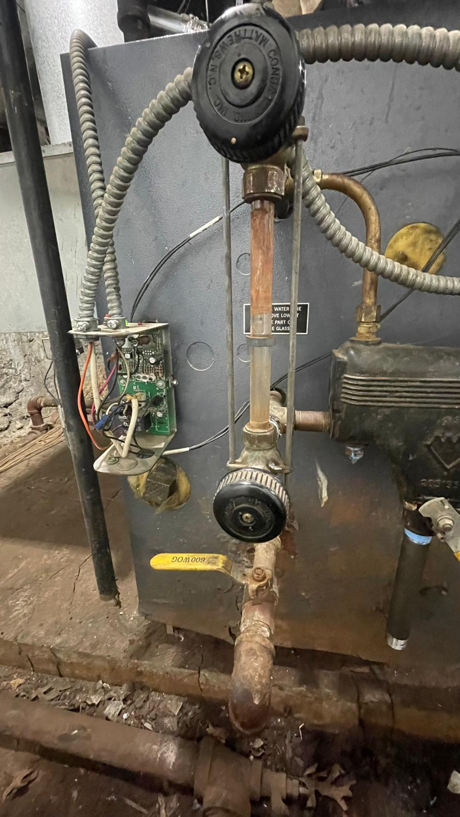

    Why did they use the old gauge glass assembly ?
    you can see some signs of minor leakage in the pictures that would likely have been there if it was inspected at the beginning of the season. it doesn't look like it was a major leak but it is hard to tell from pictures. it however looks very sooted and that didn't just happen last week.

    Bad O-rings

    I assume by soot you mean the black carbon on the surface. I don't know if you mean the soot on the boiler blue case panels or on the sections.
    All I know is what I'm told and the little I've learned. I'm told they did a flood test and the boiler had a substantial leak from multiple sections and was full of crud. Does that report, together with the pictures, fit an explanation of excessive MU water over the a substantial period of time? I have suspected for quite a while that it was using far too much MU water, and did a diligent search throughout for any leaks, finding quite a few vents, radiators, and valves with leaks.
    Only float type needs cleaning? So a boiler with only a sensor type doesn't need to have dirt removed from the water on a regular and frequent (weekly?) basis?
    well, both, but it is outside the jacket because it has been inside the boiler block for a while. gas should produce no soot if it is burning properly. I don't know if the steam leaking can cause the sooting, it doesn't seem like it would but i'm not an expert on combustion. you can see that it is burning very yellow in one of the early pictures so it isn't burning right for some reason. the soot caused the rollout. i don't see why it couldn't have been brushed and vacuumed and whatever was wrong with the combustion fixed and the leak wait until spring but i might be missing something.

    I installed a water meter (DLJ hot water version) on the MU water line. It's only a couple of days, but I'm showing about 0.275 gallons/day usage for this 8 unit plus store building. It's a very small time frame, so I'll have a more accurate understanding of the water usage in a week or two.
    I installed the same meter on another building (4 units plus store) at the same time and it's showing 2.5 gallons in a day — so I have problem now (unless the reading is some sort of anomalie).
