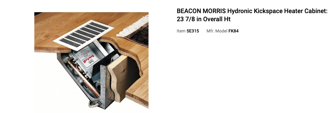

    does the boiler run non stop on the coldest days? If not it may have some addition capacity to add a hydronic heater.
    Can you get under the glass wall section of the home? You could cut in a few kickspace heaters to blow warm air across the glass. They may work at the same radiant temperature, they need about 115°F or more to kick out much heat.
    The go into the floor like this. Since it is a forced air convector you get a lot of BTU/hr output compared to fin tube or panel radiators.

    Now having said that… @hot_rod 'ssuggestion is a very good one, if you can get access to under the floor to install them. Another possibility, but somewhat more complex, would be panel radiators in that specific room. They, however, need hotter water than your radiant system, which adds the complexity of generating that hotter water (your boiler can do that) but then mixing it down for the floor — which is also easy enough to do, but adds some valves and at least one more pump.

    I'm with @hot _rod on this one. I have seen a project where the floor heat was sufficient for the home where there was average (35% of the walls are windows) glass, but the "solarium" with 18ft ceilings and 18ft floor to ceiling glass wall would not get enough heat after the outdoor temperature dropped below 40°. That same boiler would produce 180° water to run through Runtle® radiant panel baseboard radiators that wrapped around the perimeter of the glass walled room.   That was able to heat the room when the temperature dropped to 15°.  But when the outdoor temperature reached below that, the warm air duct system would operate to take up the slack.
    Since you are using minispit systems for your cooling, that eliminates the duct coil option.  So perhaps the kickspace heaters as the third line of defense is the best idea.  That can all be operated from the same boiler that most likely has extra capacity that the floor heat as a heat emitter can't use.
