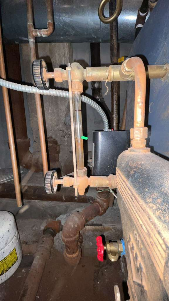

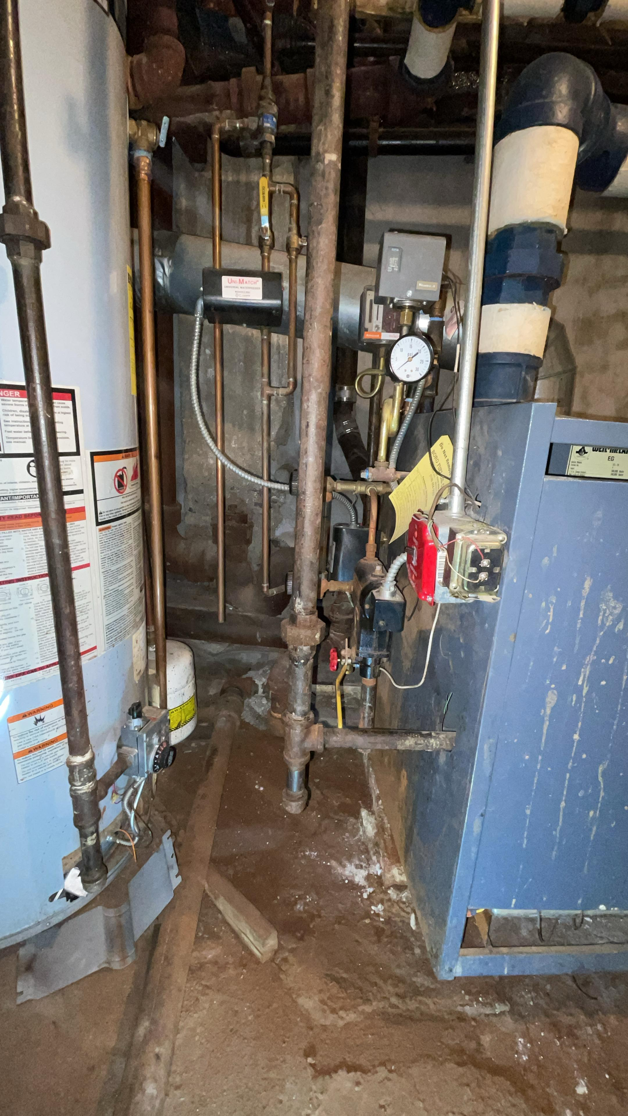

I have a gas, Weil EG-75, 300kbtu input (240k out) boiler living in a basement serving the floors above it as follows:
1st floor — retail, 4 large'ish radiators
2nd floor — 2 apartments, each with 4 radiators, plus a pipe through the bathrooms.
3rd floor — 2 apartments, each with 4 radiators, plus a pipe through the bathroom.
The boiler continues to short cycle and I've tried everything I know.
3rd floor have all brand new D size vents.
2nd floor have half #4 and half #5 size vents
1st floor has half #4 and half unknown size vents.
Basement has 3 brand new #2 vents and 1 #1 vent.
All pipes throughout the building are quite hot.
Changed from a simple programmable digital thermostat to a CK87 round which is not located in direct sunlight, or anywhere near a radiator, or open window, etc.
Thoroughly cleaned the piping to the pressuretrol (pigtail, etc. all clean). Pressuretrol set to 0.5 with differential now at 1.5.
I tested the pressuretrol as follows: When boiler shuts off, I push down on the rocker to make sure microswitch is not tripped but the boiler does not come back on. My conclusion: Boiler is not shutting because of pressuretrol.
Water looks clean to me. I don't see lights flashing on LWCO to indicate that is the problem.
It basically runs for 2-4 minutes, shuts off for 2 minutes, repeats.

Boiler stops, green light solid and red light flashing on LWCO.
After 30-45 seconds, red light goes off and boiler starts up again.
Dirty LWCO? Dirty water? What's the easiest/quickest fix for now — going away for a week.

The LWCO may or may not be a problem. Probably not. It may be reallly and truly telling you that the water in the boiler is a little low — what you are describing sounds like slightly low water with slow returns. Check the water level in the sight glass when the boiler is cool.
Does the boiler lose water and require feeding from time to time? How often?

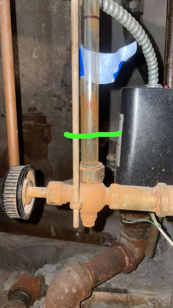

The sight glass was about 1/4 from the bottom with a hot boiler. I raised it to just over half and it's been running for 5 minutes. Water bounces between 1/2 and 2/3 high while boiler is running.

You reported that you tested the pressuretrol, but does this boiler have two of them? One this large usually would.
For a multi-residence with retail you should have a steam pro contracted to care for this boiler. There is too much liability for it to be DIY (and I love DIY but there are limits)

The boiler has a low pressure pressuretrol and a high pressure one. I haven't touched the high pressure one and have never needed to press its reset button.
I had a guy come in today who said he needed to rebuild the pressuretol (maybe both of them) with 3/4" piping because the small pipes get clogged and give it "a good cleaning" and that would fix it. I don't know if it's not allowed or improper etiquette here to talk about money, but between not being inspired to confidence with his quick analysis (didn't even want to hear what I've already done) or with his price, I passed.

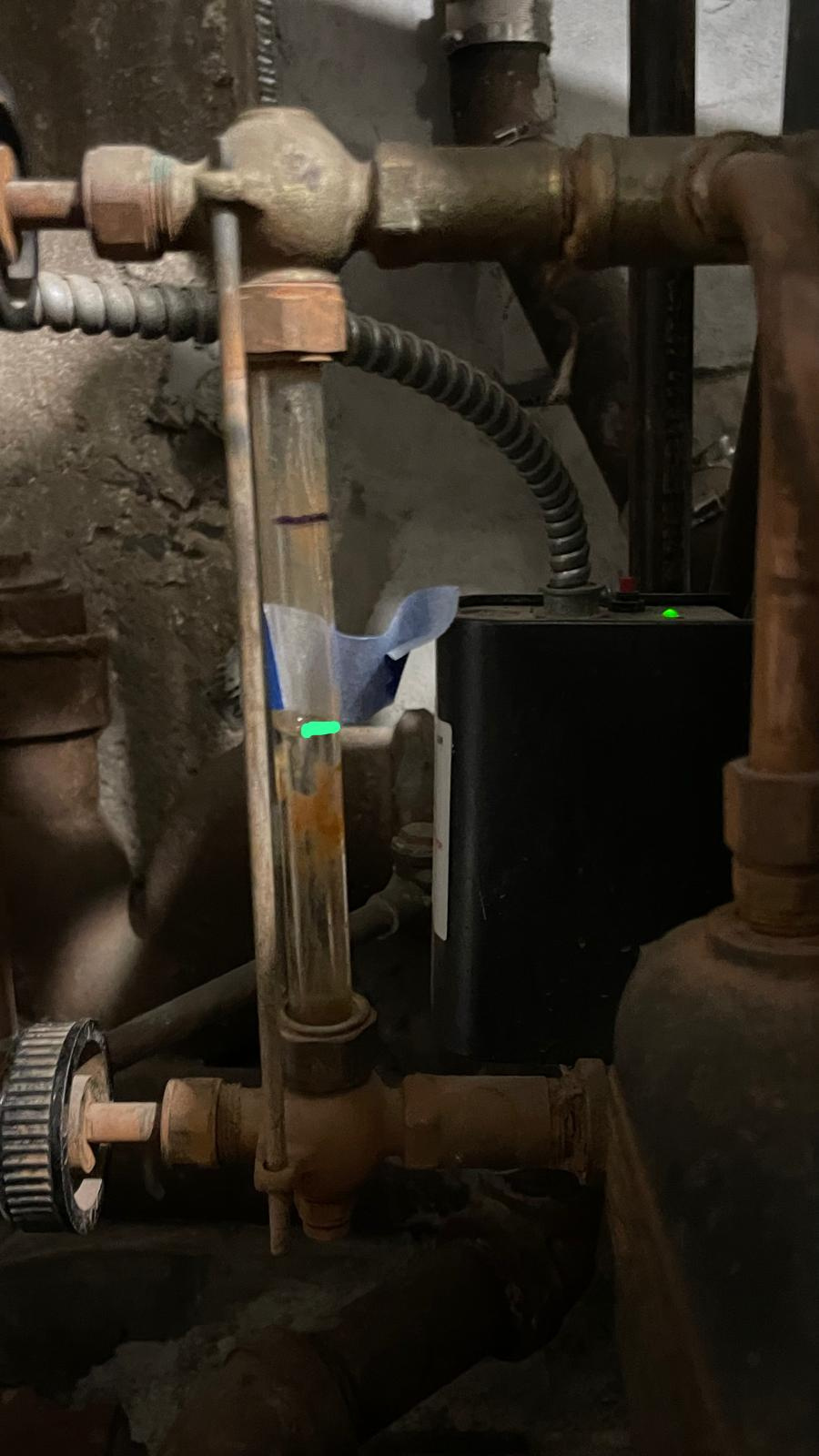

I added water until the sight glass is 3/4 high.
The system has 4 main vents consisting of three #2 and one #1.

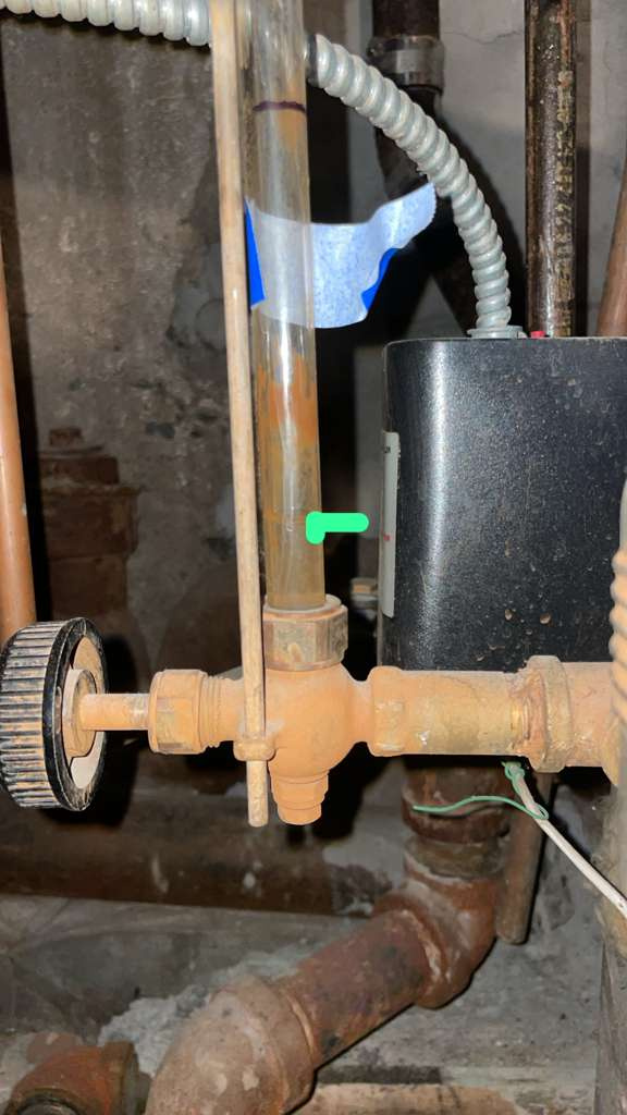

After 48 hours, the sight glass shows 1/4 high, when boiler is very hot. I don't know if this is significant. That is, maybe all the water is in the form of steam throughout the building, or maybe it is solid evidence of a leak.
The ON portion of the cycles have lasted up to 20 minutes. But the OFF portion of the cycle is often as short as 1 minute.

Is it okay to add cold water to a hot boiler when the sight glass shows 1/4 of the way up from the bottom?

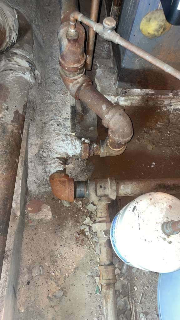

can you post pictures of the return pipes to the back of the boiler? If any of them are beneath a floor slab they may be leaking underground.
Sorry for the very basic question: I have what I would call 4 mains each with a vent. Does that mean there are 4 return lines going down from near those main vents? Those areas (basically the corners of the building) in the basement are not visible, so i can't see.
What I'm getting at is: How to check the return lines if they are behind a finished area?
when the boiler stops firing, the water level rises to about 1/2 way up the sight glass.

Unless the mains are counter-flow (pitched down toward the boiler) there are some sort of returns to bring the condensate back to the boiler. Maybe start at the boiler and trace out the returns (if any).
Pictures may help us.

is the water level at 1/4 of the sight glass after the boiler has been off for say 10 minutes or so or is it just low while steaming?
water level rises when boiler stops firing.
there is some buried return lines.
Is the cycle of 20 minutes on then 1-4 minutes off a good indicator what’s going on?
tstat is no where near a radiator.0 -
There is about 14’ of return lines in concrete and another 24’ that are buried behind walls.

does the water line move up and down as it it steaming?
May I as a silly question? What's turning off the boiler for that 1 minute chut down? That almost sounds like a pretty well sized boiler cycling on pressure, which is just fine. Not a problem at all.
On the possible leak — the quickest and simplest test is does the water level recover when the boiler is off and allowed to cool down some? That is, you set it at some level — note what — and then come back later after it as cooled down again, where is the water? About the same? If it, no leak. Slow returns maybe, and quite possible — they can be flushed if needed — but no leak. You only have a leak if you have to add water to maintain level — more than a gallon or two a week.
yes, when the boiler is running the water level in the sight glass moves up and down some.
I'd expect that. some boilers are pretty quiet, some bounce an inch or two. The question is — does it return to where it started eventually?

I'm confused about how to do the water-level-returns-to-prior-level test. Can I start with a hot boiler?
It would make it a lot easier if I could start with a hot boiler, either firing or not (I could shut boiler for a short period of time, maybe 20-30 minutes to start test).
And, if it's 1-3 gallons/day leak, wouldn't i have to do this test over the course of quite of a bit of time to be able to determine loss by looking at the sight glass?

Do you have an automatic water feeder? And, if so, does it have a counter? If it does, it will tell you how much water, more or less, it's feeding. If there is no counter, you may have to find out what's happening by simply turning off the water supply to the boiler and watching it over several cycles. Or longer. If it's leaking the water will not return to the original level in the sight glass.
As to when you check the sight glass. So long as you are looking at it at some consistent time after the end of a cycle, you can get a good idea of the trend in water level over time, from cycle to cycle.
