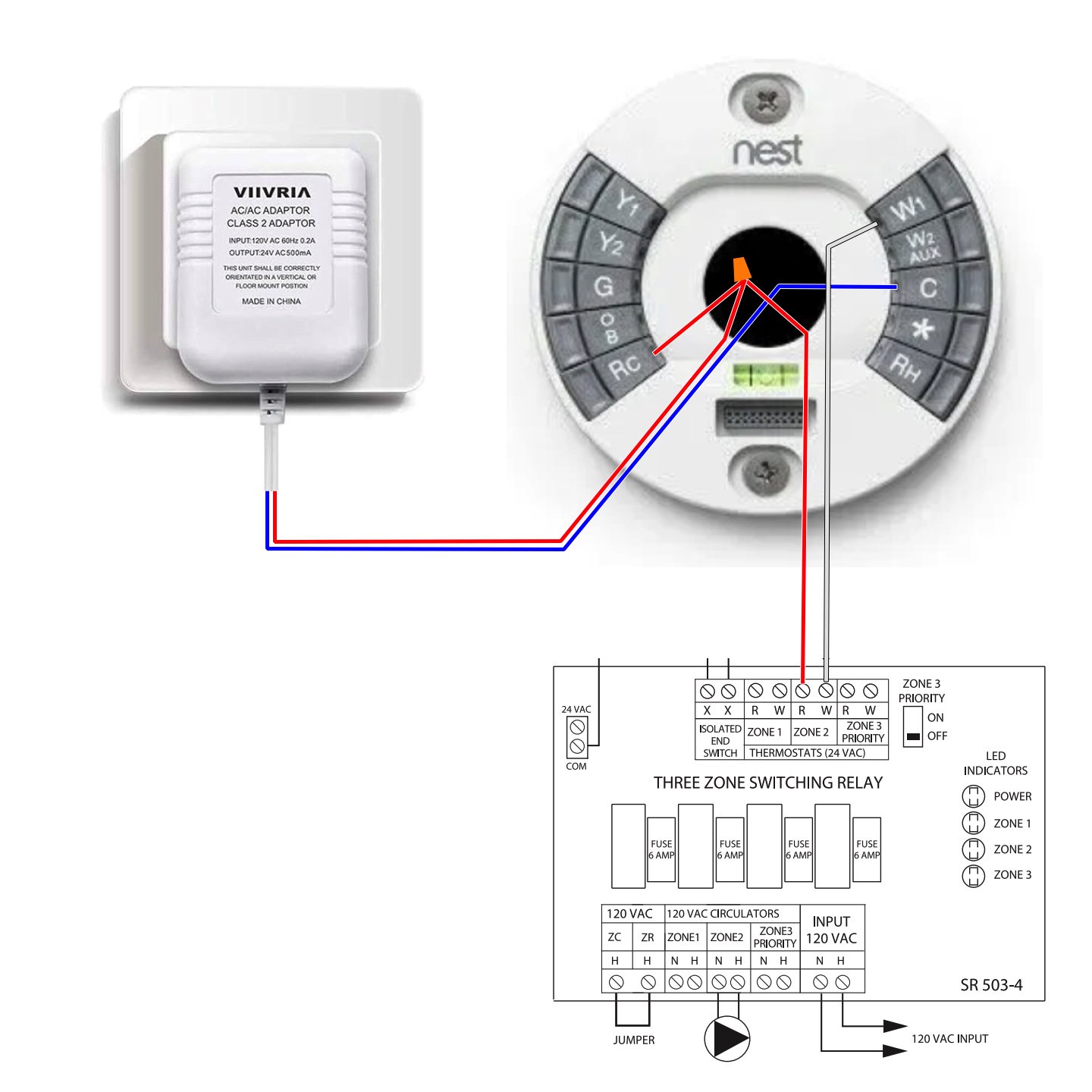

    can you help with a simple wiring diagram Thanks so much
    @DaveM PM @EdTheHeaterMan he probably already has the drawing you need stashed somewhere on this site. In the meantime
    I will post a simplified drawing I made which will give you an idea
    If you add a 40 va transformer you can power multiple Nest thermostats and relays off 1 transformer.

    If you are asking if the transformer in the Taco SR503 can power everything in the control along with three Nest thermostats I would say NO. You are better off using the power connector or a separate transformer to power the thermostat in each room like this one: Smart Thermostat transformer. You can plug it in a wall socket in the room where the thermostat is located and connect the R and C directly to the Rc and C on the thermostat.  Like this:
    You want to use the Rc or R terminal when you have only heat connected to the smart thermostat.  The only time to use the Rh terminal is when there are separate air conditioning controls and heating controls in order to keep the transformers separate.  With heat only this is not the case.

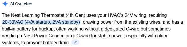

    3 NEST, so 6 VA consumed continuously doing nothing. Assuming it is actually a 15 VA transformer in your SR503, only 9 VA left for the internal load of the SR503. Not sure what a "taco power connector" is, I'm guessing it consumes power also. If there is no C wire to to second floor NEST then that battery needs to be topped off when there is no call for heat, an additional load.
