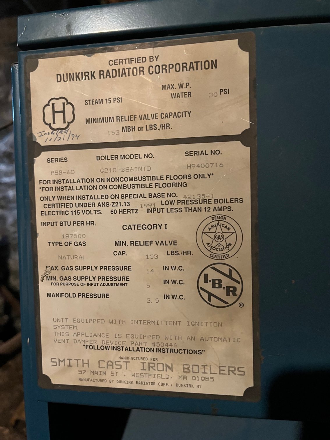

Boiler: Smith Cast Iron (Installed in 1994)

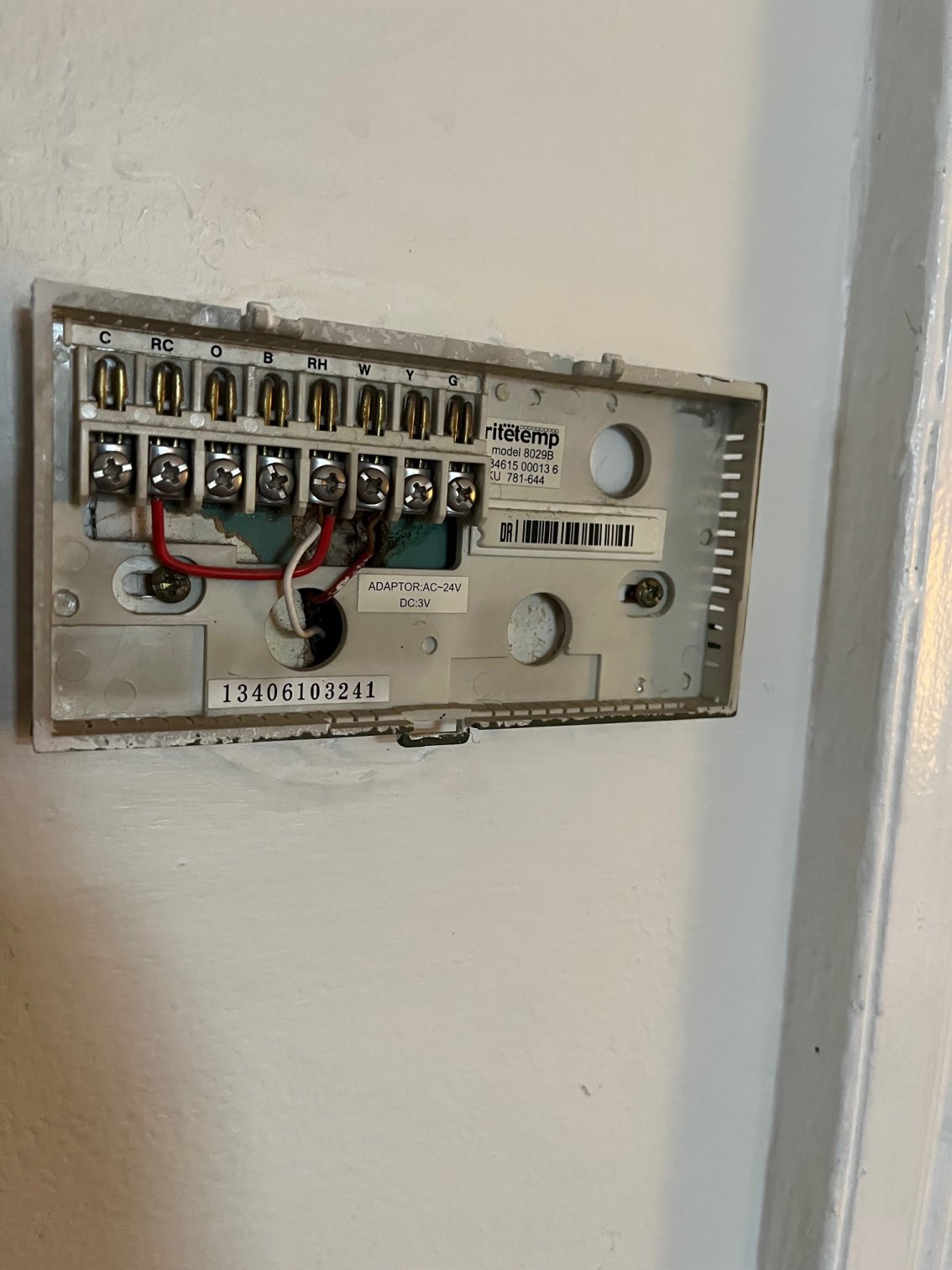

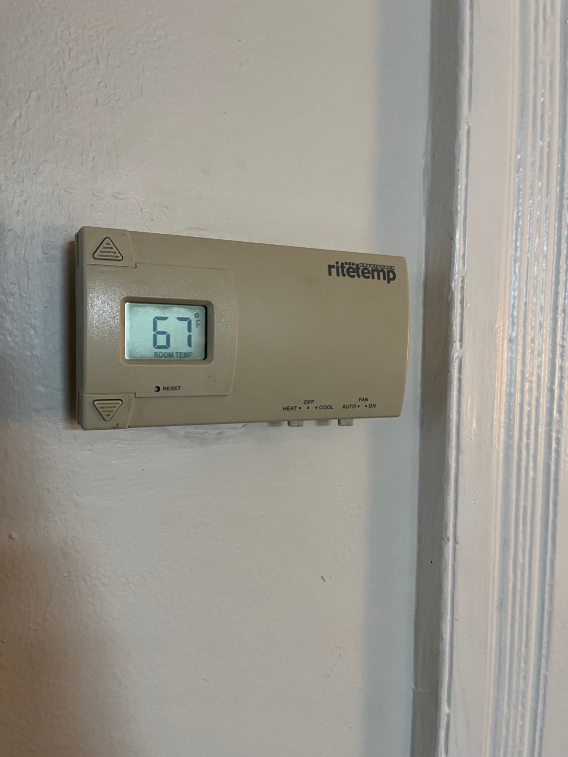

Current Thermostat: RiteTemp 8029B (Simple two-wire/Battery Operated)

I want a simple thermostat that works with my current two wire setup, and allows me to delay it kicking on until temps in my house have dropped by roughly 5-6 degrees from the preferred temperature. In other words, if I want my house to be 68 degrees, I don't want the boiler kicking on until the thermostat reads 62 degrees. I don't want it coming on when its 67 degrees. This is why:
  • From what I can tell, my boiler operates best when it has to raise the house temperature by 5 to 6 degrees. That takes approximately 25-30 minutes, and uses the majority of the water inside the boiler (but not all of it). Any more than 5-6 degrees and then the automatic water feeder kicks on for a second time, and the system has to reheat itself (which seems very wasteful for a few more degrees). Anything less than 5-6 degrees and then the boiler keeps kicking on and off, and it seems like the steam is more wet than dry. My assumption is because they system does not have enough time to drain back and air to clear the pipes.
  • When I am home and can manually turn the boiler on and off, I use the above 5-6 degree drop as my gauge, and only have to turn it on 3 or 4 times throughout the whole day to keep the house comfortable but not excessively warm. I may be wrong, but that seems like pretty good efficiency to me.
  • At night when I'm supposed to be sleeping or when I'm out of the house and can't manually turn the boiler on and off, the system is running almost every 15 to 30 minutes because of a one degree drop in temp. The whole system makes more noise, and seems to have to work harder for less gain.

    if only 2 wires
    Find a T87 at a yard sale

    @pecmsg - I'm guessing you mean the T87F (with the mercury) that I've seen others mention? Are the non-mercury versions of the T87 no good or are they just not as good as the F? Anything is better then what I got right now.
    So here is my question, what is the advantage to the T87? How does it help me make sure that my system isn't running for a 1 degree dip? Sorry if this explanation has been posted somewhere else, but I didn't see it.

    You’re gonna have to get a higher end thermostat that would allow you to program the differential to 5 or 6*. Maybe a Honeywell T6 or above?
    I’ve really never heard of someone wanting that and it’s sounds like you’ve got issues with the system that should be corrected instead of trying to operate it like that.

    187K is a lot of boiler.
    5°F swing is unheard of for heating.
