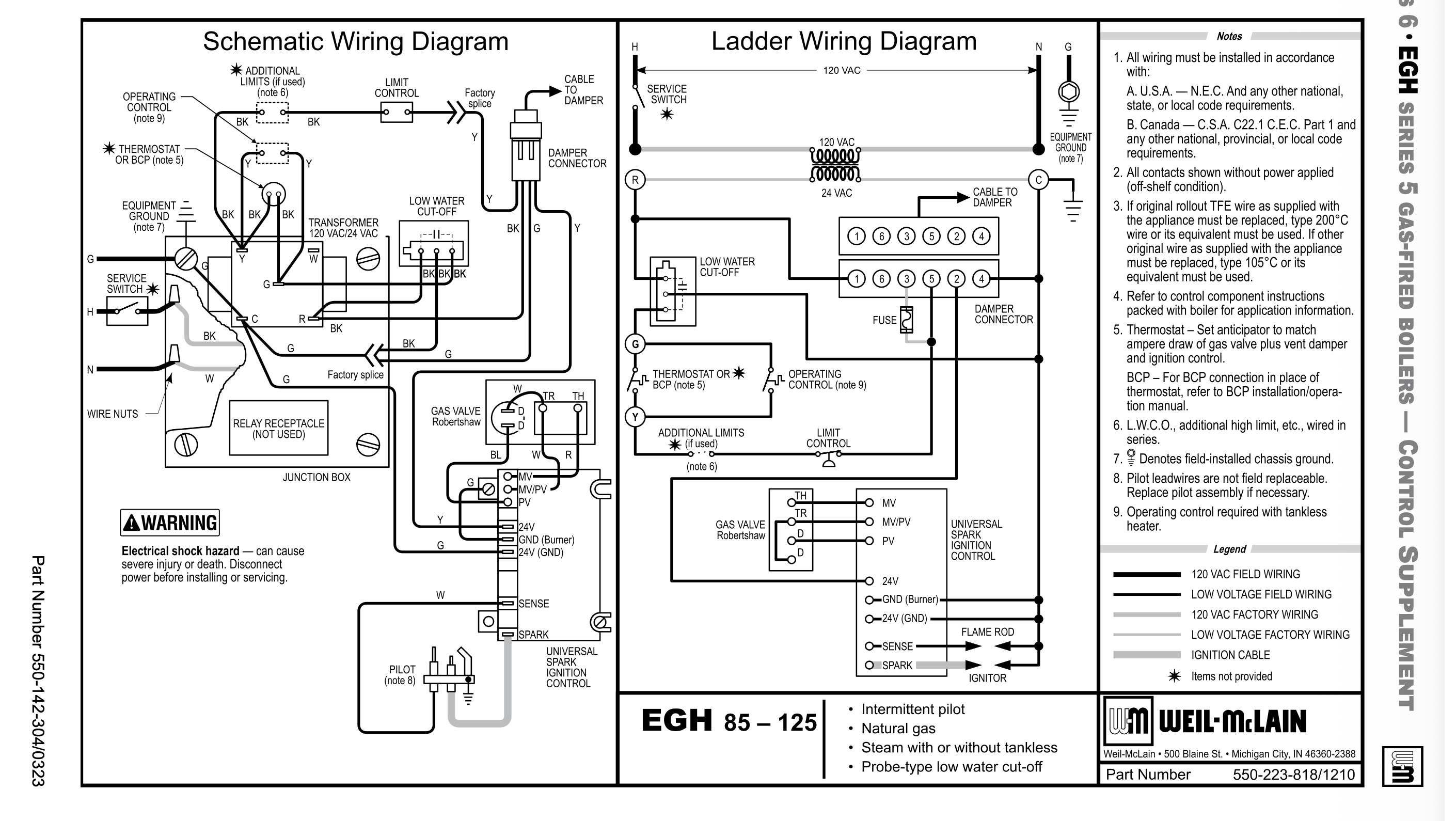

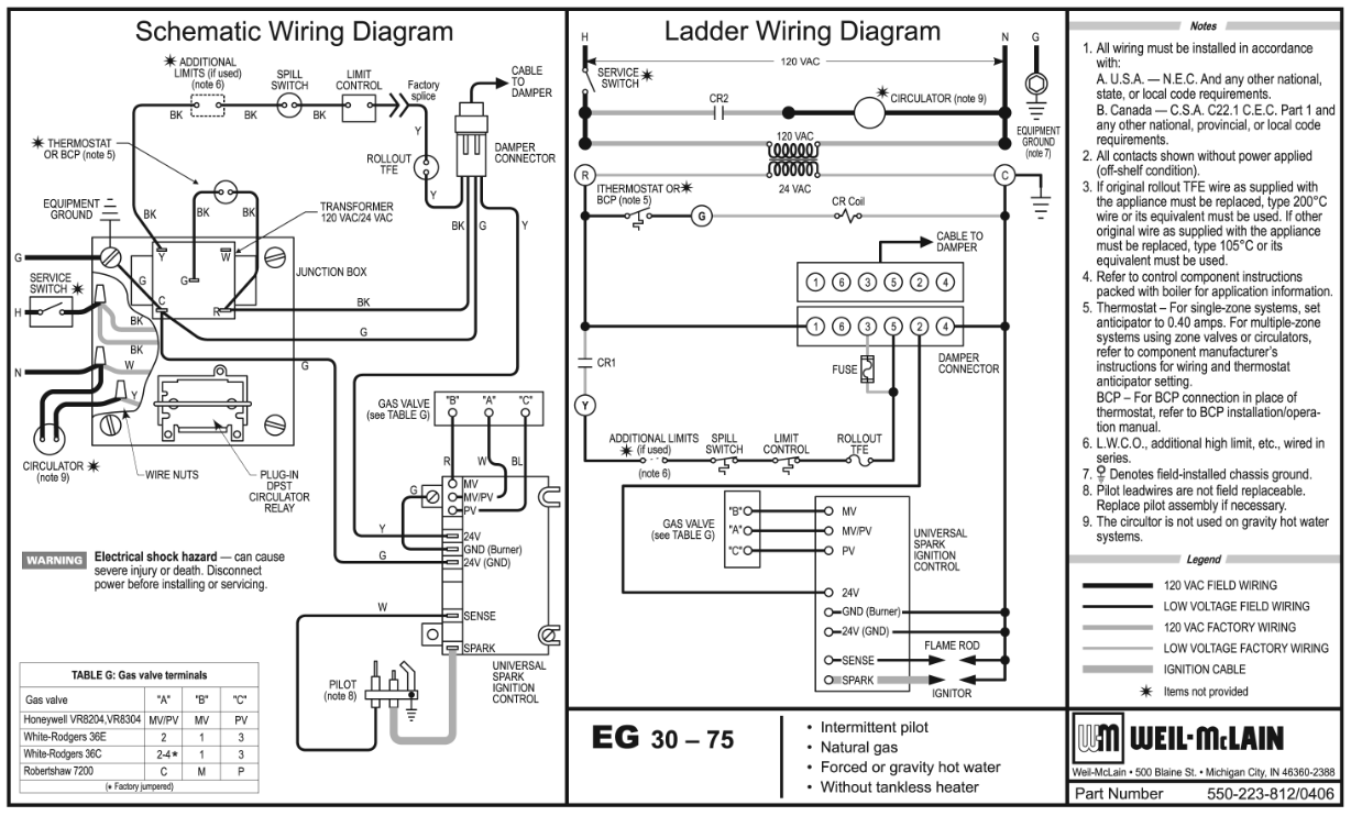

Weil-McLain EG/H: thermostat and pressuretrol shut the damper, but not the spill switch.
For troubleshooting purposes, I'm trying to explain to my guys that on a no-heat call the damper being open is the first indication there is a call for heat, but it will remain open if the spill switch is activated yet will close if the pressure is satisfied. The included wiring diagram does not support my claim. All the safeties and limits are before the end switch of the damper. Or am I reading this wrong? What goes on inside the damper has always been at the very limits of my electrical comprehension. Power to open, power to close? Whyyyyyy? Can't the damper just spring close like a zone valve?

    These always confused me as well and I am an electrician. Looking at the ladder diagram
    Basically 4 wires to the damper:
    1. Constant hot 24v from transformer "R" Black wire to #1 on the damper
    2. 24 volt common from transformer "C" Green wire to #4 on damper
    3. #2 on damper yellow wire to 24v on ignition control (starts burner)
    4. yellow at damper. Starts at "R" red on transformer through limit and operating controls to damper #5
    I have looked at the internal damper wiring. The way I think it works is:
    thermostat and controls call for heat, this pulls in a relay (internal in the damper) to open the damper but it just operates the relay. The damper power comes from the "constant hot wire". When the call for heat ends or pressure control or LWCO opens the damper loses its "signal" and the internal relay drops out and the damper is driven closed also by the constant hot.
    As for the damper position. The limits and thermostat circuit have to be closed for the damper to open. Once the damper opens the damper motor is stopped by the internal switches. Once the damper is open if a limit or stat opens the damper will drive closed.
    But if something was wired into the "constant hot" and that opened the damper will stop wherever it is.
    I don't see a spill switch on the diagram. If it was wired into the constant hot and it opens the damper can't move.
    The confusing part is the hot from the thermostat and limits just operates the internal damper relay. The damper power comes from the constant hot.
    Hope this helps. Maybe @EdTheHeaterMan or someone else who knows this better than I do will comment.

    All depends on where the limits are wired into the circuit. If the spill switch trips it may be best practice to keep the damper open, spring close would not allow that.
    The spill switch is on the control side of the damper on this one.

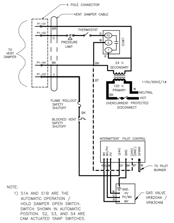

    In this case I believe with a tripped rollout or blocked vent safety limit, you may find the damper open with a call for heat. However if the 120 to 24 VAC transformer dies with the damper open, the damper will remain open. I would think learning the circuits the basic components and use of a multimeter may give more consistent troubleshooting results, but it is not for everyone.

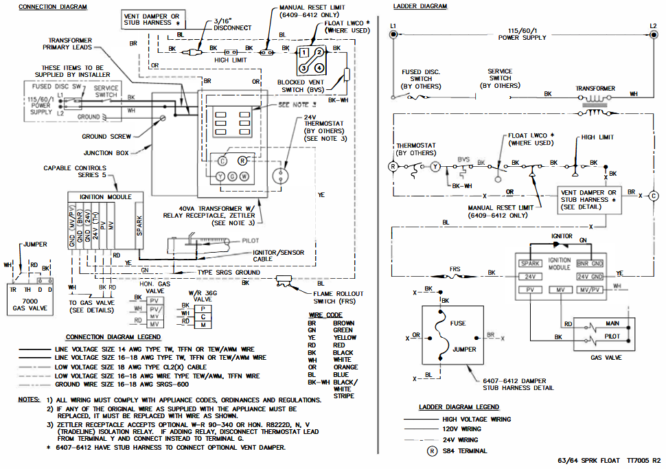

    @109A_5
    In @JohnNY diagram there is no spill switch shown
    In the first diagram you posted if the spill switch opens the damper will drive closed
    In the second diagram you posted the spill switch opening will stop the burner and the damper will stay open if the controls are calling for heat.
    109A_5 Posts: 4,761
    edited December 2025
    Yes, those diagrams were intentionally chosen and I thought the operation was kind of obvious, which is why I chose those diagrams. If not, thank you for the clarity. Which is why I basically suggested better education and troubleshooting technique and not base 'no heat' troubleshooting on whether the damper is found open or closed.
    A damper found open may give you correct troubleshooting direction or it may not, it's just an open damper. IMO learning how to troubleshoot basic electrical circuits is much more valuable than the open or closed state of the damper.
    109A_5 Posts: 4,761

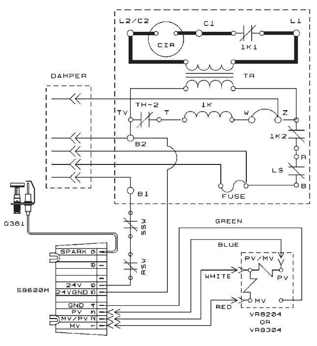

    So here are two other variations. The first example a tripped Blocked Vent Switch will close the damper. A tripped Flame Rollout Switch would result in the damper staying open.
    In this case a tripped Blocked Vent Switch (SSW) or a tripped Flame Rollout Switch (RSW) would result in the damper staying open.

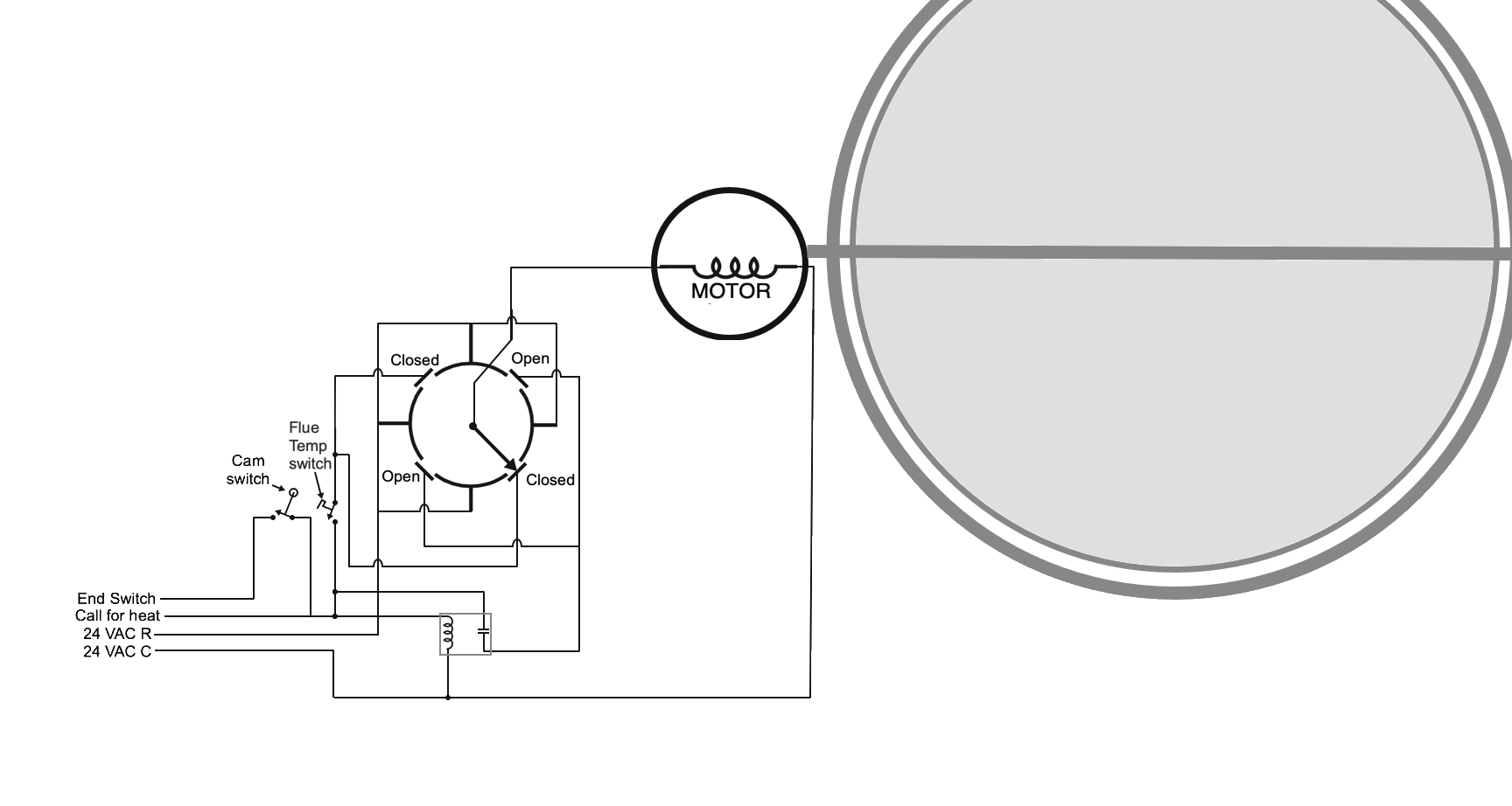

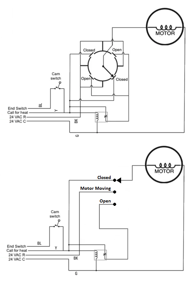

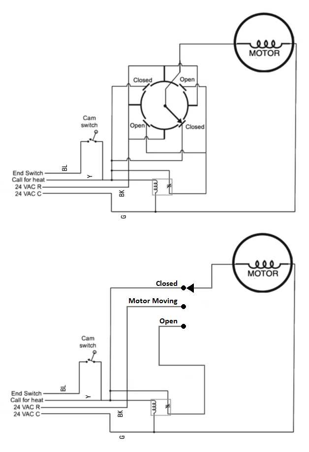

    The best diagram I have on the internal of the auto vent damper, and this is from a long time ago (not the current Fields/Effikal version) is this one:
    The motor stops at each 90° turn of the motor. 90° to open, 180° to closed, then 270° to open, then 360° = 0° to close. There is constant power needed to operate the motor to close the damper after the call for heat is satisfied. @EBEBRATT-Ed has the correct wiring description

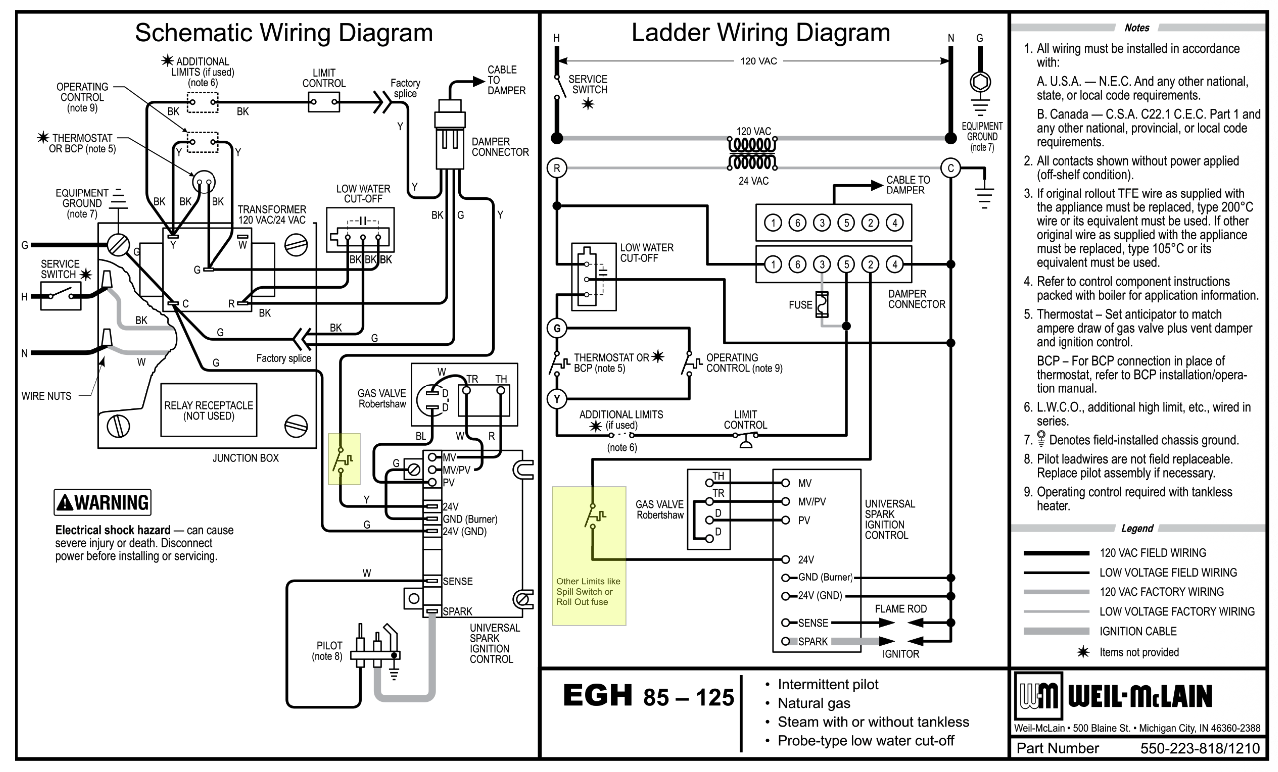

  • As far as your original Query "For troubleshooting purposes, I'm trying to explain to my guys that on a no-heat call the damper being open is the first indication there is a call for heat, but it will remain open if the spill switch is activated yet will close if the pressure is satisfied. The included wiring diagram does not support my claim. All the safeties and limits are before the end switch of the damper. Or am I reading this wrong? What goes on inside the damper has always been at the very limits of my electrical comprehension. Power to open, power to close? Whyyyyyy? Can't the damper just spring close like a zone valve?"
    I might suggest that the Roll Out Fuse and the Spill Switch are not specifically noted in the Schematic Wiring Diagram or the Ladder Diagram. Look closely at the Roll Out Switch actual wiring on the appliance to see if that was added by the installer to break the circuit from the #5 on the damper plug to the 24V on the ignition control.

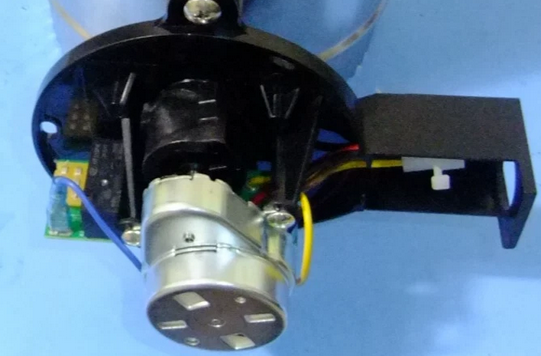

    Page #6 shows damper internal wiring. I don't see this damper stopping every 90 degrees. The "constant power" drives the damper open or closed. Weather it opens or closes depends on if the limit circuit is calling or not calling.
    So basically, anything in the limit circuit wire #5 on the damper that opens will cause the damper to close.
    If something is wired between #2 on the damper and the ignition control opens the damper remains open.
    I think part of the confusion is that the 24 volts to terminal #1 on the damper is the power to drive the damper. Constant power
    The limit circuit to terminal #5 pulls in or drops out the spdt relay in the damper to open or close the damper
    The other thing (at least with the Honeywell) is that when the boiler is firing and the damper is open it just sits there with no power to the motor.
    @EdTheHeaterMan your internal diagram is giving me a migraine. Not understanding that one.
    Guess different brand of dampers have different internal wiring but work with the same 4 wires.

    With the upper original schematic the motor control switch that changes state by the movement of the motor and indexed to the damper plate can be simplified and drawn like this in the lower redrawn schematic. Although the switch in the simplified drawing does not show the 90 degree damper plate indexing.

  • @109A_5 I saw some flaw in the wiring logic so I fixed it. That first old diagram I copied was never proofed to see if it works… it was just a concept drawing from taking apart some old damper that is no longer made. It took a long minute to find it but I knew it was on an old computer somewhere
    @EBEBRATT-Ed said: @EdTheHeaterMan your internal diagram is giving me a migraine. Not understanding that one.
    Take each circuit one at a time if you want to understand it.
    Everything in Red is powered and the blue is the return path to the transformer. The purple Is the path from the rotary switch arm to the hot side of the damper motor.
    The switch arm in the closed position has no power until there is a call for heat
    That call for heat causes three things to happen (See Orange wires).  The Closed contacts get power to start the motor.  A relay coil causes the power to the Open section to the rotary switch to lose power and the motor then reaches the “Always Hot” portion of the rotary switch so it continues to operate until it is completely open.
    When the motor reaches the full open position the motor stops since there is no power to the Open contacts on the rotary switch. Also the Cam Switch (End switch) closes sending power to the burner circuit (Green wire).
    The burner operates safely with the damper open. Eventually the call for heat or a limit stops the burner.
    The orange call for heat looses power and the green to the burner looses power but the thermal switch may keep the damper open for a time in order to clear out the byproducts of combustion from the boiler or furnace.
    Eventually the thermal switch will close and power the open portion of the rotary switch.  The motor will start and travel to the always hot portion of the rotary switch and finally end at the closed portion of the rotary switch then stop.  The cam switch will open as soon as the damper motor starts to close the damper.

    OK @EdTheHeaterMan just conceptual, looks like it would work. Yeah the Flue Temp Switch is in a non-helpful place.
    I think you would find the circuit board version is pretty much the same as the version that @EBEBRATT-Ed posted, just built different but electrically very similar.
