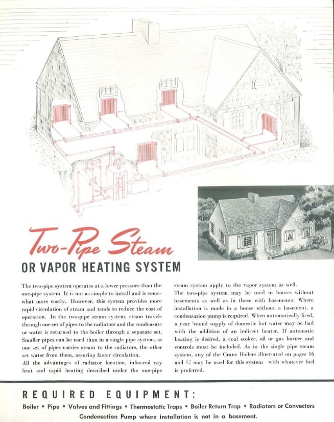

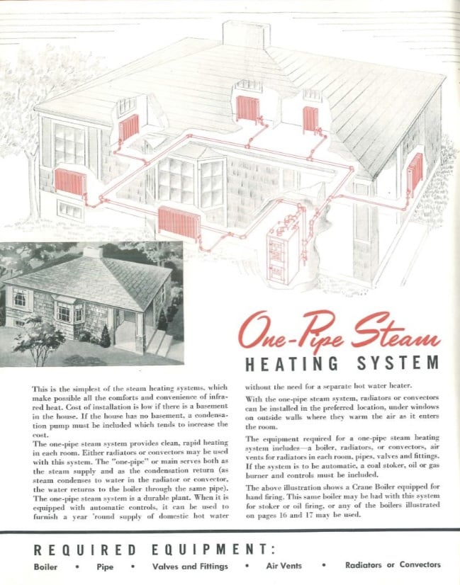

Looking through some vintage Crane/American Radiator Company catalogs got me to wondering if steam is even still an option for new construction residential houses or even old houses undergoing major renovations (gutted to the studs)?
Keep in mind, location matters so I’m referring to Northeast/Midwest/Canada and other cold regions where -edited- professionals exist to install and service boilers. With this hypothetical scenario, money is no object for the homeowner. Use this image from Google as the theoretical new build house we are trying to heat with steam. 😃
From Crane brochure:

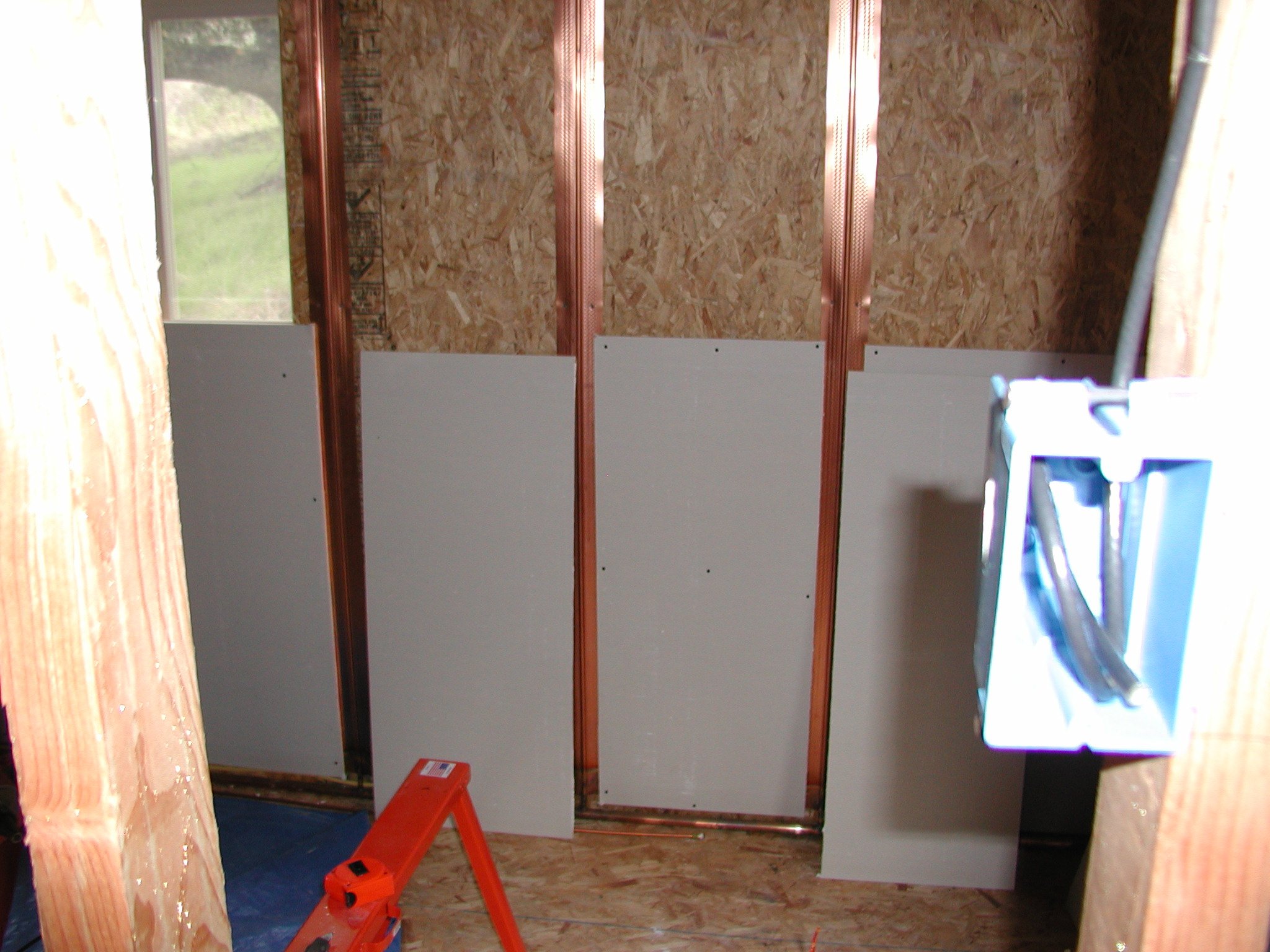

    Generally folks with budget to spare don't want to look at rads. You can see this even in older mansions where the rads were in the floor.
    People also now want AC and since budget is optional there is usually snow melt.
    This tends to mean heated floors off a modcon with ducted AC/HP for cooling.
    I guess you could do underfloor heat off steam if you really put your mind to it.
    The other issue up here in the great white north, is you can't get any cast units any more as they don't meet efficiency standards. Lack of equipment, lack of knowledge, high cost, steam is a non starter.

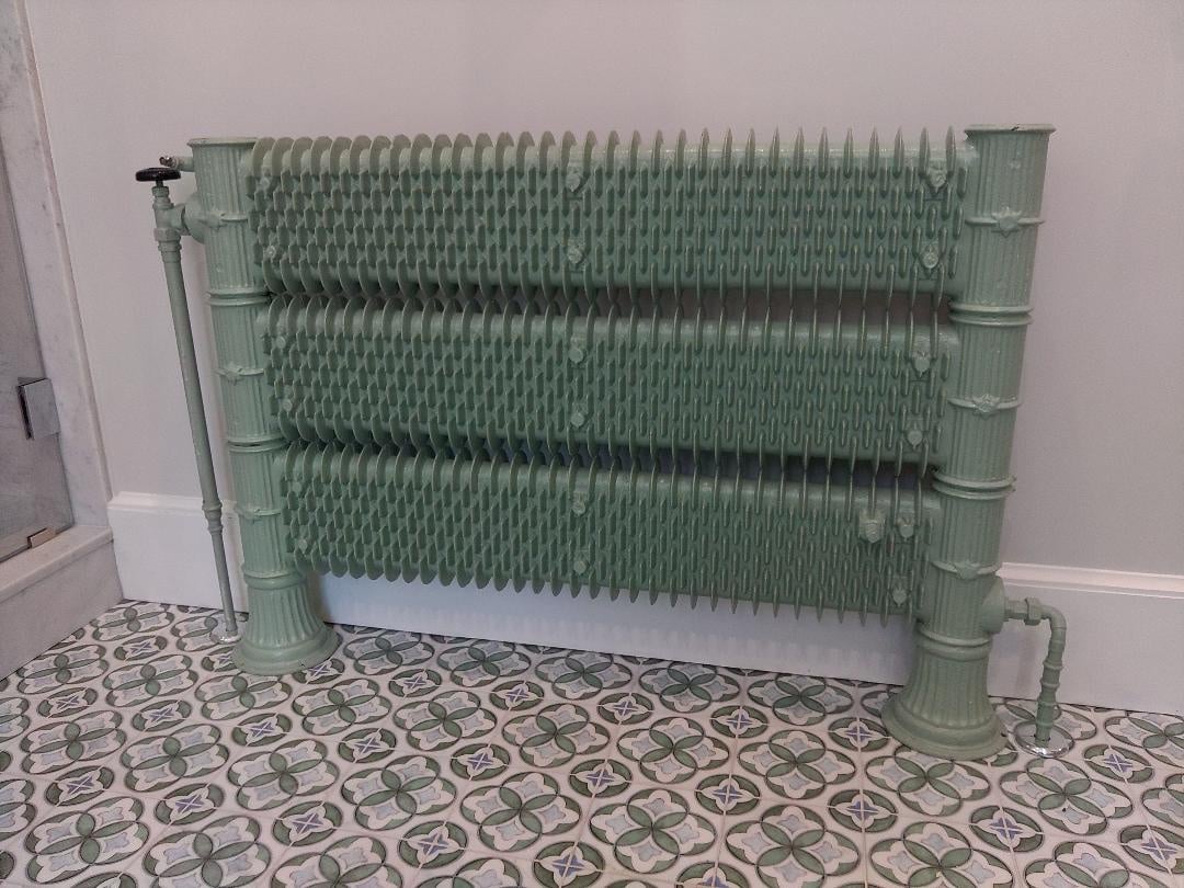

    Below is an example of one I found on a job I thought was extra interesting.
    And above is an old post from this site that shows some examples of really nice radiators.

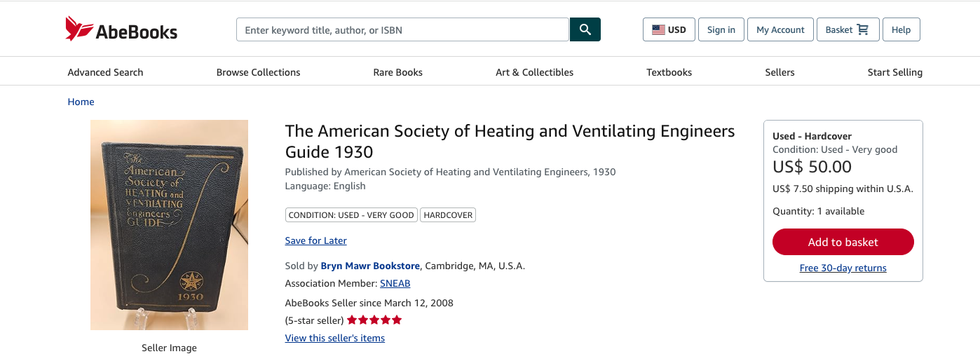

    If I were to install a steam system, I would start with this book. It takes you from heat load calc, radiator and pipe sizing, near boiler piping and plenty of math and formulas to explain along every step of the way.
    I found this online a few years back, there were others offered.
    It also explains the concept of "pumping away" with 1930 graphics :)
    Here is one that is available
