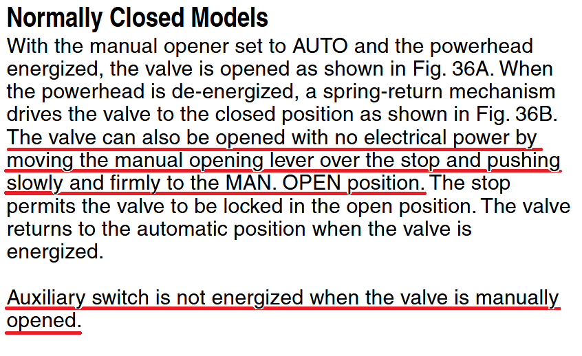

    What the 'End Switch or Auxiliary switch' does in the manual mode may be brand or model specific.

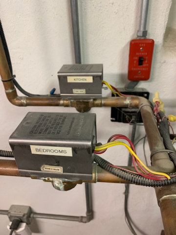

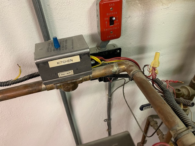

    I'm back!
    I thought it was the boiler to thermostat wire and have been testing. I had put the thermostat back in place w/new batteries and all was fine. That was after testing with a thermostat connected to short jumper wires at the boiler which worked nicely.
    However…
    Everything has failed again. Running a thermostat on the jumpers at the boiler doesn't work anymore and the system never shuts off.
    The 2 zones into 1 has zero to do with it. It's been that way for a long time. There are 2 zone valves and 1 circulator. I simple have the one zone valve locked open at the boiler so any water that circulates when the first zone is triggered flows into that 2nd zone. They are Honeywell V8043 Zone Valves designed for that as 109A_5 points out.
    Tearing my hair out, for the hell of it, I unlocked the zone without a thermostat and the valve did not close. I figured maybe it's been locked open so long that something froze in that position. I then tried with the thermostated zone and same thing. Both motors are roughly 5-6 years old, so ****???
    I've been manually powering the boiler on and off via the emergency shut off switch (120V) on the wall. This morning while it was running, I pushed close both valves. The one w/no thermostat had no effect. When I closed the thermostat connected valve, the boiler shut off, the flu vent closed, but the pump kept on pumping. Even cycling the emergency shut off has no effect on the pump when it's in the on position.
    No one has touched the wiring in 10+ years except for me attaching the thermostat where the wire nuts are off. I have to think this issue is in the valve electrical circuit but know nothing about it.

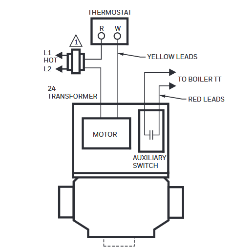

    There are 4 switches and some wiring to deal with, that is it. Two 'End' or 'Auxiliary' switches in the Zone valves and two thermostats (and one thermostat I think you said is disconnected).
    Disconnect either of these wires, what happens ? If the boiler shuts off or does not come back on (if you shut off the boiler to disconnect the wire) the issue is in the Zone Valve / Thermostat circuit.
    With all thermostats off, one at a time disconnect the wire that goes to the boiler at each zone valve. When the offending zone valve's 'End Switch or Auxiliary switch' is disconnected the boiler will shut down, if not it is the wire between the End Switches and the boiler that is shorted.
    Once the offending zone is identified, disconnect the thermostat wire to that zone valve, at the zone valve, see if the boiler shuts off.
    109A_5 Posts: 4,759
    edited November 2025
    For two zones the zone valve's auxiliary switches are paralleled.
    In other words the Thermostat(s) call for heat powers the zone valve motor. The motor turns the valve.
    When the zone valve gets to the end of its travel (valve completely open) the 'End Switch or Auxiliary switch' closes activating the boiler.

    Try disconnecting the Yellow wires of the zone valve of the "thermostat connected valve".
