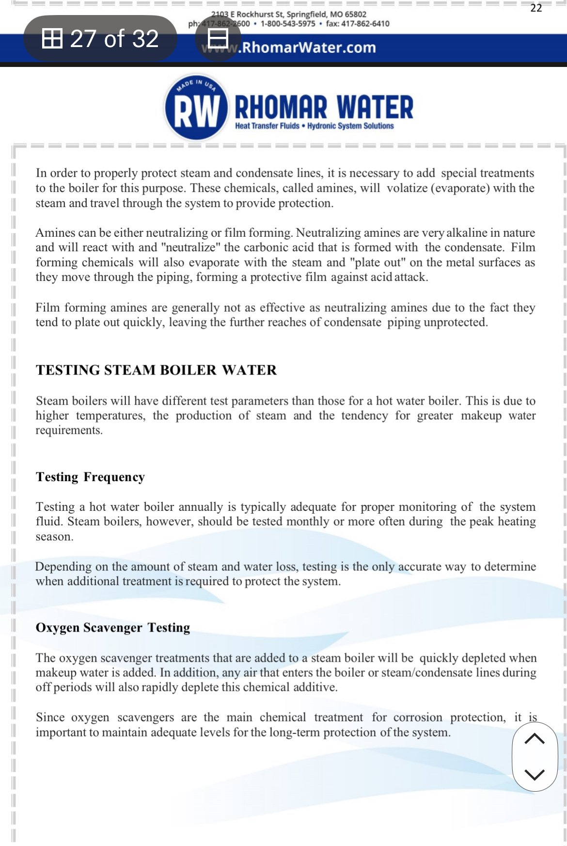

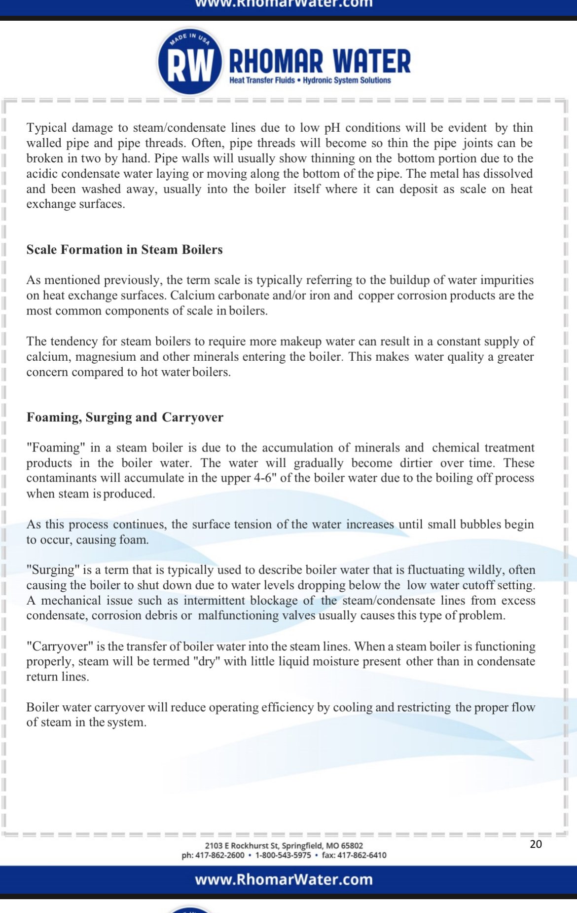

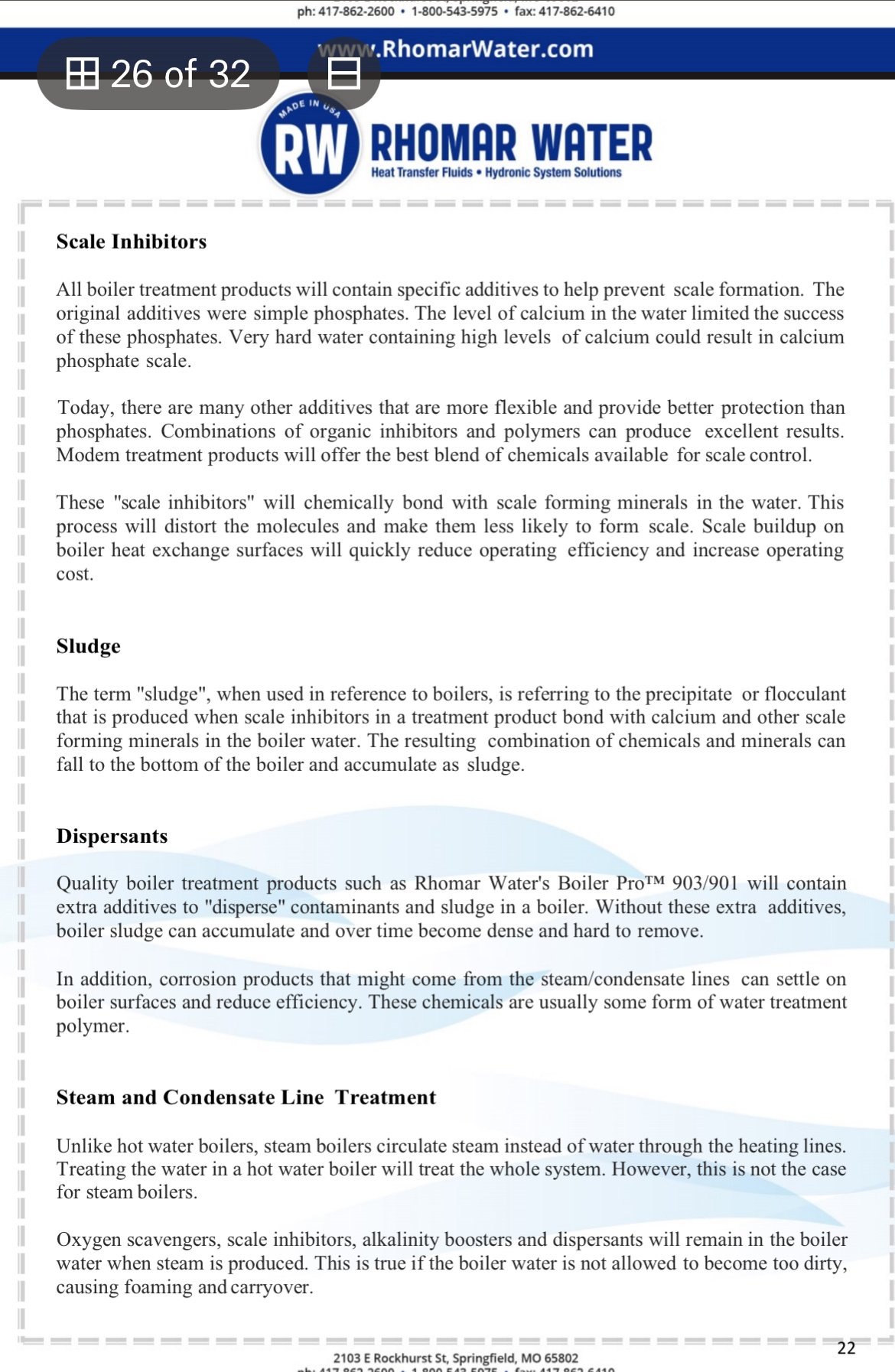

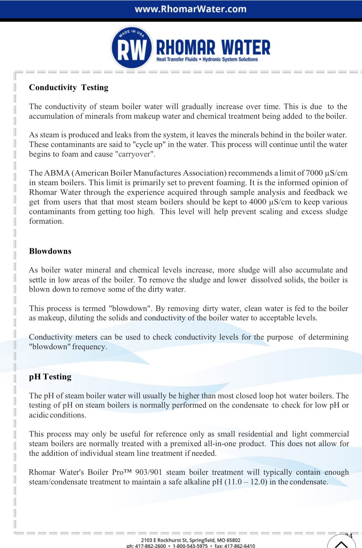

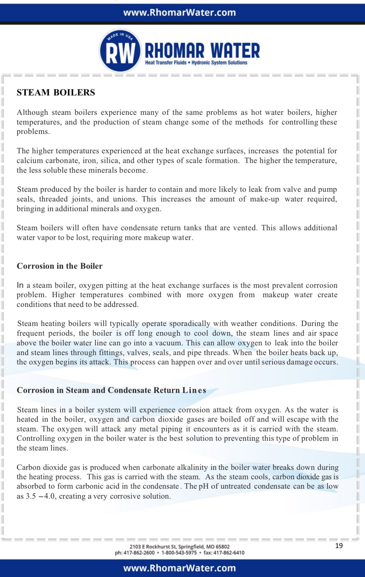

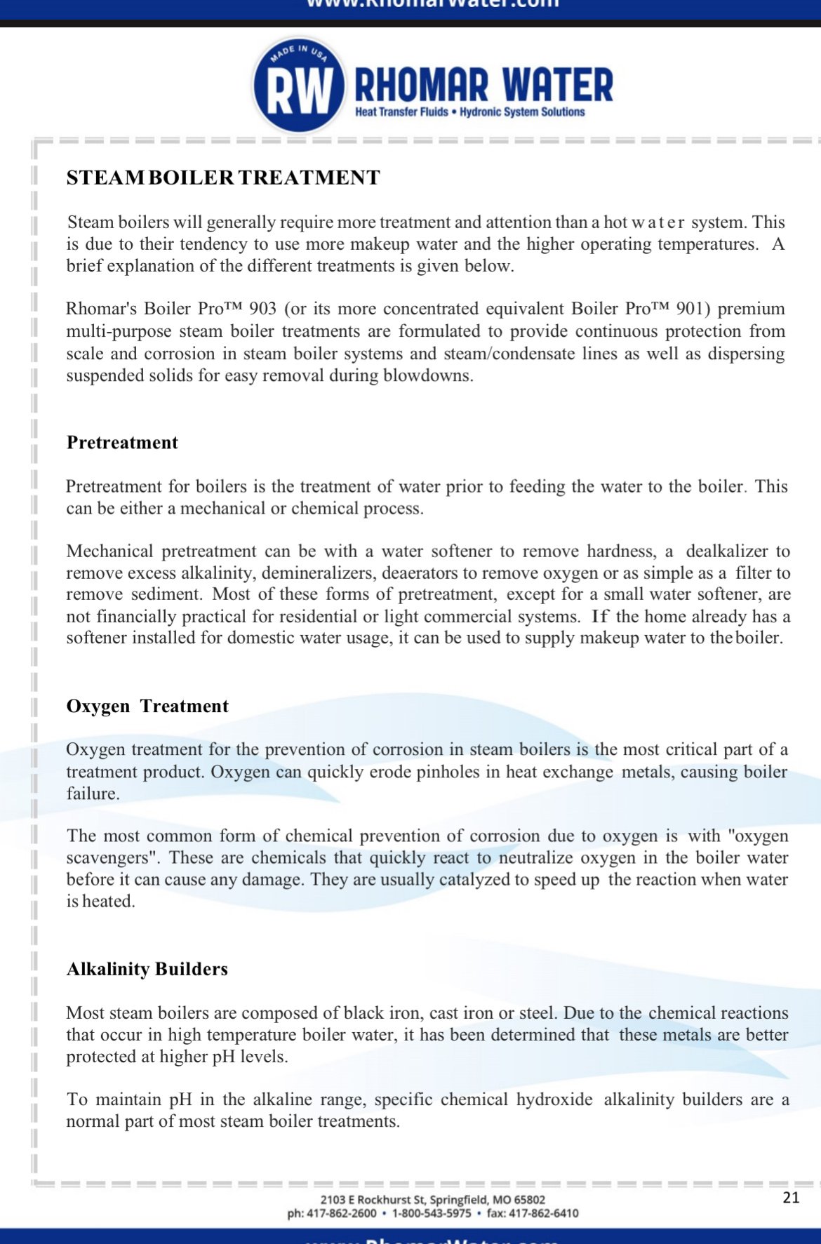

    hot_rod Posts: 28,708
    Rhomar has a good section on steam boiler water in their manuals
    IMG_1669.jpeg IMG_1670.jpeg IMG_1671.jpeg IMG_1672.jpeg IMG_1673.jpeg IMG_1674.jpeg
