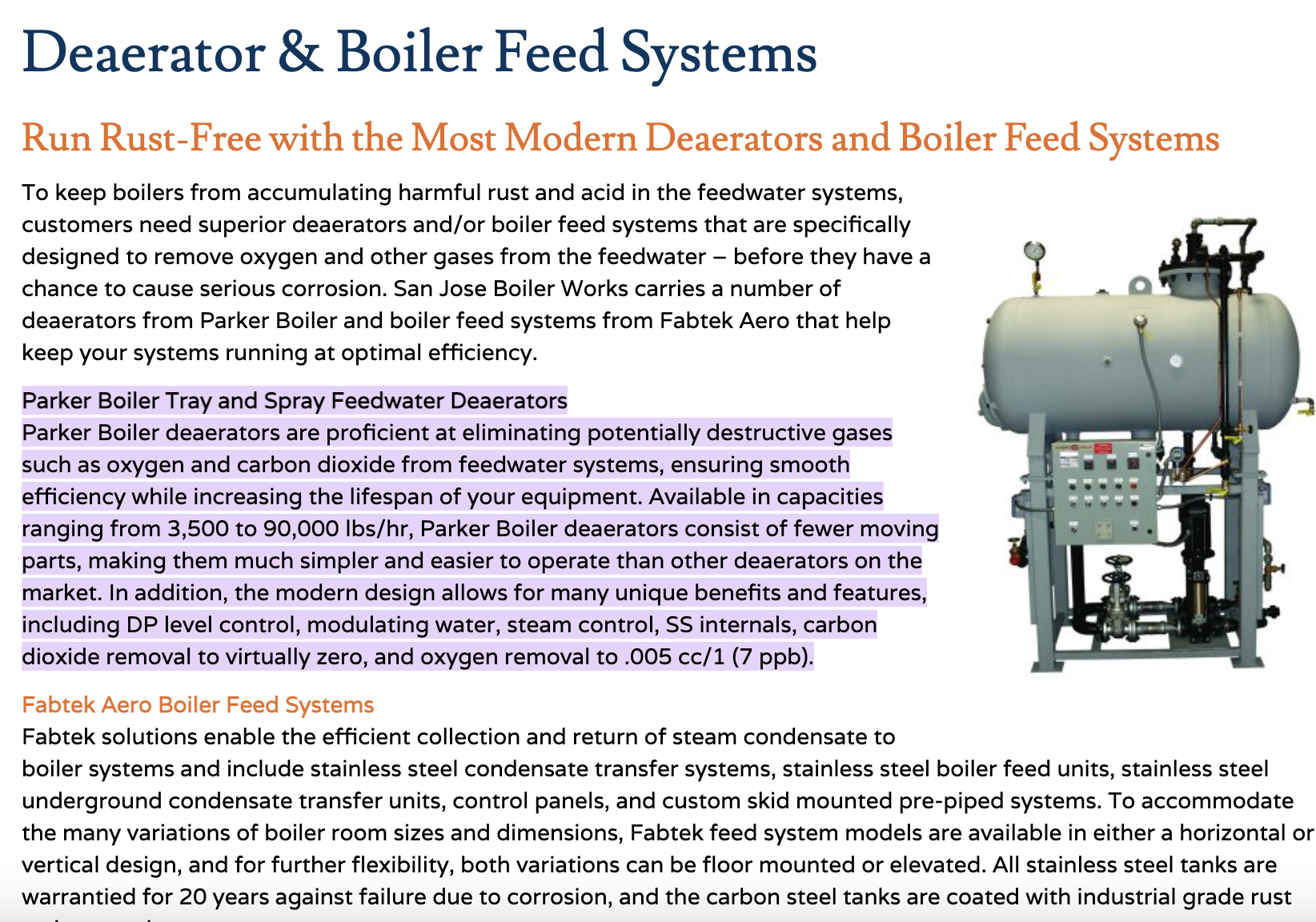

Commercial installations, especially when steam goes to waste, have "degas" devices to strip O2 & CO2 from feed water. Then there's complications concerning pumping that treated water while preventing air from re-entering.
An example of a large commercial deaeration device.
Rarely seen on residential systems.

@hot rod has it exactly right. All large commercial and industrial steam systems should have Deaerators with boiler feed pumps to return water to the boiler. Also , the water should be treated as necessary by someone that knows what he is doing. This will extend the life of the boiler and piping system and allow the boiler to operate efficiently.

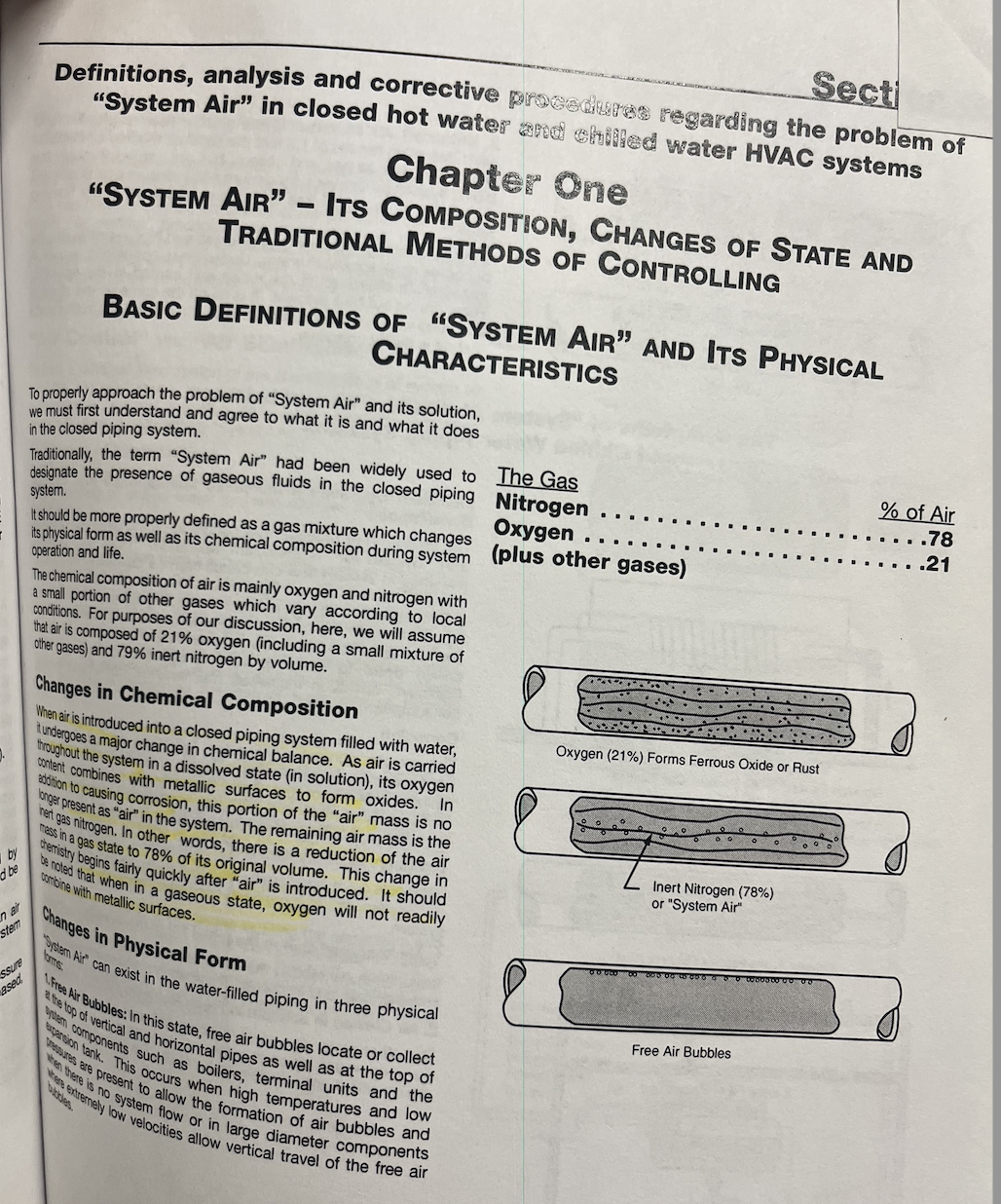

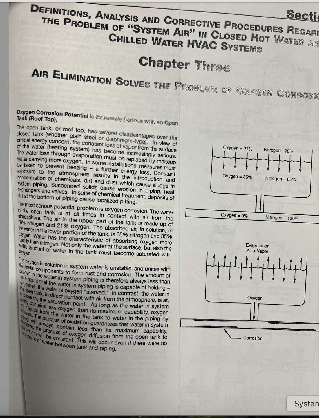

You are filling mostly with mostly nitrogen, their is approximately 20% O2 in H2O, 78% nitrogen.I think you are thinking of how much oxygen and nitrogen is in our air
Yes and the air that is within the water.
Amtrol talks about the air, O-2 and nitrogen component. They did studies on the amount of "air" in water that enters you building.
This Amtrol Handbook should be required reading for anyone in the hydronic business. So, so many problems could be avoid if hydronic folk read this book. It is one of my most used books.
Excellent explanations of p
umping away, air removal, sizing, compression vs hydro pneumatic tanks, troubleshooting, etc.
I think an online version is out there.
Living the hydronic dream3 -

Read the book and we can have a discussion. I trust Amtrol did their homework on this topic.

I think most would agree corrosion in open or closed systems has to do with the O2 inside, regardless of how or when it enters.

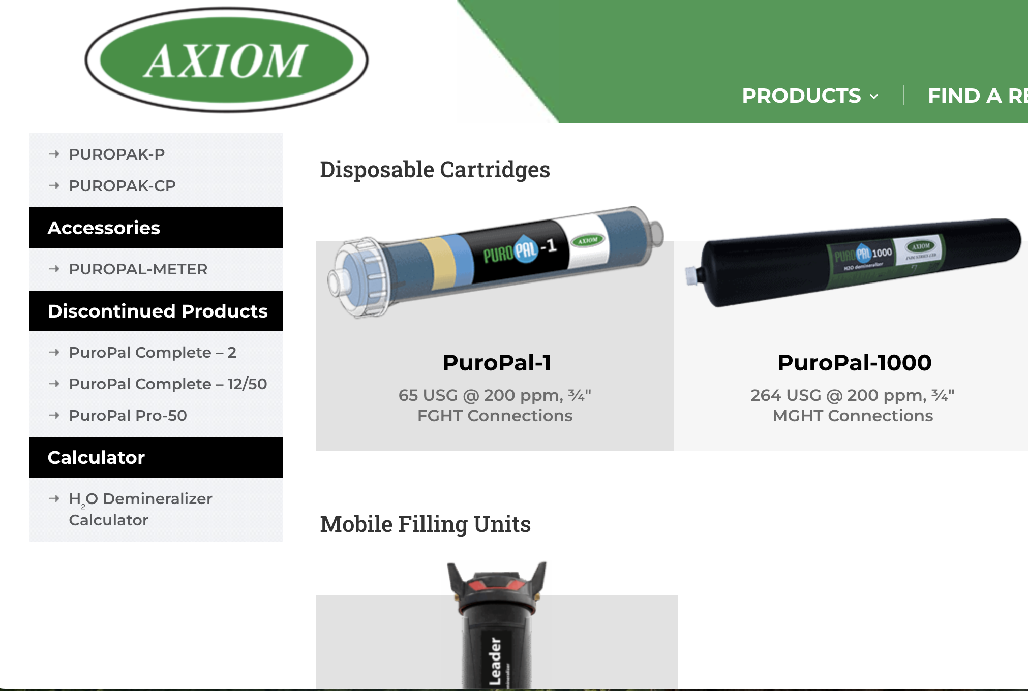

These are becoming very common for one or two time use for filling residential systems.
These will scrub out all the + and _ ions giving you pure water. This will result in a low ph. The ph buffers up quickly as the water touches the metals in the system. The actual gallons you get out depends on how bad the water going in is.
Many, myself included, like to add a hydronic condition to give you even more protection . If the fill water is aggressive the conditioner buffers that.
