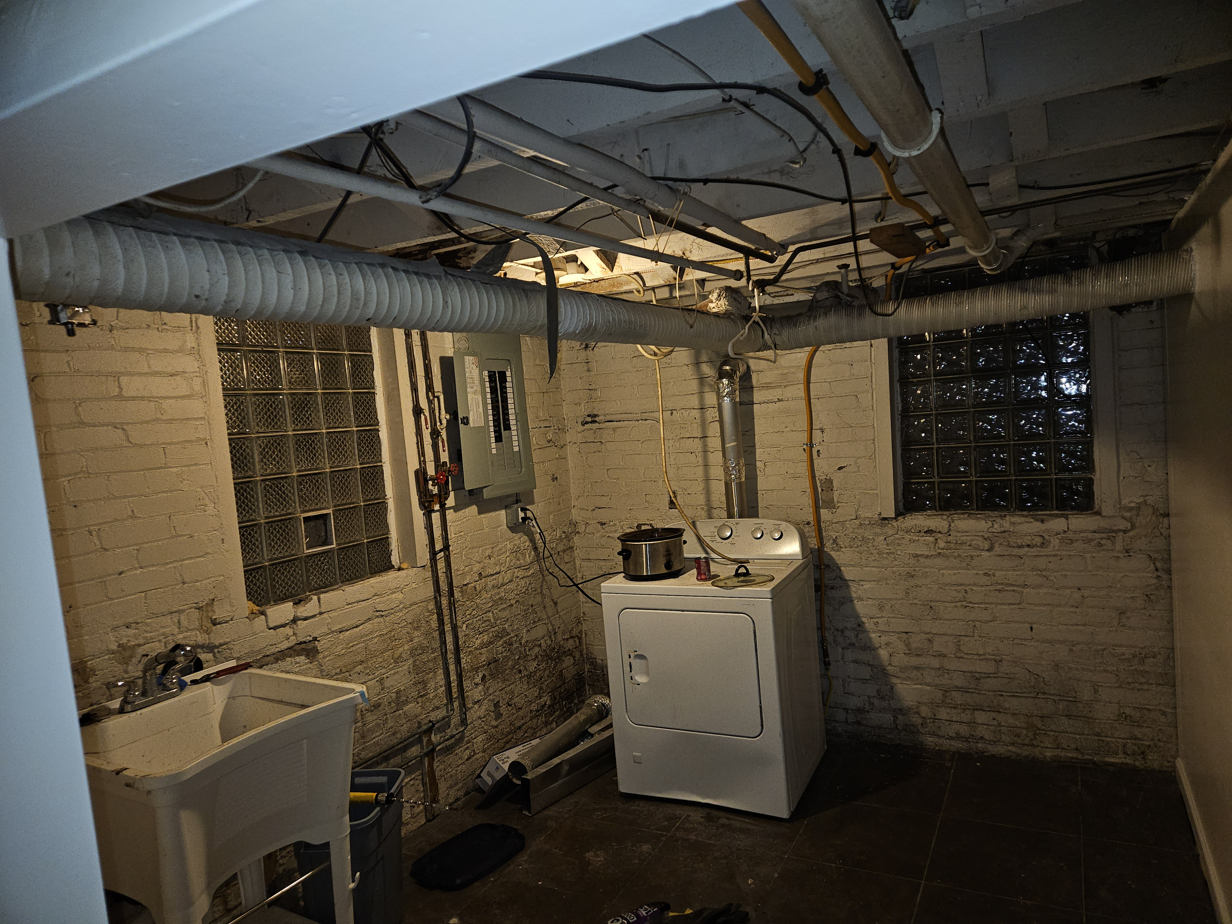

I have a few rental units, and this one is new to me. Old 1900~ brick 2-story side by side duplex in the Detroit Area, each side has its own steam system, and the unit in question is currently empty. This is my introduction to steam. I'm trying to get better at not doing EVERYTHING myself(this is hard for me, I have trust issues with contractors), so before I fired this system for the first time a couple months ago I hired a family friend HVAC professional to come "inspect" the system. I heard things like "Everything looks good" and "these boilers last forever" and "there's not much to them".

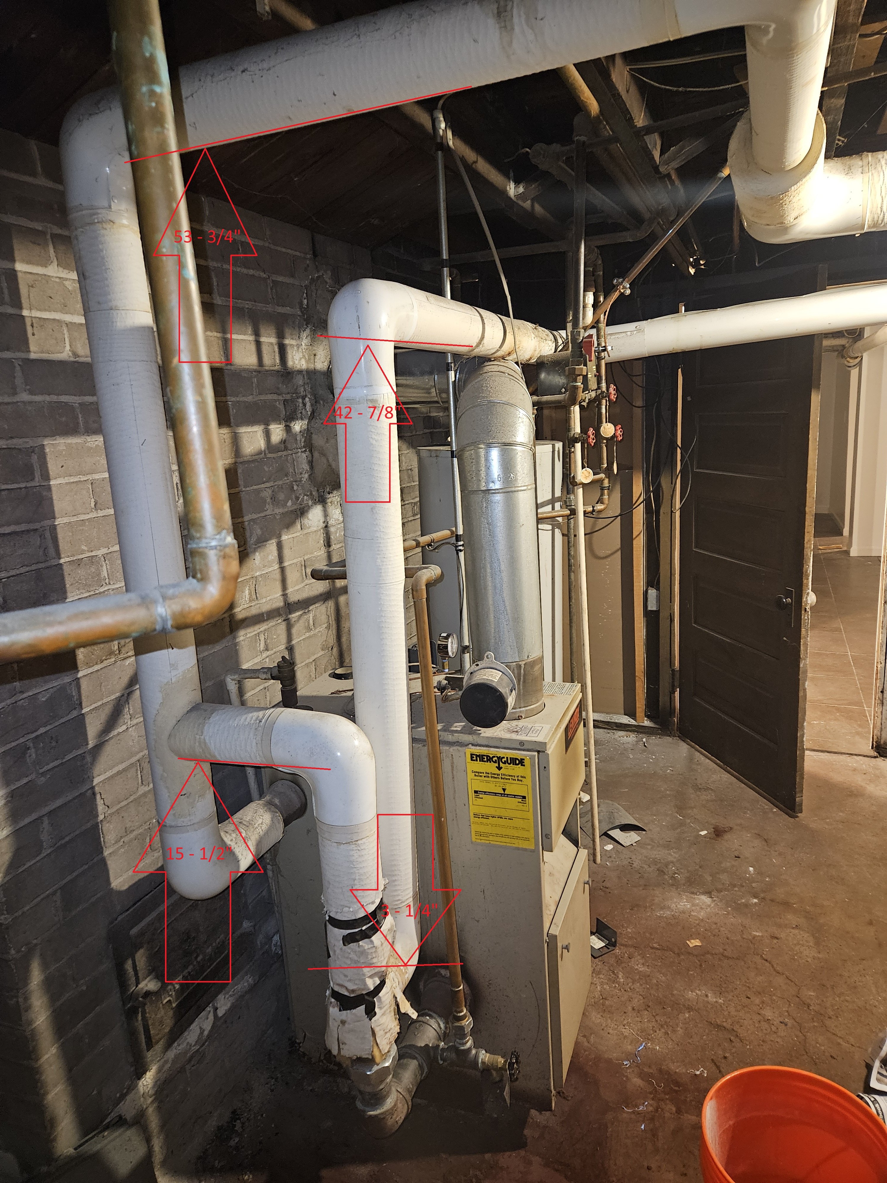

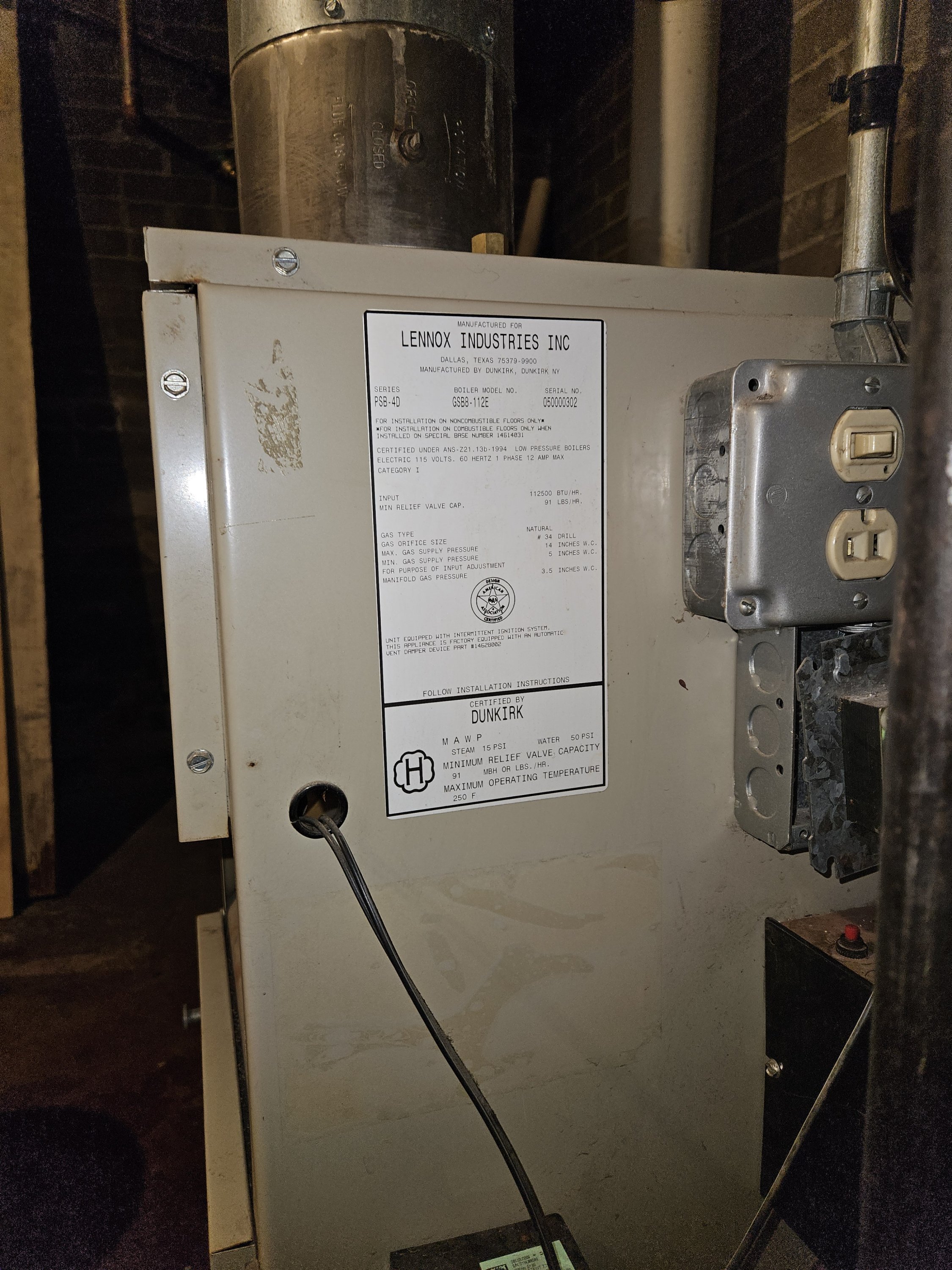

Here is what I got so far:
Boiler is a Lennox (Dunkirk) GSB8-112E

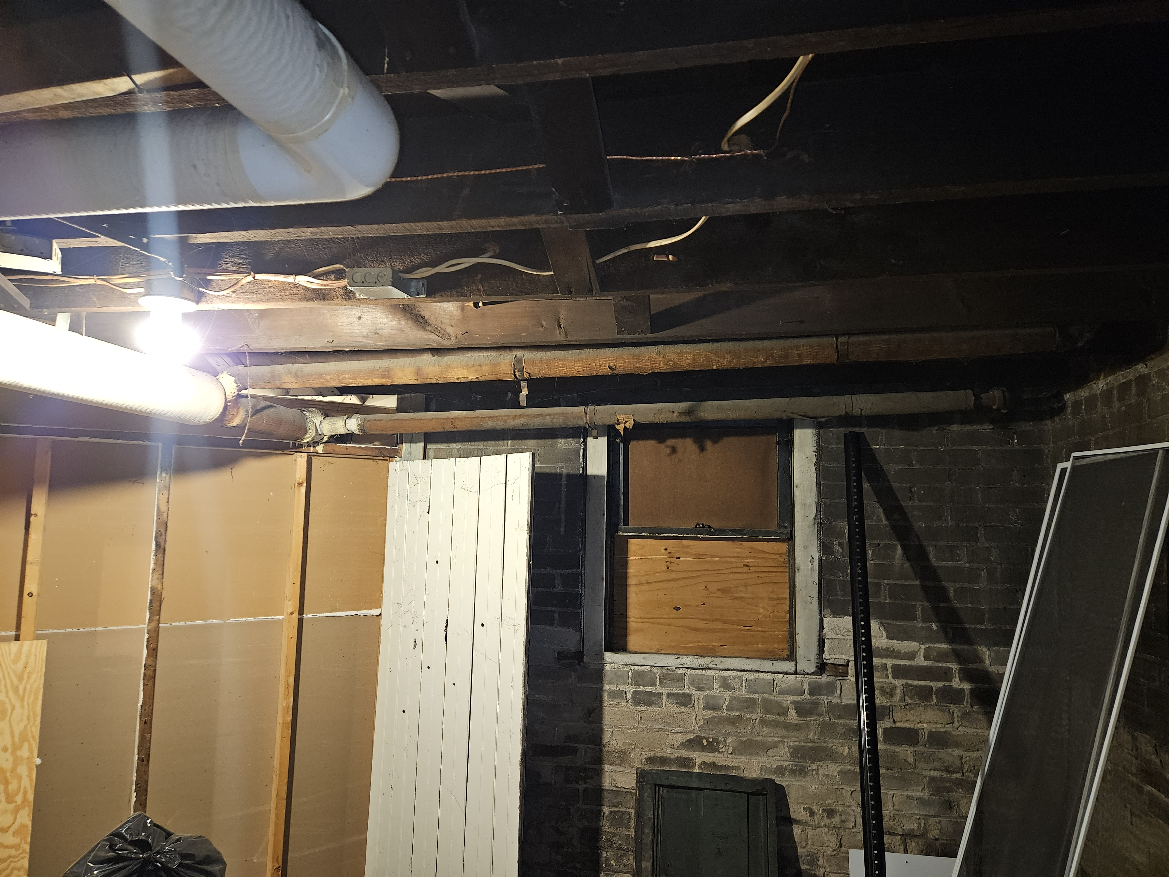

1- 2.5" pipe roughly 90' around basement, The single main is roughly 58' to last rad run, dry return roughly 32' from there to boiler. No main vents(or signs there ever was one).
6 rads, 3 on 1st floor, 3 on 2nd floor. One was removed from 1st floor kitchen, and pipe was capped a couple feet off main in basement. 2 rads upstairs were removed, one capped above floor, one in bathroom still has valve. All 6 rads have valves full open, good pitch. Before the 1st floor vents were replaced, all 6 rads had random mismatched vents.

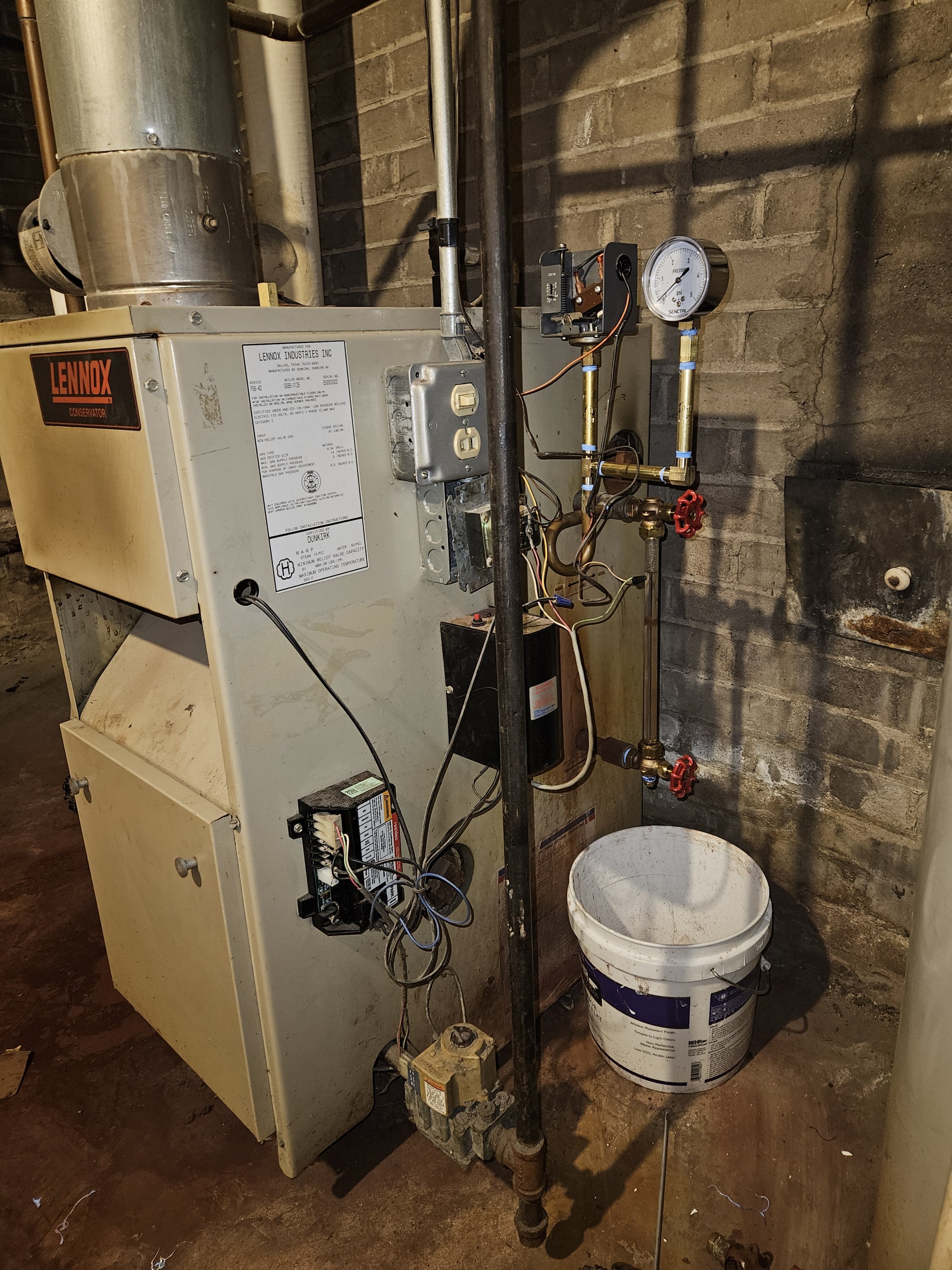

The stock 0-30psi gauge sits at about 5psi all the time, off or on.
Pressuretrol was set to cut-in at 7-8 psi. Ouch. Turned it all the way down, changed nothing. Removed it and the pigtail, pigtail was completely filled with sludge. Cleaned it and the pressuretrol, and flushed as much sludge out of every valve that opens off the boiler. Still no change in operation.
Replaced Gauge glass and valves. Water is decently clean and the level stays pretty consistent. Very light movement during firing. No change in issues upstairs.
I got a cheap gauge and put it parallel and discovered the pressuretrol is doing nothing. The switch works, but not without me helping it along. I tried tweaking with it and still cannot get it to switch on it's own. More interestingly though…
The vents in all 6 rads lightly hiss on startup and then close, and the rads heat up completely-valve side to vent side- before the gauge shows any pressure. They sit like this for a bit, probably 45 minutes if it was a very cold start . Like clockwork, as soon as pressure starts to build, the vents on the 1st floor rads open and get louder and louder as pressure builds. I shut it down manually at 2psi every time, but even at that point the 1st floor rad vents are rattling, pouring out steam and dribbling some water. I'm not exactly sure what water hammer sounds like, but I don't think I hear any. 2nd floor vents are definitely letting out steam, but not at all like the 1st floor. All rads get hot in my opinion pretty quickly. I feather the system on and off manually when I am in the unit to keep it from getting to cold in there, it's a lot of fun.
I know I am really stress testing this system because when I get there in the morning, it can be down to the low 40's F at the thermostat so it has a lot to make up. I'm sure it runs more smoothly when it is maintaining, but I'm not satisfied with that. I want this thing running as reliably, efficiently and SAFELY as possible before I stick a tenant in there.

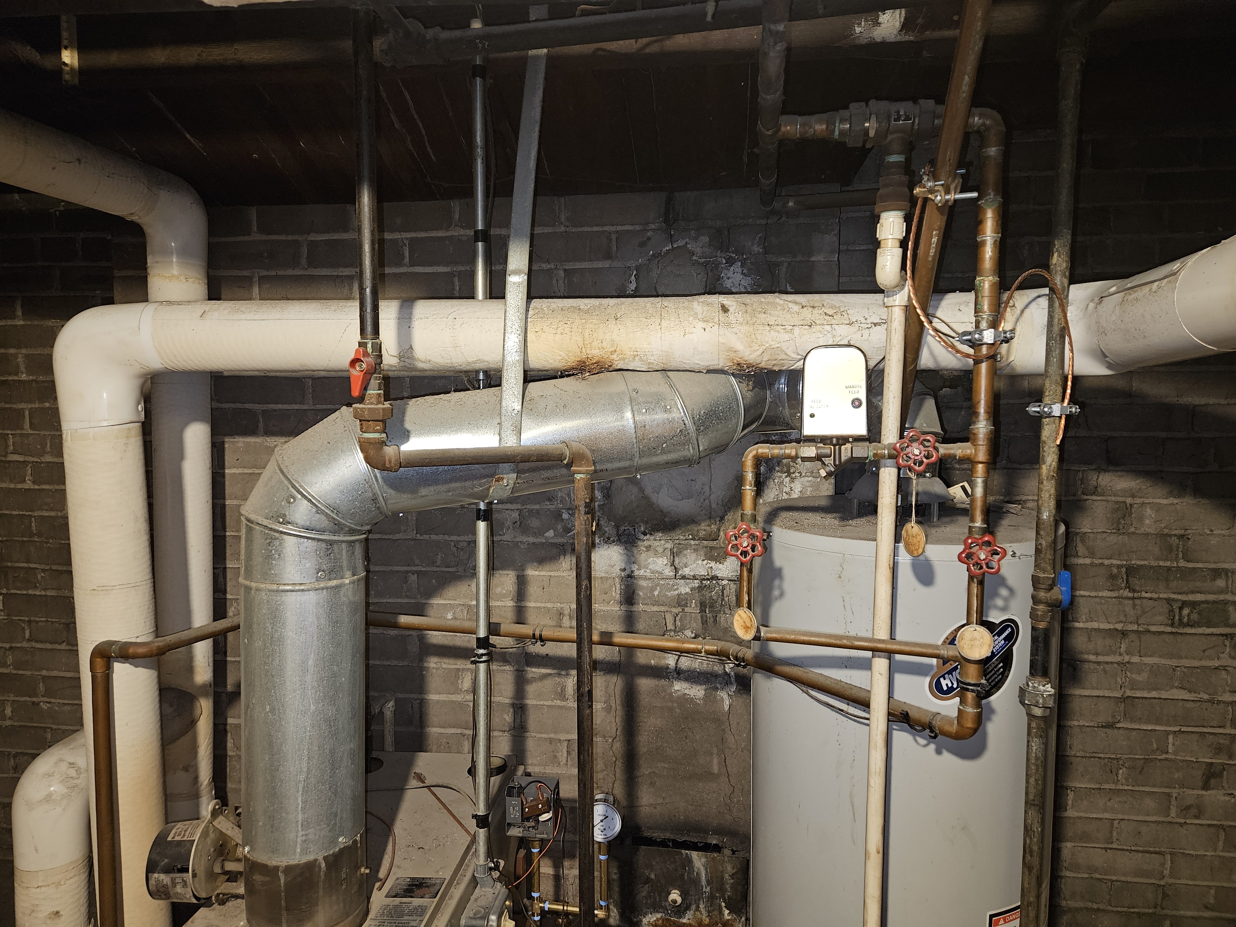

I don't think I have a header or a hartford loop. Not sure if this is an issue because when velocity is at it's highest at the boiler outlet at startup, I never have issues. The pipe that used to run to the kitchen rad is about 2 feet off the main. There is only one existing rad past this point. This bare pipe is the easiest spot to put a main vent, though I know this isn't ideal. Alternatively, there is an old run to a disconnected radiator on the 2nd floor that is the last run off of the main. This pipe is unfortunately covered in asbestos. From that point on, the entire dry return was replaced at some point with what seems like copper? all the way to the boiler. Cutting that last asbestos covered rad run and venting there seems easier to me than cutting into the copper? main/ dry return. I'm not a pipe fitter and I am trying to avoid drilling/ tapping/ threading if possible.
I ordered:
-Honeywell L408J1017 Vaporstat 0-4psi. I chose this over the 0-16oz because I wasn't sure the optimal pressure for the system and liked the wider range.
-New 0-5psi Bluefin gauge, I thought 2 different cheap gauges were better than one
-Gorton #2
-15psi relief valve, the old one was stuck
-Hoffman 40's for all 6 rads, this seemed like a good place to start
I will update as I start adding the new parts, little by little, cycling the system between the changes to try and get a better feel for what is going on.

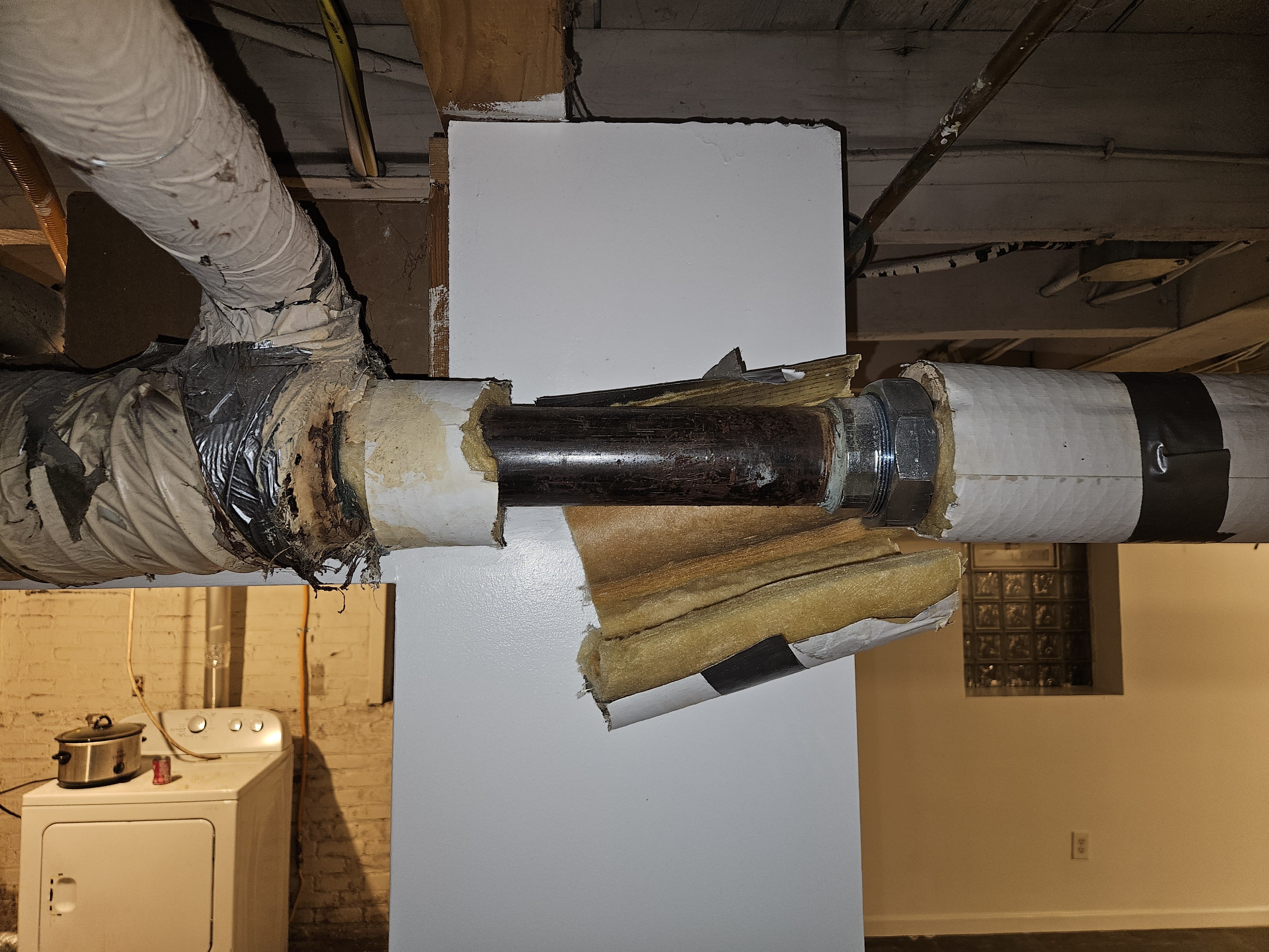

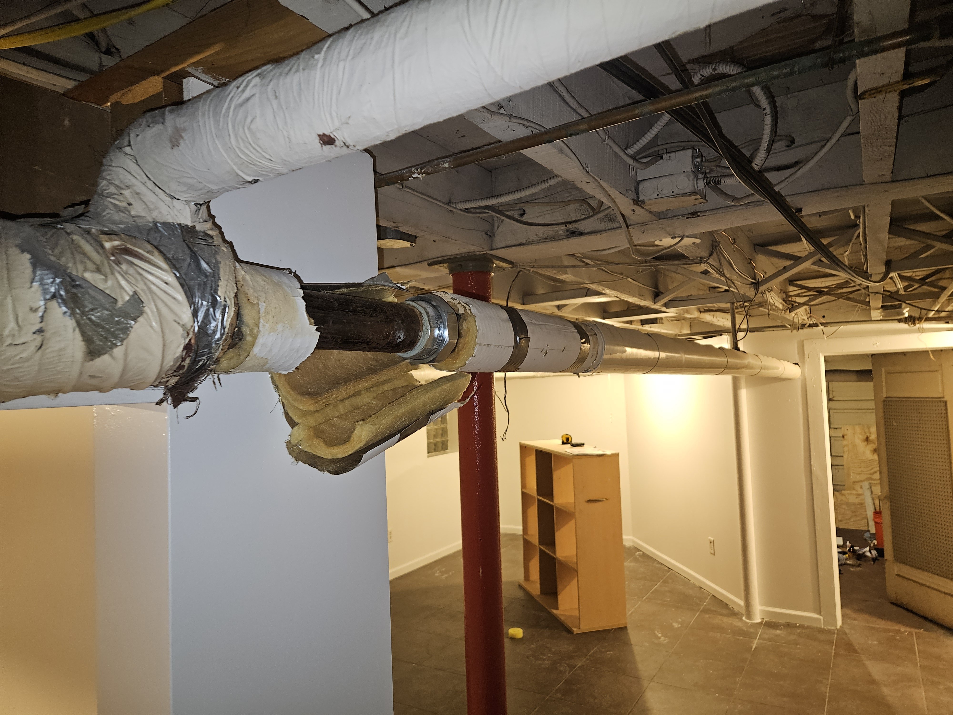

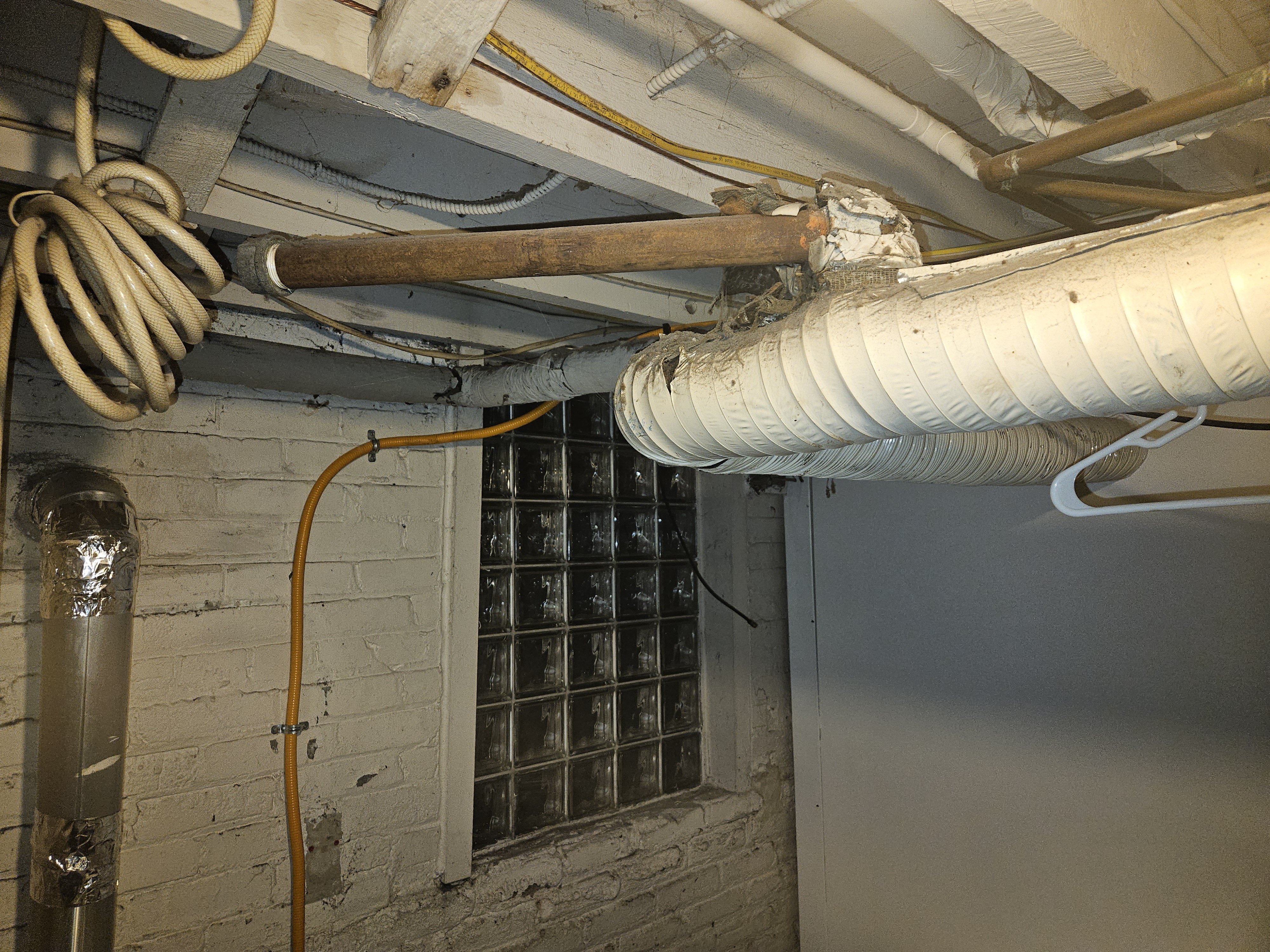

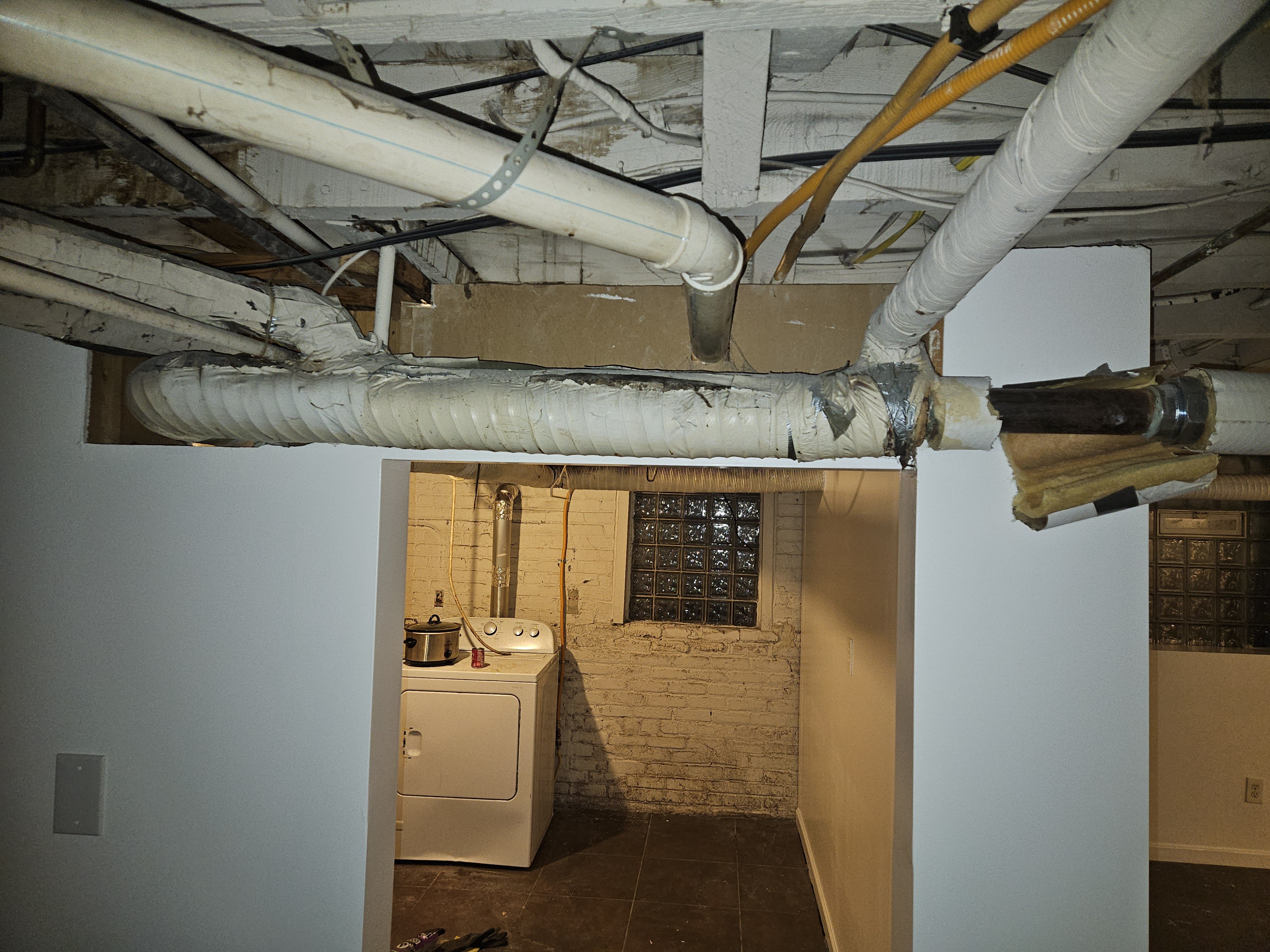

I'm attaching pictures of all piping in the basement, I will make another post of a fun little drawing of the system with labels.
What do you all think of the main vent? Am I better leaving it alone? If not, what is my best option for placement?
Where is a good starting point for cut in - out on the new vaporstat?
Am I on the right track here with my diagnosis?
Any and all comment is welcome and very much appreciated. Apologies for the long winded introductory post. If I get no responses, the very writing of this has helped me better understand my situation.

    you potentially have a lot of issues but the first one is to get your pressure regulation working which it sounds like you are on track.
    I’d set like cut-out at 1psi and cut-in at .25 to .5 if you can with that vaporstat

    wwrenchh
    If your nice new vapourstat (good for you, by the way!) doesn't shut off the boiler when you think it should, it is possible that it is miswired. It — and the low water cutoff — should both stop; the boiler when they are activated, but it is possible — since there seem to be one or two other things which are peculiar — that something else is wired in parallel with it instead of in series…
    See if you can trace the wiring out to see what is connected to what and how.
    ethicalpaulwwrenchh
    the receptacle behind the gas pipe is a nice touch
    wwrenchh

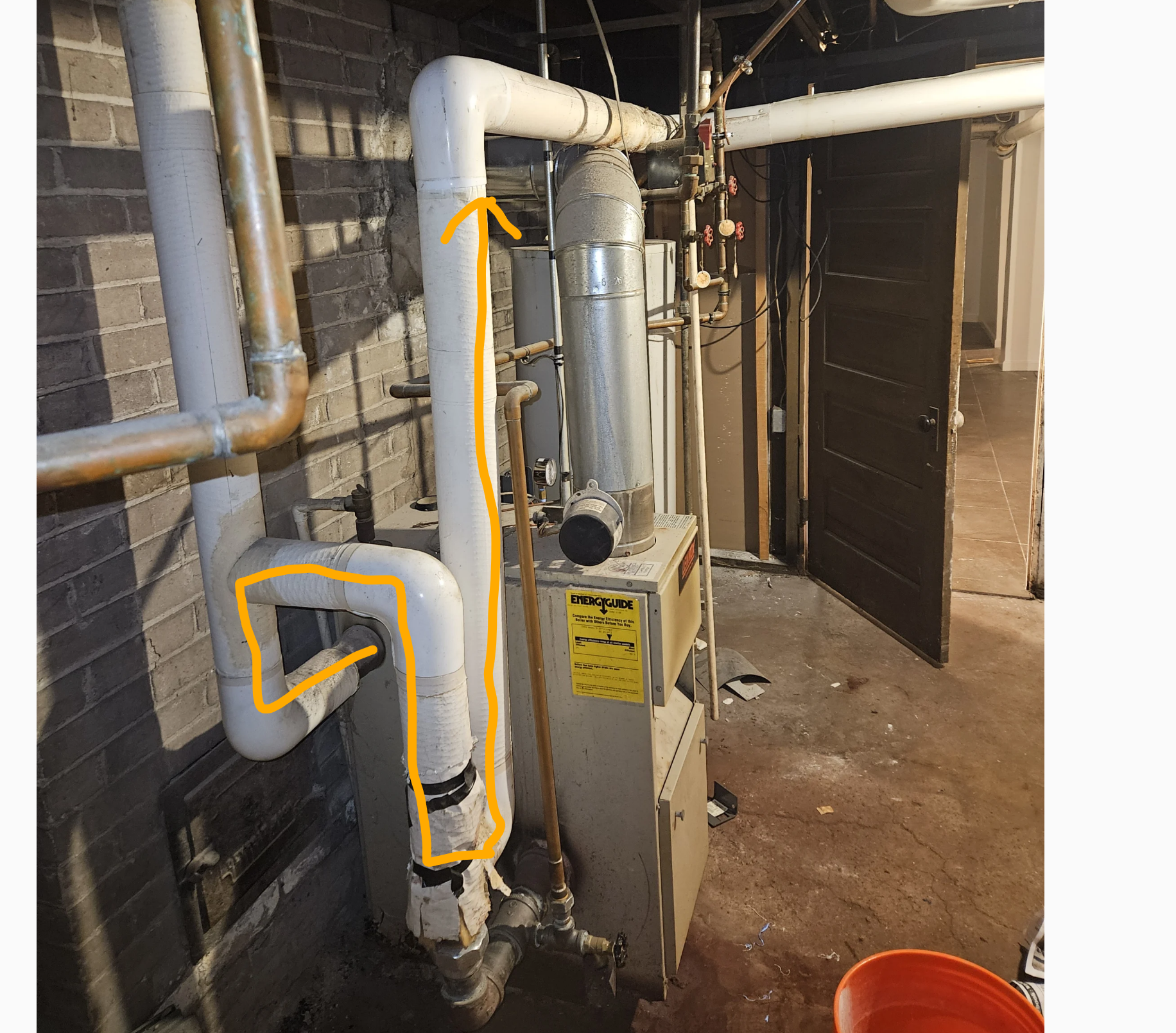

    steam is likely to want to take this path as well as along the main depending on the water level and pressure
    there are lots of things wrong with the near boiler piping but this is the biggest.
    you can put the main vent at an old runnout after the last radiator or anywhere in the dry return. It likely will get closed by the steam through the return before the main finishes venting.
    the vaporstat settign will be a compromise between the lowest you can set it and keeping the cycle length reasonably long. It sounds like the boiler is likely significantly oversized or the radiators can't vent properly.

    the hissing until they see steam is because you have no main vents, all the air is trying to get out of the radiator vents.
    it actually sounds like it is working better than i would expect given the amount of knuckleheading. if the radiators are all heating and getting to a point where the vents close it is working kinda ok. you're wasting a ton of fuel trying to vent it through the radiators and it likely won't heat evenly because the steam will get to the first radiator long before it gets to the last.

    You don't need Hartford loop on your system as your dry return becomes wet for only 8 inches or so so your water will never escape from your boiler through that pipe. Your dry return become an "inverted" Hartford loop.
    As was pointed out, the steam might want to take the path of your dry return but i suspect the water level prevents that (i presume it's around the top black take in your photo). Yes, ideally your return pipping would return water at the bottom of the boiler.

    With the boiler running if you disconnect one wire from the pressuretrol or the Honeywell L408J1017 Vaporstat 0-4psi switch does it shut the burner down ?
    The 0-30 PSI gauge should be maintained it is a safety code thing. Any low pressure gauges should be installed in addition to the 0-30 PSI gauge.

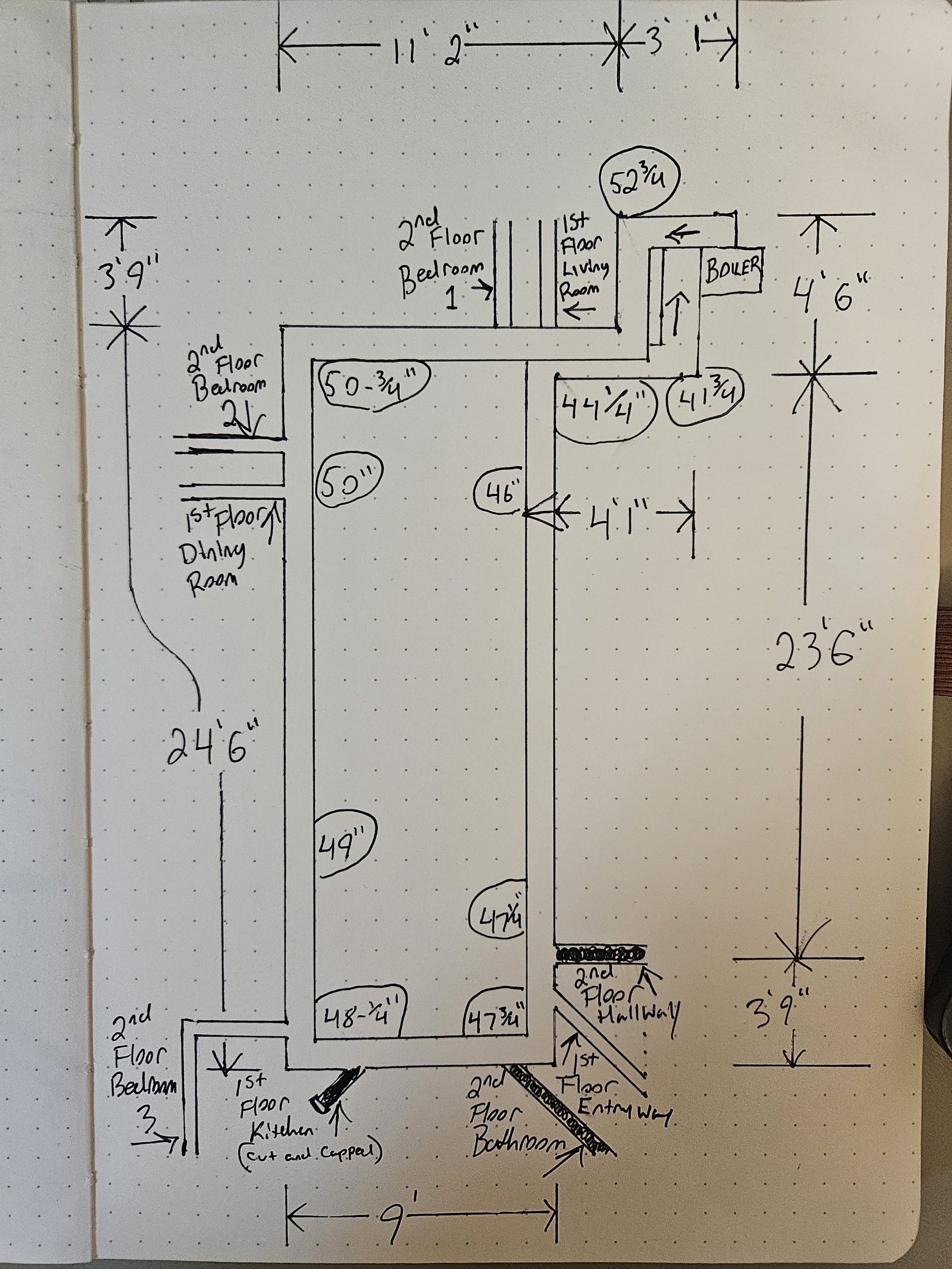

    I am attaching a drawing of the layout of the system in the basement, including measurements of the pipe, and the measurements in the circles are the distances from the bottom of the main/return to the water level for the points where they are labeled(I achieved this with a laser level), The shaded runouts no longer have radiators attached.
    These are measurements of the nearpiping in relation to the water level with system off, the up arrows are above the water level, the down arrow is below.

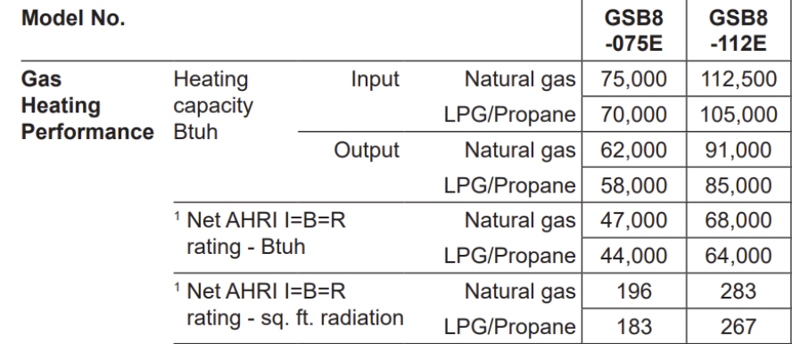

    Radiator sizes, in the order they are attached to the main starting withe the closest:
    All are 3 Column, 9" deep x 38" tall, EDR calculations based on 5 per section
    1st Floor Living Room, 9 Section, 21 - 1/2" wide, EDR 45
    2nd Floor Bedroom 1, 9 Section, 21 - 1/2" wide, EDR 45
    2nd Floor Bedroom 2, 5 Section, 11 - 1/2" wide, EDR 25
    1st Floor Dining Room, 10 Section, 24" wide, EDR 50
    2nd Floor Bedroom 3, 6 Section, 14" wide, EDR 30
    1st Floor Entry, 7 Section, 16 - 1/2" wide, EDR 35
    Total EDR 230

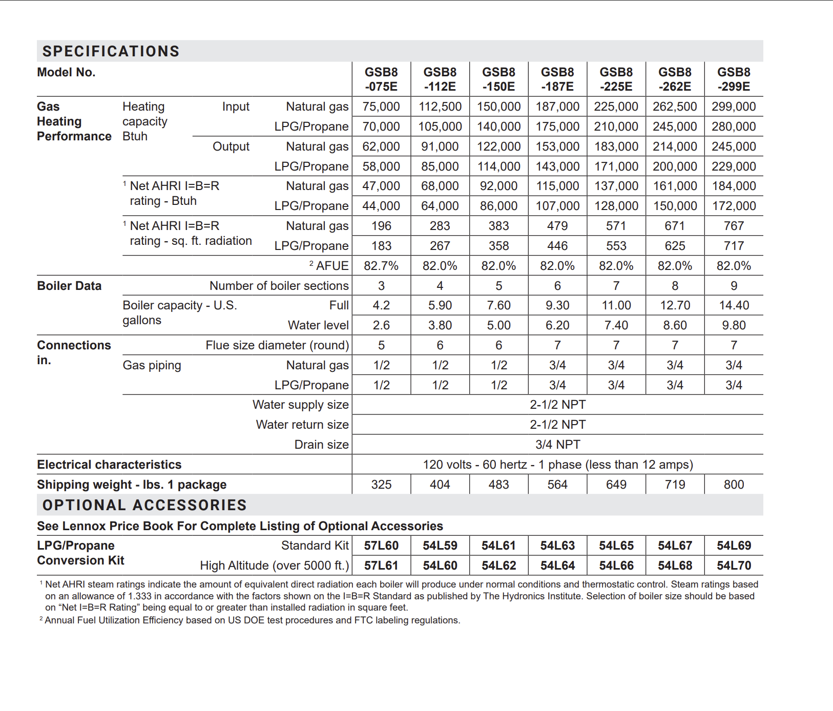

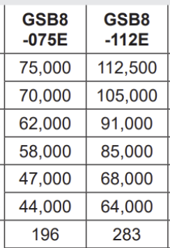

    Attached is Manufacturer Specs- not sure which BTUH value to use in calculating how properly sized the boiler is for the load
    Model is GSB8-112E

    1 radiator in particular, 2nd Floor Bedroom 2(the smallest radiator in the system), gurgles like crazy. Sounds like boiling water in the wall and at the radiator itself. This starts once it heats up. The last rad in the system, 1st floor entry, eventually does the same thing but it takes a bit longer. Working on installing the Gorton #2 and hopefully that will alleviate this problem.
    It probably won't help. You likely have a sagging steam supply pipe leading to that radiator that is holding some condensate after the heating cycle ends. Ideally, all the pipes are pitched in a way that all the condensate drains back to the boiler. When the next call for heat starts, the steam has to heat up all this sitting water and will cause knocking, or gurgling, or both.
    The numbers at the bottom of this image below are your "net square feet of steam" which is equivalent to EDR, which is the total square feet of exposed radiator surface in your home. The short answer is your home is tiny and you should have used the 75k boiler because its "sq ft of steam" value more closely matches your actual radiation of 230. Unfortunately it's very very common to have an oversized boiler. Yours is a lot less oversized than some we see around here. It will work, it just may so-called "short cycle" a little more than you'd like. You can minimize it by not turning down your thermostat at night or when you are away from the house for less than a day.

    Do you have anything for main vents in the basement?
    post a picture of that gurgling rad, show the pipe and valve into it, is it fairly level?
    the piping at the boiler is bad, steam leaving the boiler has no way to shed water and is carrying it up into the system,
    known to beat dead horses
    There is a picture of it above. It isn't great. The problem really is that there is no place for any carryover to go other than back in to the outlet of the boiler to give they exiting steam another chance at throwing it up in to the main. there is no header but there is a fairly tall riser so it will separate there but the lack of a header means it goes back in to the outlet of the boiler instead of in to the equalizer and in to the return. That actually is probably why it was ok with terrible venting, the pressure was slowing the steam down but now that it is open it can pull water with it.

    you see venting? main venting?

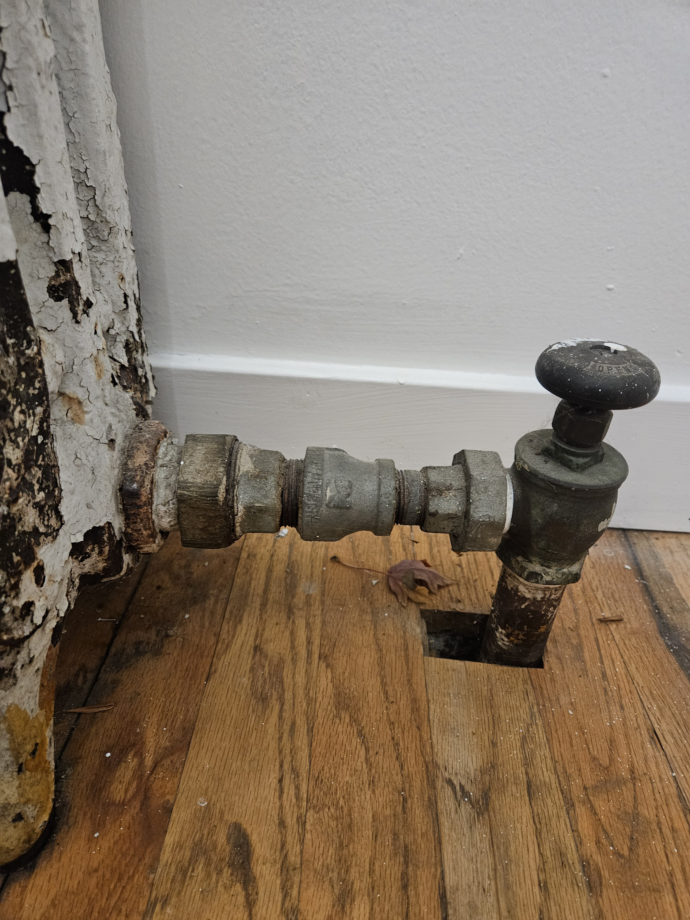

    The other rad that gurgles(1st floor entry, last in the series) has this piping artistry:

    I'm no steam expert, but wouldn't that narrow stub pipe next to the elbow create some steam / condensate issues?
    wwrenchh
    pecmsg Posts: 7,634
    That coupling needs to be replaced with an Eccentric Reducer. The outlet is lower.

    Agree pretty much with @ethicalpaul . You are about 12% oversized which is not good but is not bad relatively speaking. I'm over 30% oversized but am managing fine. Get the Gorton #2 main vent on, fix the piping to that entryway radiator and either avoid doing setbacks and recoveries, or, if your thermostat programming will allow it break up the recovery into something like 30 minute on off increments. You could also wire in a delay timer which you can find information on in other threads. You want to avoid building the pressure and if you do most of your issues will subside.
    Note your main vent isn't going to change alot from a full cold start. It improves time to get steam to the radiators significantly when the system is already warm. Cold, most of the time is eaten up heating the main pipes and condensing steam along the way (steam isn't just going to rush through a cold pipe all the way to the main)

    Possibly not. If it's a 1" supply line, you are going to have to reduce the outlet from the radiator one way or another regardless. And for the small radiators that are typically attached to 1" supplies, the steam and condensate seem to pass by each other well as long as there are no pitch issues in the supply line.
    I have found that all radiators hold some amount of water regardless of the connection used.

    Kind of wondering if that valve is open all the way.

    are the 2 rads with gurgles, are their valves all the way open? they need to be, and then it may be worth a look inside to see that the washer/disc hasn't detached and is holding condensate back from draining,
    are the vents too fast on the rads and the rush of steam is holding back condensate? does the gurgle start and stop with venting? or last thru a whole cycle?

    All rad valves are all the way open.
    Are you saying to take the valves apart?
    All vents are currently Hoffman 40's that I put on, the original valves would not close. It is worth noting before I put these on, system pressure took a lot longer to build and gurgling was not an issue anywhere in the system. I find this a bit confusing because with lower pressure, velocity should be higher pulling more water up into the main.
    The gurgling is so bad, now the water level is dropping before a cycle can complete, auto feed kicking in and flooding system once the boiler cuts out.
    The Hoffman 40 seems a good size for 2 of the smaller radiators, but the larger ones are taking a lot longer to heat up (this makes sense because before they were wide open). I might experiment with some different vents I have laying around and see if that helps.

    Had you tried lifting the gurgling radiators? Take a 2x4 and gently lift/lever them up and slide maybe 1/2" spacers under the legs.
    Steam production won’t pull water into the main regardless of pressure, unless your water quality is bad.
    Your description sounds like you have a couple things going on and you may be combining them in your head.
    1. Is your boiler surging?
    2. Does your piping have pitch issues?
    Find out and fix these separately
  • neilc
    neilc Posts: 3,213
    @ethicalpaul did you look at the near boiler Pipes above?
    not good, needs redo,
    ethicalpaul Posts: 9,076
    I didn’t look closely enough and have to retract what I said. This boiler piping is insane. Thanks

    Hello and good afternoon EBERARATT-Ed,
    My only thoughts were as there is plenty of ceiling height it would allow the wet steam to dry faster, then travel faster to the radiators but as it is small system it may not be economical to do. The 1st floor apartment over my parent's grocery store was a well balanced one pipe steam system that was coal fired at one time.
    My first thought was one boiler could be used with a double drop header to heat both apartments using temperature regulating valves, the correct piping, properly shimmed radiators with the correct vents, pipe insulation and the correct main vents leaving the second boiler as a back up boiler.
    If I am wrong about my thinking about this I stand corrected.
    A drop header is nice to have but probably the only time it is going to gain you anything unless you need to do it because of height restrictions is if the boiler is surging or priming. it might make initial skimming easier but if it is connected to a correctly functioning system it likely isn't worth the cost.
    Steamhead Posts: 19,007
    But if there are two or more risers from the boiler to the header, a drop header is much, much easier to put together since it adds two swing joints.
