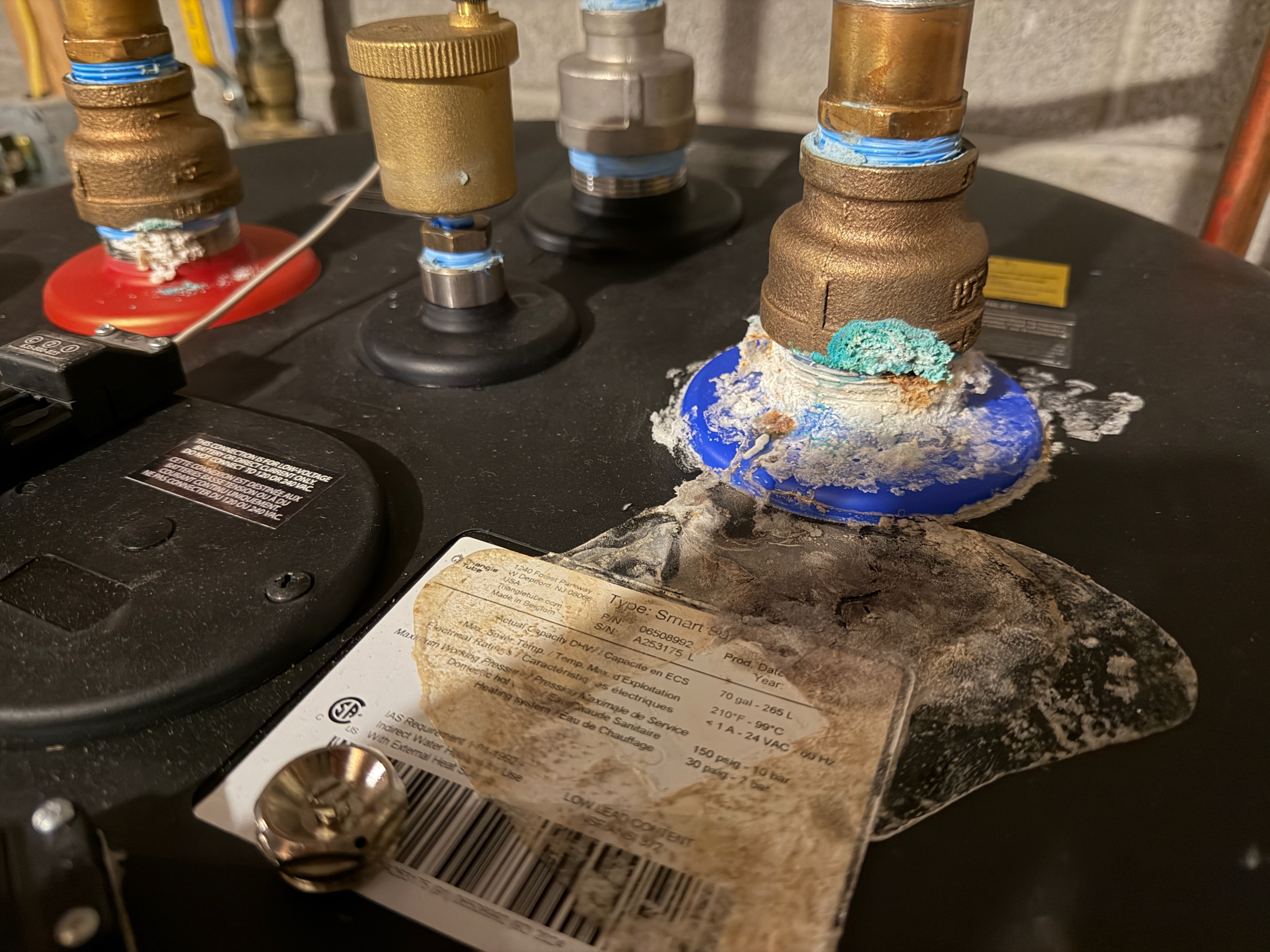

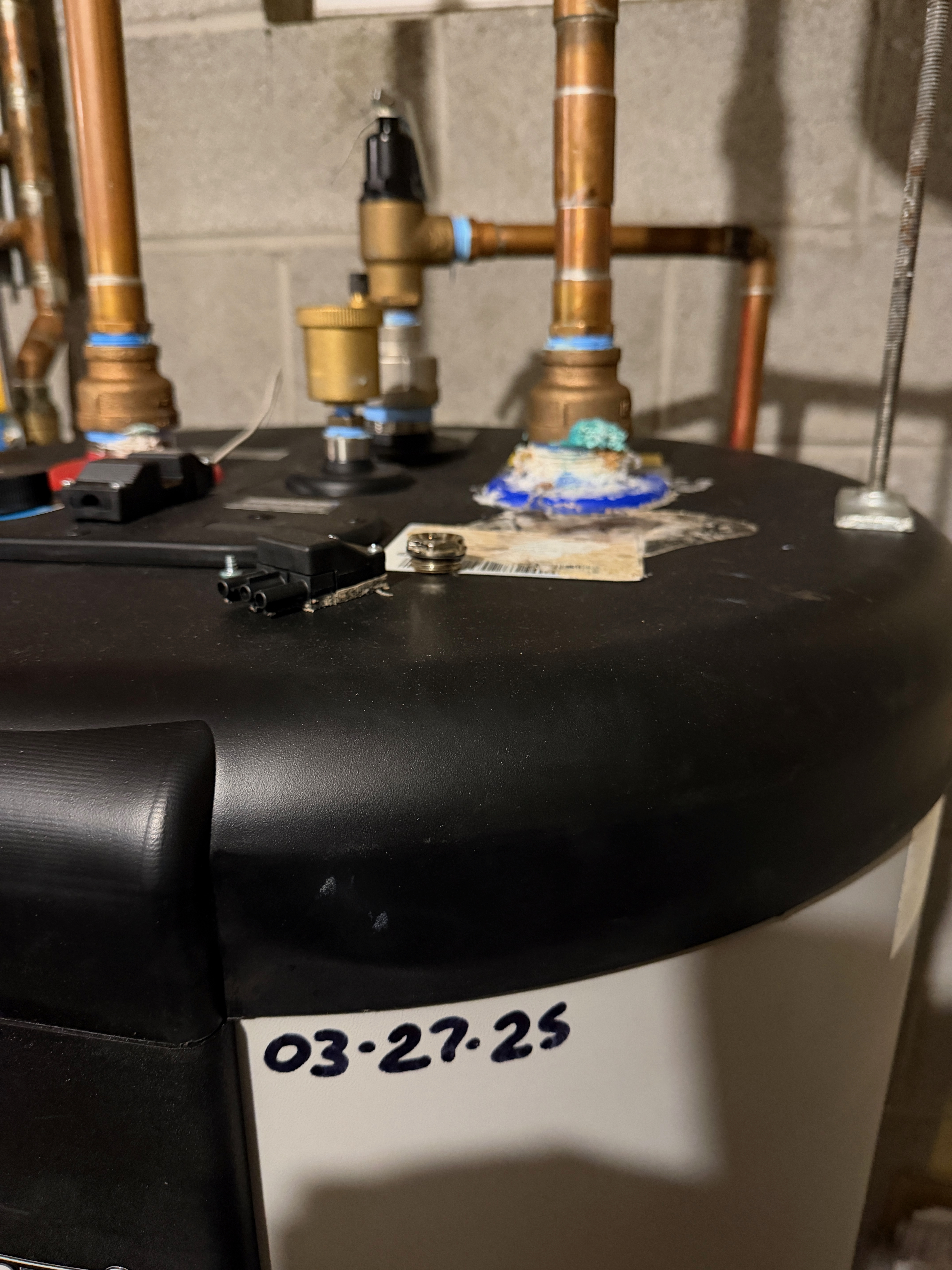

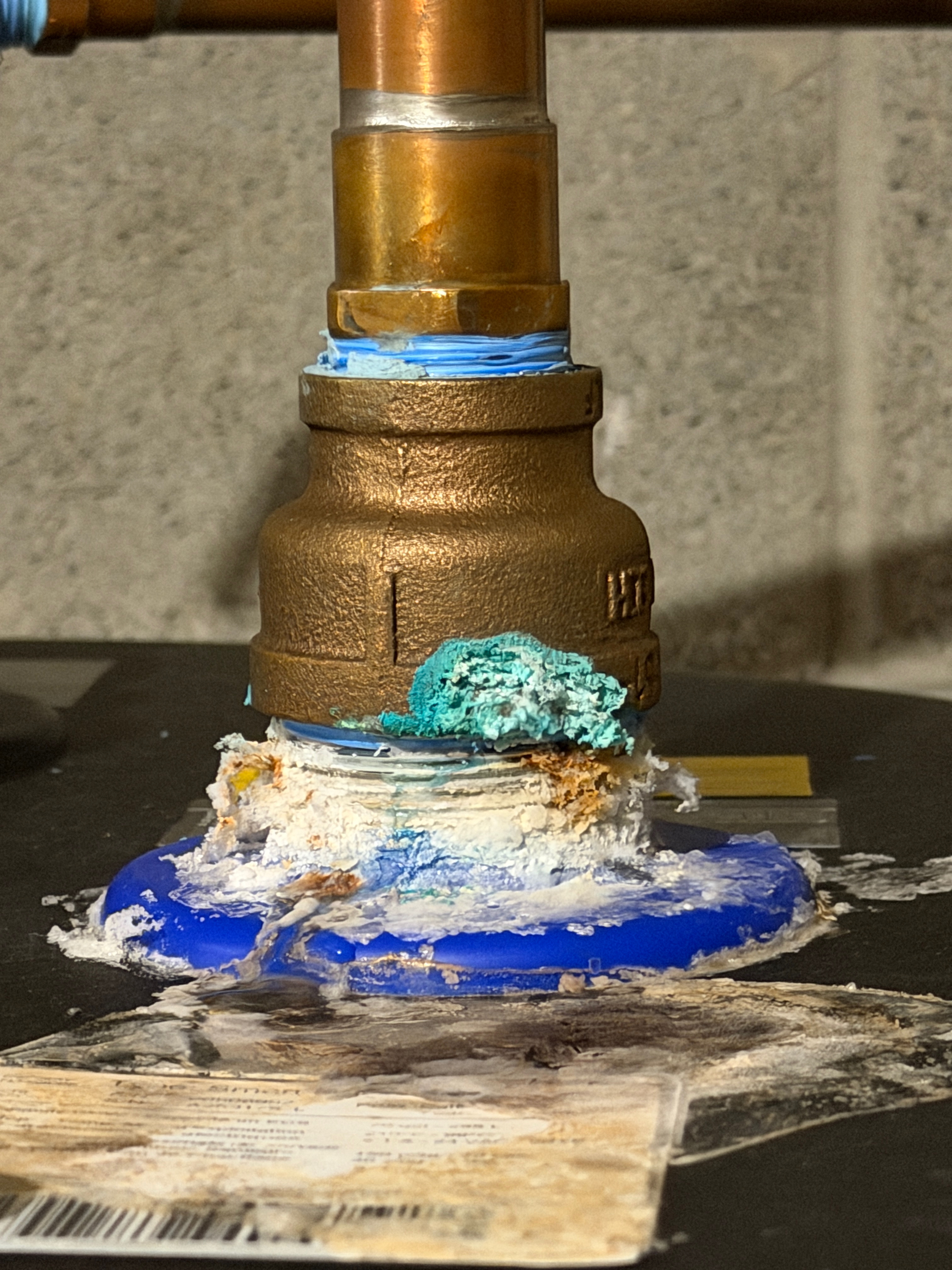

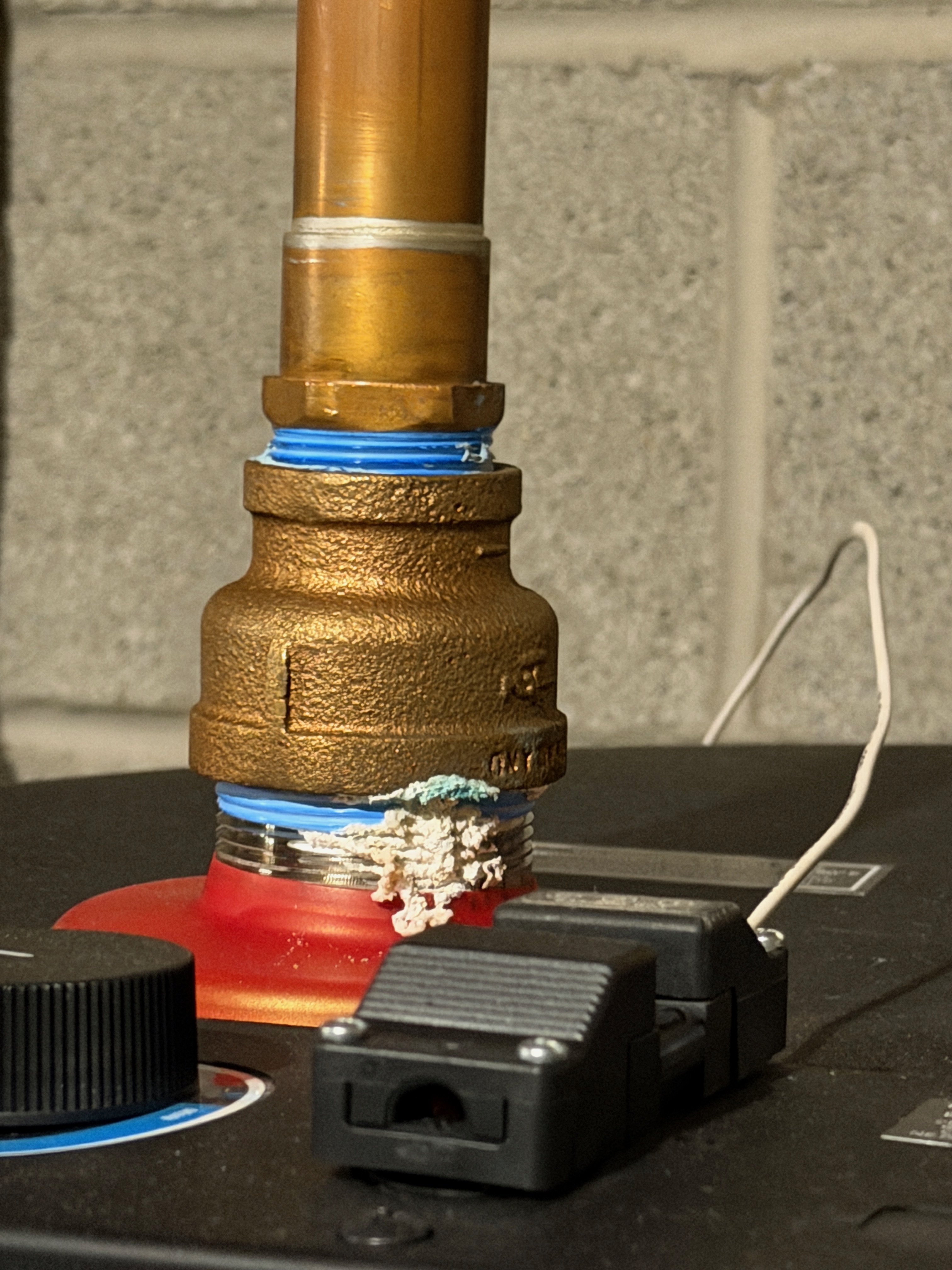

Hello, I had a new boiler installed in March 2025 and I just noticed the inlet and outlet connectors are corroded and leaking. Brass reduction fittings were used on them. Will the boiler need to be replaced?
Could you supply some more information? Pictures and model of the boiler. If the boiler was just installed 8 months ago it will not have to be replaced.
Did you contact the installer?
Pictures? That's awfully quick for ccorrosion..
It's a TriangleTube Smart 80.
Isn't that galvanic corrosion though?
I agree but dissimilar metal sometime are a little more difficult to join together thus are more likely to leak
Those are stainless steel nipples that are welded to the inner tank. Use more teflon tape or teflon rope.
I just installed a Viessmann indirect that had the same stainless nipples and the cold nipple at the bottom of the tank leaked. I redid the threads multiple times with different applications of tape and dope; none of those worked. What finally stopped the leak was Loctite teflon cord wound into the threads.

I had that happen on Viessman indirects as well. PP adapter onto the ss nipples was bone dry when installed a year later no water but a little corrosion.
Maybe the SS & brass expand at different rates.
Your installing contractor has to take them apart clean them and actually make them tight this time
Fixed it for both of you πChances are something is made in China.
Because american fittings can't be incorrectly taped and tightened, Ed? Come now π
The problem is the dissimilar metals. Brass and stainless steel. I have had a problem with Lochinvar indirect tanks that leaked for that very reason. I unsoldered the heat exchanger copper piping 3 times one particular time, using different thread sealants. I had leaks every time. The solution that stopped the leaking was the use of Locktite Anaerobic thread sealant. That's all I use for these connections, now.

OP the good news is that this is fixable. The bad news is that the company that made this indirect water heater went out of business on the 3rd. (it's not a boiler in your photo, and its a leak on the domestic side, so no boiler water involved with the leak)
It doesn't matter what language the people that made the pipe nipples speak, you can get a leak free connection there. These are generally regarded as good tanks, despite the company going under
1 -
And I'd say you can forget about the lifetime warranty.
Make sure the cap on the auto air vent is tight. Most SMART failures I've see have been because the air vent leaks and rusts through the outer tank.
