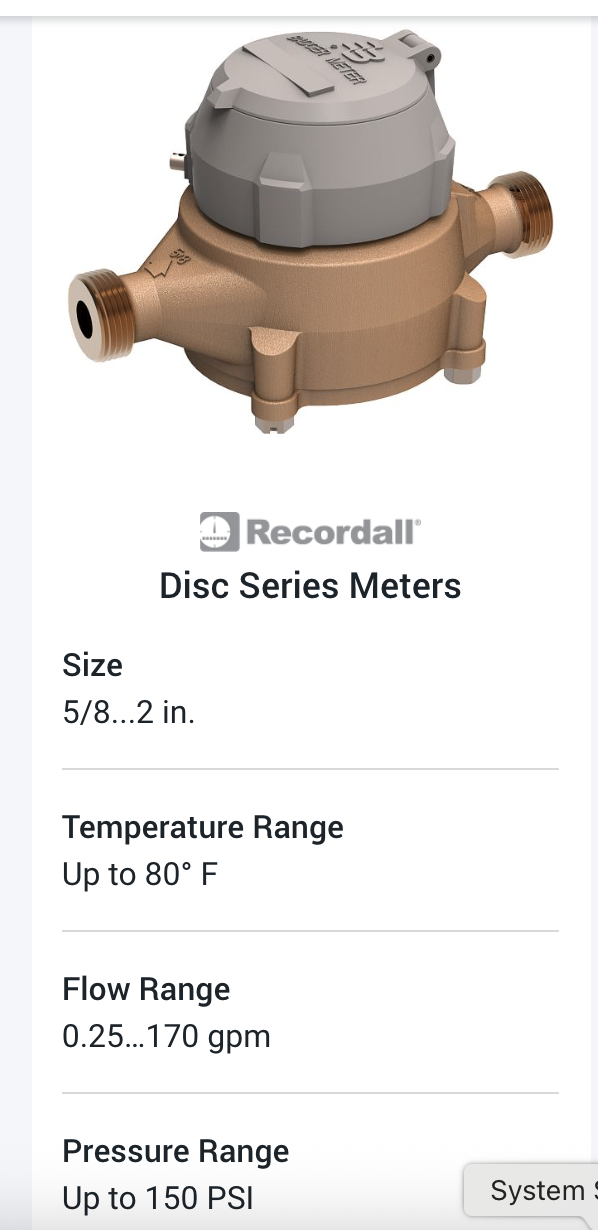

    depending on how much flow your fill system provides? You want a meter that reads low flow rates maybe .5 gpm or less? I have a plastic version of that meter and it seems to take 1 gpm or so to get it booted up and spinning.
    A typical Badger disc meter reads low flows, plastic versions are inexpensive.

    hot_rod Member Posts: 28,078
    The pipe sizing example is probably more for the ability to get full flow condition, gpm reading.
    If you are looking for below 5 gpm flow a 1/2" copper will easily move that through the meter.
    The meter will see the same gpm regardless of a 1, 3/4 or 1/2" pipe feeding it.
