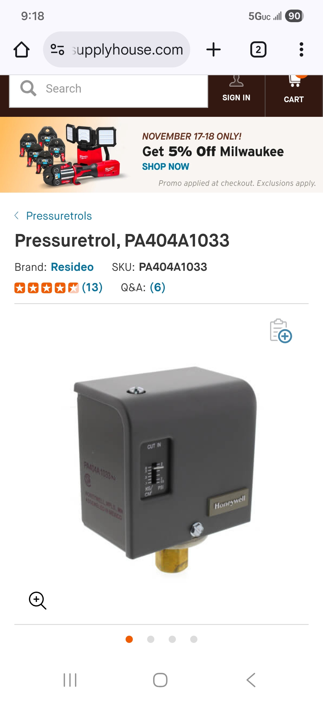

hay techs , I replaced a defective pressuretrol PA404A1033 on steam boiler ,add boiler treatment for service , all the radiaters are getting heat , but the pressuretrol short cycles boiler every few minutes i have it set just below 2psi , it was very late in evening so i didnt further check , will need to return back ,wanted to post the issue for solution .tnx

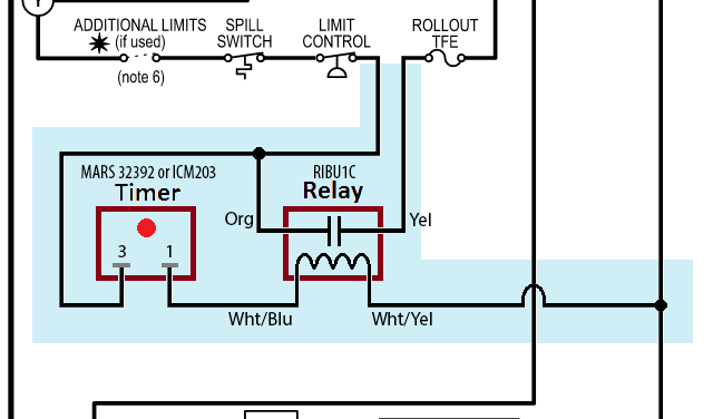

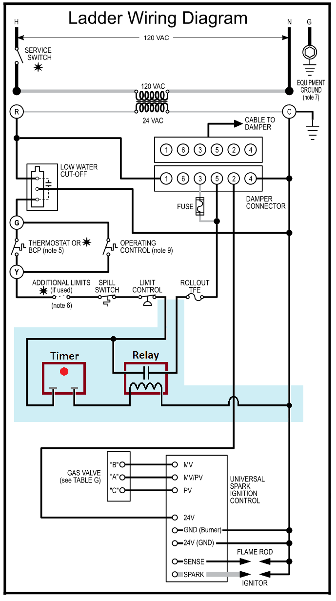

    An inexpensive Delay on Break timer can be added to minimize the cycling nonsense after the first trip on pressure. There are other ways to minimize the cycling, the Delay on Break timer is probably the least expensive and easiest to install.

    I dont have picture but the new pressuretroll cut in was set just below 2psi , with the diff @1 from factory ,i havent got a call back its ben 5days already .

    you mentioned delay on break timer , is this a time delay ,thats used on air conditioning compressor or its something specially for steam boilers ?

    so what setting your putting them just to be exact, & this is the pressuretroll I installed.
  • dabrakeman
    dabrakeman Member Posts: 1,017
    Slide the slider down right to 0.5psi and the white wheel inside should be set on 1
  • nytech28
    nytech28 Member Posts: 116
    ok so thats gona set the psi for the system to 1.5psi
  • dabrakeman
    Assuming you have an accurate pressuretrol which would be unusual :) Most as set still seem to let the pressure creep closer to 2psi before cutting out.
    ethicalpaul Member Posts: 8,896
    No, it's going to set the high pressure limit to 1.5psi. Big difference
    109A_5 Member Posts: 4,146
    edited November 2025
    Basically it is the same as used with AC with an install that accommodates the boiler situation.
    Here is a recent thread that was successful.
    A wiring example
    The OP's connections.

    the old pressuretroll was johnson control P47EA-3 ,which was discontinued, so i got a replacement.
  • nytech28
    I would need to adjust it to .5 & leave the 1 on the diff ,thanks
