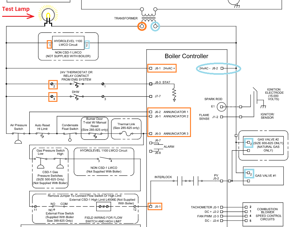

    There are many techniques to find a short circuit. Focusing on mostly one here. IMO the best way is not to accumulate burned up transformers and/or blown fuses if the circuit has a fuse or if a fuse has been added.
    I would find the Li'L Popper very annoying, since it requires constant resetting, it is just an appropriately sized circuit breaker with convenient wires and wire terminations added. But it is better than accumulating burned up transformers and blown fuses. I have not used the LED device so I have no comment about it.
    The oldest but probably most forgotten method is to put an incandescent lamp (tungsten filament) in series with one side of the transformer's secondary wires (a lamp on the transformer's primary side may work too but you have the transformer's properties that may muddy up the technique a bit.)
    The incandescent lamp technique, commonly called a Dim Lamp test or Dim Bulb test (look on YouTube) has to be set up correctly to be most effective. And this means the incandescent lamp(s) need to be sized correctly. The lamp need to be the same voltage as the circuit under test. Also the load current of the lamp should be in the ball park of what the transformer can safely source.
    So for example if the 24 VAC transformer is rated at 40 VA the lamp should be in the 40 Watt ballpark or a bit less. The lamp provides a maximum safe load for the transformer and any fuses in the circuit. So no more burned up transformers or blown fuses. Two 12 volt lamps in series can be used too.
    The benefits: No more burned up transformers, blown fuses, it is self resetting, provides good visual indication of the circuit status providing diagnostic information.
    The down sides: 24 Volt lamps are more rare, incandescent lamps are more fragile, you would probably have to build the tester.
    Using this technique I have founds shorts in seconds where others have failed using other methods (the looks on their faces were priceless).
    In this situation it appears the Orange and Blue annotations are shorted together somewhere. With the test lamp in circuit it will be bright until the short is removed, then it will get dim. Often the circuit will actually work with the dim lamp in circuit (the short has been repaired obviously). In this case the Orange or Blue annotations can be disconnected one at a time to locate the part of the circuit that is defective. Also if there are crushed or chaffed wires the lamp may help identify where they are with the self resetting ability and the good visual indication. Also although not shown here one side if the transformer's secondary may be bonded to ground and/or the jacket of the heating equipment.

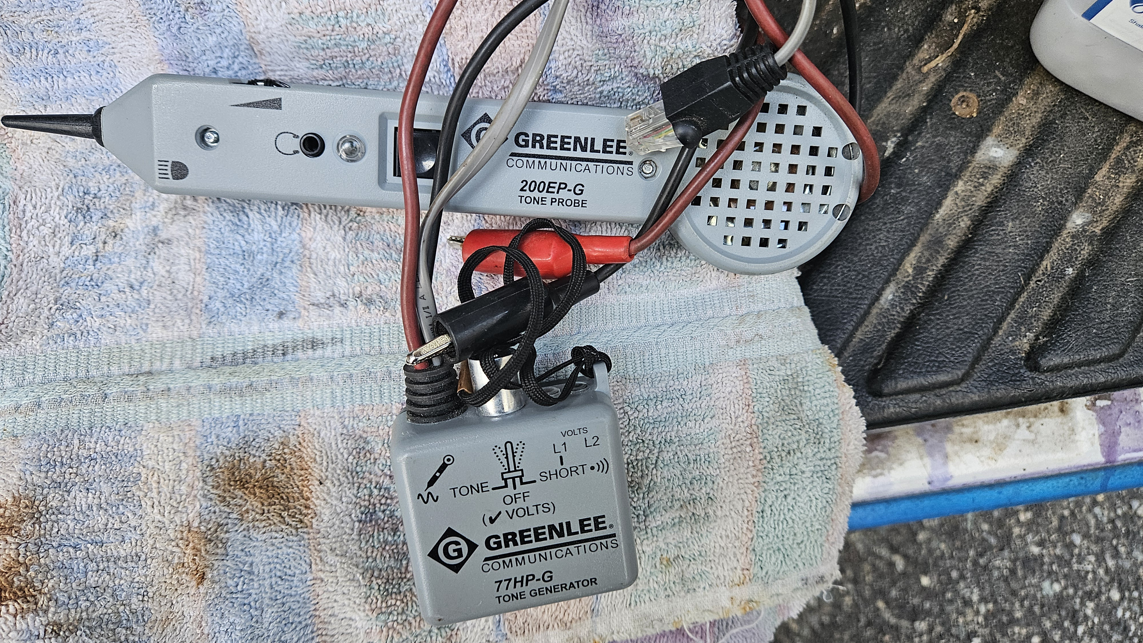

    Just curious " tone generator has a short circuit setting " what is this piece of test equipment ?

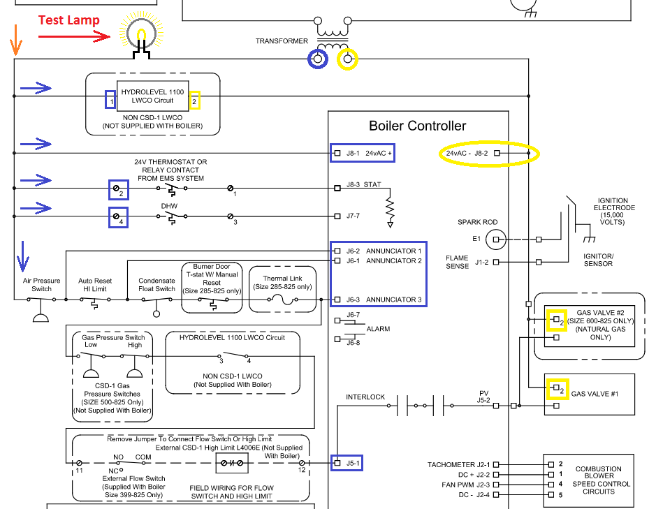

    See how this is taking way too long and now you want to change the harness. What if it is actually not the harness ?
    There is 5 places to disconnect to give you troubleshooting direction, the 5 Blue arrows, one at a time. If the short still exists with all 5 places disconnected it is a defect with the wire from the transformer into the harness Orange arrow, a defect like that should be obvious with inspection. There is nothing else left, unless some one tapped into the system with some other device.
    Once the path to the short is identified move on down that branch. This process is not hard or time consuming, but it has to be logical, strategic and methodical, using the correct test equipment helps too. Ambiguous testing leads to ambiguous results. Keep in mind disconnecting J8-1 also disconnects J8-3, so the thermostat wire (screw terminal 2) should be disconnected first to avoid confusion.

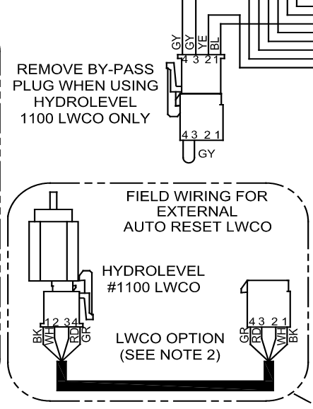

    LWCO ? Could someone have put the connector together wrong shorting out the 24 VAC ?
  • Transformer is not connected at all. All sensors and safety devices disconnected. LWCO 120V and the jumper was removed during testing procedures.

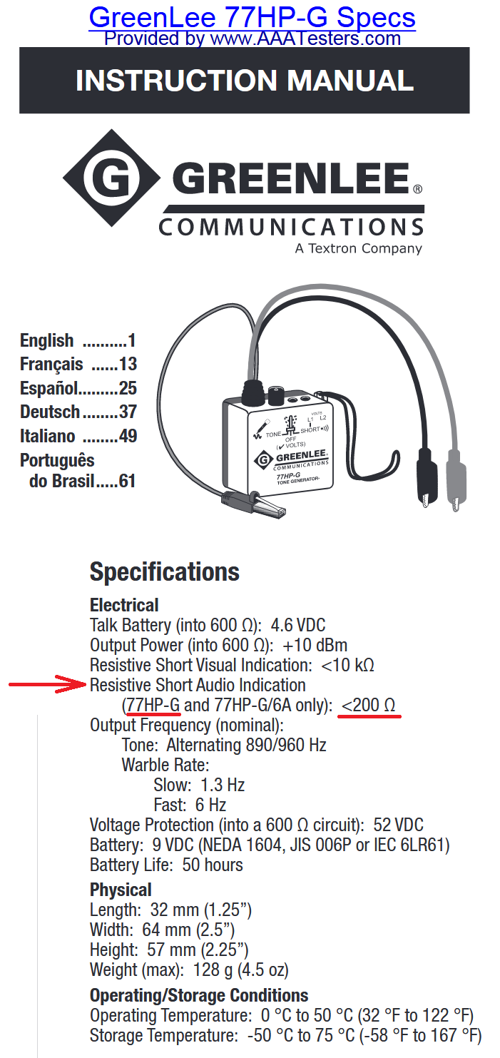

    Thanks, got the picture of the " tone generator has a short circuit setting ". I figured that is what it was, just wanted to be sure. Here is my issue with that type of tester. Some manufactures call that functionality a continuity tester, yours and others call it a short tester. The intent (at least the original intent) of that type of equipment was to trace out and verify phone lines, not to help troubleshoot burning up transformers.
    When you look at the specifications of that short tester it will alert with any continuity under 200 Ohms (see the image below). Well, for example if you have a 24 VAC 40 VA transformer at full load the load resistance would be about 14.4 Ohms. Since in this case the transformer immediately dies I suspect the fault load resistance is much lower.
    The issue the way I see it is using that short tester it may be prone to false positives, since you can't tell the difference between 180 Ohm load, 14.4 Ohm load or a 1 Ohm load. False positives will have you replacing things that are not defective.
