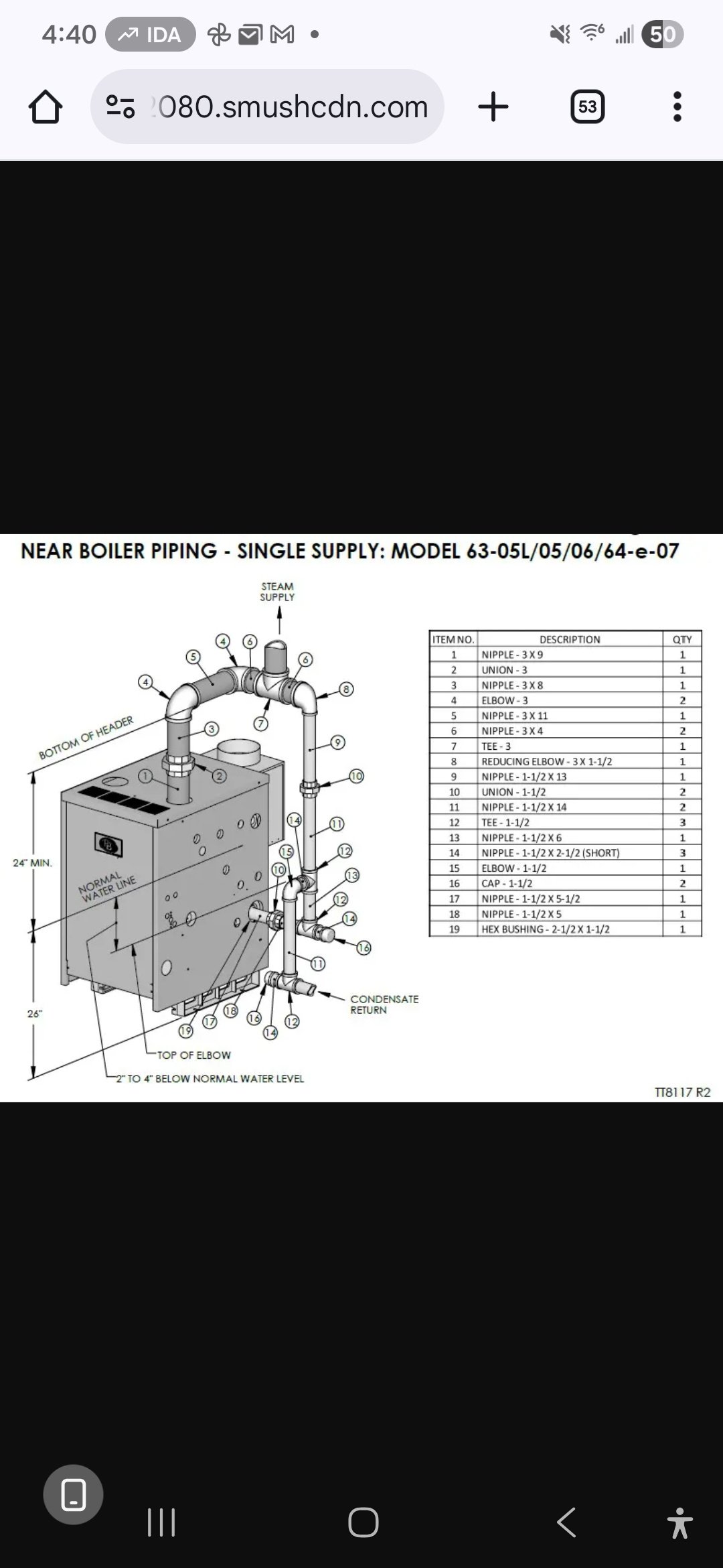

So in the process of trying to determine the bare heat exchanger height for the series 63 (to see if i can slide it through a basement door without pivoting) i tallied up the header pipe dimensions allowing 2 1/2 inch guess at nozzle height over the main block. All adds up to 24 inches as expected.
But wait! Isn't that 24 inch height from NWL? Surely there is disengaging headspace from the NWL to top of the exchanger block? Seems their design puts the inside level of the header high by that amount? How much disengaging height is there? Any ideas?

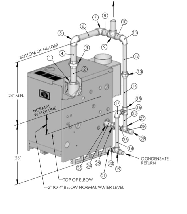

    I can't tell what you're asking but Peerless diagram says they want the bottom of the header to be at least 24" above the waterline.
    The boiler height is 36 3/8" from the floor to the top of the jacket plus the vent connection which is about 1". And the vent connection is probably removeable.

    disengaging headspace ? Steam Chest height ? Subtract the length of the two nipples and the union from 24 Inches above the NWL (Normal Water Line), should get you in the ball park.

    The key dimension is from the normal steaming waterline in the boiler to the top vertical of the first risers from the boiler outlets. That needs to be at least 24 inches — but it can be more. After that — you can go higher. You go over laterally. You can bend over and use a drop header.

    Better picture with cut-away shows what I'm calling the "nozzle" atop the block:
    So by this calculation the top of the exchanger block less the raised nozzle is 26 inches which just happens to be the NWL which cannot be unless the block is either completely filled to the nozzles or Peerless has added in some additional height on this design. I guess I'll assume the latter. So if I had some idea how far the NWL actually is below the nozzle top I could infer the exchanger height. Or I suppose I can see when they deliver it.

    Ok if you mean the pipe(s) marked “2” in the diagram, those are pipe “nipples” added by the installer after the boiler is in position.
    None of the pipes in that diagram come preinstalled

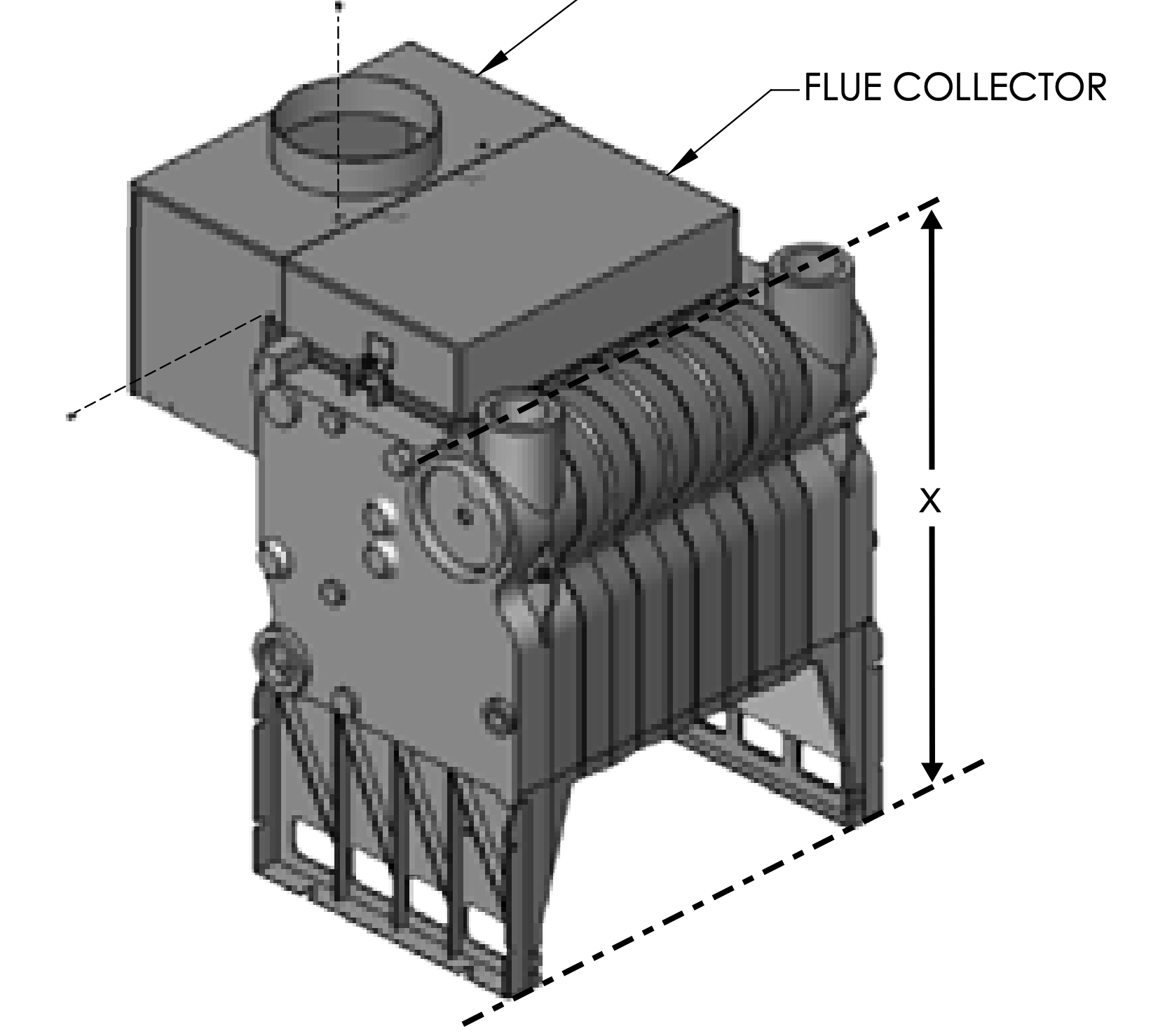

    @ethicalpaul   I believe @dandub1960 would like to know the measurement of the cast iron block from the floor to the top of the CI block. this way @dandub1960 can calculate if it will fit after they take the jacket apart and all the trim off. What is measurement X ?
    I remember doing this for a boiler job that would not fit through the basement door. We took the entire boiler apart down to the block and were able to fit the block assembly in the basement door.
    Since Peerless does not offer that dimension. @dandub1960 is trying to do the math from the piping diagram to subtract the pipe nipple sizes and union sizes, to back into the dimension.   You, Paul, can just measure for them by sliding a tape measure inside the jacket to see what the dimension is.
    if you are really tight on space you can usually order it with the block unassembled and move one section at a time in and assemble the block in place.
