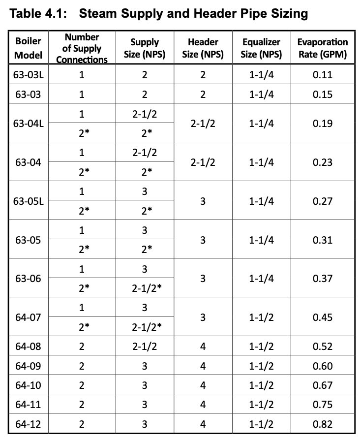

    I don't know specifically what's on Burnham's mind, but every boiler installation manual from every manufacturer has it reduced. Now that I've said that, someone will post an installation manual proving me wrong.
    But here's Peerless:

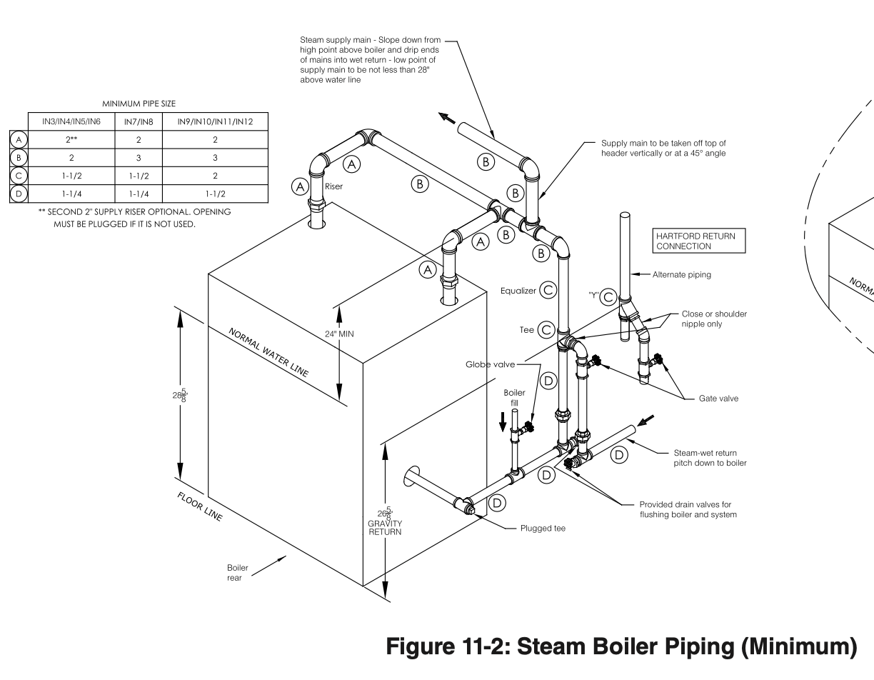

  • All the manuals that I’ve seen have the equalizer as a minimum size. It doesn’t say that it can’t be bigger. Burnham was the same up until recently as far as I can remember. We always run 2 inch because it’s easier to not switch sizes for such a small amount of pipe.

    All I see in their Independence manual is 1 1/2" minimum, no comments on a maximum equalizer size?

    Everything in their manual says "Minimum"
    If I had to really guess, I'd almost say they are misstating the rule that IF an equalizer pipe is reduced from the size of the header, then the reducer MUST be a reducing elbow, or MUST be a reducing bushing on the vertical pipe and SHALL NOT be a reducer on the horizontal header.

    There is nothing in the Burnham Manuals that state anything about the equalizer except:
    1. Specify minimum size, no maximum size is given
    2. Specify that any size reduction must be in the vertical portion of the equalizer
    And this in the attached found in the Steam Max manual.
